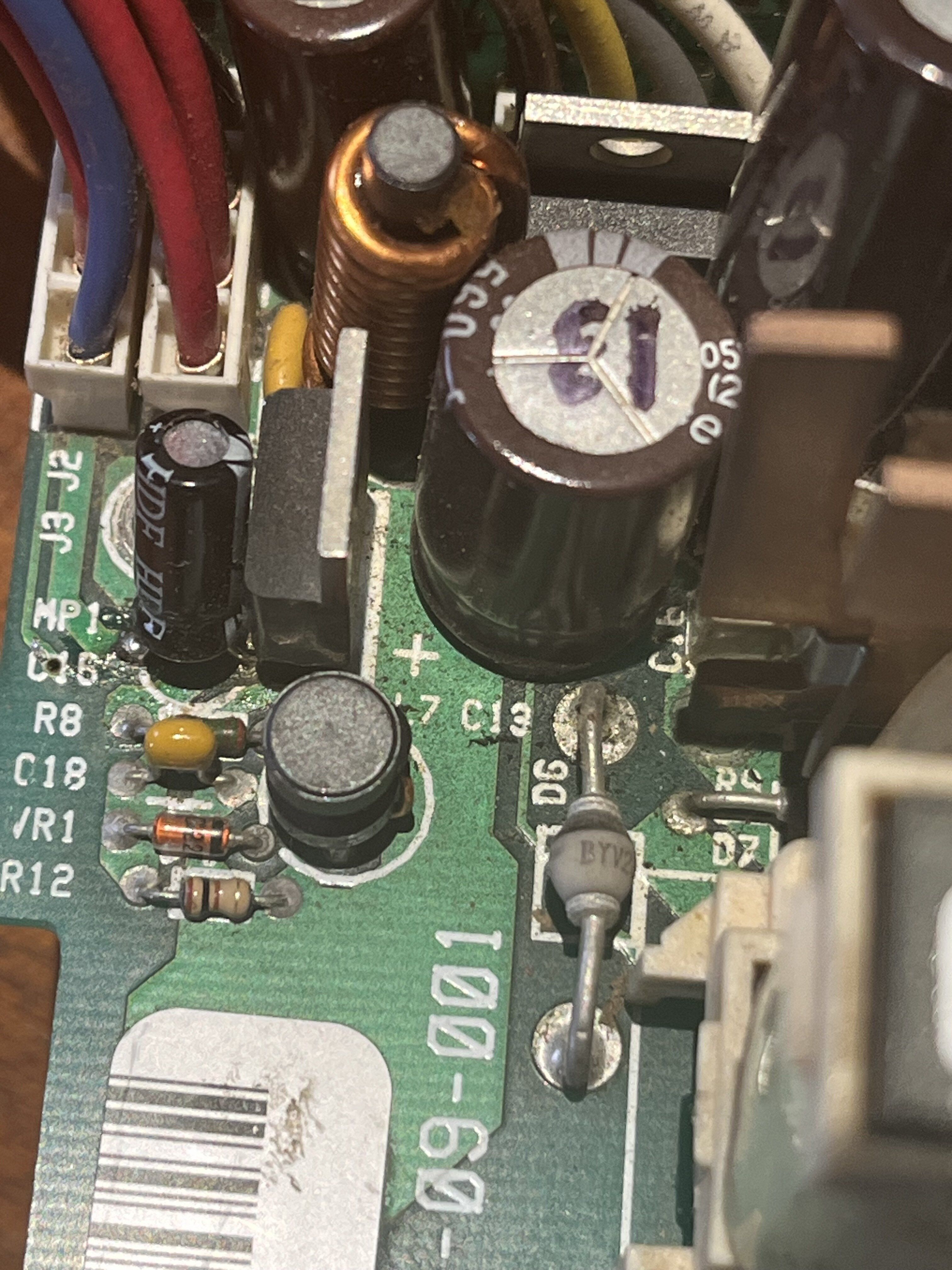

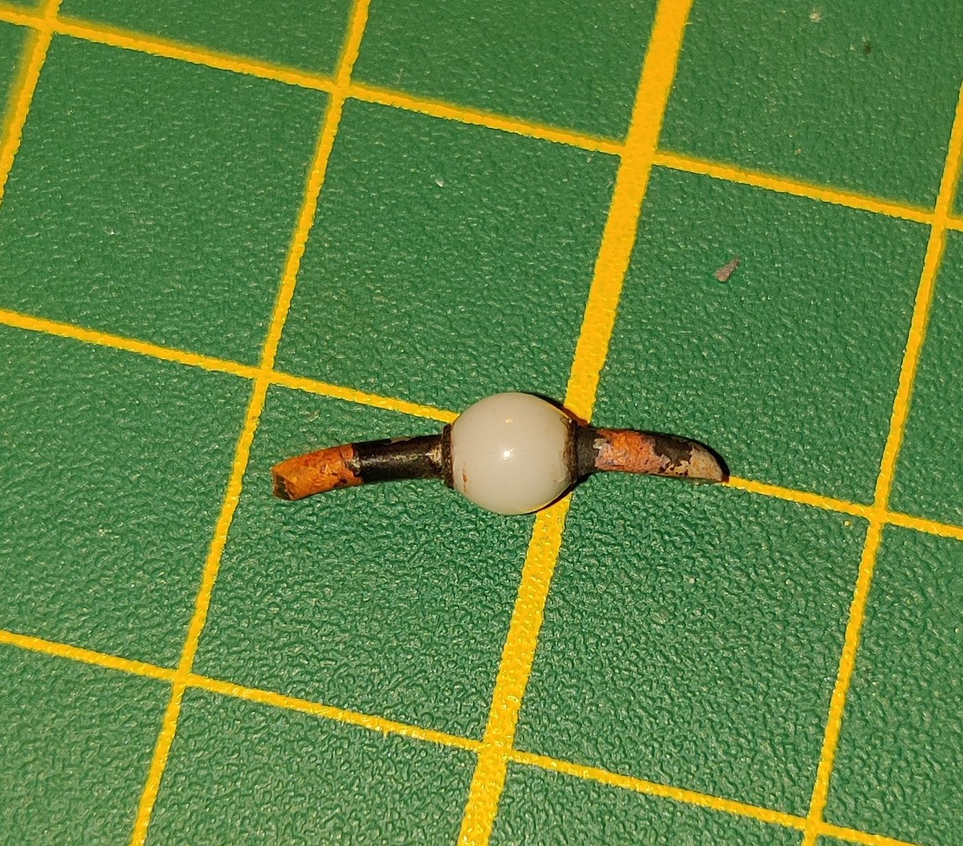

When opening up the power supply to identify and replace the caps, I noticed a diode on the board had once gotten extremely hot, to the point of its solder joints melting and deforming. Assuming it had catastrophically failed, I clipped it out to take a look at the part number. Very frustratingly, however, as I removed it, all the identifying markings on it rubbed away into my fingers! So I've come here to ask if any of you folks could help me figure out what the part is so I can find a correct replacement. Here it is:

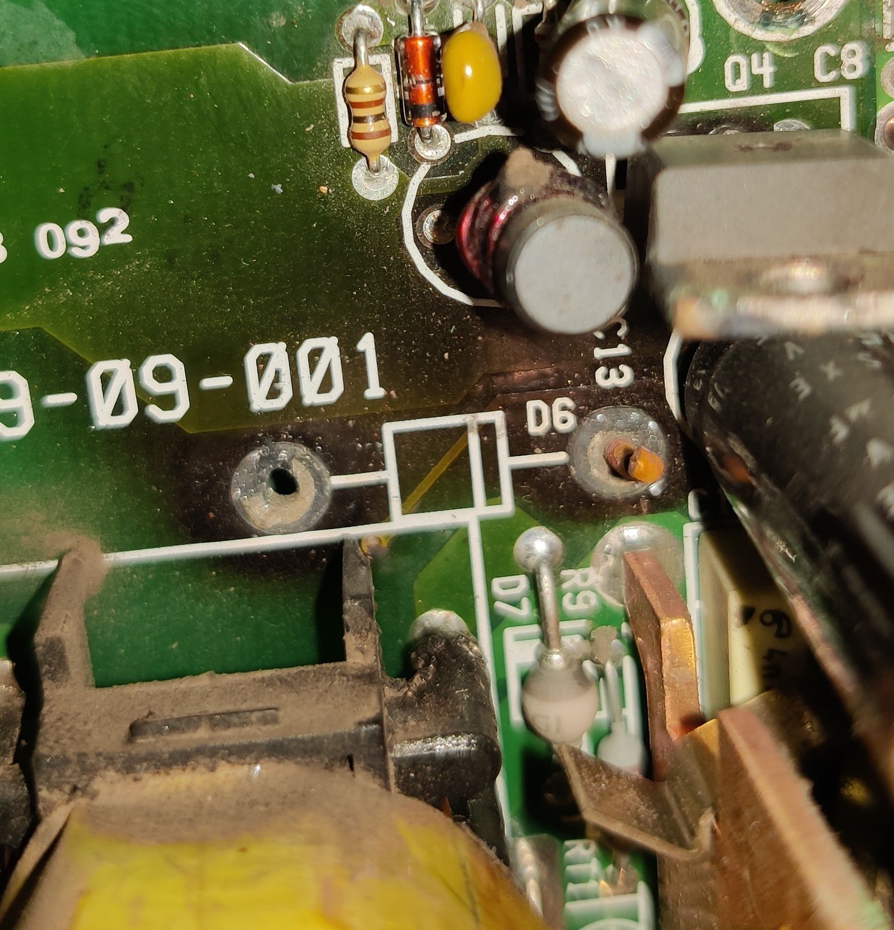

It's diode number D6. I believe that it got so hot, the printed P/N unbonded with the surface of the diode. The only characters I could make out before they disappeared completely appeared to read "V28", which yields no results online. It was located just under the PSU's fan, right here:
You can see how hot it got just from looking at the board. It's burned on the bottom, too. And since the diode is obviously cooked, I wouldn't count on finding a replacement by testing the old one.

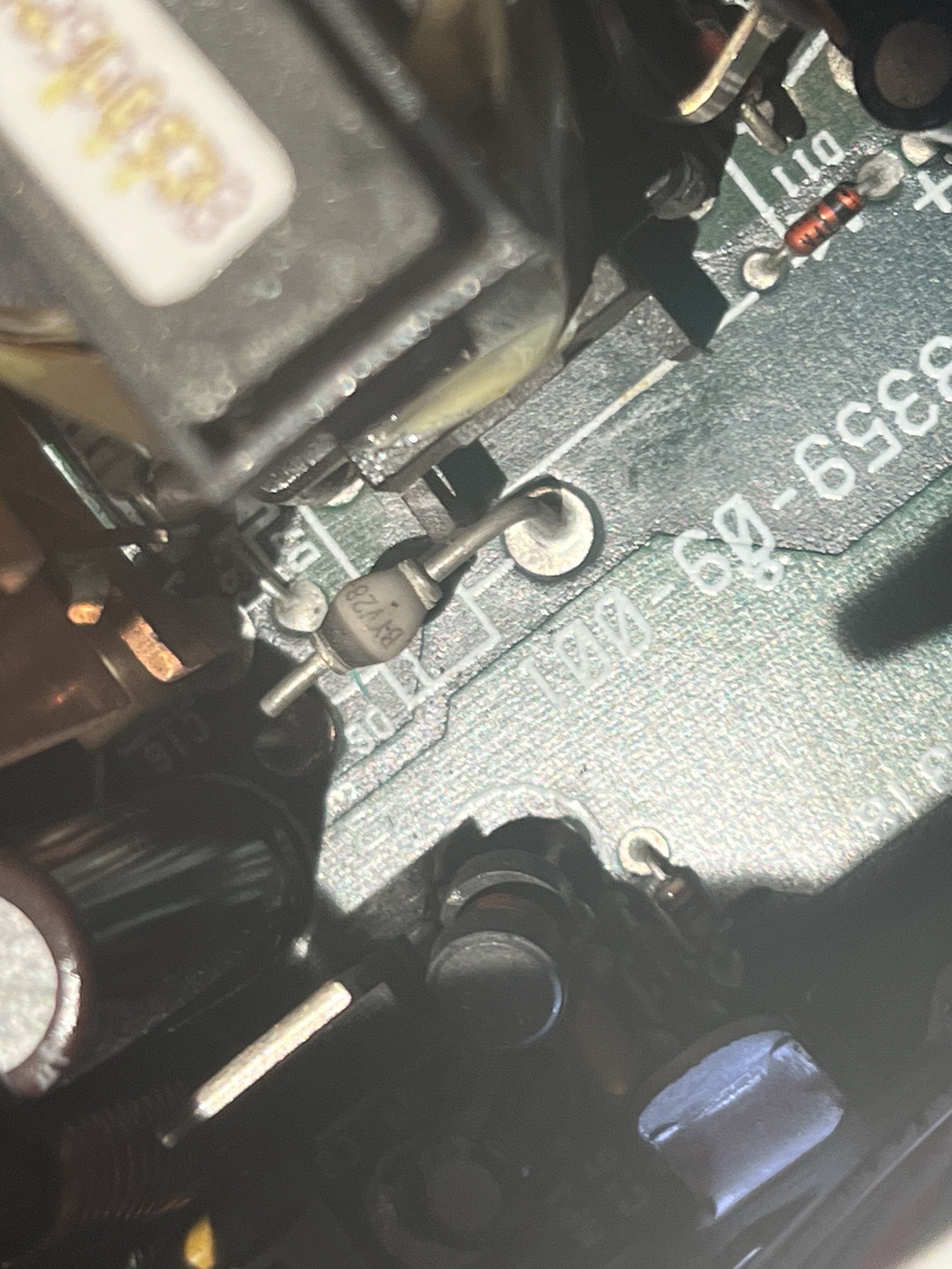

Hey there, not sure if you’re still searching for this but I’ve got my duo ps apart (2 different ones) so thought I’d post the pictures of that diode.
I can’t make out all of the numbers on it without removing it, but what I can see is BYV28-2(some more numbers but not sure)1332.
Hope that’s some sort of help.

Swapped one of these from a known working power supply onto my dead one and it did the trick! This is the only place I could find on the internet where someone has mentioned this as a failure instead of all the other posts about the caps. So well done OP sir, you’ve helped me out. And hopefully this thread helps other poor souls in the future. Just for the record my diode/rectifier (thanks for the link Kai) did not appear damaged or overheated. But it tested weird compared to the known working power supply.
