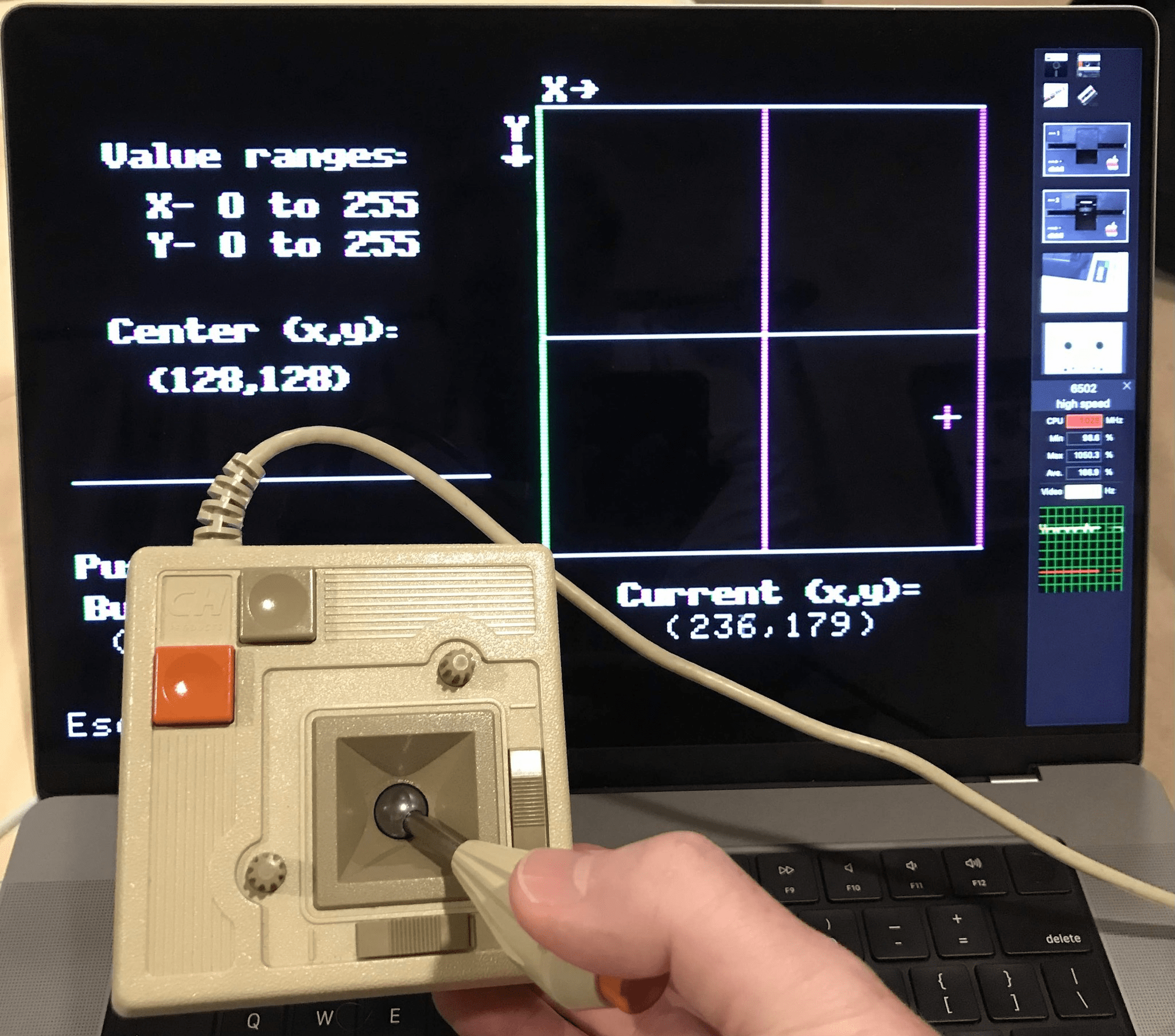

Well I took one of my two CH mach joysticks which works fine on my IIE and plugged it into the Joystick shield (original firmware, have not updated it yet).
I cannot fully get to DOWN or RIGHT (UP and LEFT will max out). If I center it, I max out toward bottom right at a far cry from max, just 197,193
Suppose I should update this firmware :/

The only one thing I never asked him is perhaps something you still can... What part of the code affects the outer reach of the stick when it's pulled right and pulled down. If we know how to fiddle with the code, then compile it, we already know how to program a HEX file, so it would then be a matter of playing with a few numbers (I guess) until the right numbers are plugged into the code to fix the problem. I suppose Henry could do that for us, but he might tire of if after a few iterations, so if he is able to instruct us how to do it, that might prove to be the best solution overall.

Download Computer Inspector and use the Joystick calibration program. It's what I use and works fine in the Virtual ][ emulator. It's better than those simplistic BASIC programs which only show the two numbers.
