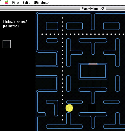

Apr 22 update
1) new Window menu item: DeveloperView toggle
2) no longer redrawing entire screen for every frame. Now in the offscreen PixMap we draw the entire frame once (startup, window size switching, & updates) and then only draw moving rects (previous location and new location) in subsequent frames. Then we transfer the whole image over to the gameWindow using CopyBits
3) we have the first row and column of pellets so that I can start to figure out spacing, collisions with, and variable storage of all the pellets
4) we have Pacman movement and animation frames. Current keys are: W,A,S,D and/or I,J,K,L
5) no walls or paths yet. He continuously moves but bounces off game borders.
6) we have pellet collision testing and erasure

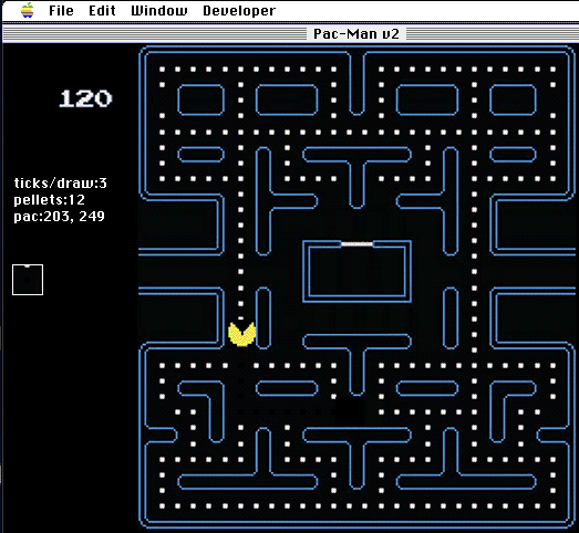

Apr 27 Major Update!
1) we have pellets. I decided to use a bitmap-style variable "matrix" to create where to draw pellets
2) we have walls. I copied the pellets "matrix" idea for the walls
3) we have collisions. I use the "matrix" to generate Rects and use these Rects inside SectRect() to test against the PacMan Rect
4) we have 30 new images, all for the custom scoring "digits", and the score is displayed using those instead of Text/Str255
5) the new Developer menu allows you to turn on/off behind the screens data that can be helpful and/or interesting
6) again, all of this is is implemented using 3 different screen sizes. A bit overkill but nice to have bigger & color when it's available
It feels like a lot of the hardest parts are implemented!
What is left?
Power pellets
Escape routes (vertically centered paths that wrap-around to the other side)
High Score
Custom controls
Sound
Monsters & their A.I. paths
Fruit / Levels
Cut scenes
Initial demo
Start/Abort game controls
