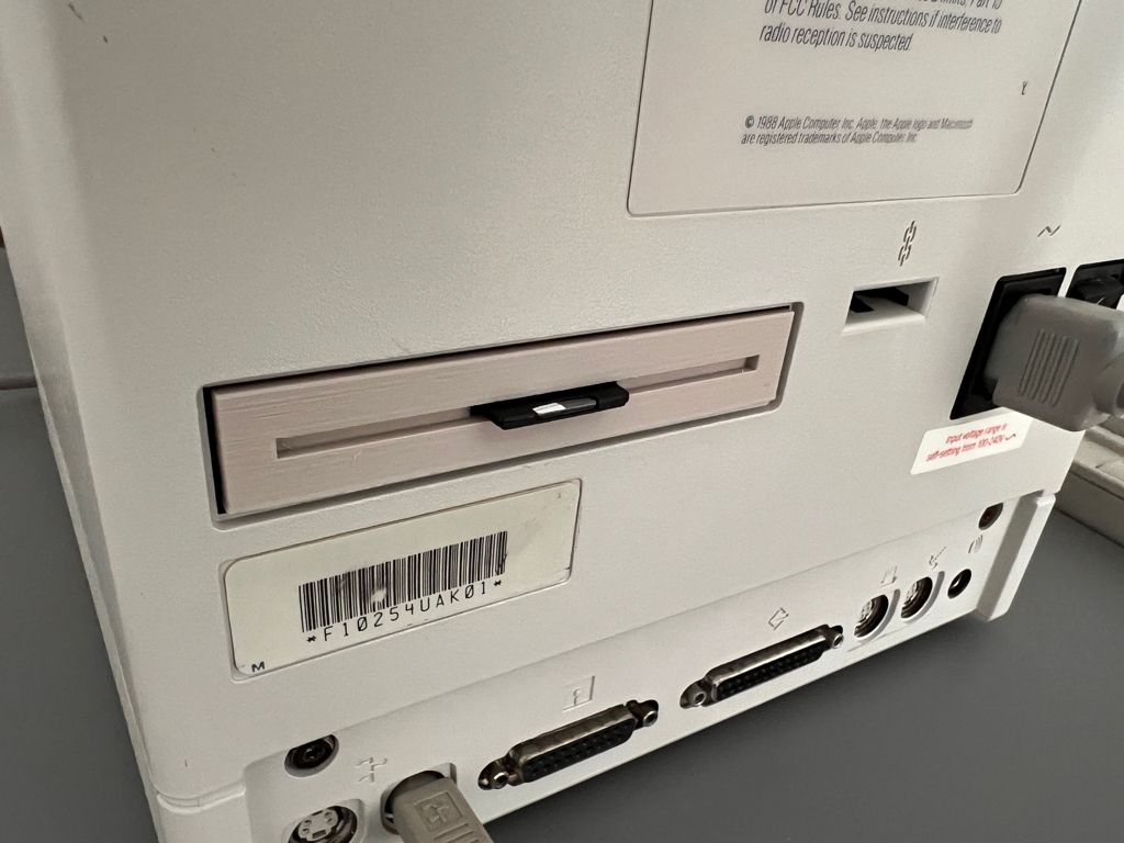

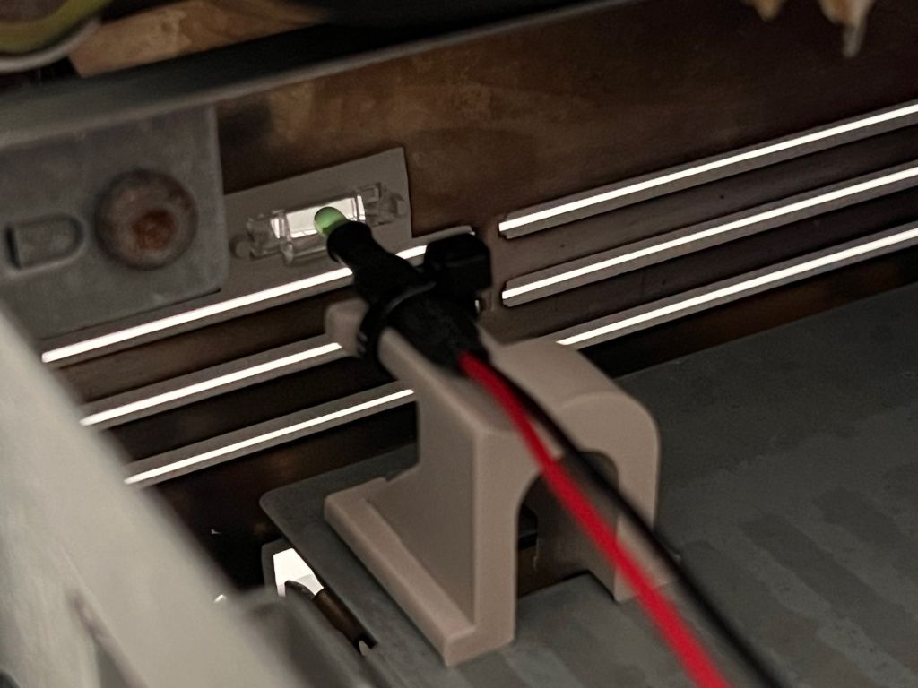

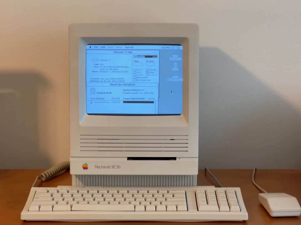

I've finished my amateur restoration of my computer by riding on the shoulders of everyone here. I've upgraded the RAM, serviced the floppy drive, replaced the innards of the power supply, replaced the fan, replaced the hard drive with BlueSCSI, and installed the CR2032 batter module to avoid future battery problems. The only assembly catastrophe I caused was I hamfistedly popped off a microscopic board component from Garrett's replacement ROM when I was trying to slide on the reinforcing brackets. So I reverted to the original ROM for now.
Like @JDW mentions above, I used @Ron's Computer Videos excellent Ultimate 7.1 disk image for my BlueSCSI but I did include WindowShade and removed the Appearance stuff. I like the super old school 2-D black and white interface for this computer.
After soldering in the fan and PSU, following JDW's videos, I can't begin to express how grateful I am that people like Thomas are available to resolder and inspect the logic and analog boards. I was sweating bullets on the simple solders I did and they are, shall we say, non-photogenic.
And everything works. The computer is quiet and fast. The speaker beeps and plays other sounds. The floppy drive reads the few floppies I have hanging around from my college days. I can transfer data with the fantastic BlueSCSI toolbox, and with that I can make it do anything I could ever expect from a 35 year old computer.
The only things I contributed to the build are a small clip to hold the BlueSCSI LED by the front cover's drive light indicator and a BlueSCSI mounting tray that attaches in the expansion slot opening. The filament color isn't a great match but it will have to do for now until I can find something closer. The clips works well, snapping into a slot left by the removal of the hard drive tray, and the LED lights up just like the original. The mount screws through the expansion opening bracket and stays with the computer when the rear cover is removed. I added a horizontal slot to mimic the lines on the front of the machine.
