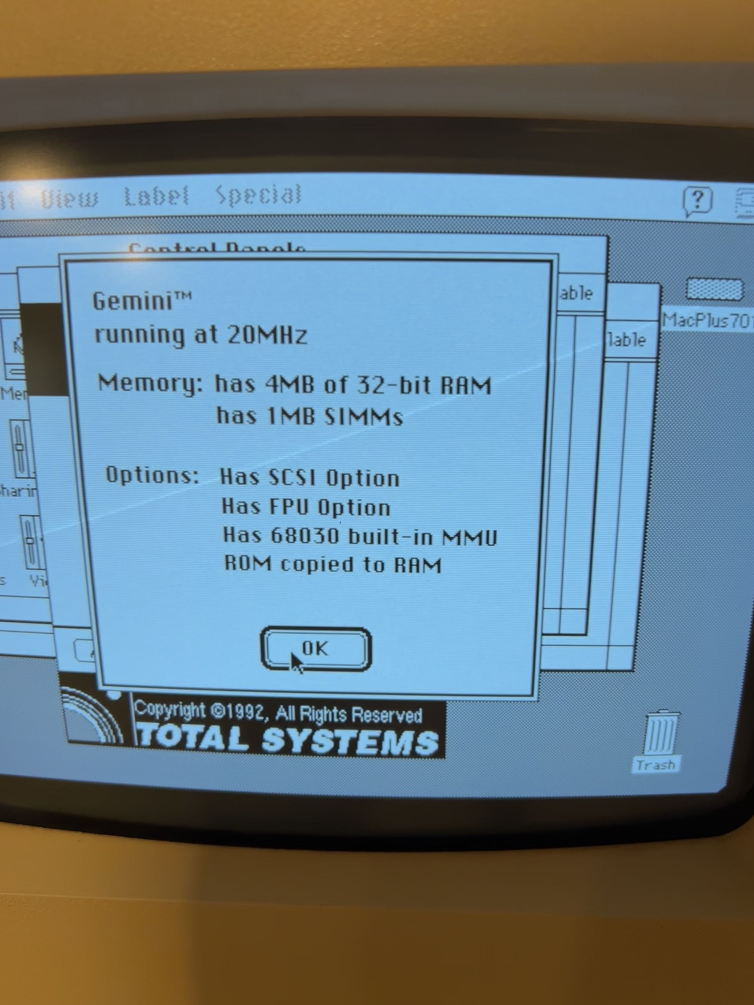

Update: I must have gotten mixed up when I was switching CRTs, analog, and logic boards. It does appear my issue is with the analog board that cam with the plus. I was able to confirm with a good logic board that the symptom remained (startup chime with no image on the CRT). I removed the accelerator board and the logic board is in good shape - the Nichicon caps don't appear to have leaked, but I'll consider replacing them since they're hidden under the accelerator board. So, after confirming the analog board as the issue, I grabbed a working one from my upgraded 512k and put it in, first with the accelerator removed - it booted up and an image appeared. I then threw the accelerator back on, reconnected the IC hooks to the new analog board, and crossed my fingers. Fortunately, it booted up fine to the question mark disk. I made a 7.0.1 image with the Gemstart extension added (the accerlator driver) and it booted up. I got the accelerator extension loaded (its icon gets wheels and then it races across the bottom of the screen). When I went into the Gemstart control panel, it shows the 20MHz 68030 as loaded, recognizes that the SCSI port is connected (I used the SCSI port on the accelerator to plug in my BlueSCSI because it's faster and provides term power), and has the option for an FPU. I might see if I can get one, although I don't use any apps that would take advantage of it.
So, I now have a working Plus with an 030 accelerator, 4MB RAM, and faster SCSI, but no analog board for my 512k (upgraded to a 1MB Plus).

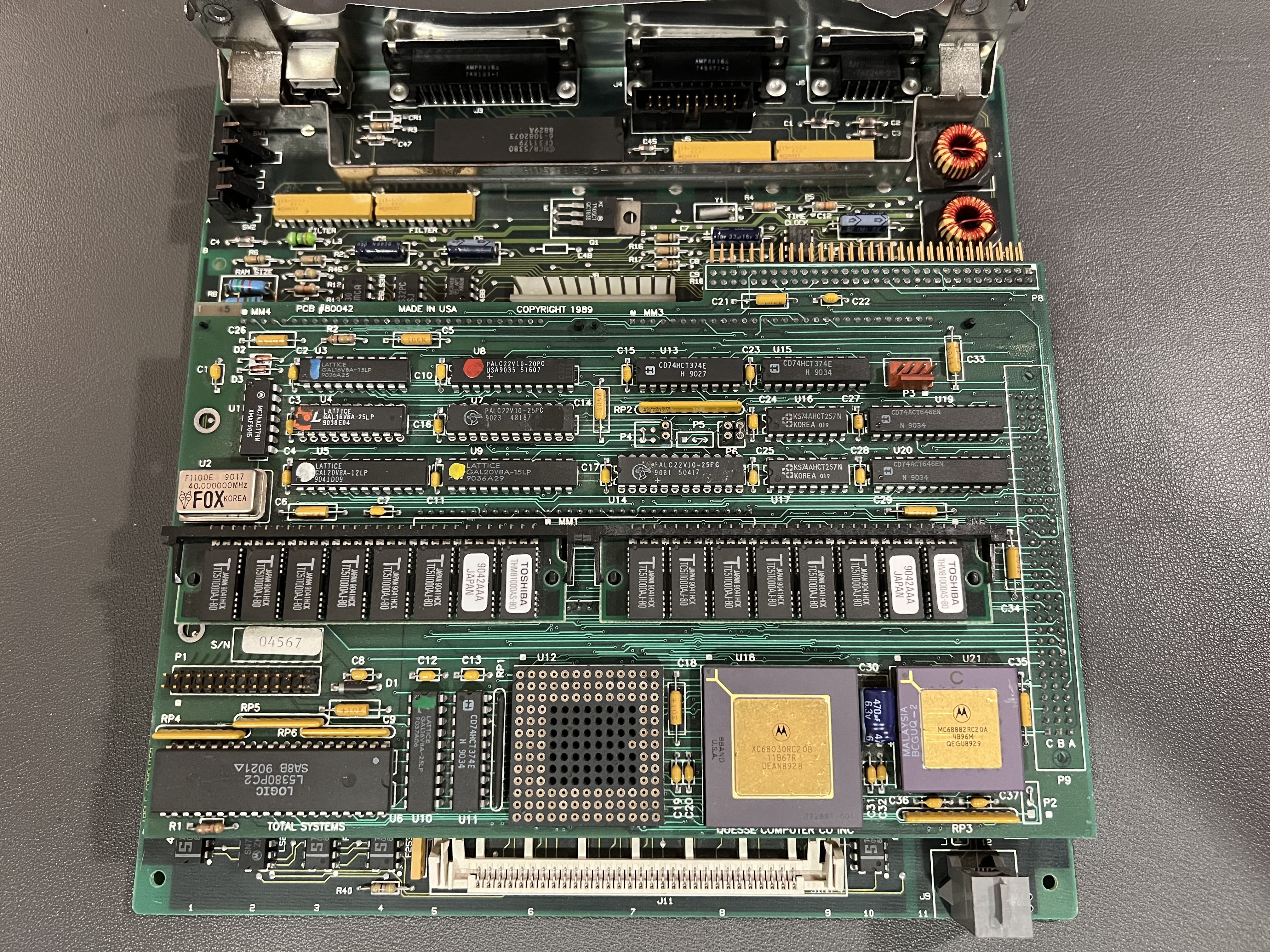

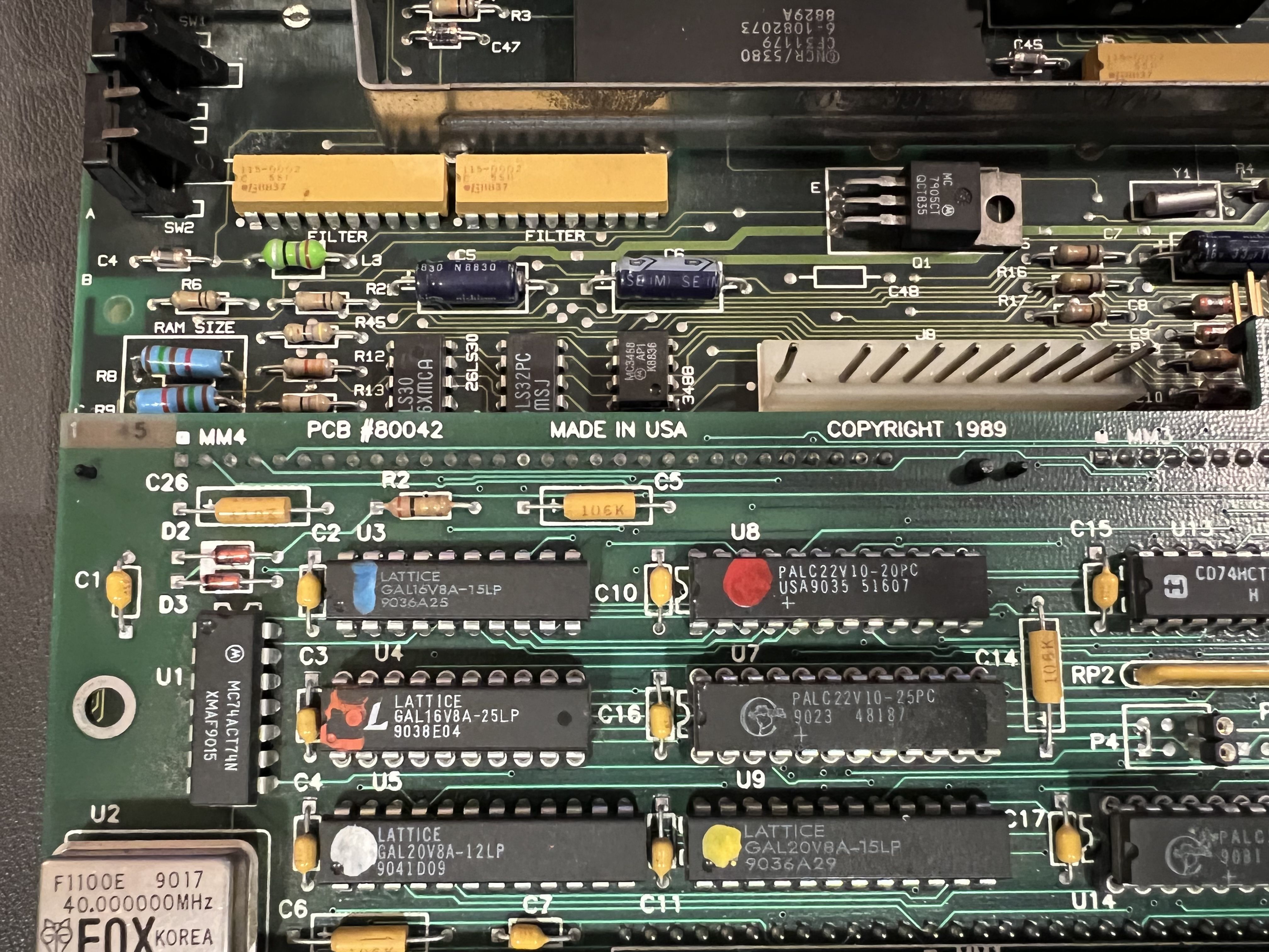

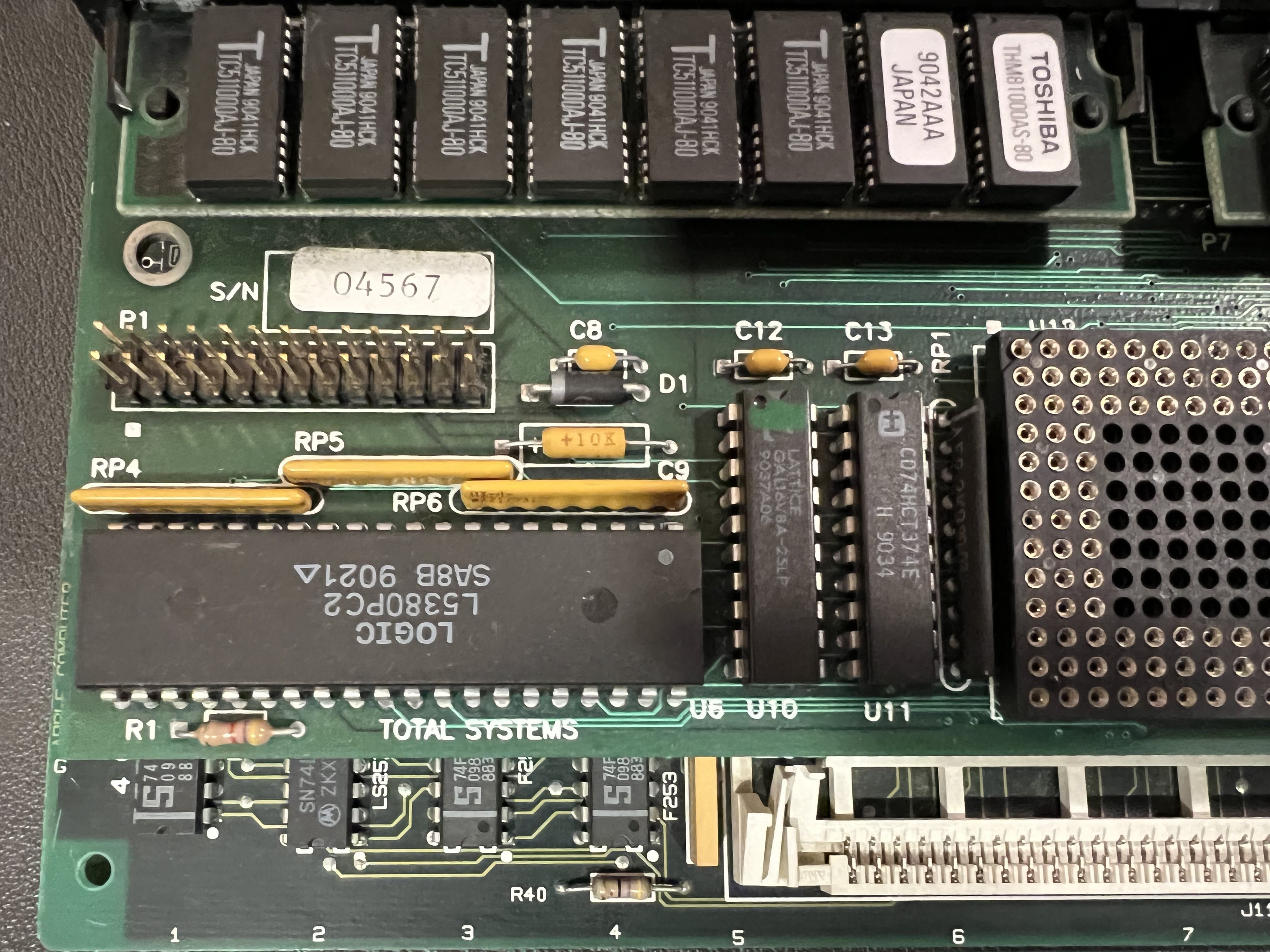

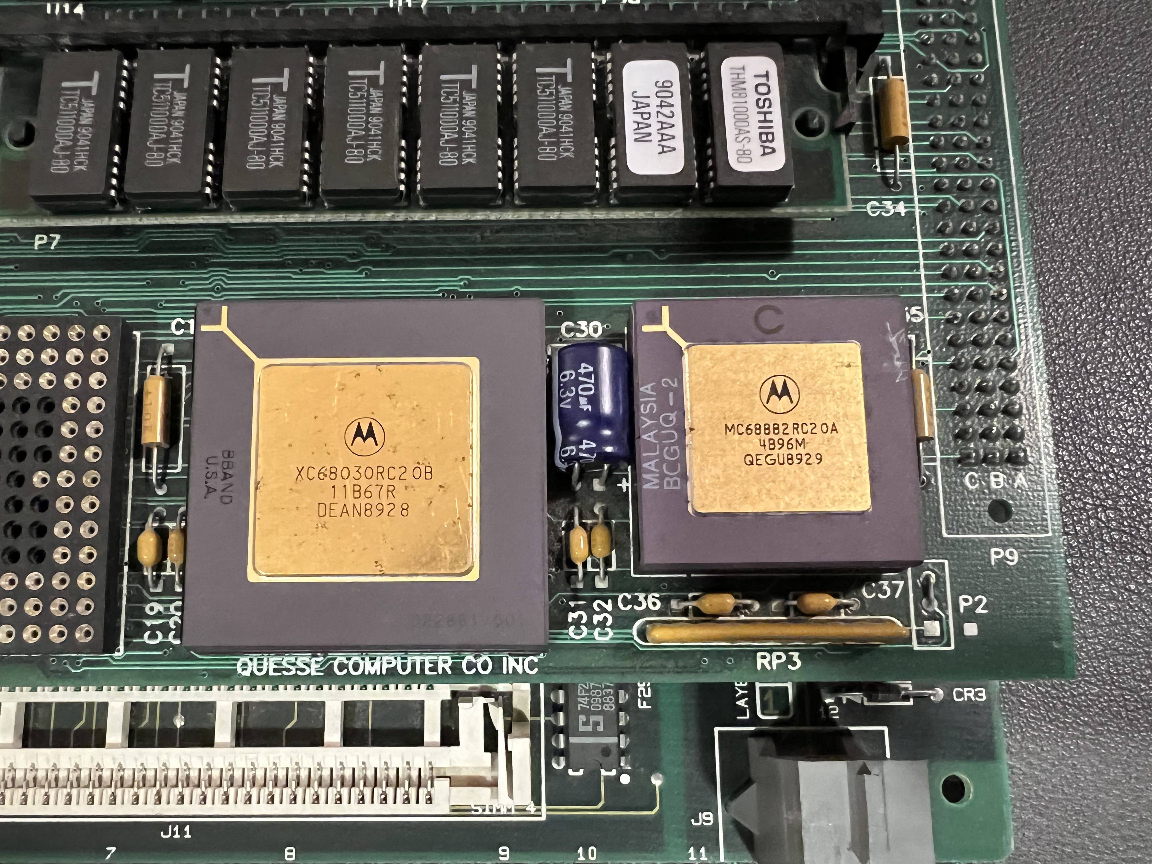

Also, here’s a few pictures of the Total Systems Gemini II 20Mhz accelerator board on the Plus logic board, for anyone curious. Later, I’ll also take a few photos of the correct pins for the IC hooks that attach to the analog board.

Also, anyone know what the empty U12 socket would be used for? It almost looks like a second CPU socket.
I would guess for a 68020. There were quite a few Mac upgrades that had options for either a 68020 or 68030 to fit different price points. It's cheaper for them to make a board to support both CPUs and just fill out whatever CPU they want for what model.
I have a LC/LCII/CC upgrade board with a 68030@25 MHz on it, but it also has pads for a 68020 and a different GAL for the slightly different equations required.
Reactions: wottle
Ah, that makes sense. Build one PCB that could be used for both 020 and 030 accelerators. Having PCBs manufactured was probably a lot more costly to create the tooling, so for lower volume, making a board that served both purposes would probably save money.
