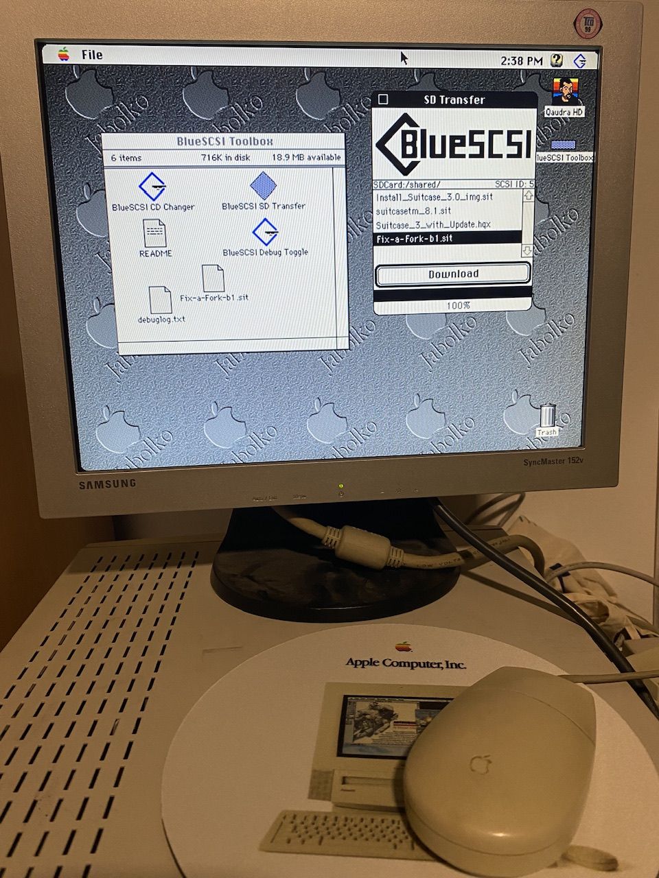

Ok, looks like its updated now but Toolbox apps do not work. Tried updating DB25 also. Same problems no compatible SCSI bus ...
Testing machines Quadra 650 and G3-266.
Bluescsi CD changer works but looks for CD files on ID3 even there is CD6 directory on SD card. The Quadra have a real SCSI CD drive installed on id 3.
Just pushed an update to the eric/toolbox branch of v1 - did a very quick test (heading out the door) but SD transfer seemed to work fine.
Please note v1 does not have any of the CD switching code in firmware yet so only the SD transfer utility will work with it.
It will depend - if you have or have flashed the USB bootloader, use USB. If not use an STLink. You can tell if you've got a USB bootloader by looking at the log.txt and the version having a -USB at the end.
Transfer works now :) thx
