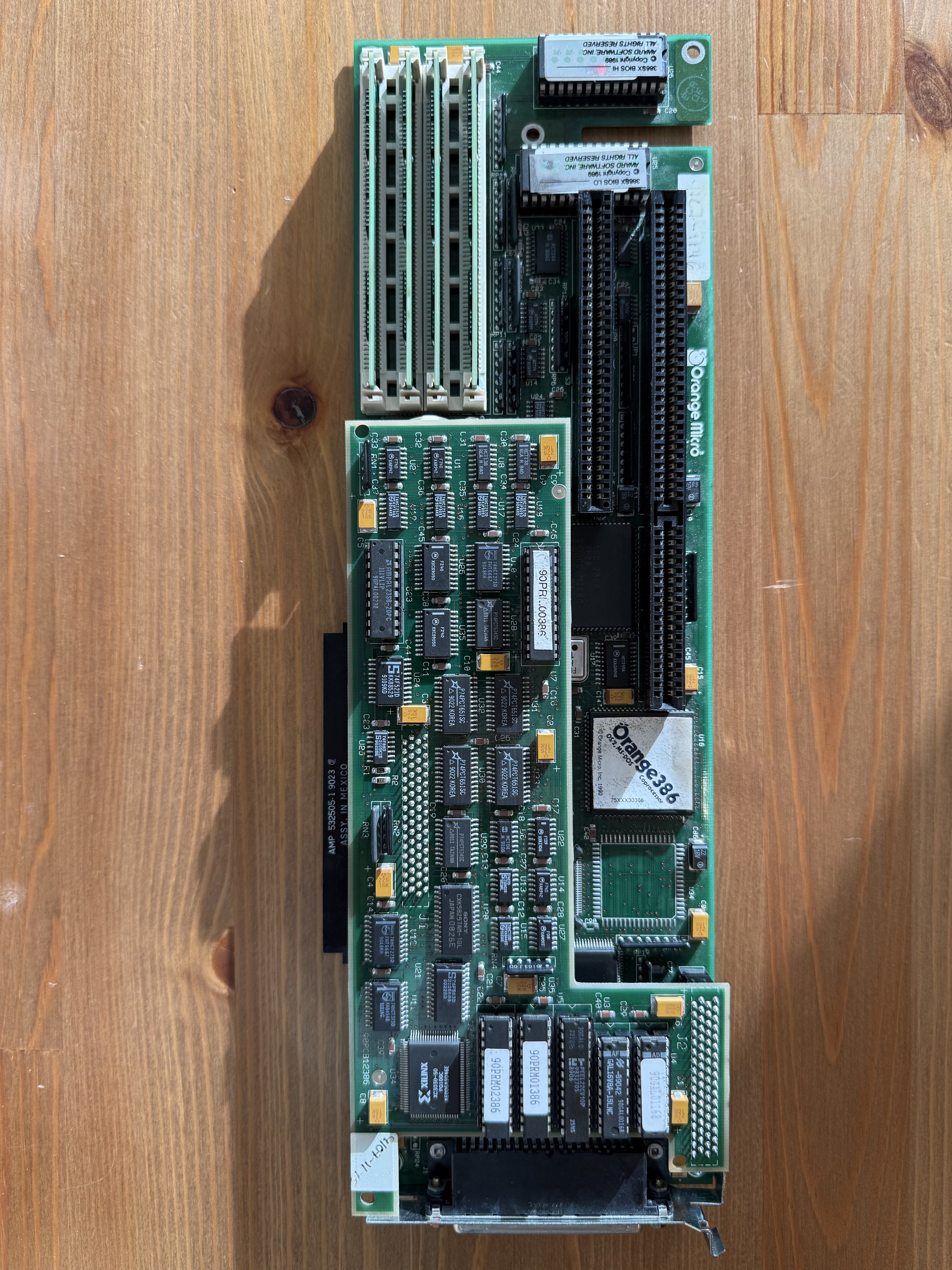

Hi folks,

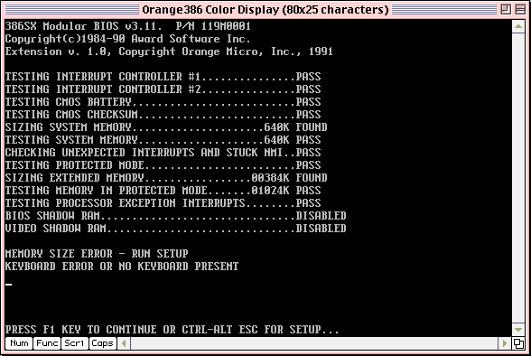

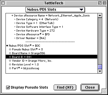

This week I received another DOS on Mac card -- Orange386. I decided not to mix it with another topic that I opened earlier, because this card and software seem completely different.

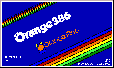

For tests, I installed it in Q950. At first, I couldn't use it because I used the wrong software. OrangePC of any version does not work with this card.

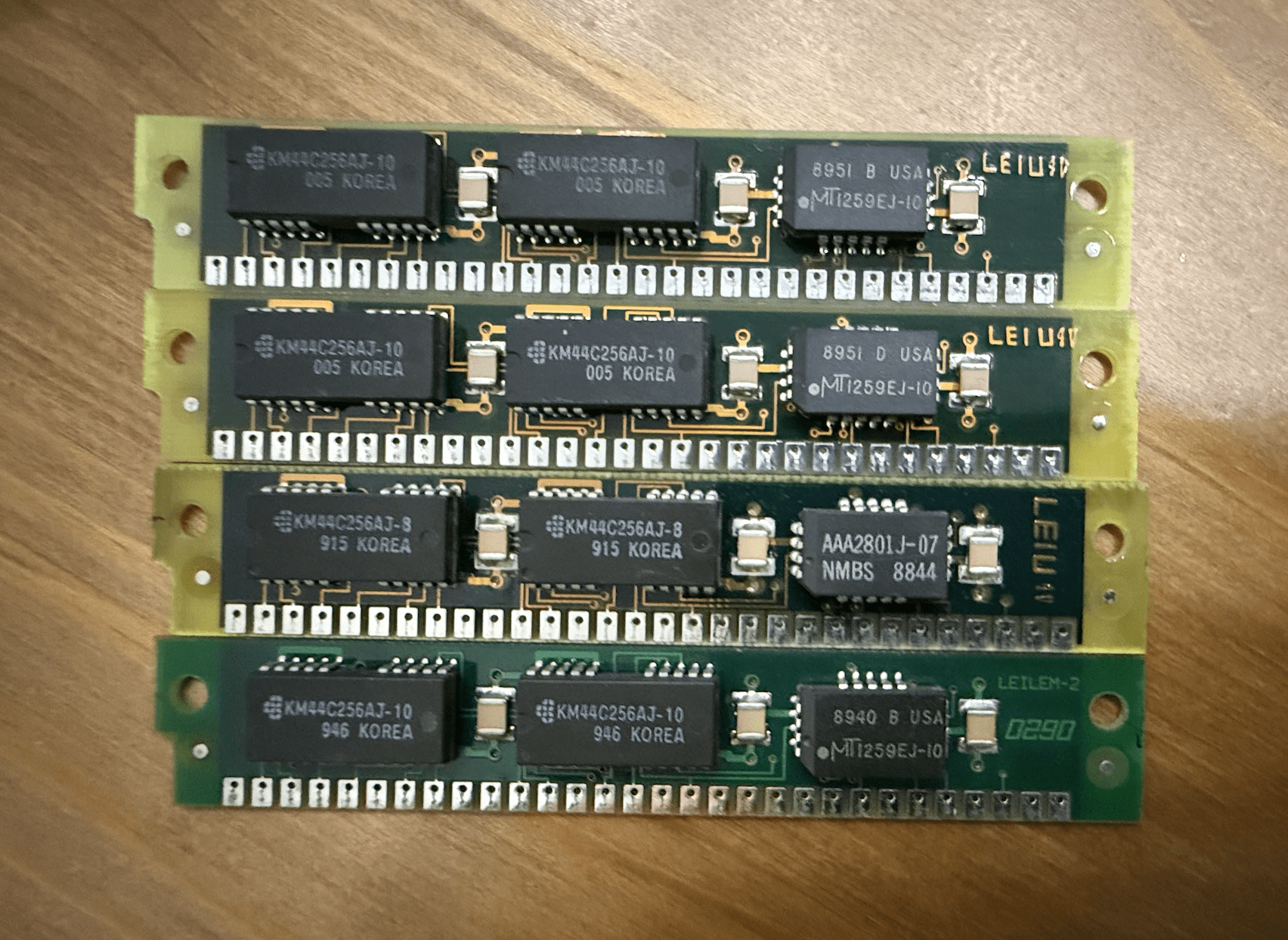

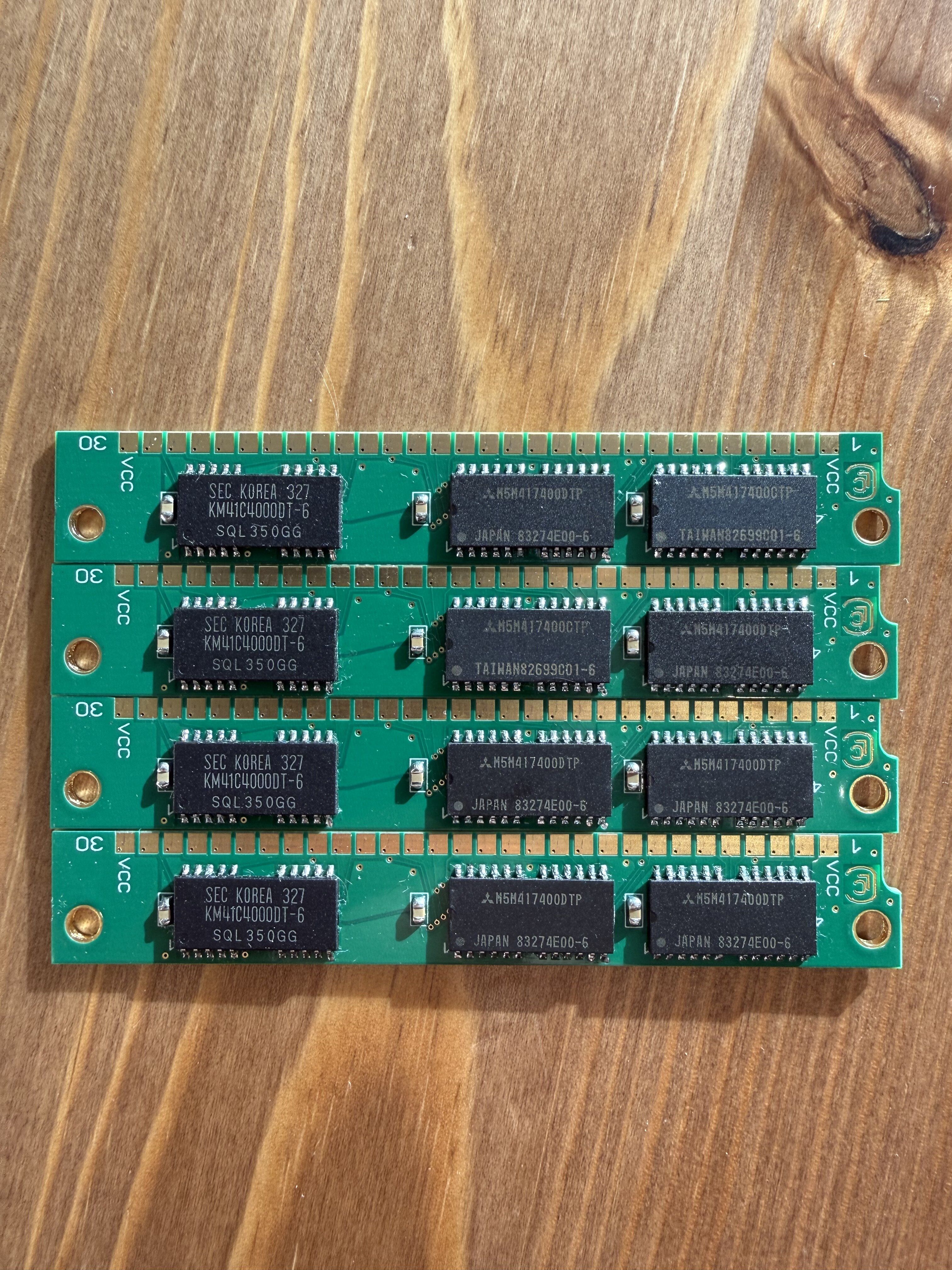

Who knows what memory can be installed here and what is the maximum capacity supported?
I tried to put the memory that once worked in Q950, but the card does not initialize, I suspect that it does not fit.

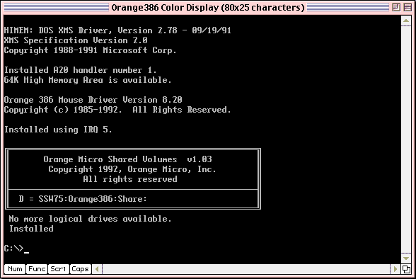

Are there newer versions of the application, drivers, firmware/BIOS? Comic situation, after installing MS-DOS 6.22, the shared directory driver displays only files, directories are not displayed. It seems that due to the small amount of memory, you can forget about attempts to unpack archives with retro7zip.

I found an interesting page here.
There is also a brochure here. I'll probably leave it here as a picture, in case the resource disappears.

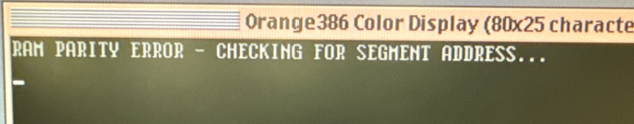

It becomes clear that it supports up to 16 MB of RAM, and it seems that parity memory is needed. I tried to install 2 bars with which it boot and 2 with which it does not boot. Received the message "RAM PARITY ERROR".

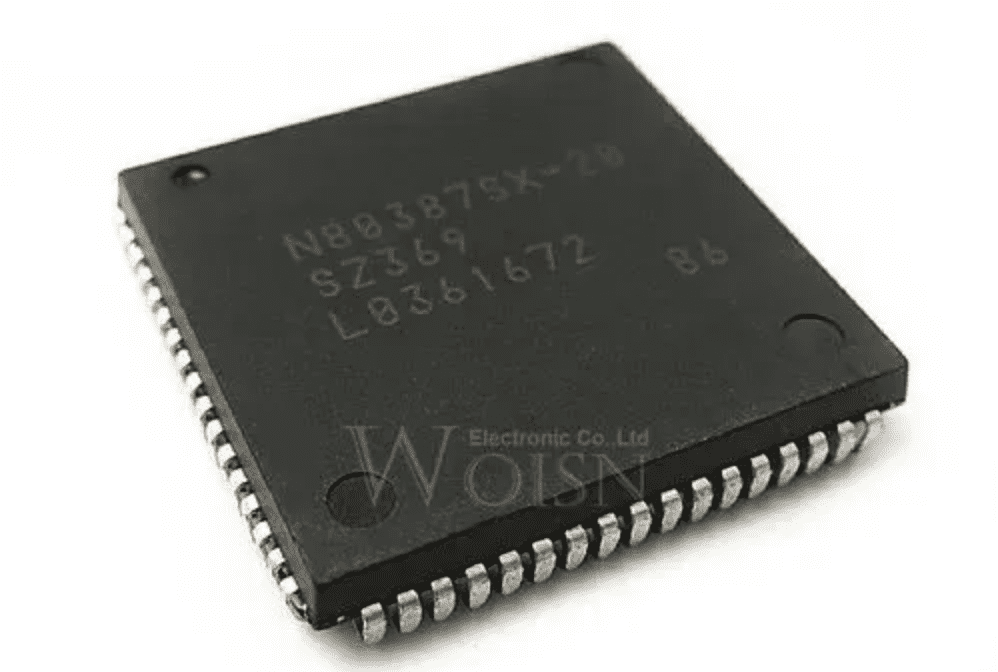

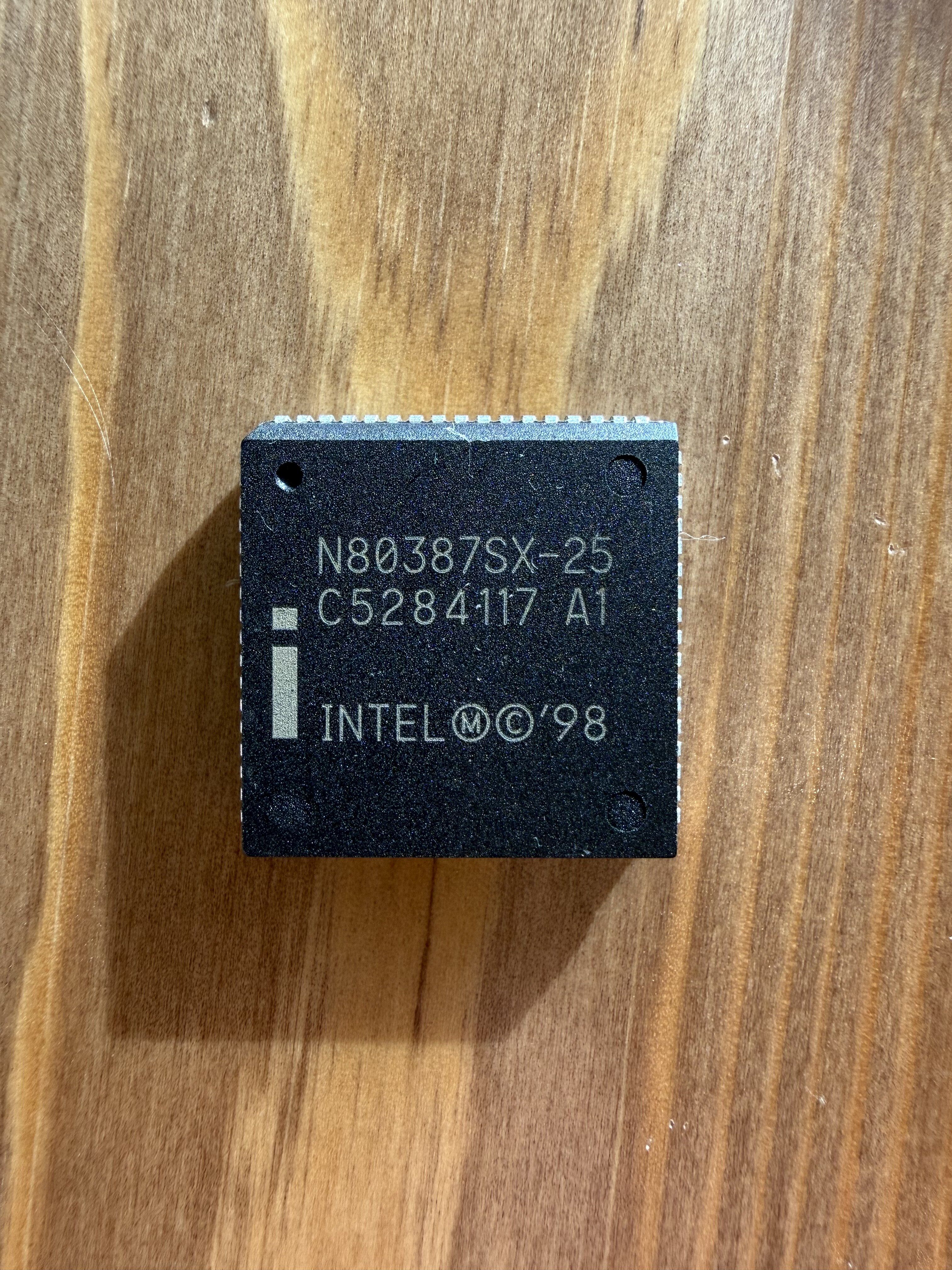

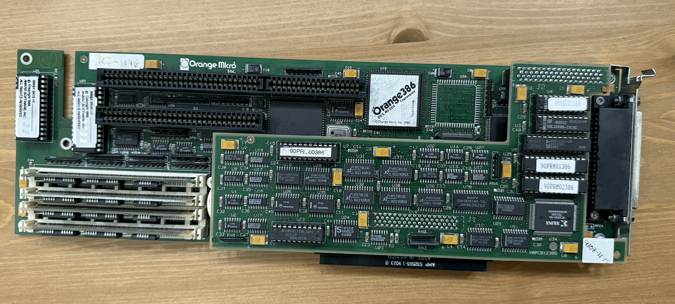

It's funny, this brochure says that the 80387SX math coprocessor can be installed on this card.

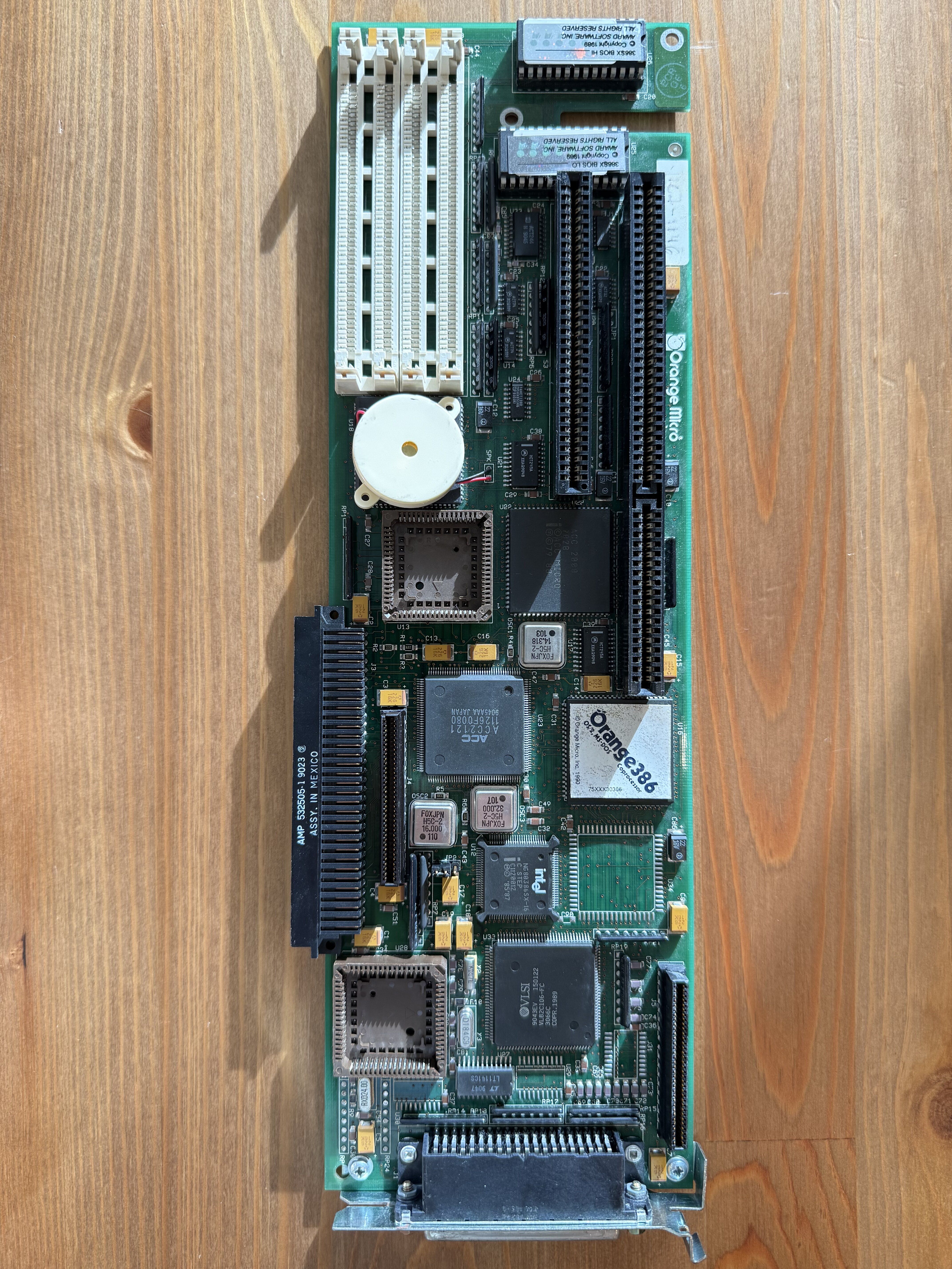

I looked on the Internet, you can buy it not too expensive at all. Has anyone done it? If you look at this picture, the coprocessor is installed next to the processor. But there is no socket on my card. But under the second layer of the card, there are 2 sockets, I can't remove it yet, apparently it "boiled".

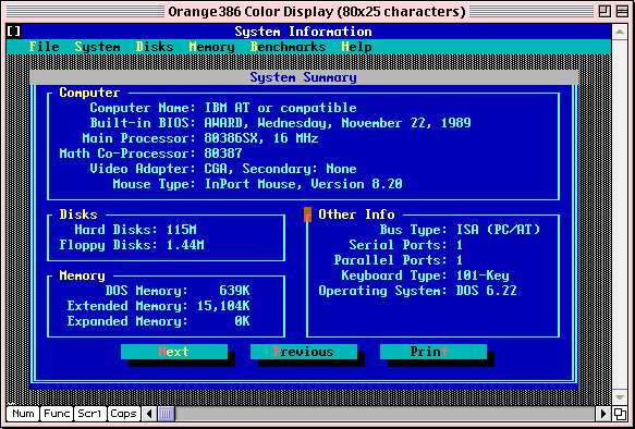

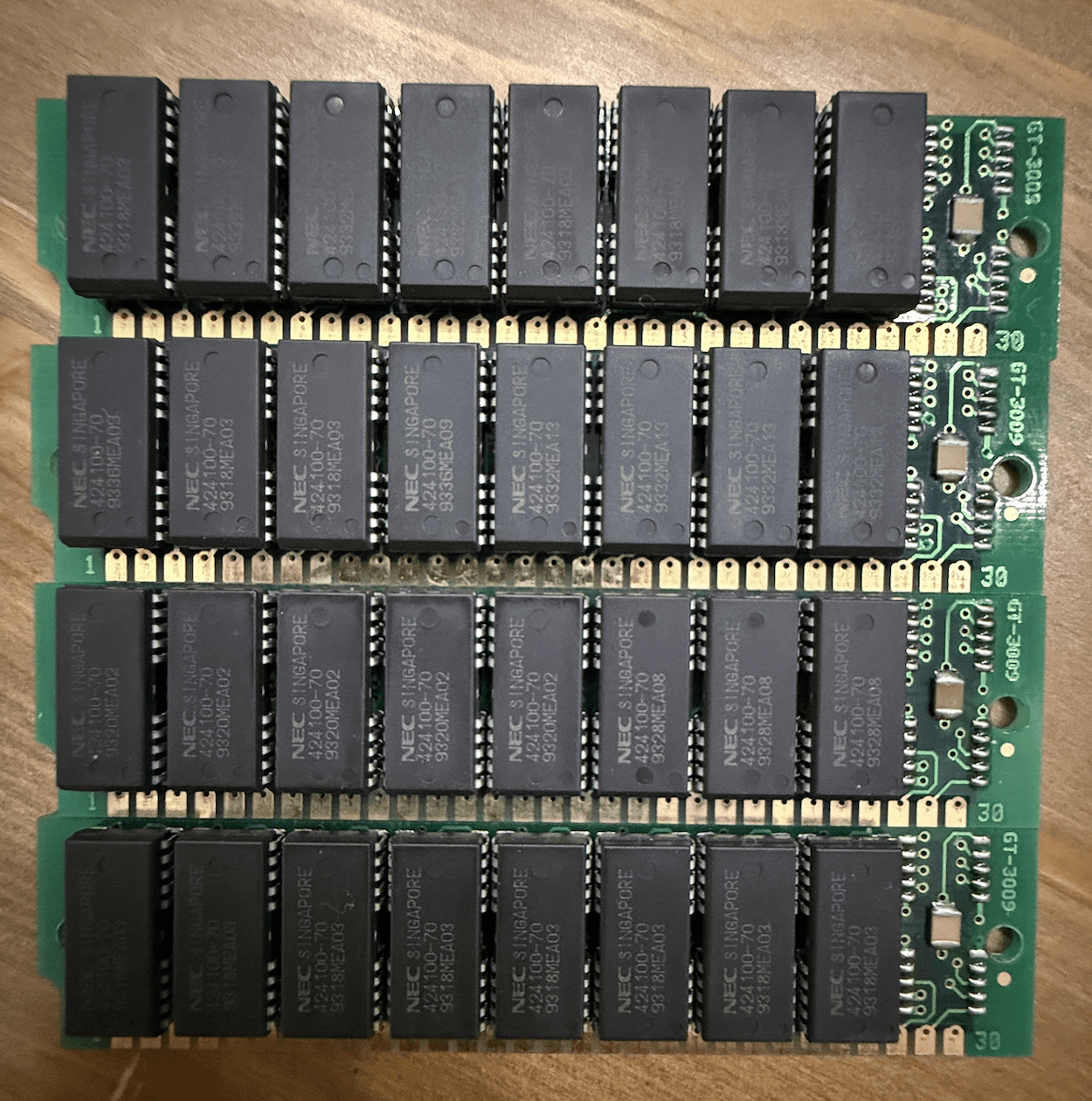

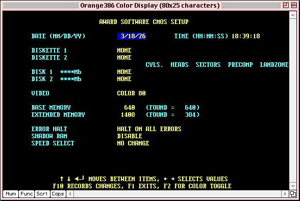

I received a 16 MB parity RAM kit, and it worked right away.
Just as it turned out, in order to save the BIOS settings, you need to set the date to 2000.
I have a Network Time control panel applet installed in Quadra, which can set the current date and time in System Software or Mac OS. The application reads the system date and sets it in CMOS. Until I manually set 92 year, the settings were not saved. At what new launch of the application did you have to configure the BIOS again and again.
Actually, now I was able to run games, but only those that can work in CGA mode work, otherwise there will be a "black DOS screen".
It remains to get a coprocessor for full authenticity of 386, in games, of course, it will be useless. :)
Who can tell me if it is possible to install a coprocessor 20 or 25 if the processor has only 16 MHz?

Yep, you can always install a faster 80387, it downclocks to meet what signal it is getting.
Reactions: V.Yakob
It worked!
16 MB of RAM and a math coprocessor 80387SX-25 are installed.

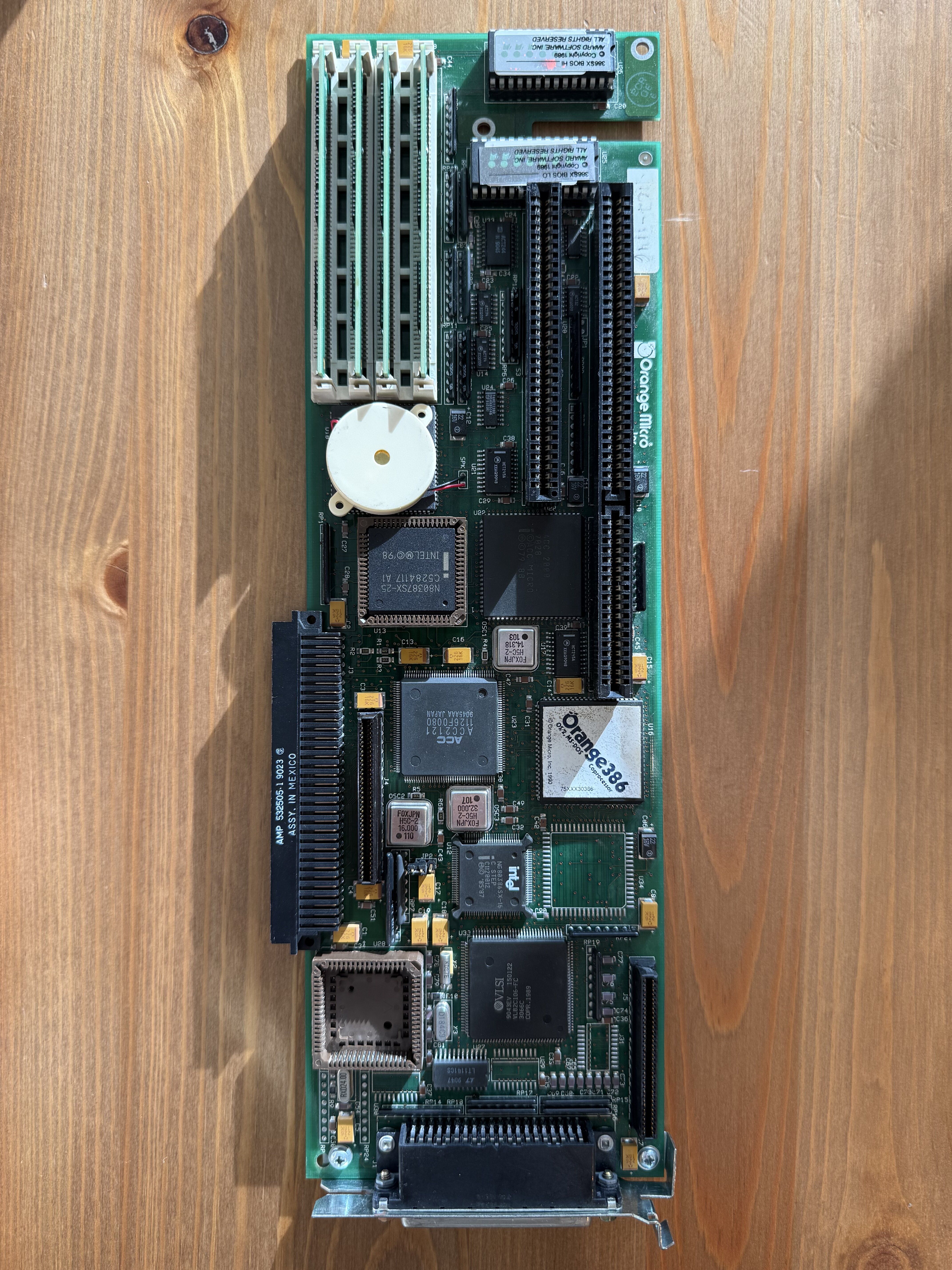

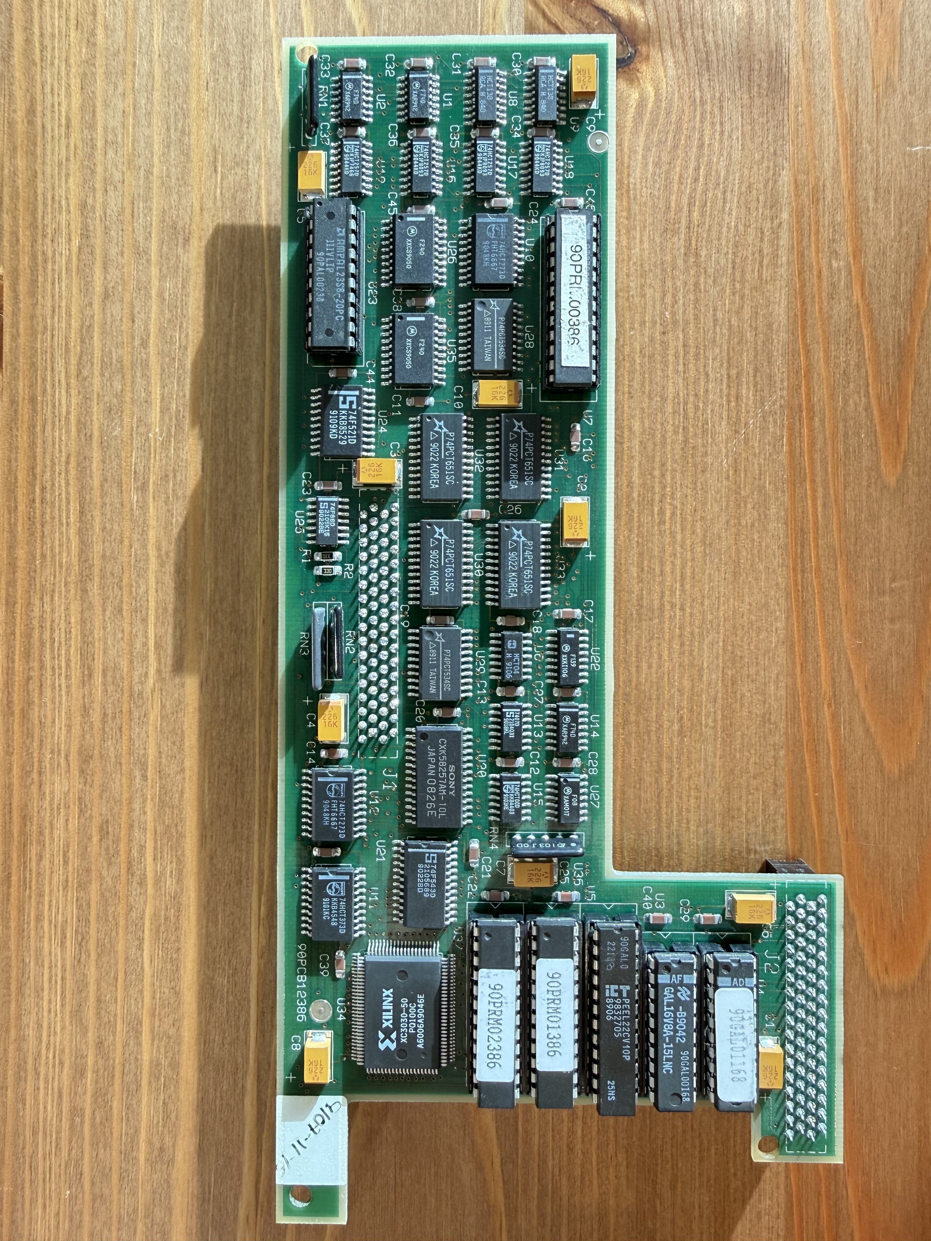

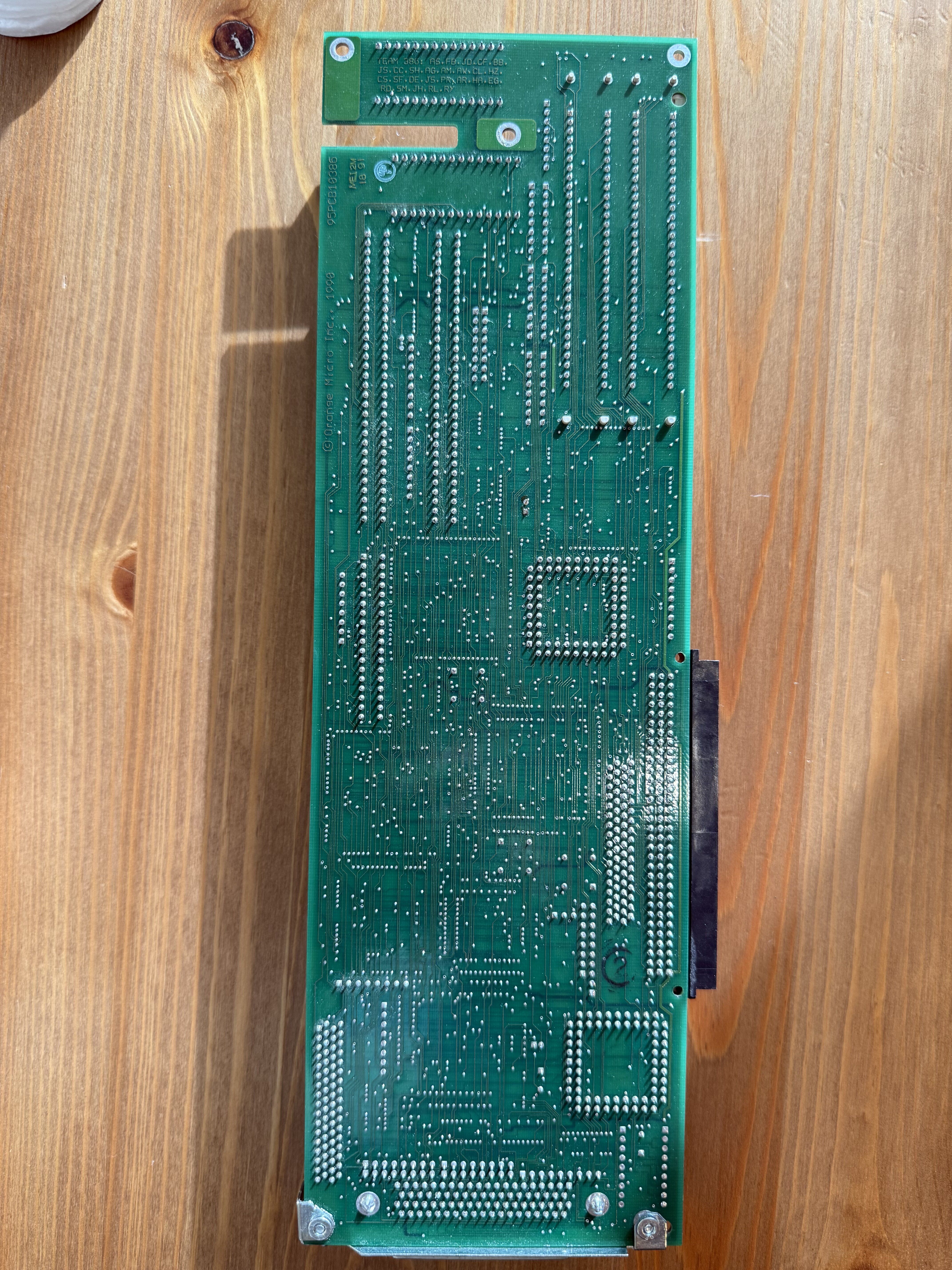

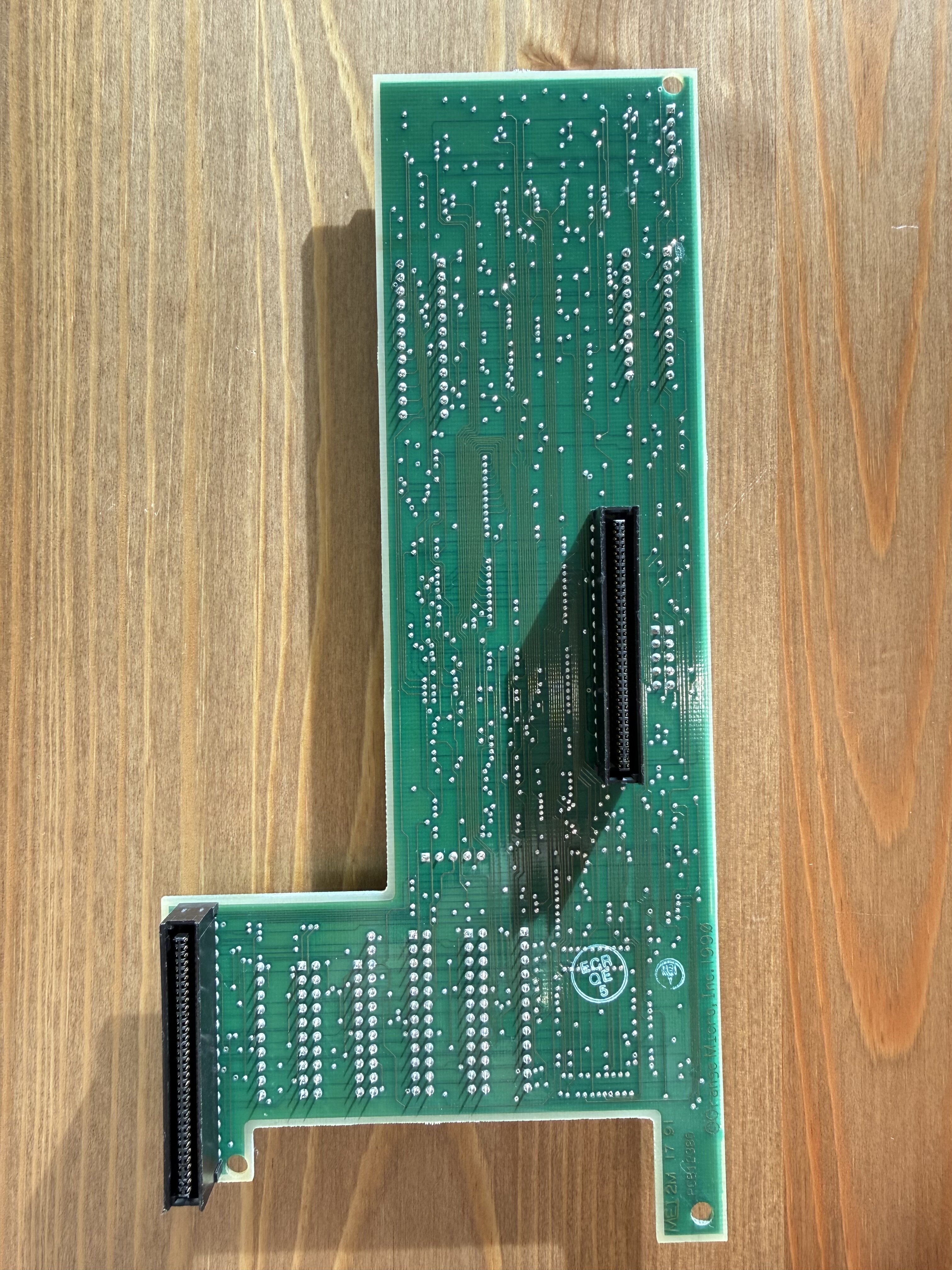

Since I managed to disconnect the board, I took a few pictures. Maybe it will be useful to someone.

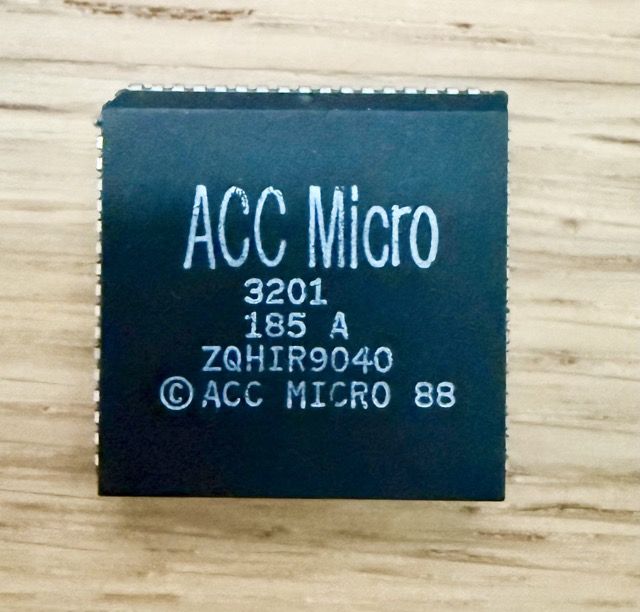

Found the last missing Floppy controller -- ACC Micro 3201.
I don't know how to check whether it works or not. Perhaps the only way is to assemble the cable for connection from Floppy.
Has anyone had a successful connection experience?
