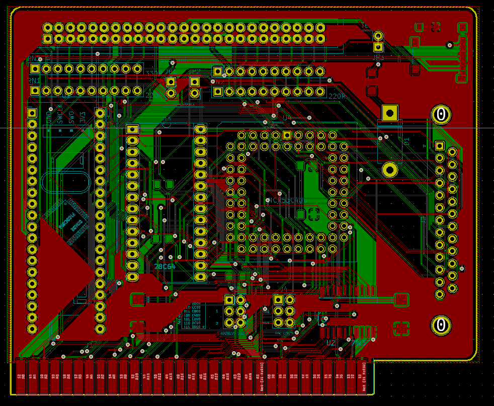

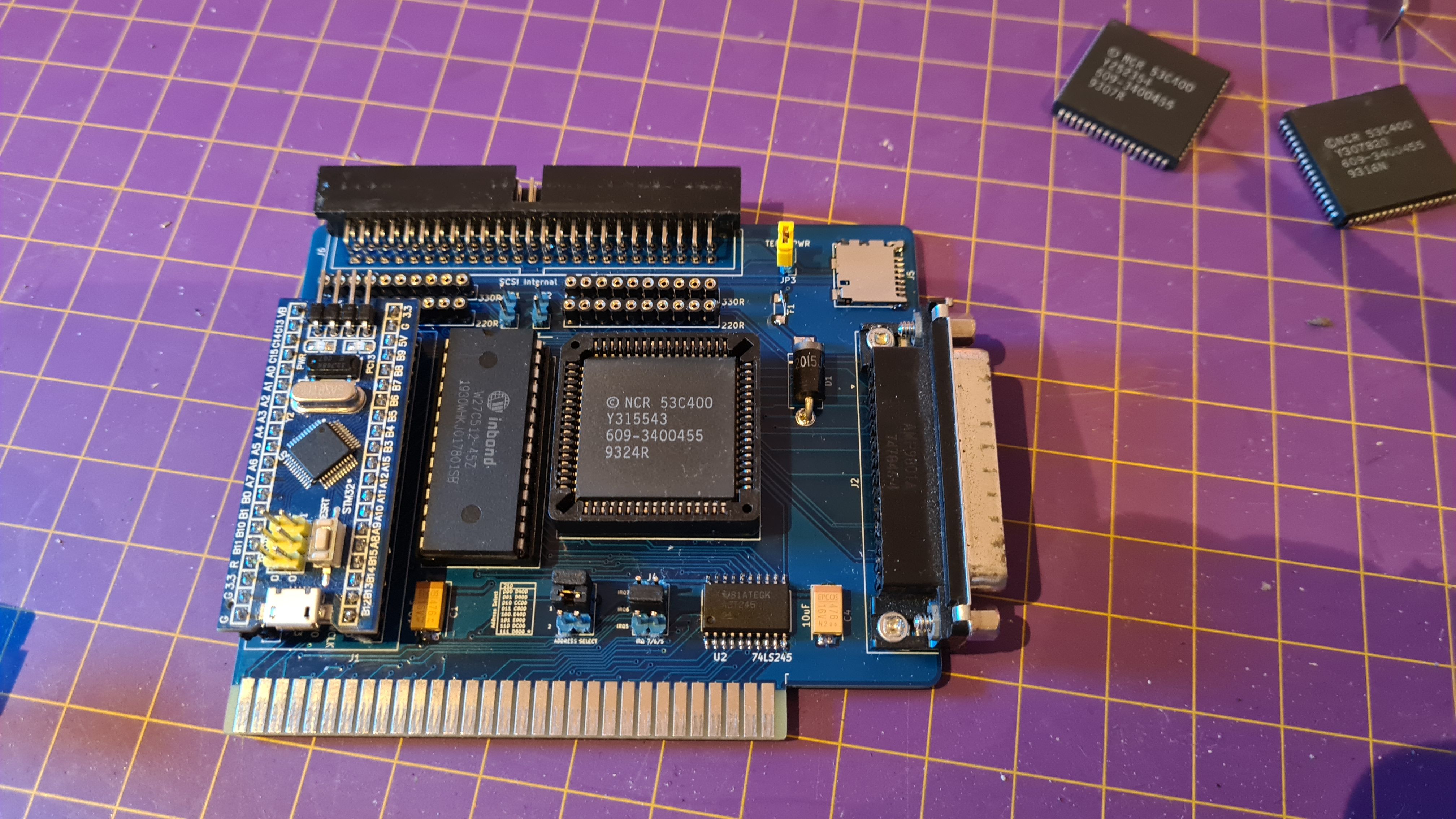

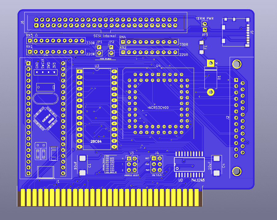

This was a little personal experiement to see if I could combine the usefulness of BlueSCSI and its HD images with the PC , and have similar HD image capability with old PCs. In the PDF of the NCR 53C400 technical document there was a rough outline for a memory mapped SCSI card that was popular in the XT PC days. I though this would be a nice jumpting off point to see if this could be done. Even keeping in mind that BlueSCSI may not work with the NCR 53C400 it would still be a cool experiment. While obsolete the 53C400 can still be got from surplus suppliers and I got a few before I started.

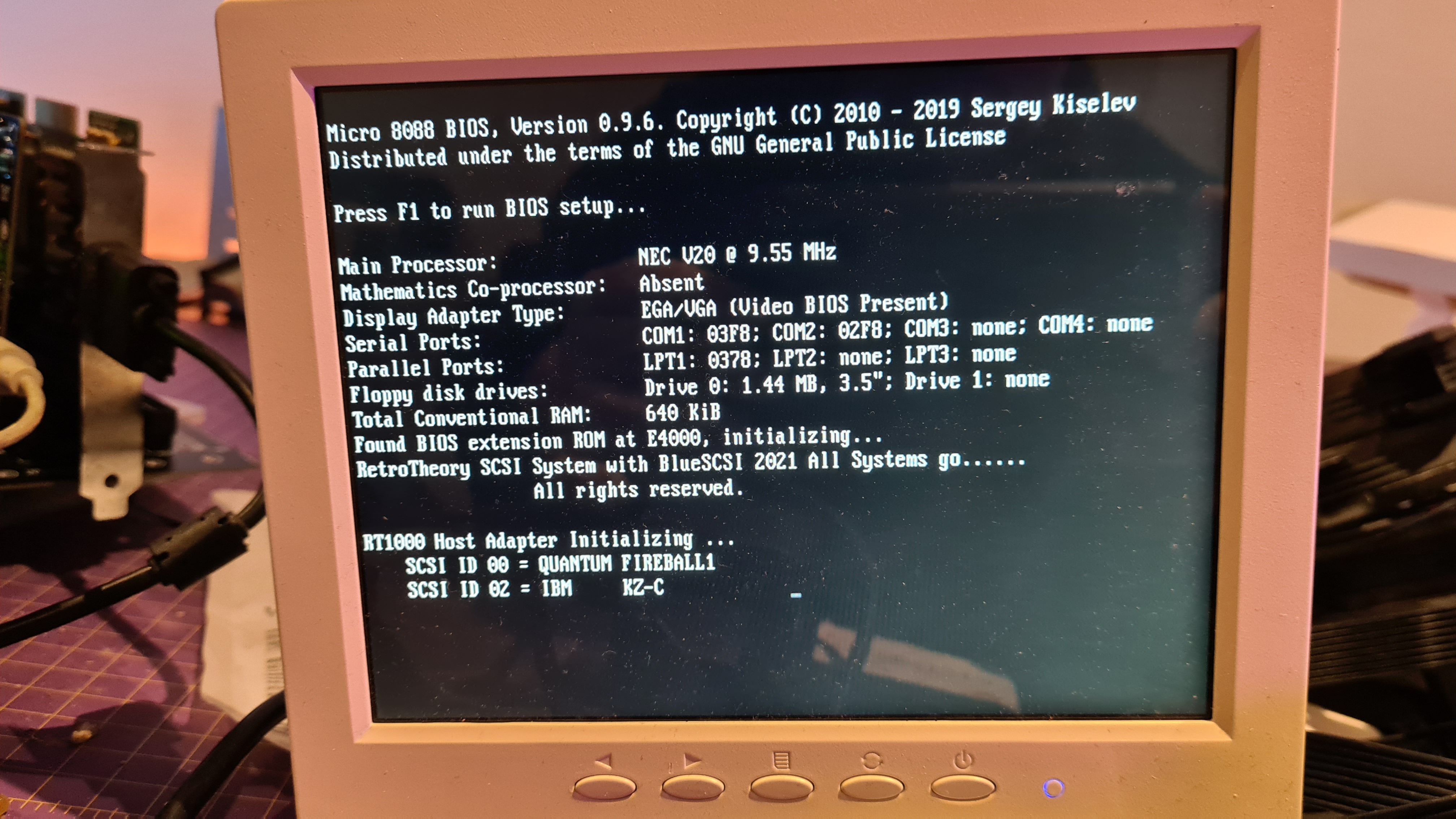

The SCSI BIOS is just a cosmetically modifed existing BIOS from other similar memory mapped NCR53C400 cards.

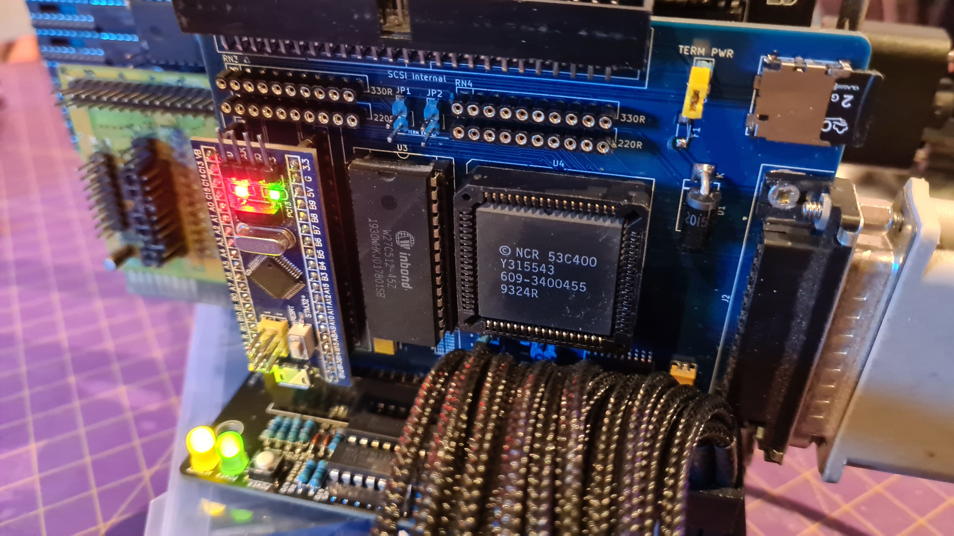

Results are mixed, it boots real drives fine but my fears were realised with the blueSCSI , while it formats and I can use the drive, on reboot the STM32 hangs with both lights on when attempting to boot. More investigation is required.
