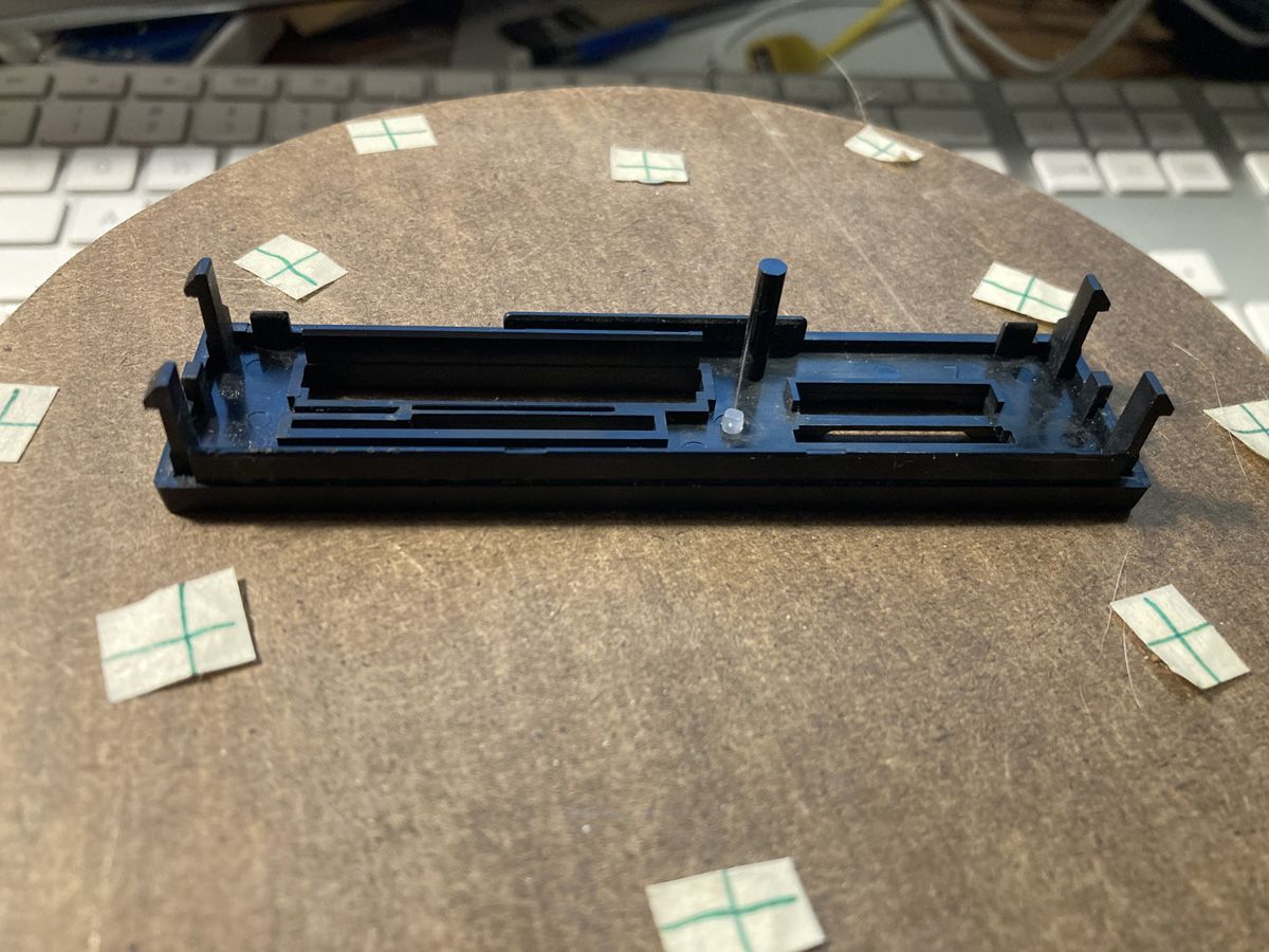

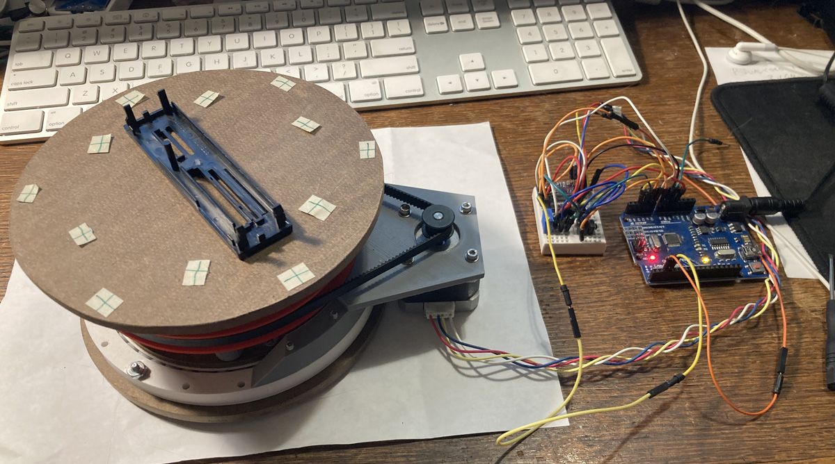

I have a little turntable that I can program the speed on to take photos for photogrammetry. Programmed with an arduino to run a stepper motor, I originally built it for use with my Creality Scan Ferret 3D scanner.

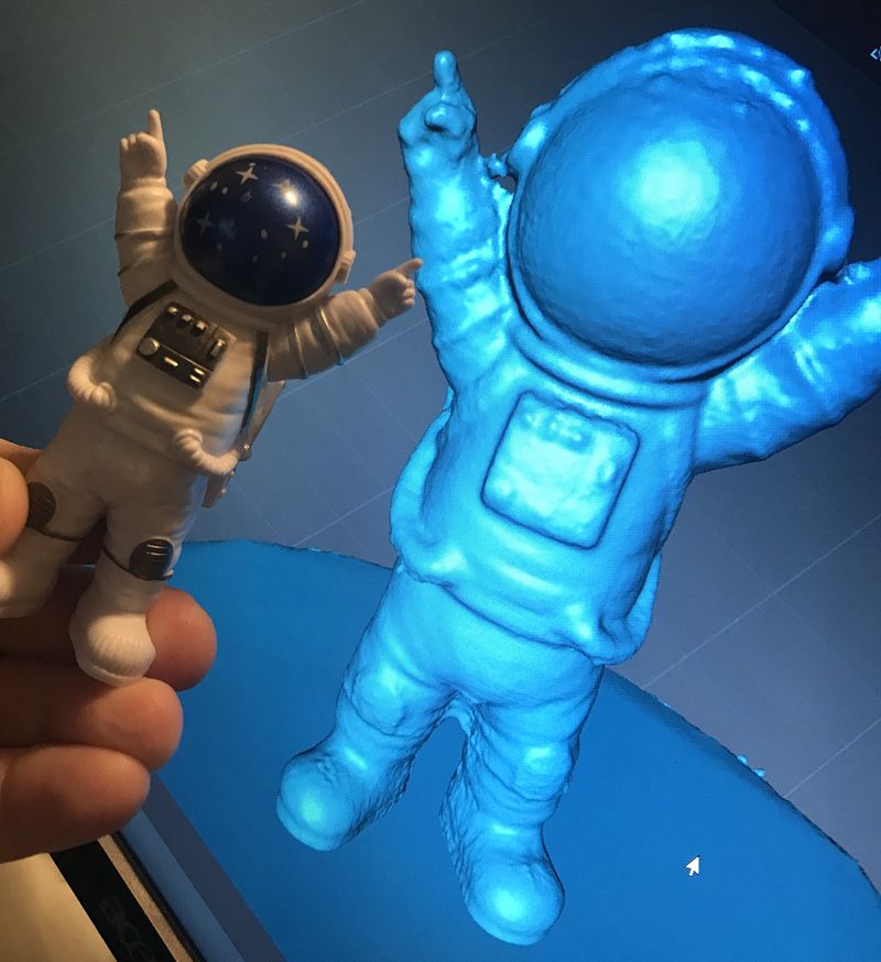

The software for the scanner works best on windows, and I rearranged my office and don't have everything setup yet. This is a scan done with the Creality software in the past.

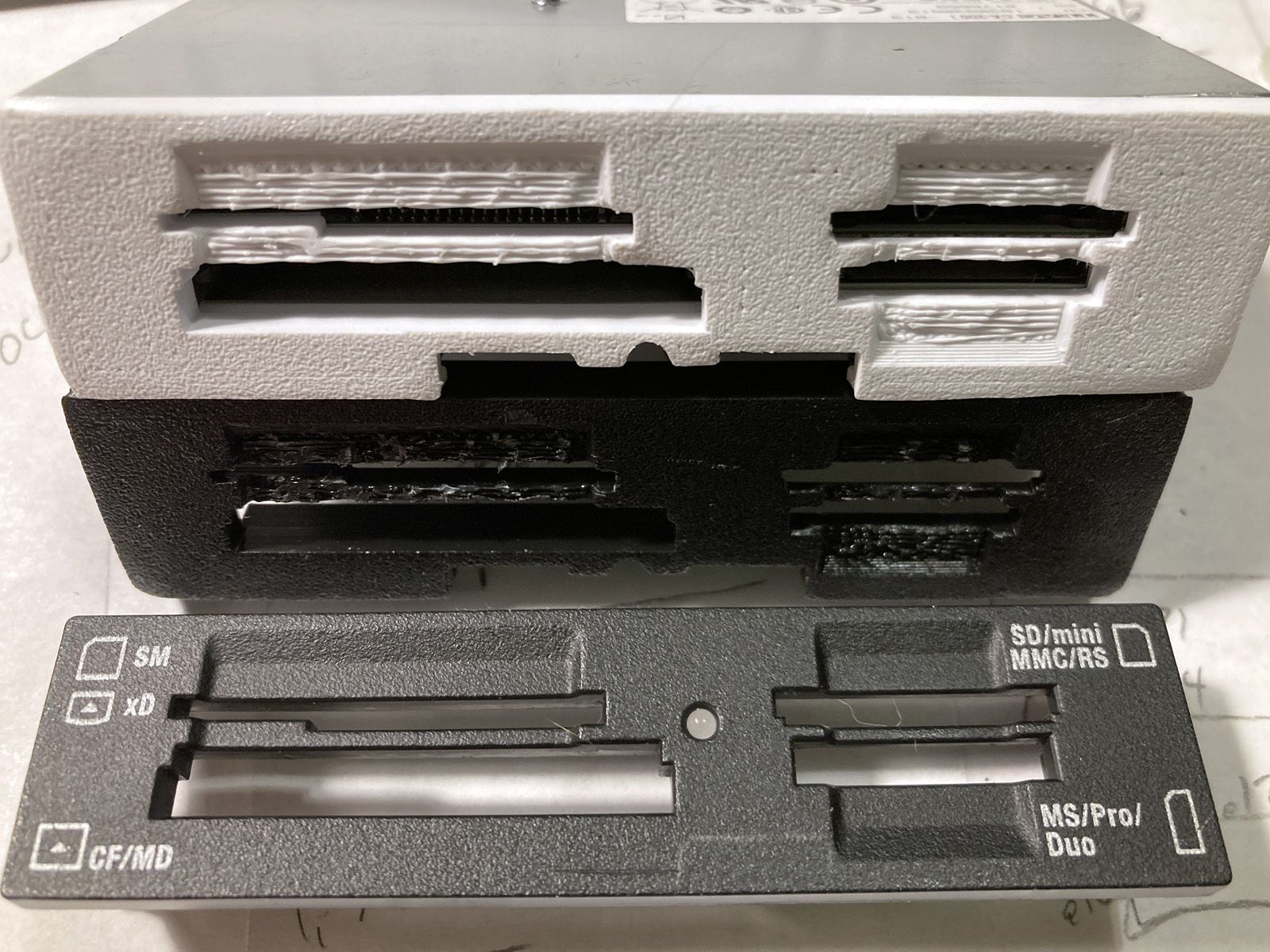

I tried photgrammetry instead of the 3D scanner. Meh results. I have a multi-card reader and I want a white faceplace instead of black. Painting would have been easier.

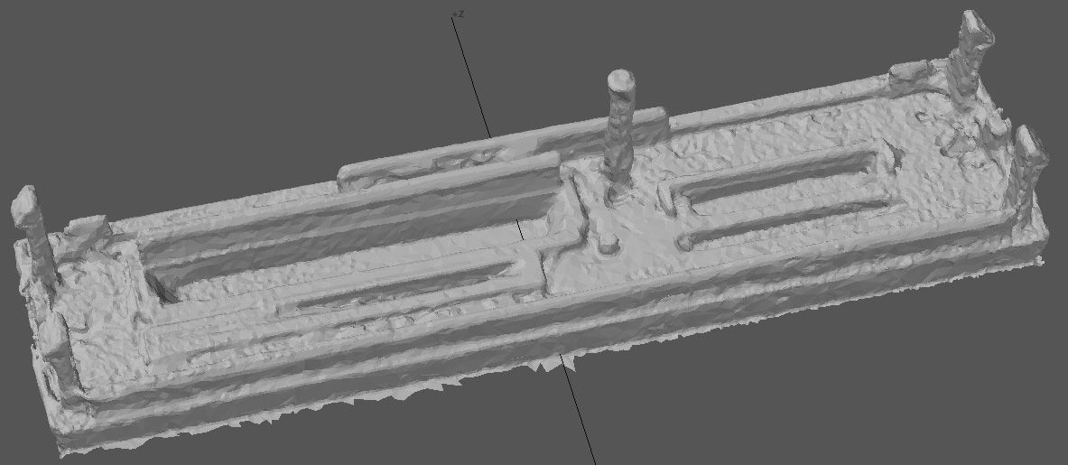

Round and round, took 52 photos.... let AliceVision Meshroom run for about 8 hours to plot this mess:

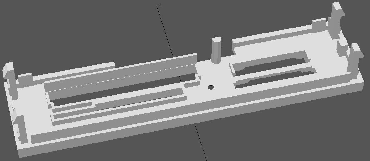

Then I spent about 4 hours just measuring and manually creating it in 3D instead.
Better result by doing it manually.

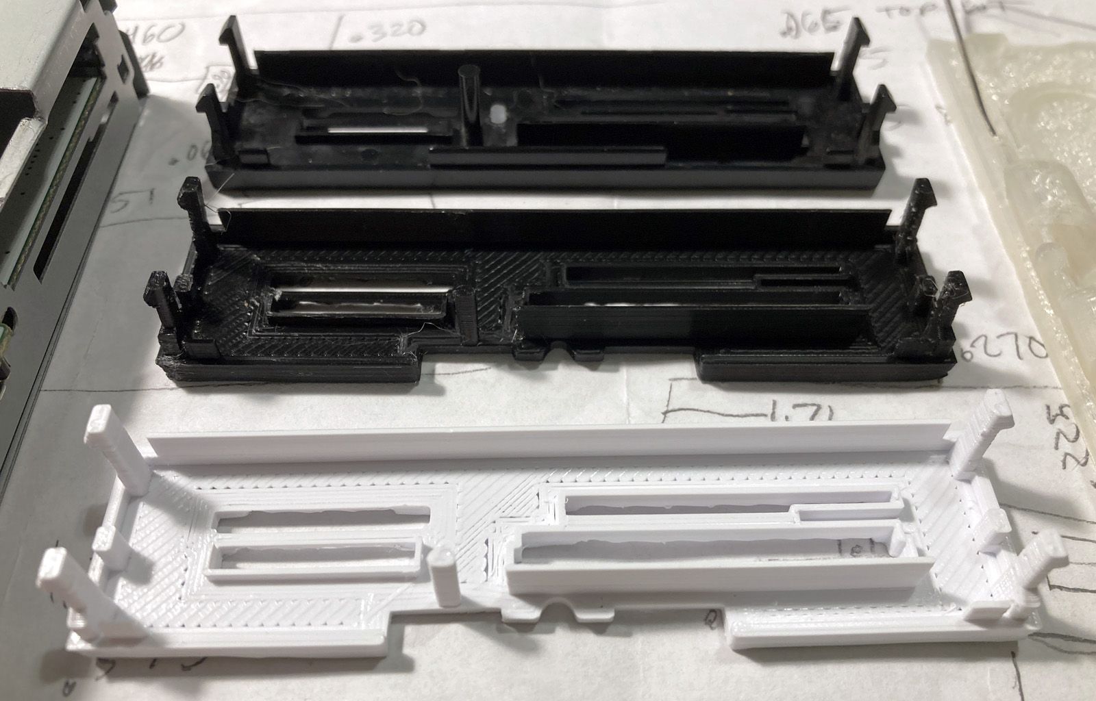

My faceplate results

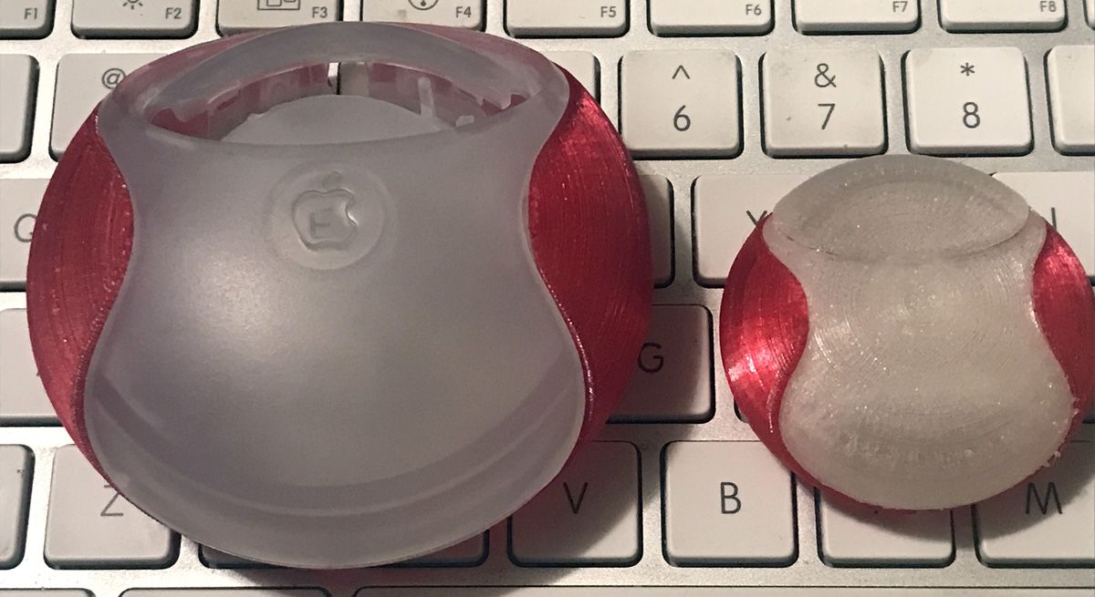

But why do I want it in white? For a Mini eMac I am 3D printing. Notches in the bottom of the faceplate are for the spring loaded door.
I got the idea from a light switch.

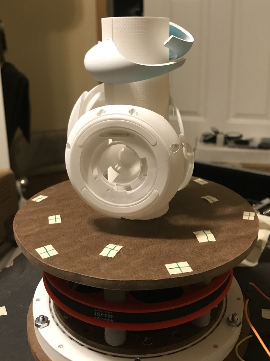

Spray it with foot powder talc, then “flick” cinnamon onto it to create the stochastic noise texture that photogrammetry requires. Tough scanning calls for tough actin’... Tinactin.

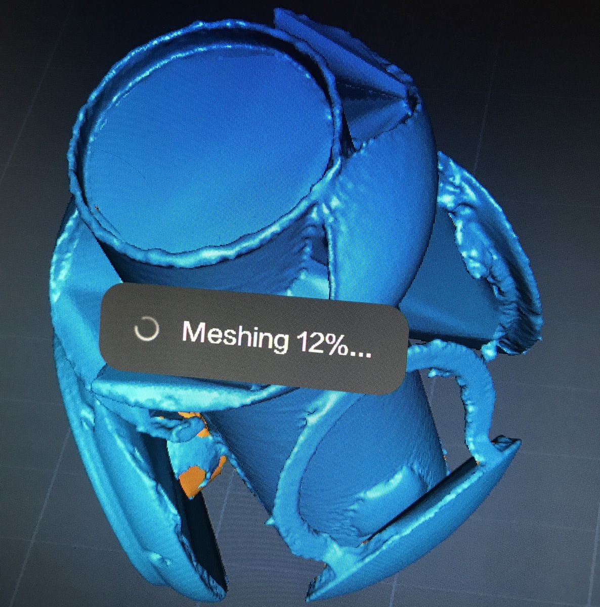

I tried the foot powder with a puck mouse disassembled and it still came out horrible (all parts attached to a tube to get the best angles).
But it was a good base I could take into 3D modeller and use it as a background to rebuild it with modelling tools.
Next time, I will try the cinnamon specs! After the manual rebuild, I could convert my Bondi puck to Strawberry and build a miniature.
