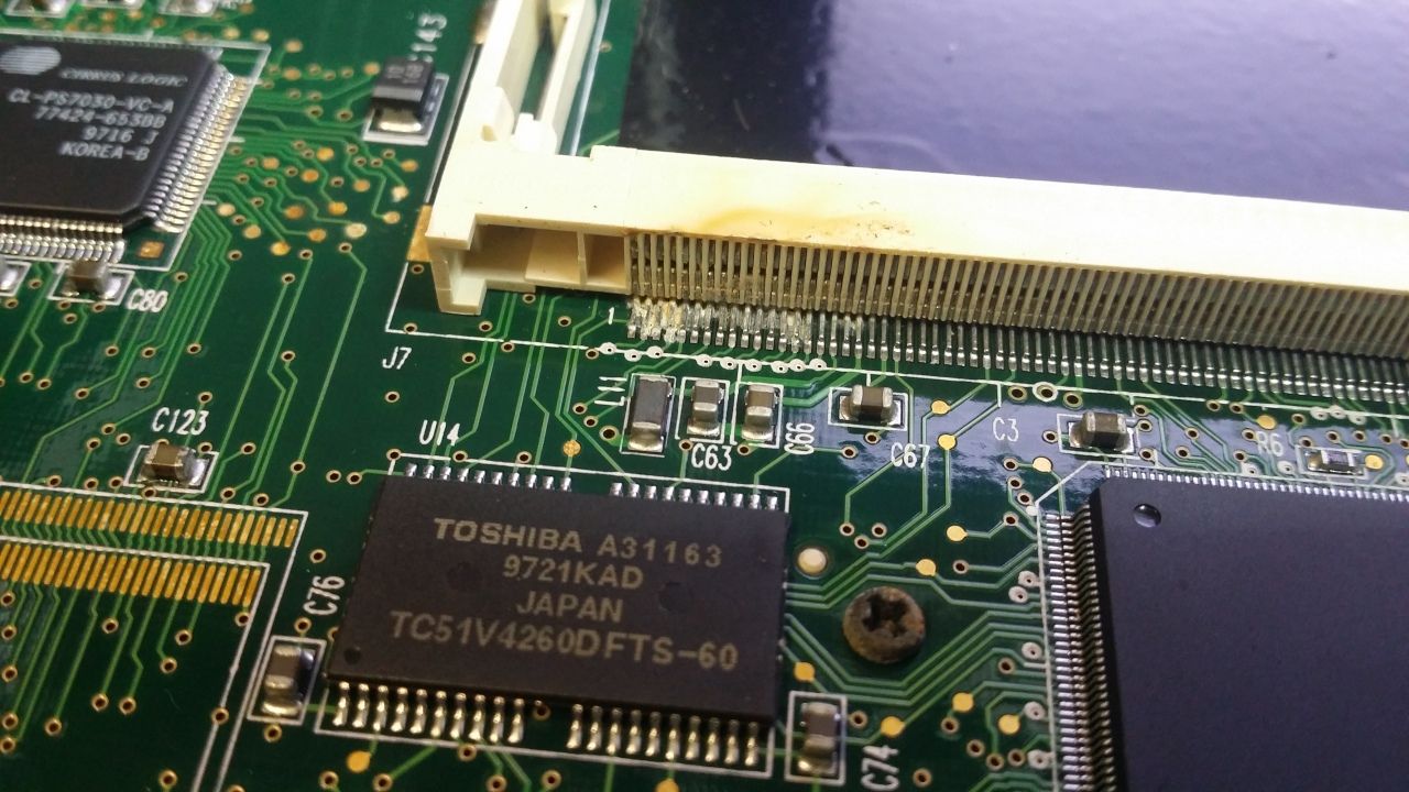

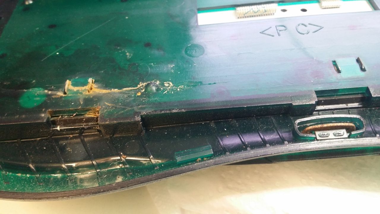

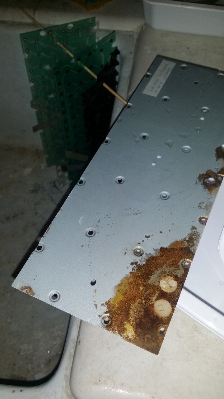

I acquired a second eMate recently, and this one needs a bit more work than the previous one… First, it needs a good clean and has some rust in places…

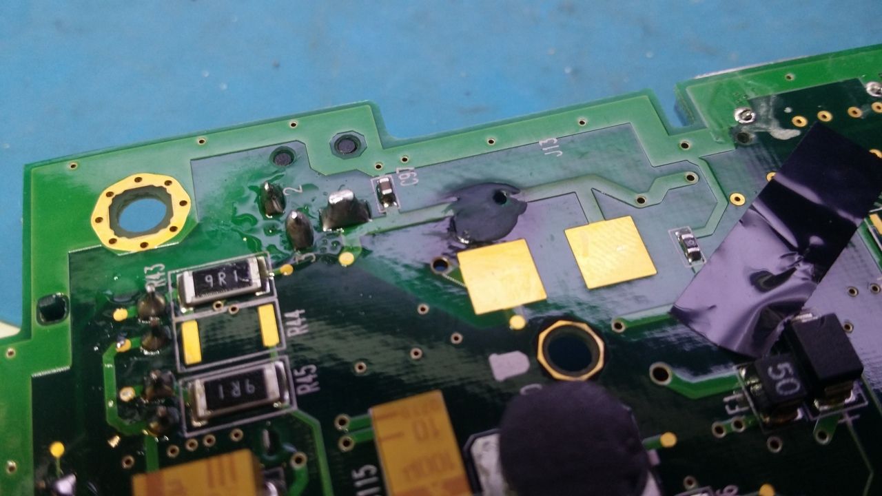

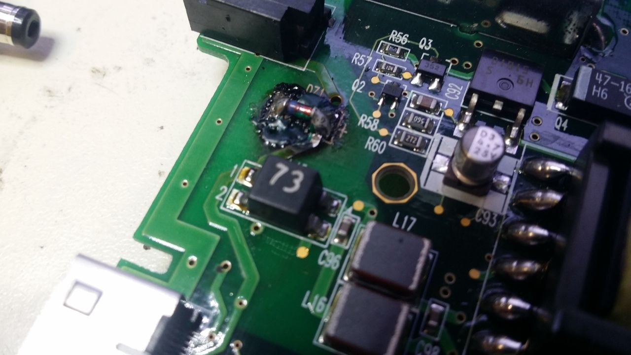

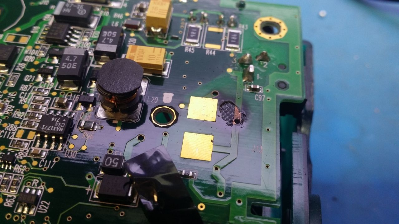

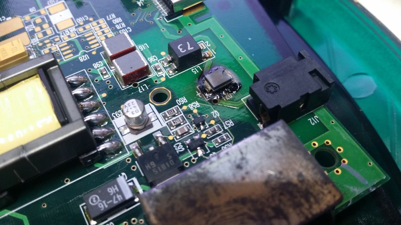

I'll handle that later, first I had to fix that burnt zener diode that shorts the power input. Likely a protection diode (12V when the input is 7.5V), which served its office when some misinformed user send more than 12V into it.
The one I replaced it with probably can dissipate less but well… At least the short is gone. The power LED lights up green then orange, so there's some life.

Today I cleaned up the bottom case on Dave's stream:
Still needs a lot of work, but I made sure it's working. Just the touch screen doesn't yet, but the screen ribbon needs more cleaning due to spillage.

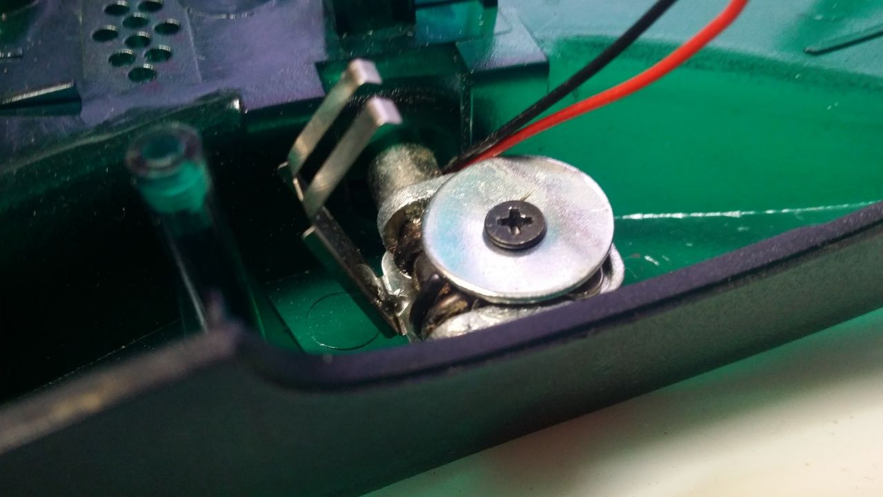

So, one spring broke after I added the washer. I suppose that washer was a bit too large and so didn't push the spring inside the cavity properly… Or maybe it just needed more grease… I added a smaller washer under that one for good measure.

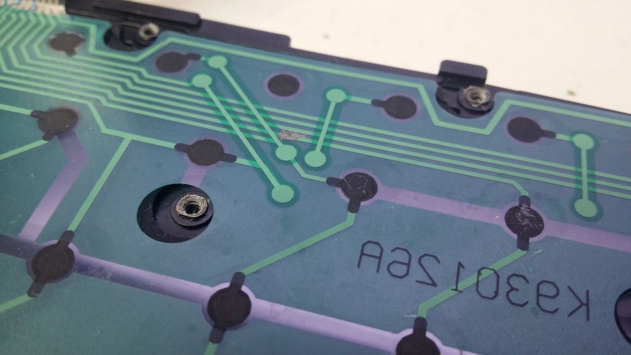

I torn down the keyboard to clean it up, it's drying now:
Let's reassemble the keyboard on that #eMate !
Turns out there's a cut trace on the membrane. I tried conductive ink but it didn't work, I'll see tomorrow if it just needed to dry out.
If you want to see if the keyboard got fixed:
So yeah, the conductive ink got somewhat conductive (about 400 ohms, which I find a bit high but well), and it worked.
