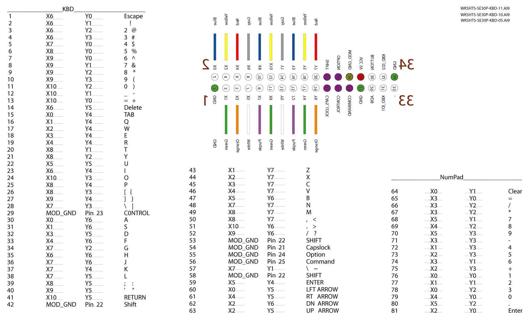

Does anyone know the layout of the Portable keyboard matrix?
I've got a Portable that crashes when you press certain keys, like U, D, L, arrow keys, etc. It's not they keyboard itself, since if I switch in another keyboard, it does the same thing.
As I'm going to start tracing things through the keyboard controller, VIA, and PowerManager, it might be helpful to know a good vs. bad key as I'm checking things out.
I had a similar issue post recap. esc, 4, 5, 6 and + would short the reset line when pressed. It turns out I shorted a trace right next to C24+ which was the issue. Maybe you did something similar near C15 or C26? I'd check that area first or by C116/C14 if you have the keyboard on the right side. I had to remove C24, add some solder mask to the neighbor trace and then reinstall C24 in my case. Works great now.

I worked it out in a thread over at the MLA, I'll look around for it.
edit: that was a quick search!
Sweet - thanks!
Glad you guys like it! Did you get a load of my matrix test bodge? 🤪
Hoping somebody will wed that table/switch matrix to a USB KBD controller at long last. PiPortable hybrid is an obsession awaiting retirement, which will be a year or two off.
