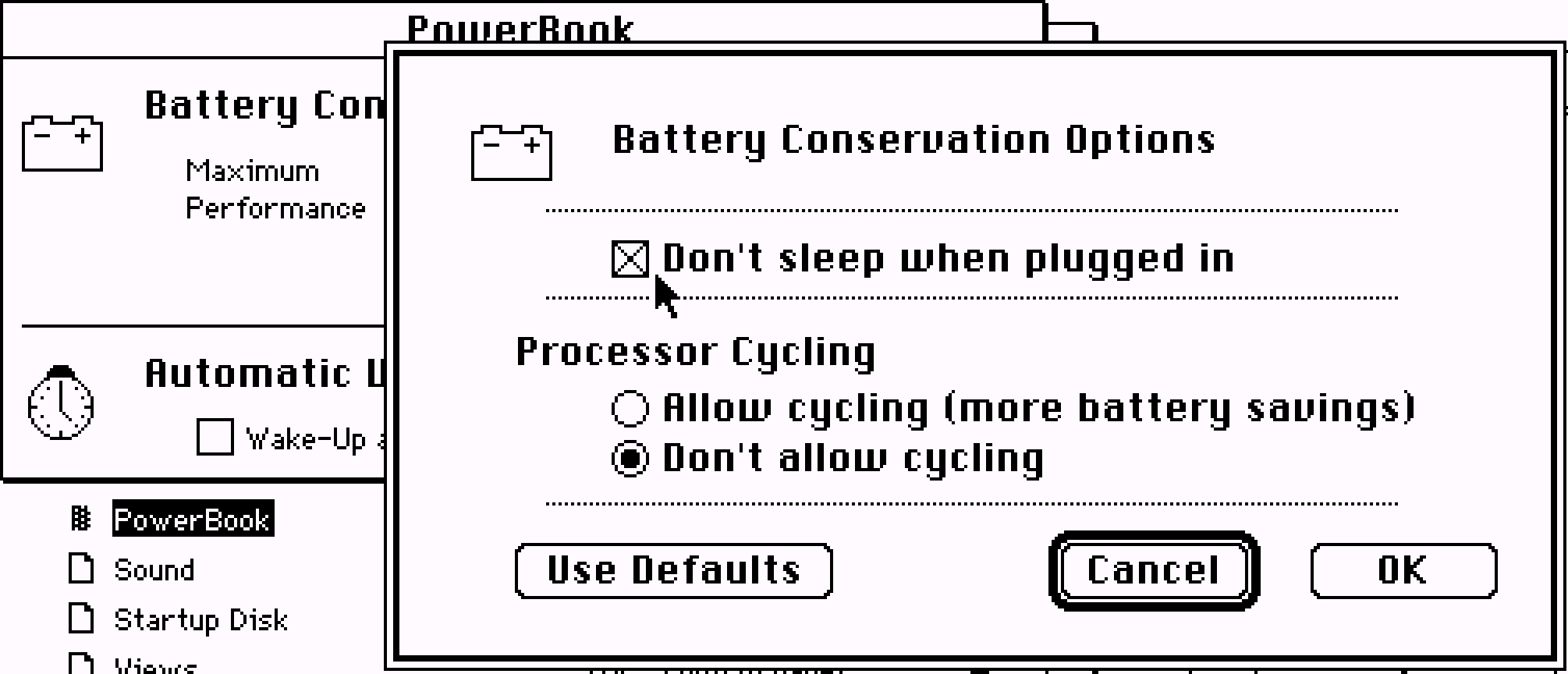

Okay, fellow Macintosh Portable owners... I've got a question for you.
Mine is a 5126 Backlit model.
As we all know, the Portable has a 2-minute Sleep timer active by default, but in theory at least, you can tell it not to sleep. When running System 7.1, the "Portable" control panel has been replaced by separate "Brightness" and "PowerBook" control panels. Brightness is just that, nothing else. The PowerBook control panel offers Battery Conservation & Auto Wake-up features. Within Battery Conservation, there's an "Options..." button that when clicked allows you to set it so the Portable will never sleep when connected to AC Power. And that's the trouble! My Portable sleeps anyway after 15 minutes of no user activity.
I am using the Portable Battery Eliminator by @Androda, which allows me to use the machine without a Lead Acid battery. I don't think that has anything to do with this issue, but I wanted to post it anyway to get feedback from all of you, some of whom might have a working battery, and others who might have the Battery Eliminator like me.
QUESTION: Does your Portable ignore the PowerBook control panel and sleep after 15 minutes of no activity?
No feedback here on TinkerDifferent, which is always disappointing, but I tend to post here and on FaceBook too so as to maximize feedback. I've been having the following conversation, which one person contends the strange sleep is due to the Portable Battery Eliminator:
I personally don't see how the Battery Eliminator is the REASON for why my Portable decides to Auto Sleep every 15 minutes when I tick the "don't sleep checkbox...
My command to not sleep is just that. It's not a command that says, "Don't sleep in 2 minutes. Sleep in 15 minutes instead." And yet that is the result. And a gain, the only feedback I'm getting thus far is from someone who feels it's the battery eliminator. And this is why I reached out to my fellow Portable owners for feedback. I look forward to hearing your experiences when running System 7.1 and either having that checkbox ticked or not, in terms of Auto Sleep.

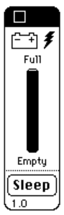

If I recall correctly the Portable uses the voltage drop through the charge MOSFET to determine when the charger is connected. It compares the charger side voltage with the battery side voltage, and if the charger side is higher then the power adapter must be connected.
So for example, with just the battery you'll see the battery voltage on both sides (6.4V for example). However with the charger connected (the charger will likely be current limited) you may see 6.8V at the charger side, and maybe 6.6V at the battery side due to voltage drop.
So with the only power coming from the battery connection on the logic board, the charger side voltage is never going to be higher than the battery side.
I'm not entirely familiar with the Battery Eliminator so I'm not sure what kind of voltage it reports, but it's possible that if it presents the full charger voltage as the battery voltage (around 7.5V) then even connecting a charger to the normal DC jack in addition to the Battery Eliminator might not make it think it's charging since the voltages would be too close to show a difference.

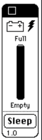

You can also see whether the computer thinks the charger is connected by opening the Battery Desk Accessory or Control Panel, usually available in the Apple menu. How it looks depends on the version, but usually there will be some sort of lightning bolt or plug icon that appears near the battery symbol.
The default ROM code for sleep only has the function to disable sleep if that setting is set and it thinks a charger is connected. You could manually set the sleep time to the max of around 63 minutes by manually editing the timeout in the PRAM or global variables. Setting it to 0 unfortunately causes it to reset to the default.
Perhaps you could edit the "charger connected" global variable, but I'm guessing another piece of code would change it back.

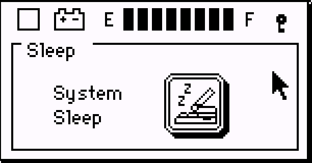

My test is finished. My first discovery was that the "Battery" DA in System 7.1 doesn't look like your screenshot. It looks like this:
So I booted into System 7.5.5 and found there is no DA named "Battery". That compelled me to reinstall 7.5.3. But even then, no "Battery" DA. I installed the 7.5.5 update, but still no Battery DA. And while there is a control strip that pertains to battery, it doesn't look like yours. Even so, no lightning bolt.
I then rebooted into System 6.0.8, but I cannot find any Battery DA that looks like yours. Yours is a real mystery. Where did you get that vertical one?
While booted into System 7.1 and installed MyBattery and rebooted, but that didn't give me a Lightning Bolt icon either:

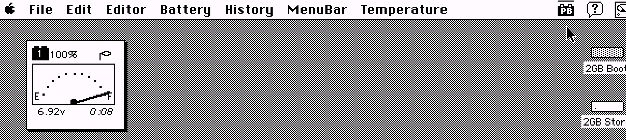

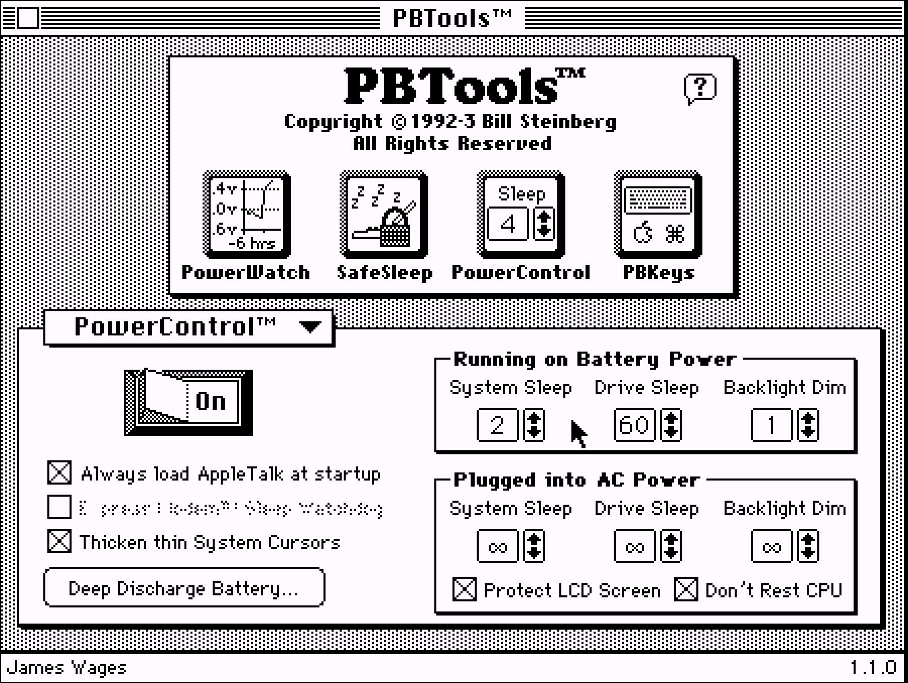

After that, I installed PBTools and restarted. No Lightning Bolt in its menubar icon either! I then did a test where I set "Backlight Dim" to 1 minute and "System Sleep" to 2 minutes in the "Running on Battery Power" section, and I set the "Plugged into AC Power" section all to infinity, as shown below.

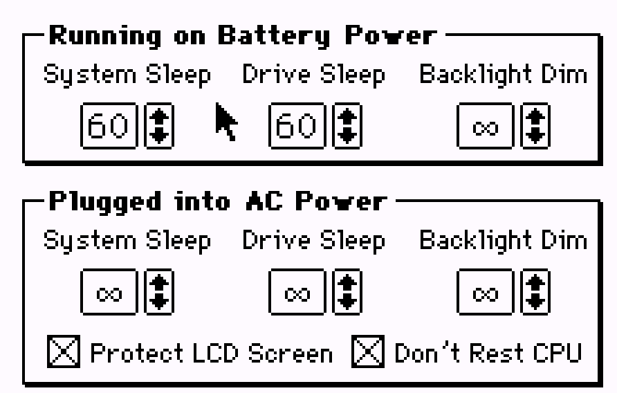

If my Portable was on AC Power, it would never dim or sleep. But precisely after 1 minute, the backlight dimmed! And after 2 minutes, it went to Sleep! (Note that I had removed the PowerBook Control Panel prior to this, so I know for a fact Dimming and Sleep were under the full control of PBTools.)
Not yet convinced, I did a second test where I set the Battery Power section to 60 minutes as shown below. I then waited for 32 minutes and came back to find my Portable still awake with backlight at full brightness! In other words, it didn't sleep like it does when you set the PowerBook control panel to "never sleep on AC Power".
These tests prove that the Portable Battery Eliminator is in fact replacing the Battery and NOT REPLACING the AC Adapter. Meaning, the Portable thinks it has only a Battery but that the battery is full. The down side of that is that anything which is setup for "AC Power" will be ignored. Instead, your Portable will be treated as being on Battery.
Because PBTools is a nice workaround for the Portable Battery Eliminator "problem," I will just use that with 60 minute settings, which is long enough to be away from your Portable before it sleeps.

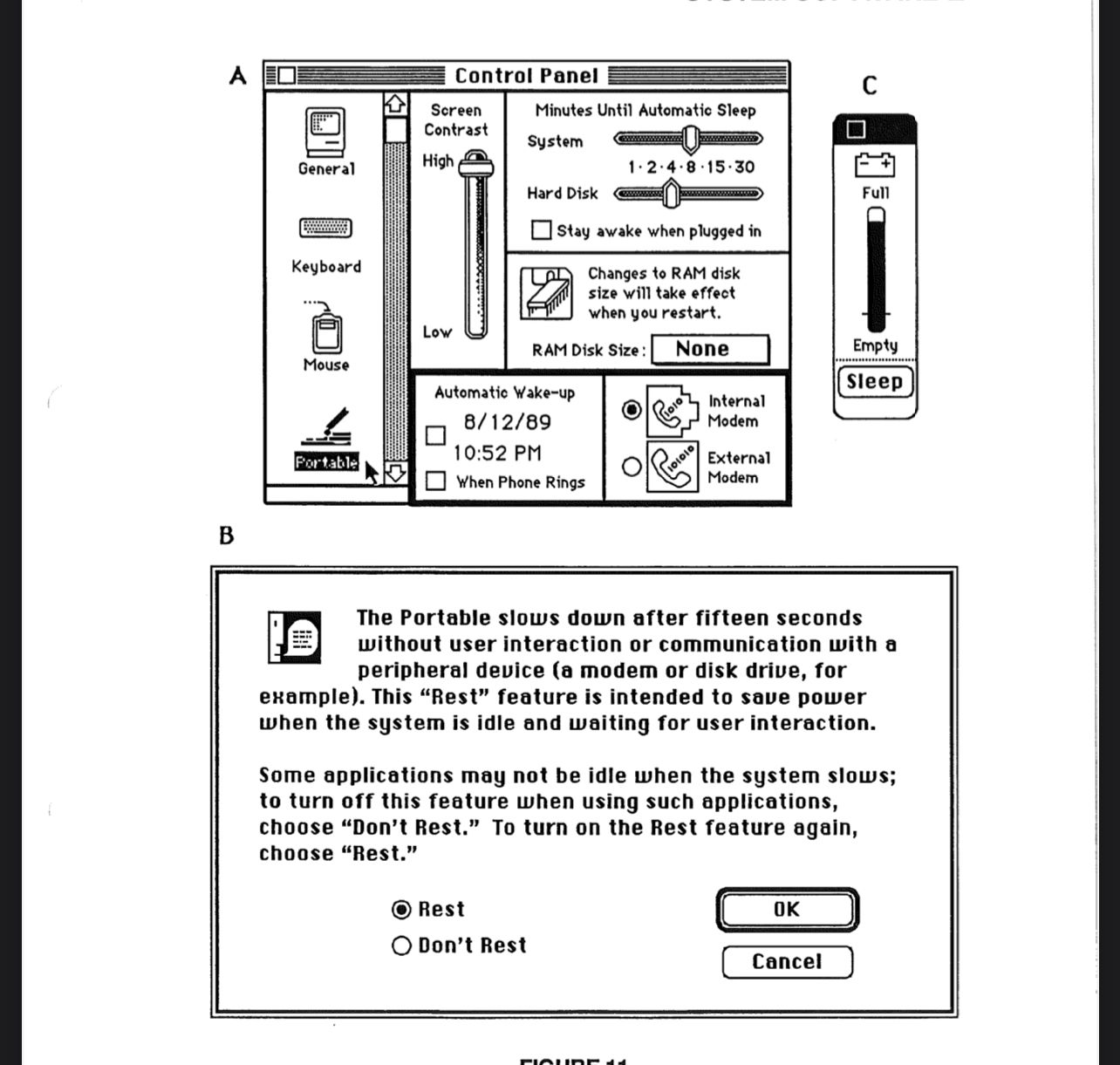

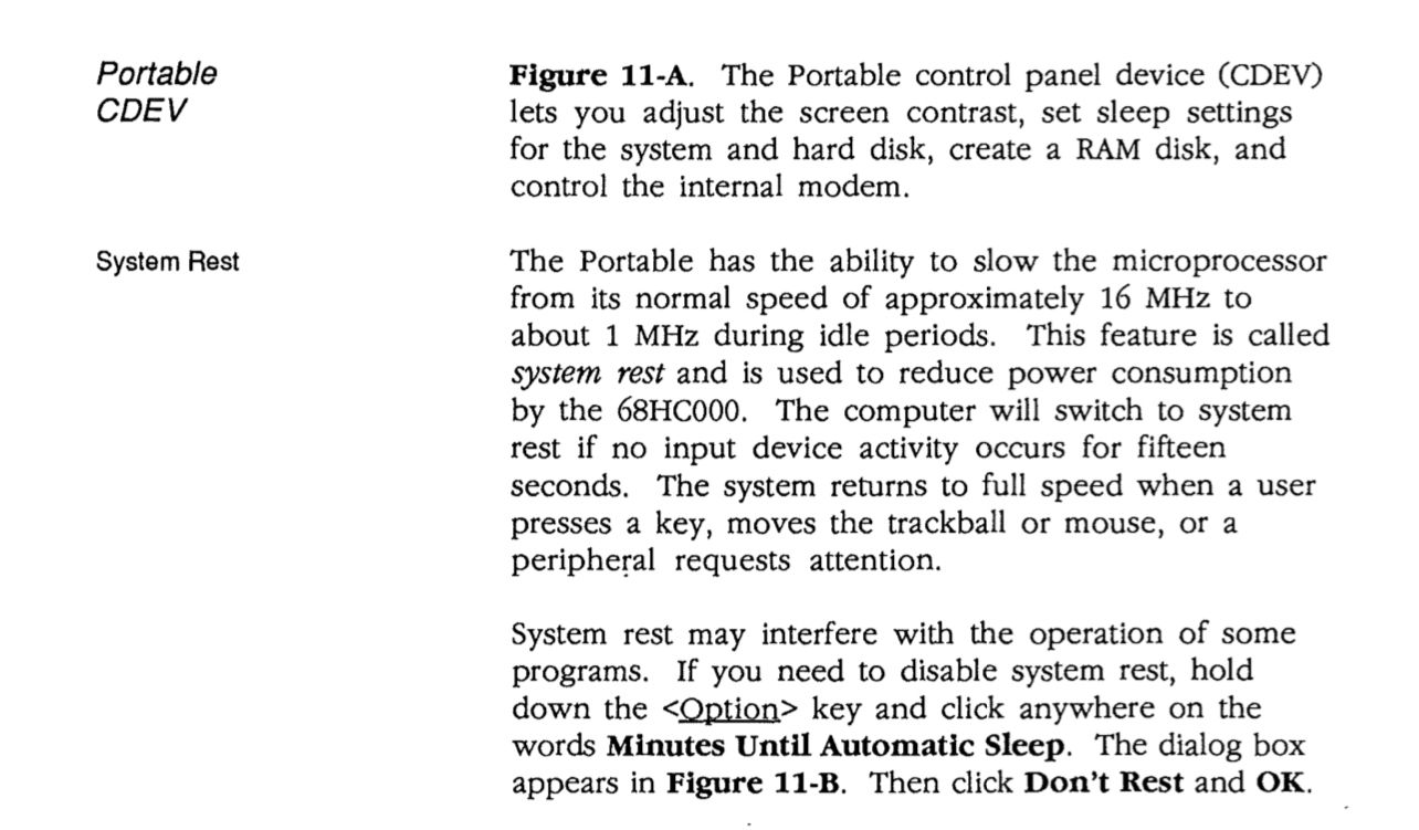

Probably not helpful and I don’t have a battery eliminator but I can recall that when I was having the wake from sleep issues early on where the machine would freeze for about 3 minutes after wake up when using the BlueSCSI, I had worked around it by forcing the computer to never sleep.
i remember on one of the system versions you had to hold down the option key to reveal the addition control to tell it to never sleep.
In other system versions I would slide the sliders all the way to “never” for battery and powered states.
If you’ve already been there done that and have found no solution (** I now see you got it sorted with PB Tools) another way to work around the problem is to install the After Dark screensaver and set it to 15 minutes. I’ve had this get in my way before when I wanted the machine to sleep and it wasn’t and found out that it was After Dark causing the machine to not sleep.
I think there might also be a mouse jiggler extension or something that will move the mouse after a set idle time. I know there’s a modern one for Mac OS called jiggler but I think there was also a 68k / PPC one as well that I had used back in the day to prevent AOL instant messenger type apps to never show I was idle.
Reactions: nottomhanks
The key to the Option key trick would be in knowing where and when to press it. Would that be in the "PowerBook" control panel?
Ok I remember now. It was the System Rest. In older system 6.0.8
you hold option down and click “minutes until sleep” text in the Portable cdev
Thank you for mentioning that hidden trick. Unfortunately, that does not pertain to the AC Adapter, Battery or Sleeping. The trick you mention is only to prevent System "Rest" which normally drops the CPU clock speed down from 16MHz to 1MHz when nothing happens after 15 seconds.
However, in your screenshot, I spotted the same exact Desk Accessory? that @SuperSVGA posted earlier...
But for the life of me, I don't know how to invoke that in System 6. I've gone through all the System 6 installers and I don't see anything named battery. So if you or @SuperSVGA know how to invoke it, please let me know. It's probably super easy, but right now, I can't see the forrest for all of the trees!
