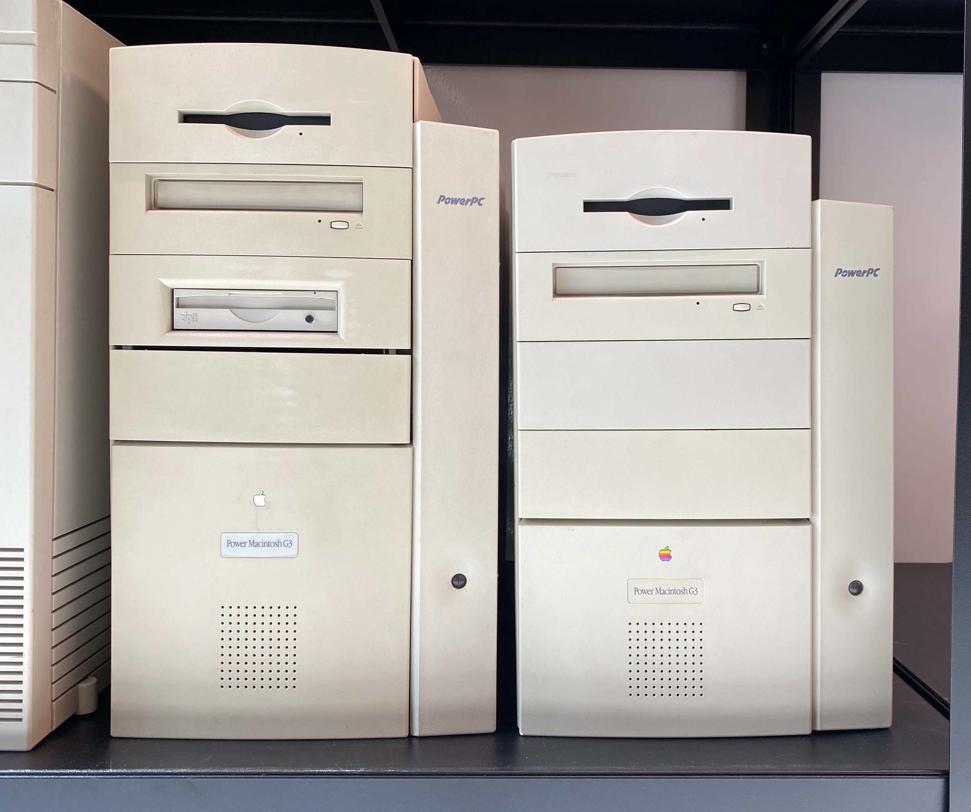

Thanks to a generous short-term loan of several original bezels for the PM9600, I have been able to produce accurate 3D model reproductions of the PM9600 / G3 front bezels. Big thank you to @xenocide21 for the loaned parts!

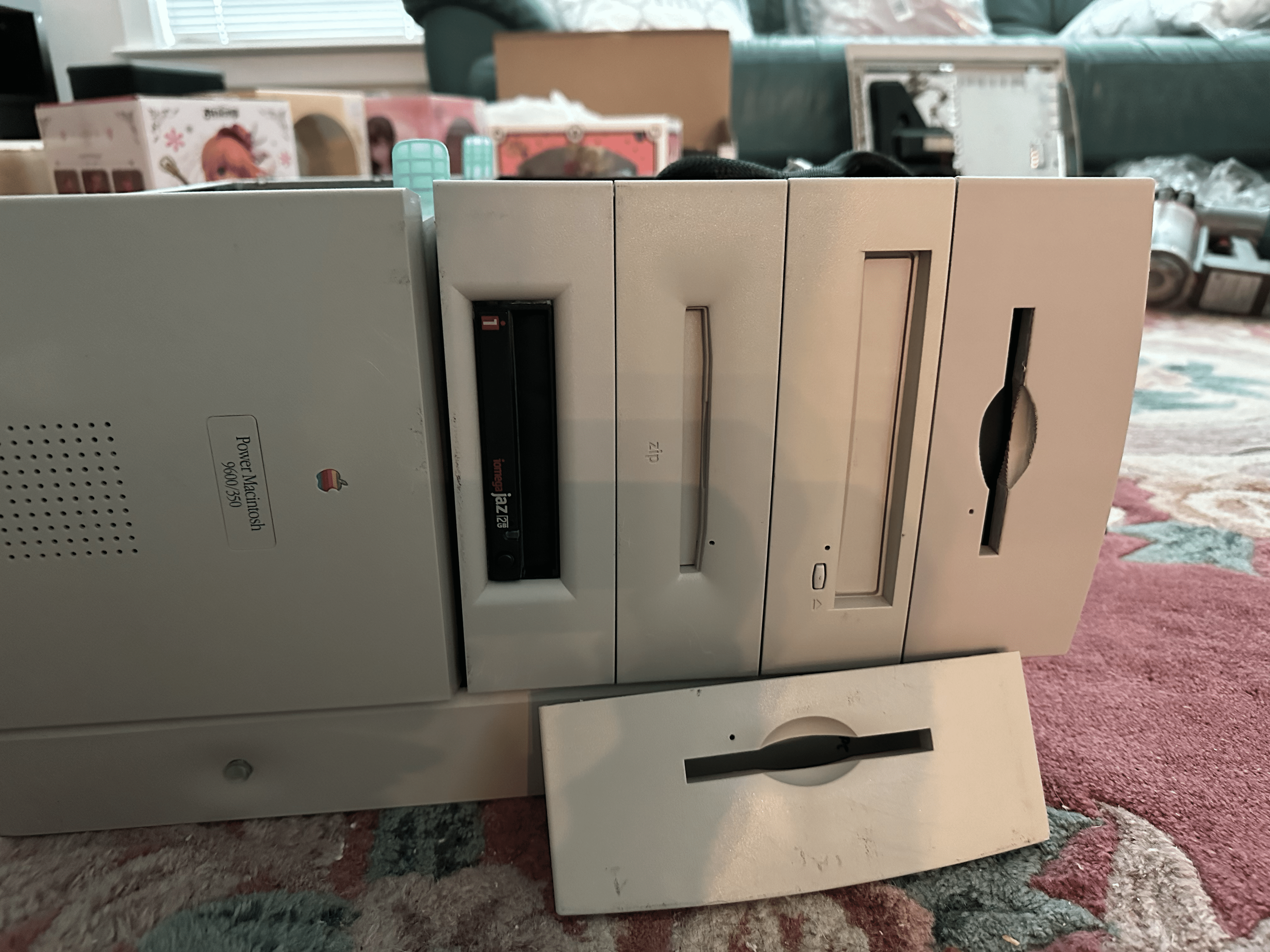

I just got a Power Macintosh 9600 recently, and I am wondering if anyone is willing to also make a 3D model of the floppy panel. It seems that those are the ones that go missing or become damaged or go missing. There is a thread on the 68kmla trading forums looking for the floppy panel for the 9600/G3.
I'm looking to 3D print a replacement when a 3D model for one becomes available.

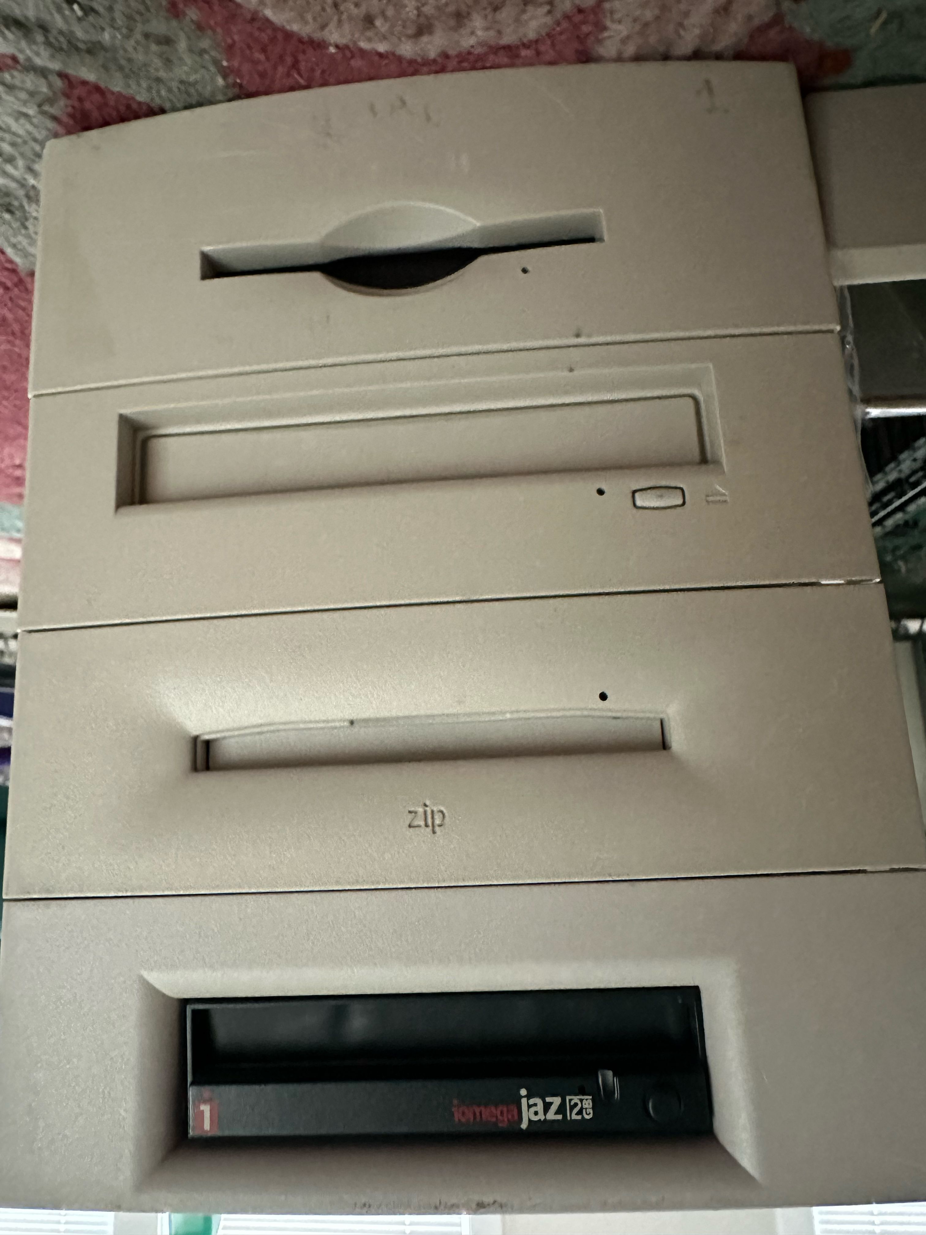

Talking about those, my 9600 seem to came with a Jaz drive, not a 1GB one, but a 2 GB. I thought most come with 1 GB. I know that panels are made for BlueSCSI and ZuluSCSI as well.
I probably need to test the drive at some point, but I wouldn't store critical data on one though.

Only have a few minutes to read this - could you circle the one you want? I thought I already made it
It's the top panel, the floppy panel (the one on the very top). Those are the ones that seem to go missing or go loose. I have seen the top floppy panel go missing on 8600/9600/G3 on eBay, but there is no 3D print model for a replacement.
Reactions: Stephen
Ah yes. The geometry on that is challenging. Some folks offer 3D scans but I personally think the quality is inferior versus recreating the CAD file - and modifications become more challenging if it’s a scanned file.
If someone wanted to loan me one of these then I could try to recreate it…. But it may take me several months.

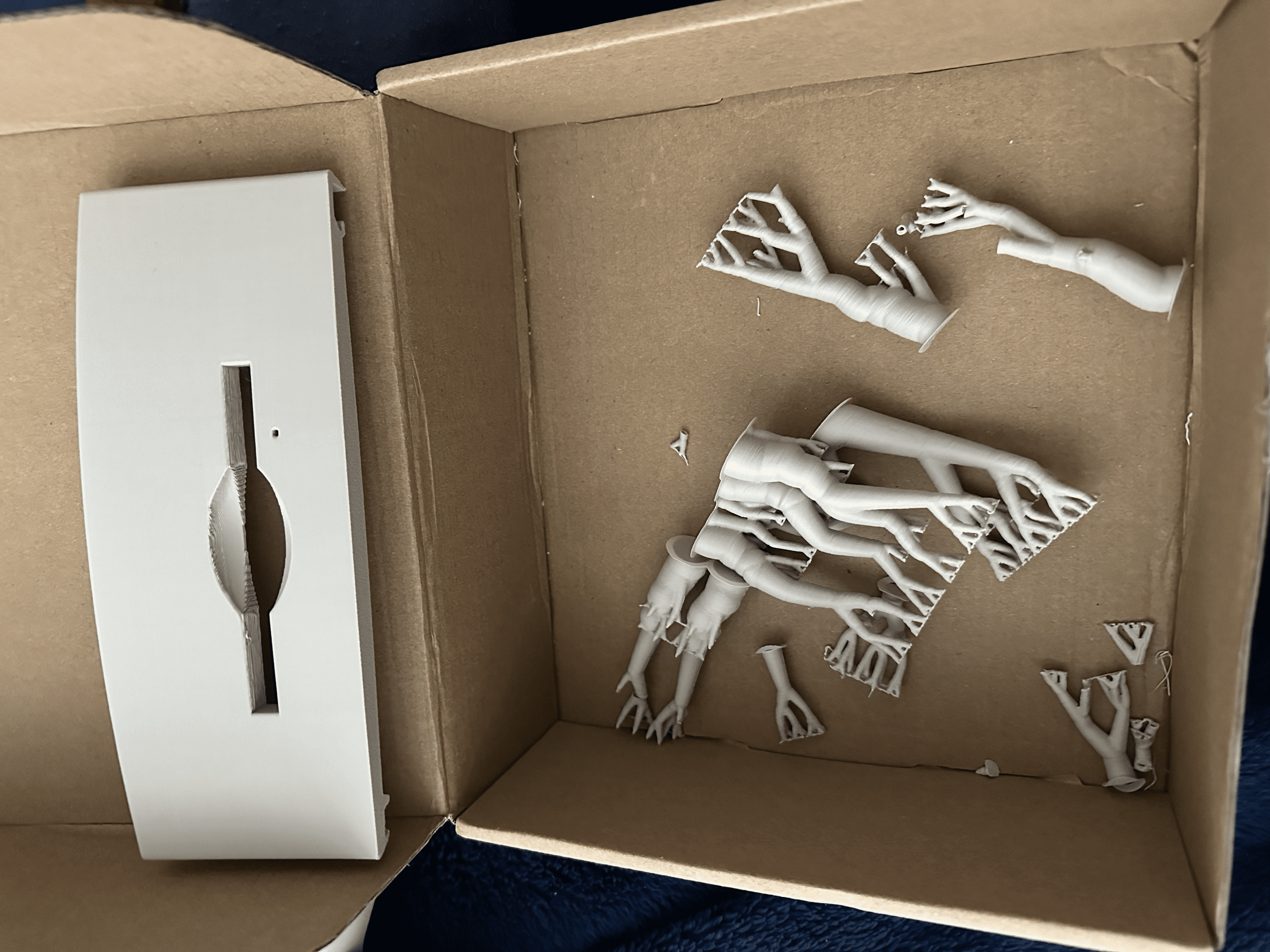

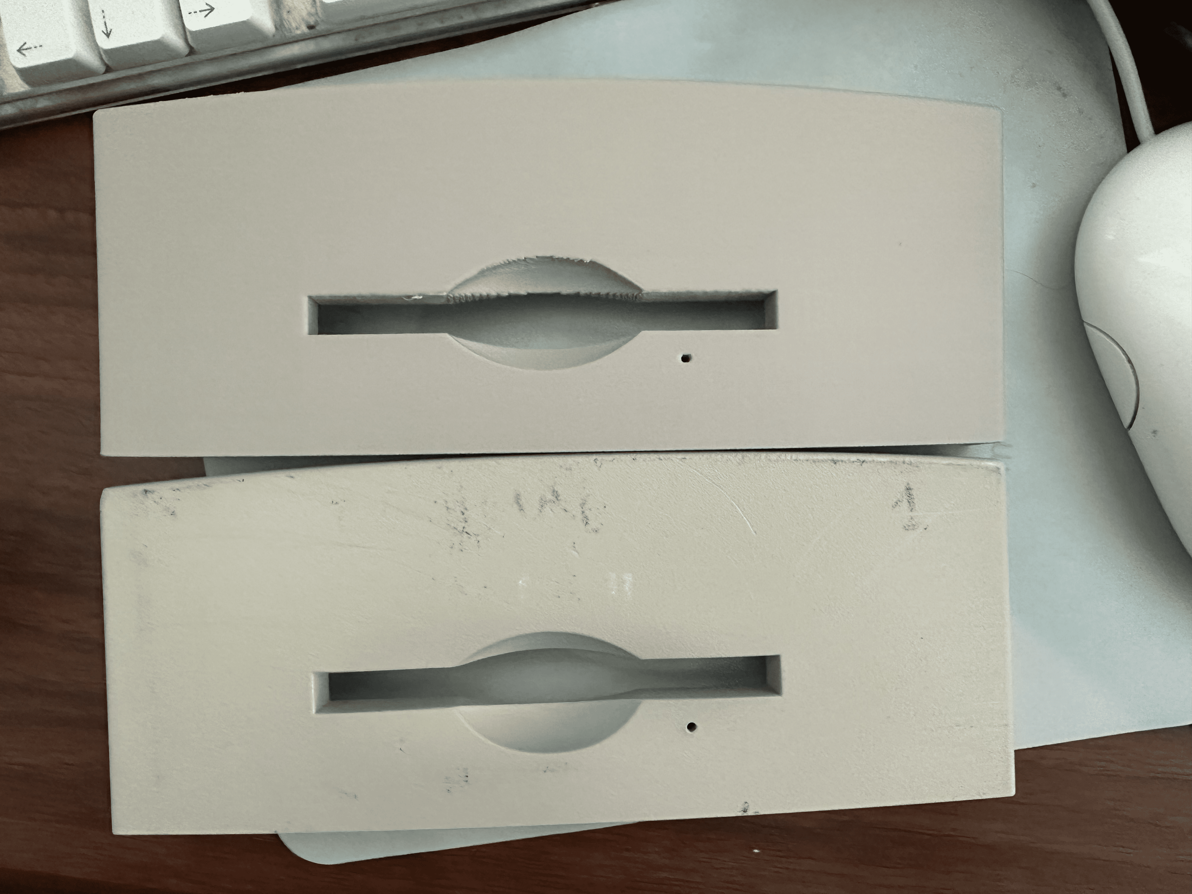

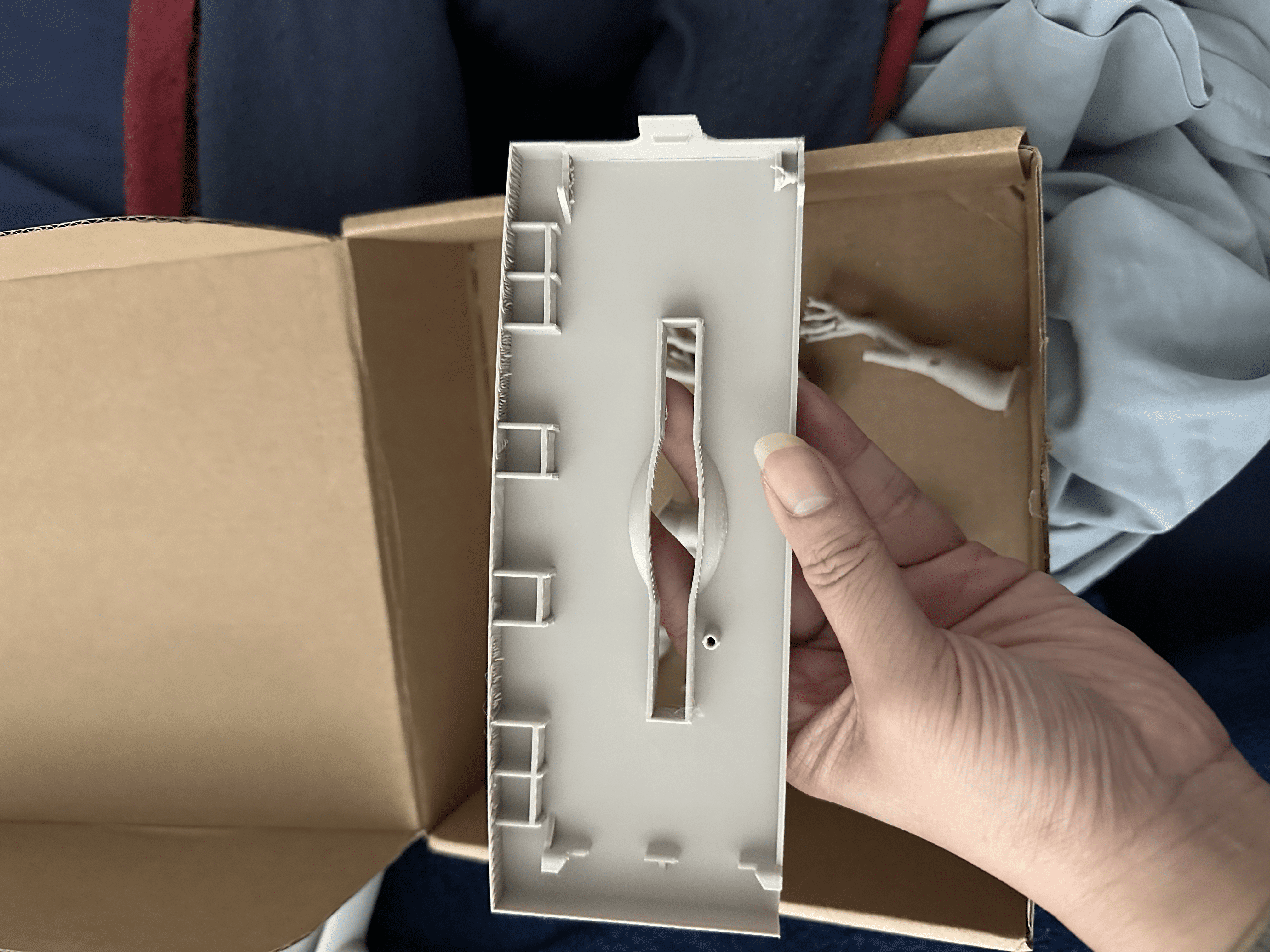

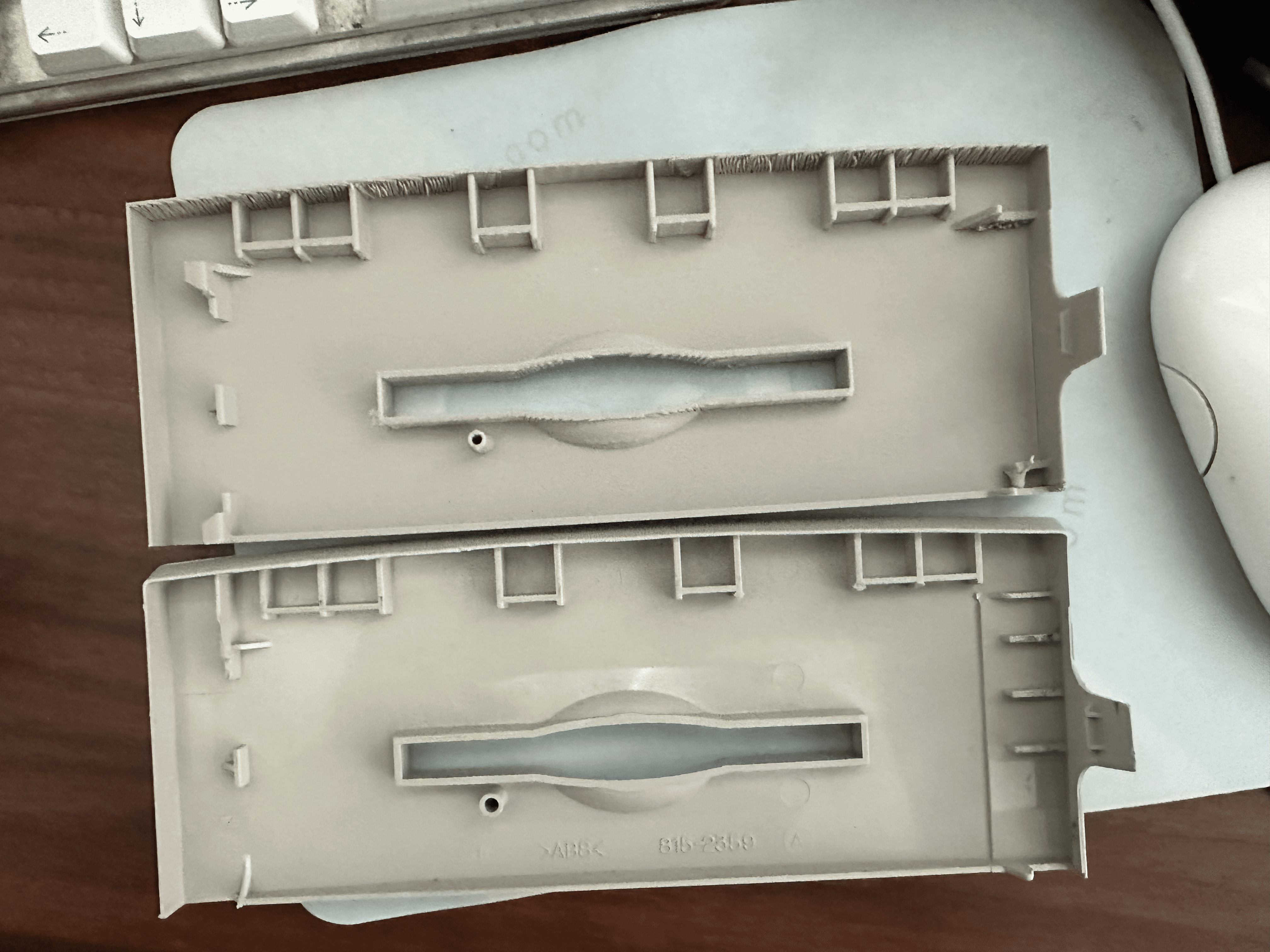

I managed to get a 3D printer to print the floppy panel. Took several tries, but it worked out in the end.
To print this, print it on the flat side up, and use tree/organic as supports. Doing it face down and face up with supports do not give good results on a FDM printer. I used Polymaker Matte PLA Filament multed white for this.
Nice work - mine came out so badly (with tree support and the same orientation) I tossed it straight into the bin.
What 3D printer are you using along with filament? I used a Bambu Labs A1 (he bigger version). You might have to use glue stick as with the tree/organic, the right side peels up and messes up the print. I catch it in time so it won't waste that much filiament.
Now, I probably have to buy another spool.
