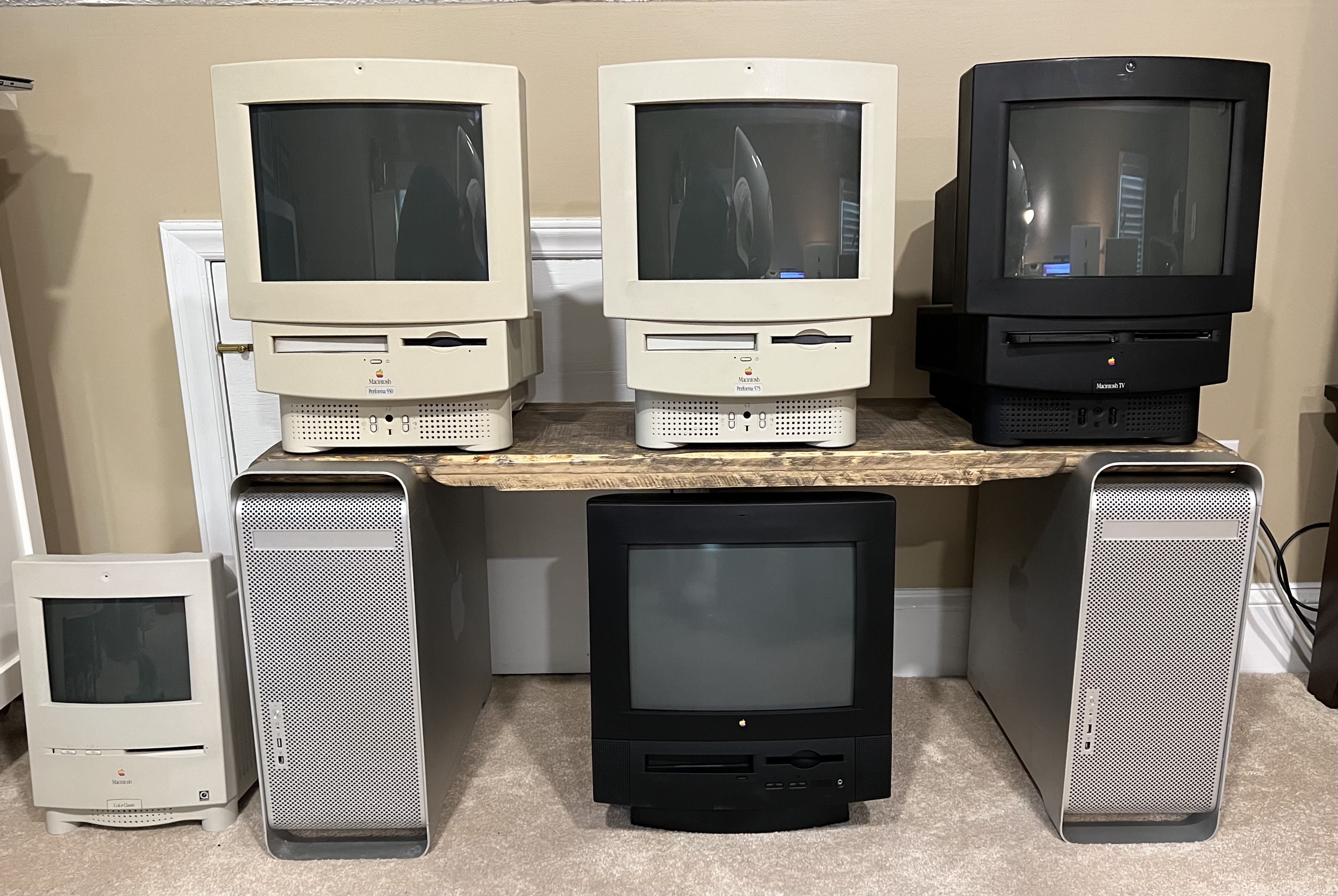

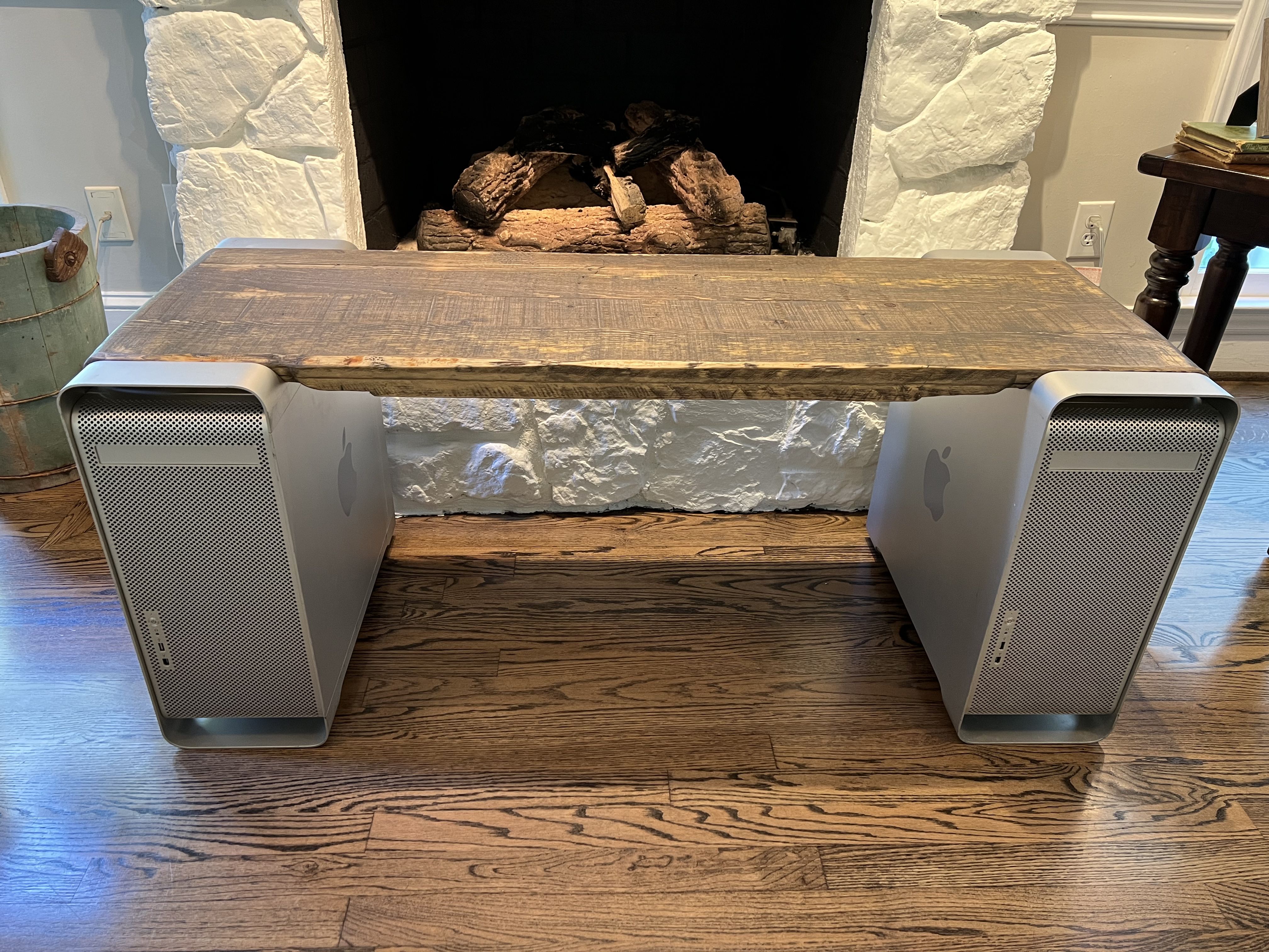

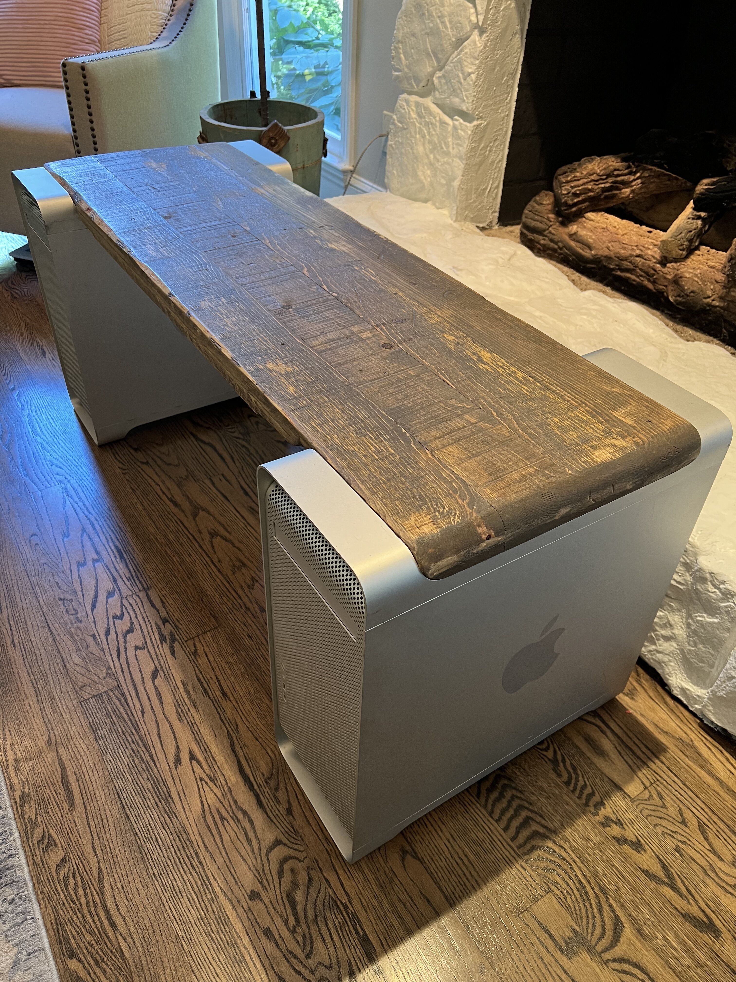

I saw someone on reddit recently posted a picture of a bench in a school with two Powermac G5 towers as the base. I needed some more storage space for my Macs, and had two non-working G5s, and some woodworking tools. I really liked the idea to route the edges of the wood to fit in the curves of the metal legs of the G5.
So, for anyone wondering, the curve seems to best match a 1" radius round-over router bit. The 1.25" bit wasn't quite right, and the 1" ended up working very close to the actual metal. I used cedar because I thought it would be easy to use such a large bit with and I like the rustic look when finished.
Here's some pictures of the end result:

So, @wottle, those G5 Macs are just cases, nothing inside, right? :D Nice that it is in front of the fireplace!
One holds the innards of a water cooled on that had so much corrosion ships were just falling off the board. The other powers on with no boot chime. I likely should have stripped the internal parts to make them less of a pain to move around, but they are still filled. Fireplace setting is just continuing my tradition of setting them up in the main living area until my wife tells me they need to go to my vintage Mac room...

This Looks good. I've been wanting to try this since I have half of the parts taking up space already. Did you feel the need to reinforce it at all or just assume the box is beefy enough for two people to sit on?
The G5's are pretty sturdy. If you did need to re-inforce, I'd say the only part that would need it would be the bottom legs. maybe put some wooden blocks cut to size. The downside is you'd be able to see the wood from the front and back.
Definitely good advice. If I sat on that, I’d squish the G5s poor little legs like an accordion without tight wood inserts.
