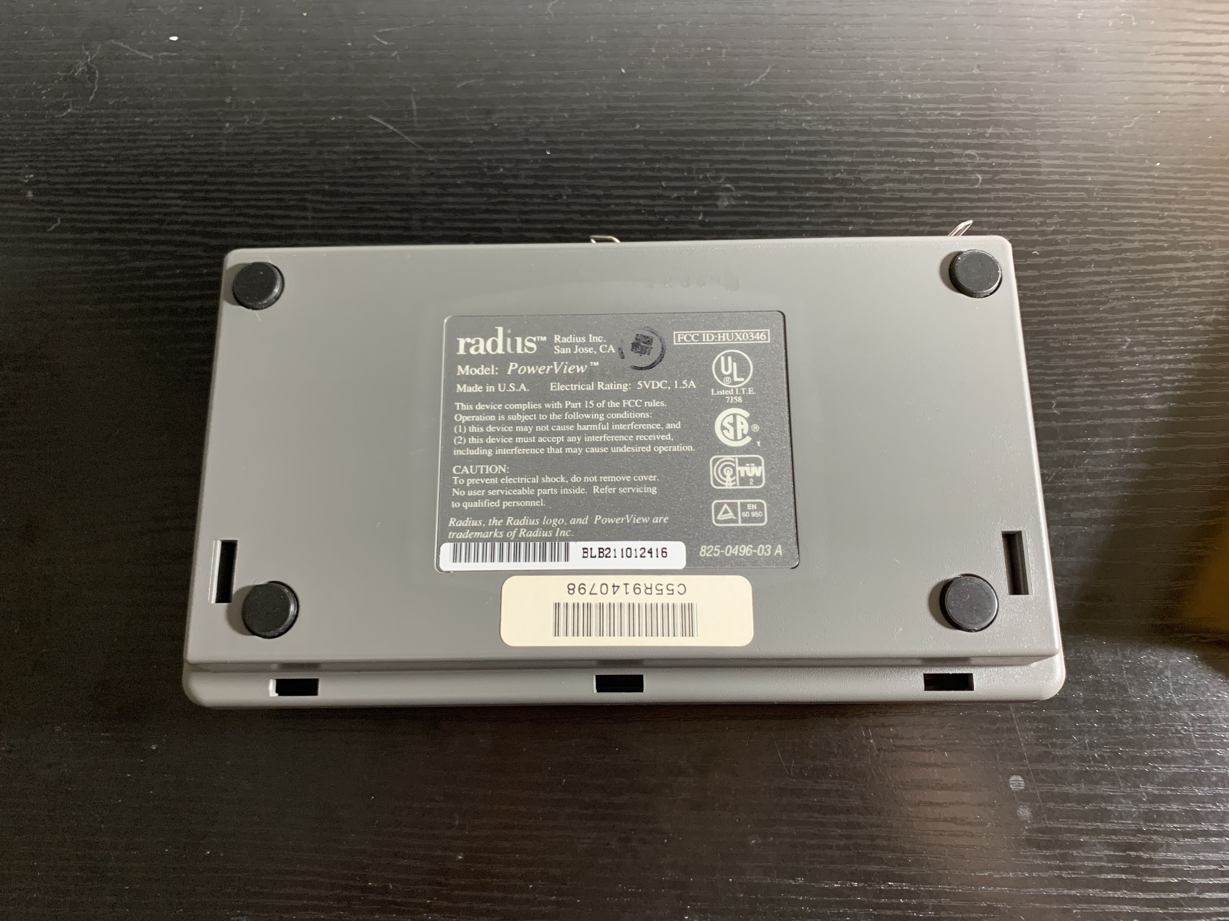

I've seen this elusive peripheral referenced for years. There's a few pictures of the device and a video capture of it actually working online but I knew it was rare. I saw one pop up on Mercari for ~$40 and knew I needed to grab it.
Box:
Contents:
(Cat was not included)
Unfortunately, mine is missing the original 1.0 software floppy disk and the HDI-30 to SCSI-50 cable. The 1.0 software would not have worked on my PowerBook 160 and fortunately you can pick up the cable for $20 on our favorite auction site.

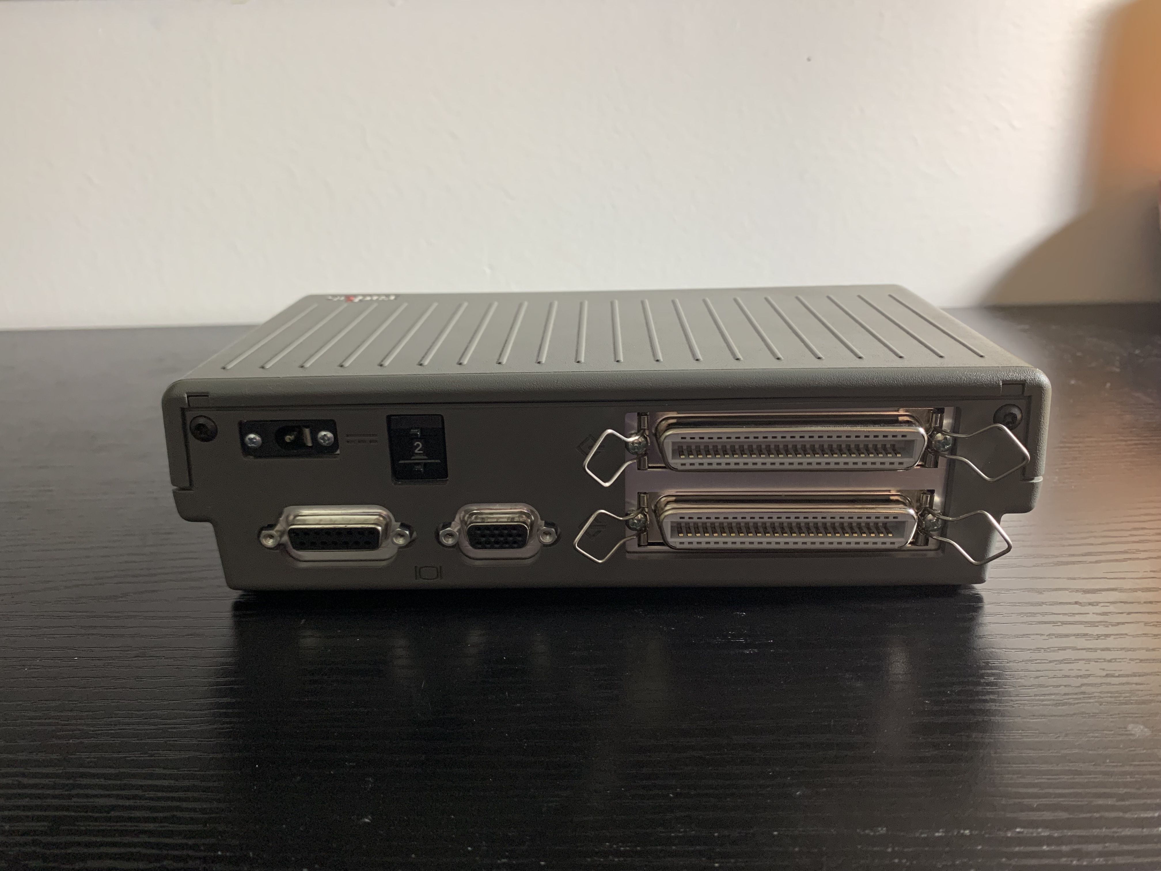

The Device:

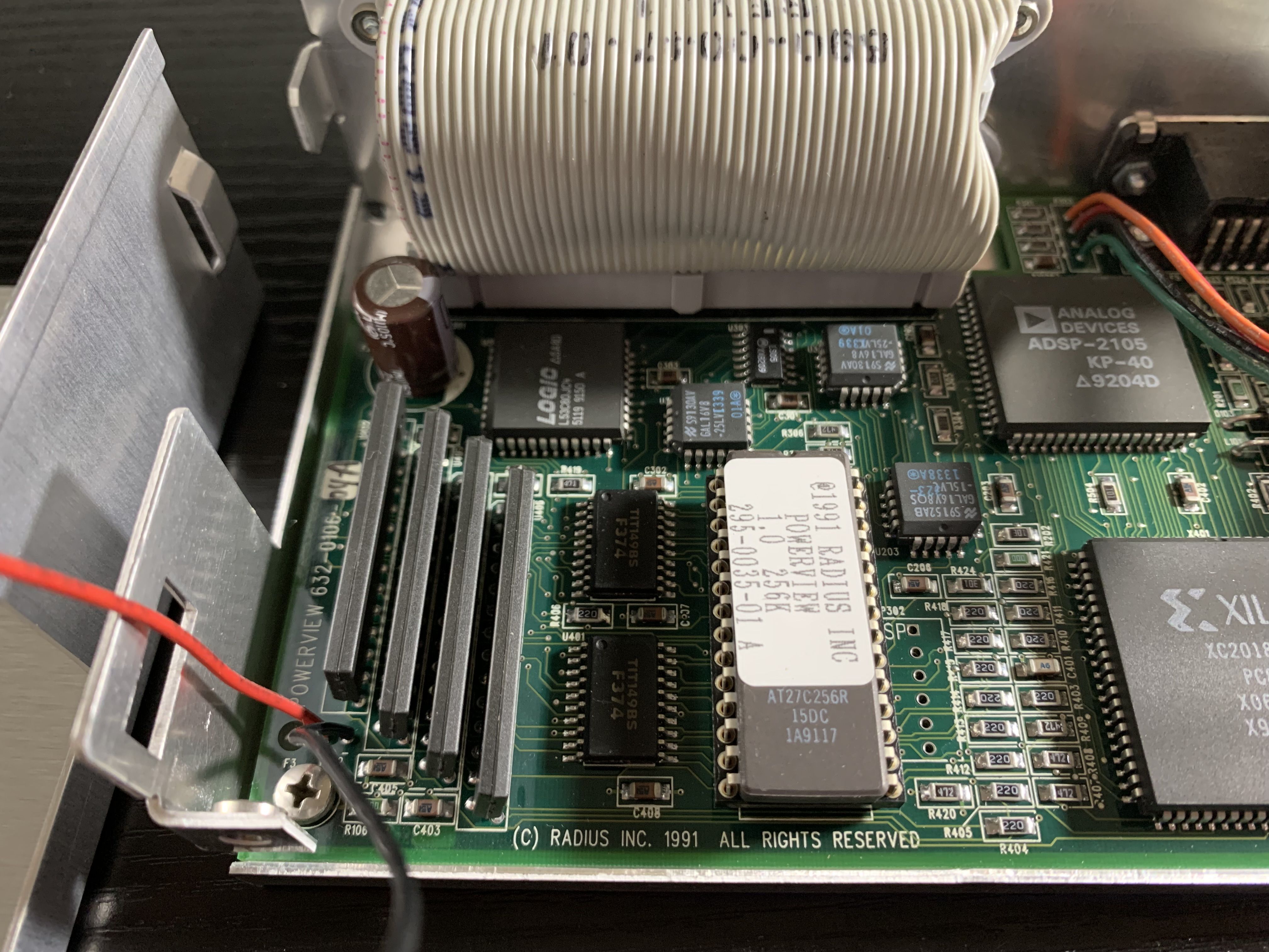

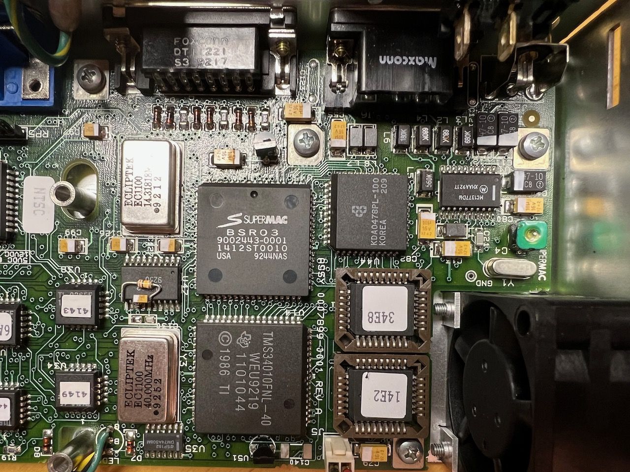

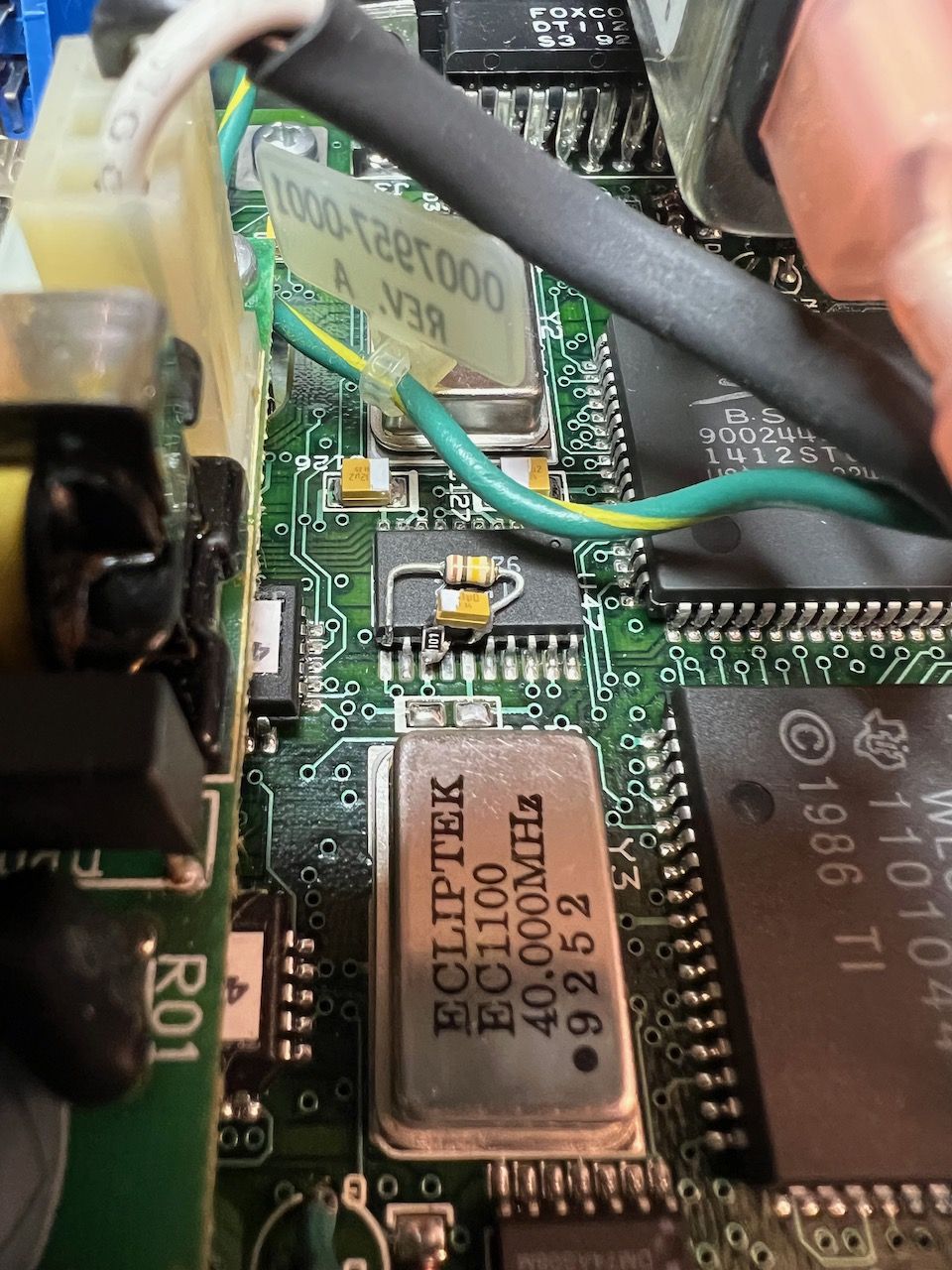

Internals:

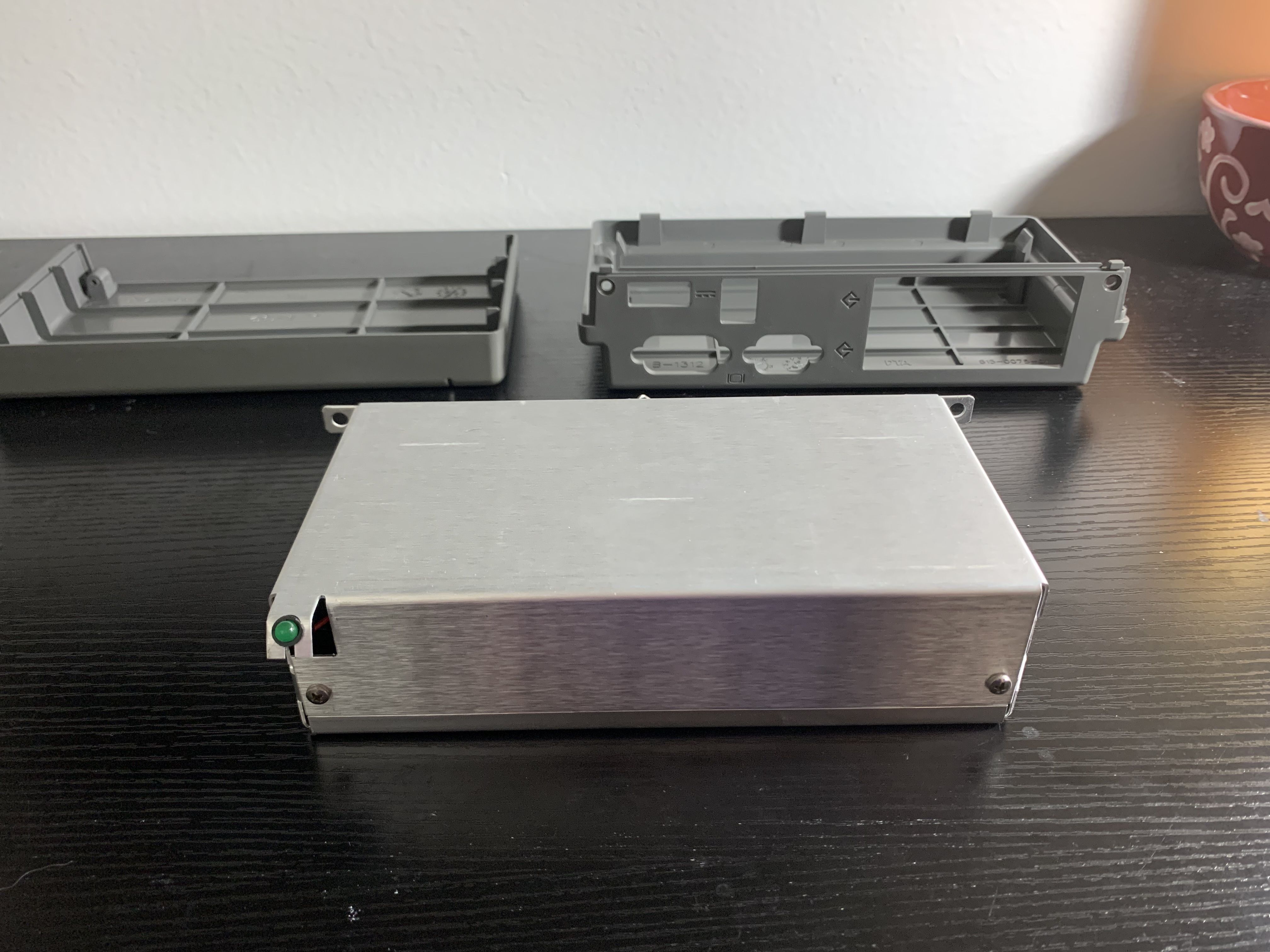

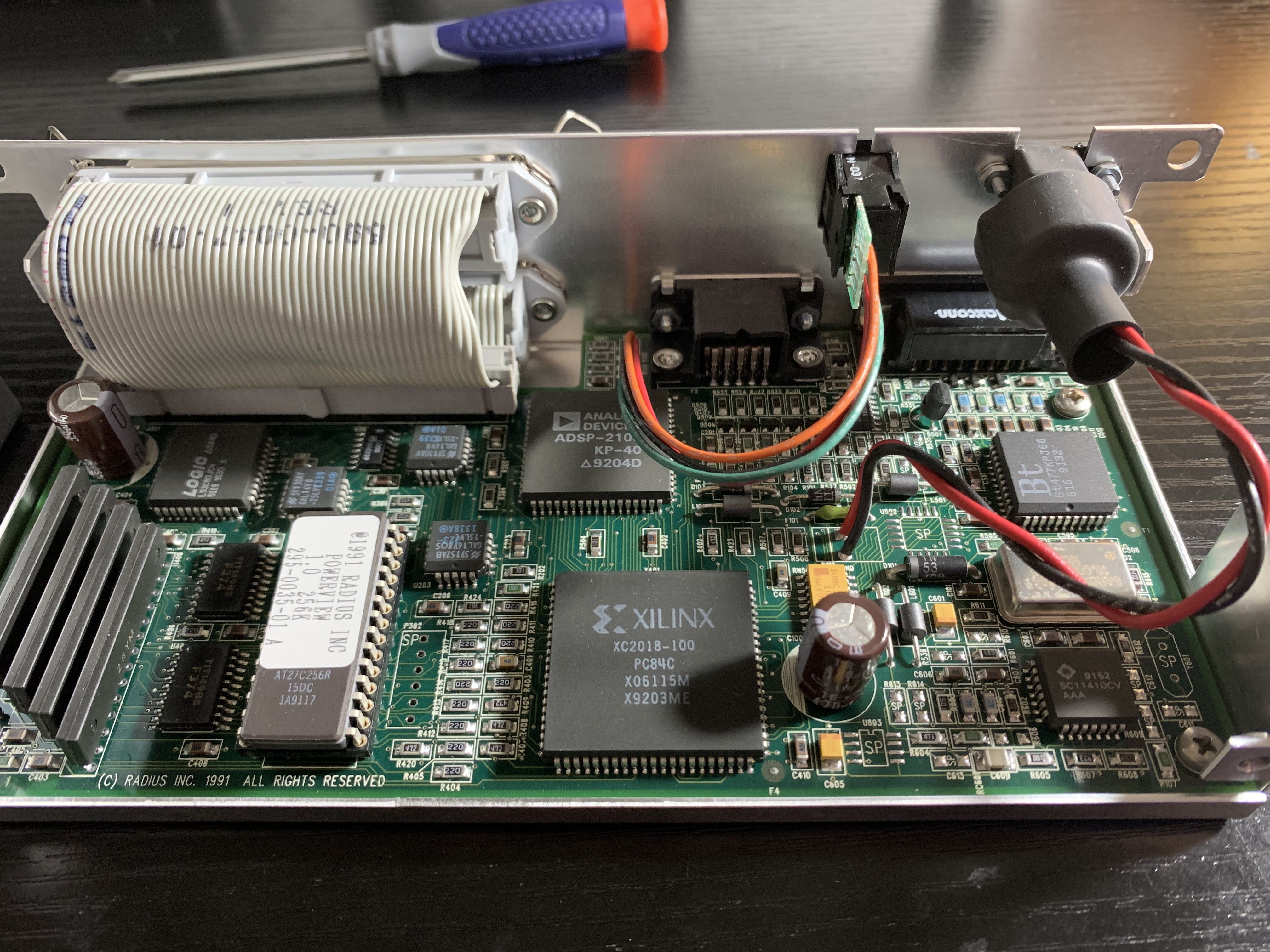

The PowerView will come apart by removing the two T-15 screws on the back. Three plastic clips on the inside of the front of the shell lock it in place.
Inside, there are clips on both sides of the metal box holding it to the shell. Releasing those will allow you to remove the metal box.
Two phillips head screws can be removed, and then the top shield can be removed. This is a lot harder than I was expecting as there are two clips that fit into the bottom shield, but then you have to flex the casing so that you can slide the top part off. I really wish I got a better photo of it.
However, then you're inside.

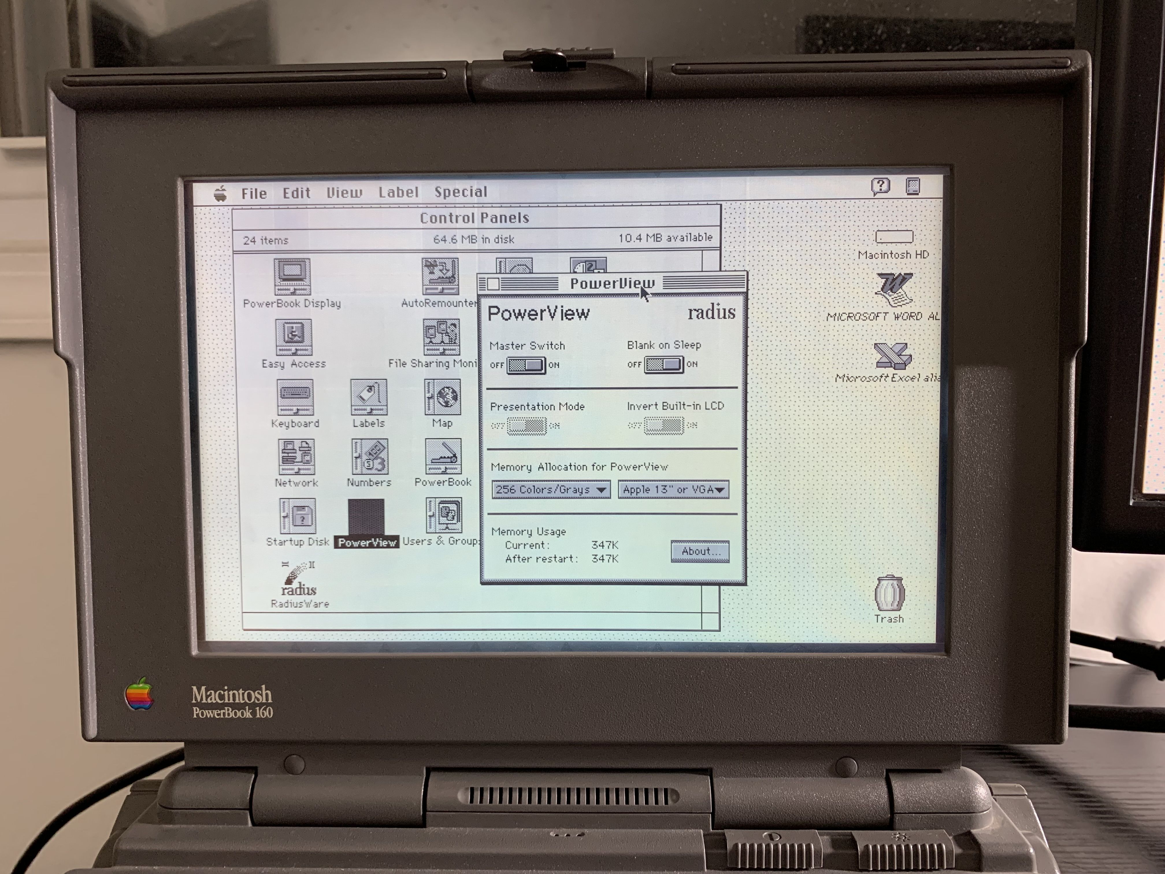

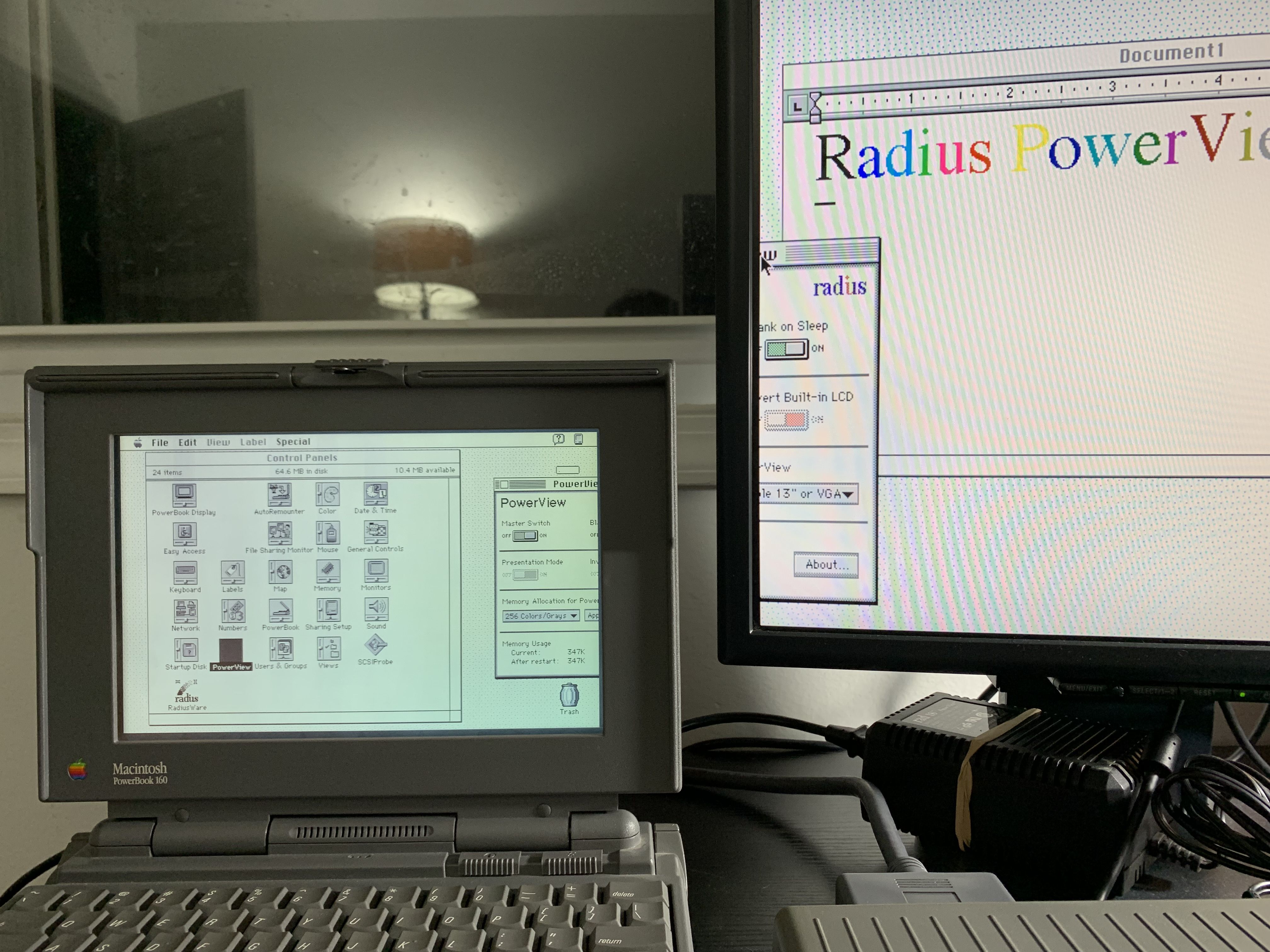

For some reason, Radius decided that you need to have the original disk in order to use the Installer. Even after using DiskDup the installer would ask for me to put the original PowerView disk in. As far as I can tell, it's just a script. The 2.1 software on MacintoshRepository works great. All you have to do is copy RadiusWare, PowerView, and SCSIProbe to your Control Panels folder, and then copy the Color Extensions file to your System folder.

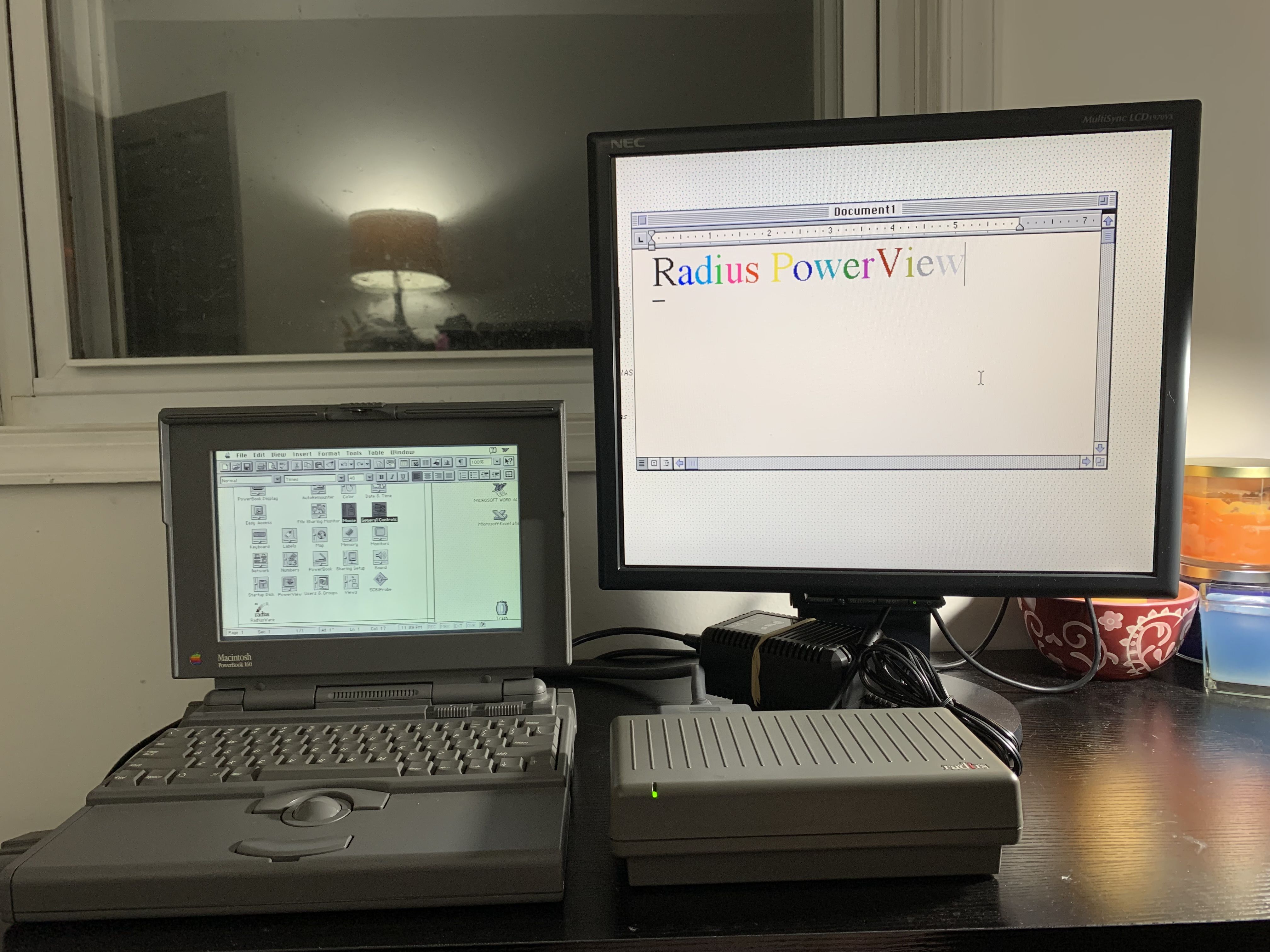

Connecting the PowerView
It's pretty self explanatory.
Using the PowerView
This is honestly pretty fun. I can't believe you're connecting it over what is usually just used for data transfer... I guess there was nothing stopping Radius from doing this, but it is a little ridiculous. Especially since I am connecting this to a passive-matrix 1-bit Mac.

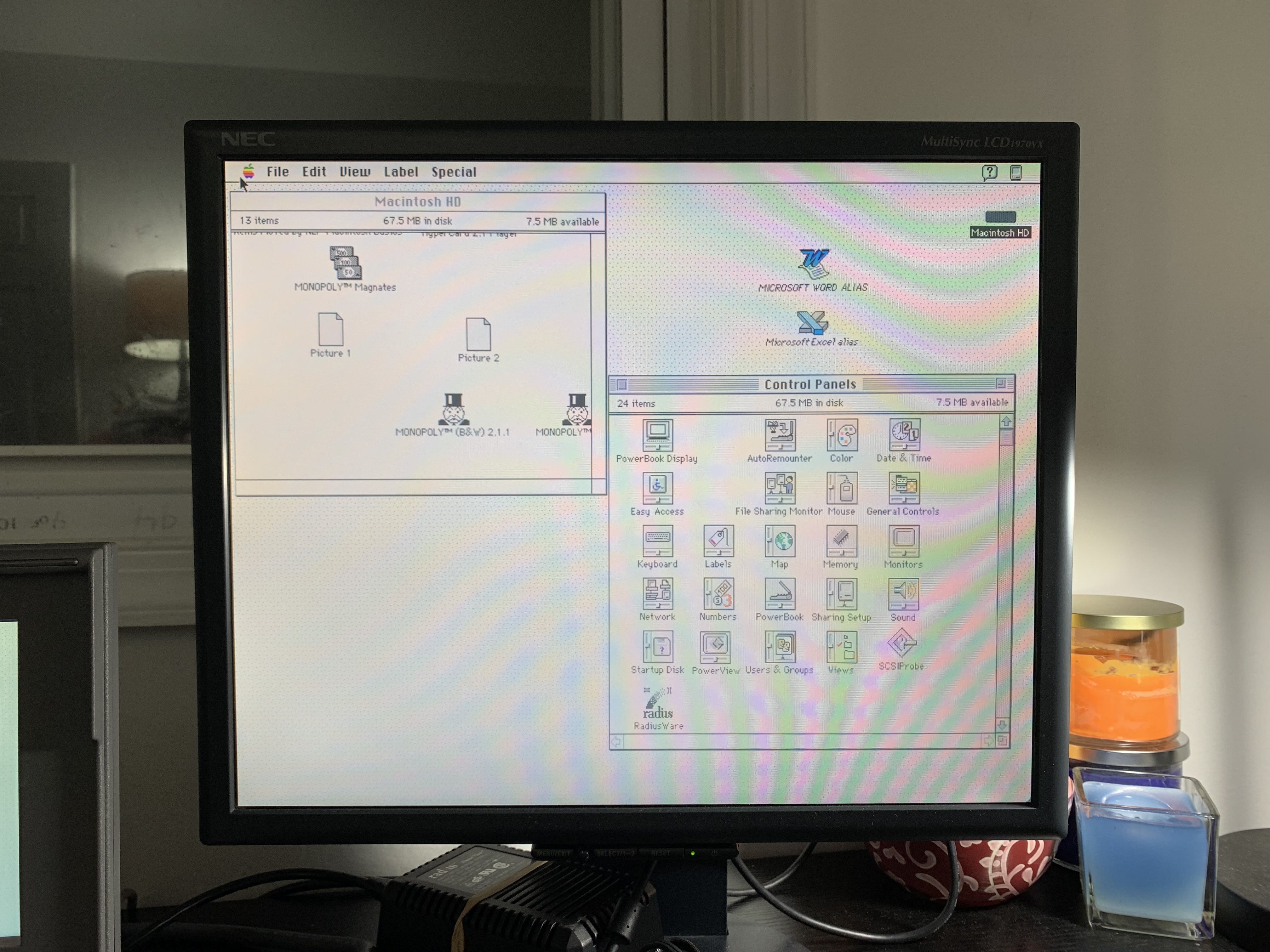

All of these are 640x480 at 256 colors.

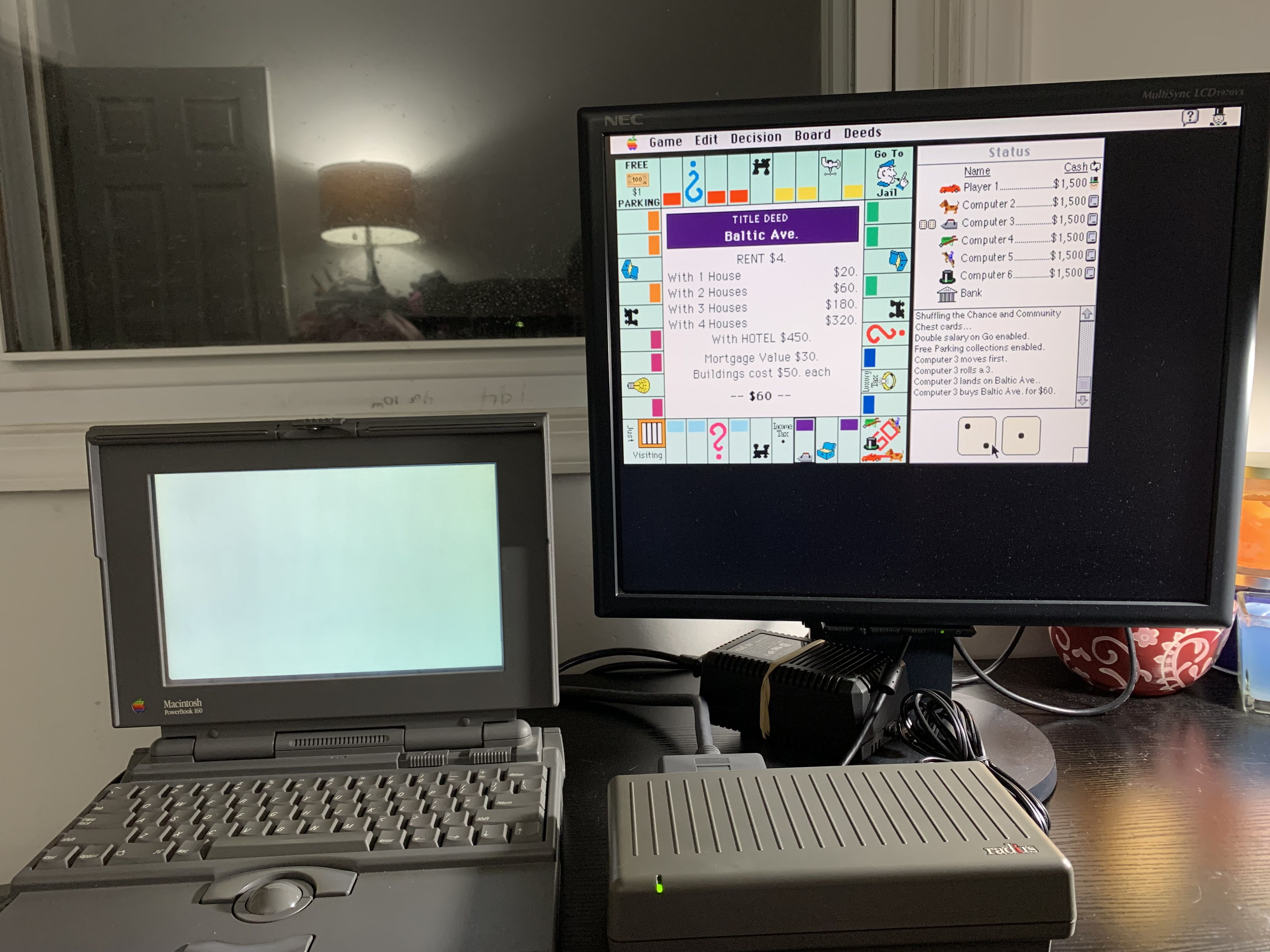

This is setting the secondary monitor as the main monitor

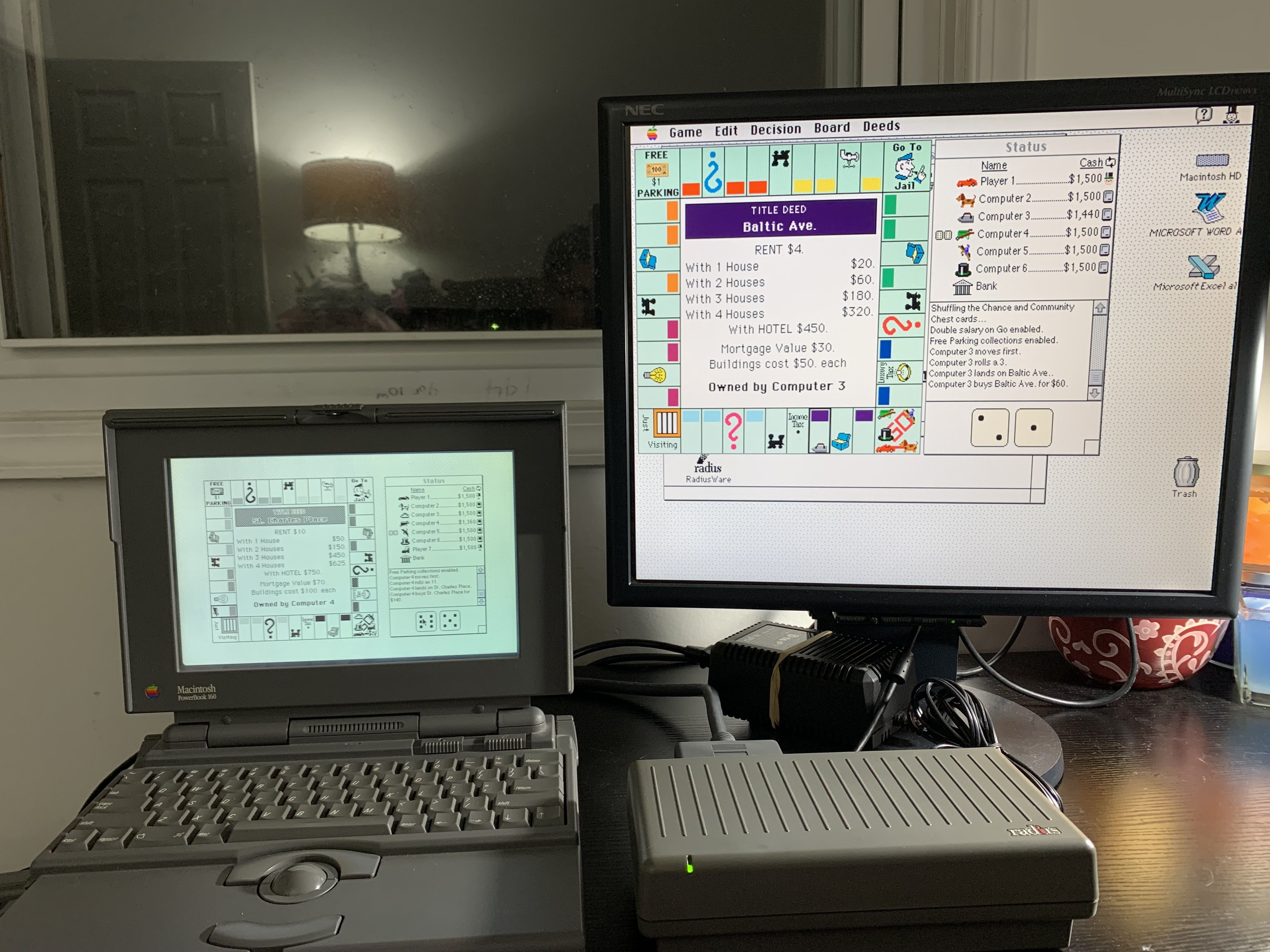

Who doesn't like some color Monopoly on a black and white PowerBook?
Not good enough?
Ok ok ok.
How about black and white Monopoly AND color Monopoly on a black and white Mac?

Now, I don't have an Apple sRGB display to test this with, but I was able to run it at 832x624 at 256 colors... But it was incredibly slow. I can't imagine getting any actual work done on this back in the 90's but I guess it had it's use cases. Even with screwing with the contrast settings on the LCD, it was still light on my monitor. The photos just don't do it justice.

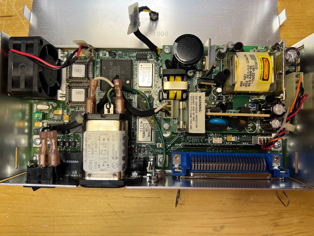

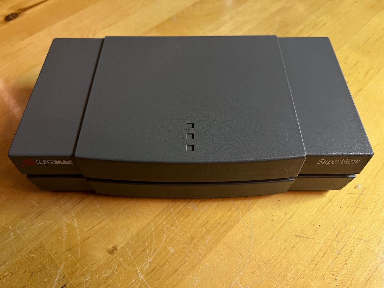

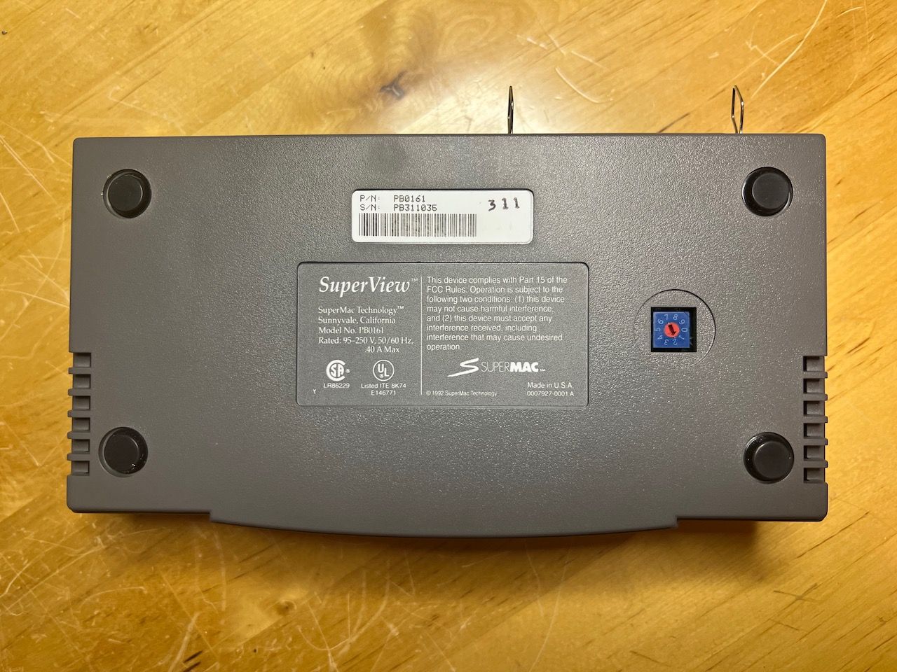

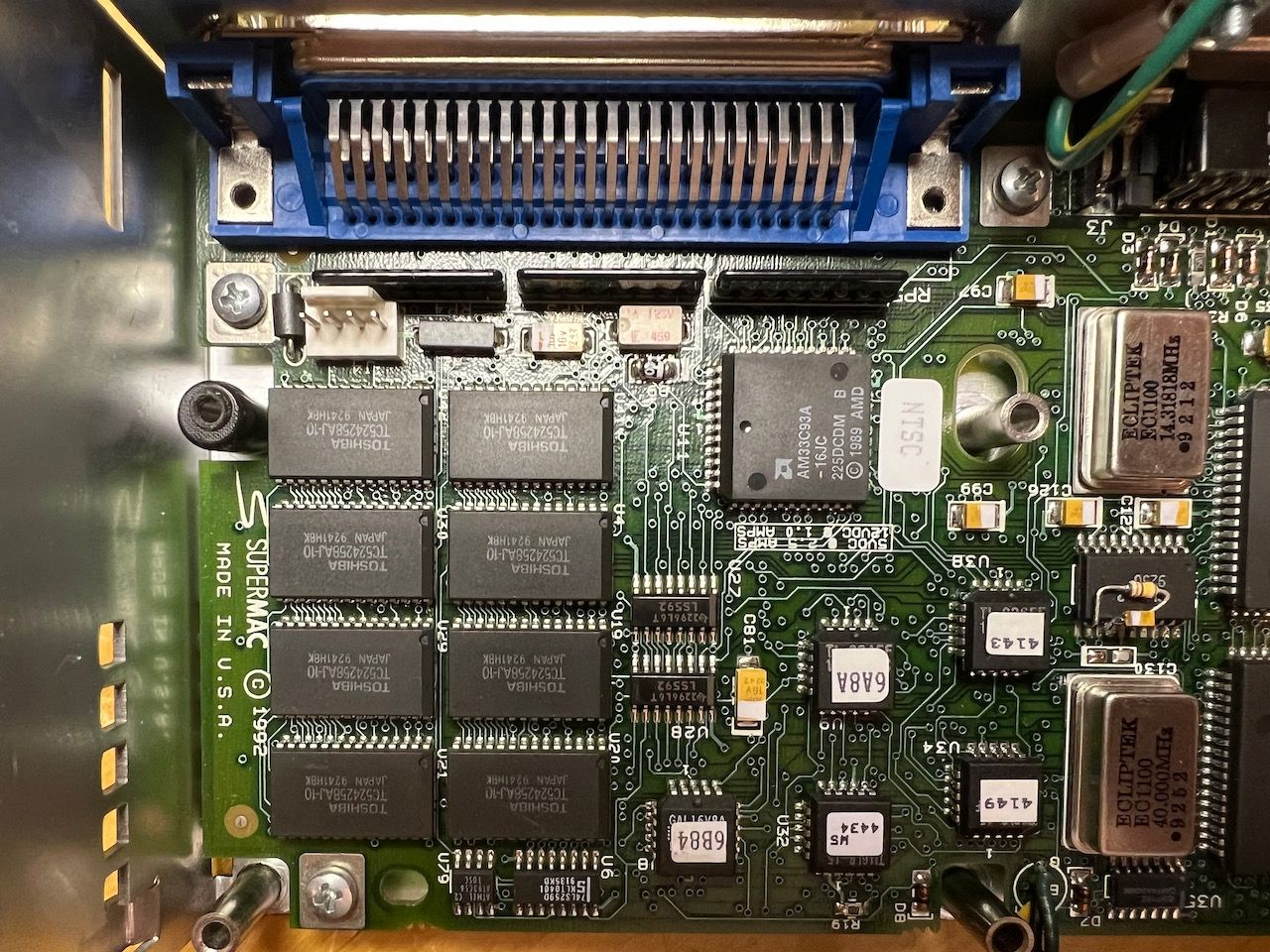

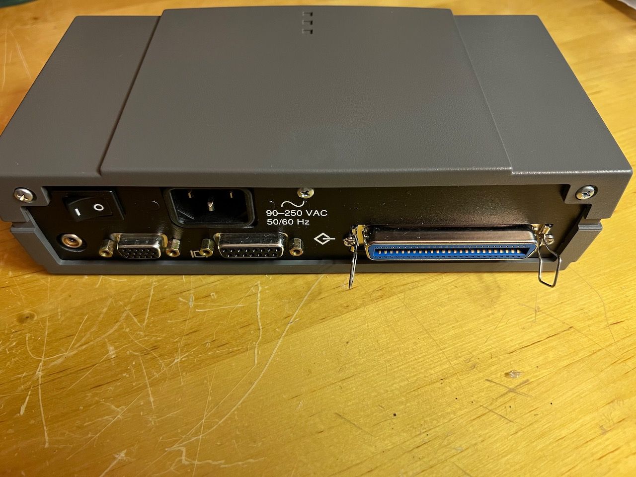

I just found almost the same product in my deep storage, but it is made by SuperMac. The SuperView! I dug up this old post since it is almost the same product.
It is interesting it only has one SCSI port with the ID selector on the bottom, internal power supply and composite video out. The manual says that it supports NTSC and PAL. It looks like this was possibly never used.

One interesting note of the TMS Gfx processor - The PowerView doesn't use ANY of its capabilities. The Mac does all of the video rendering in RAM, then copies the frame buffer over SCSI. They could have made the performance SOOO much better if they had actually used the Graphics chip as it was intended.

Have you tried the driver on other Mac types? The PowerView driver I used will only work with a small subset of Macs (officially), like the Classic, SE and a couple PowerBook variants. You can make it work by faking out the Gesault (with WishIWere) on other systems (like the LC 475).
