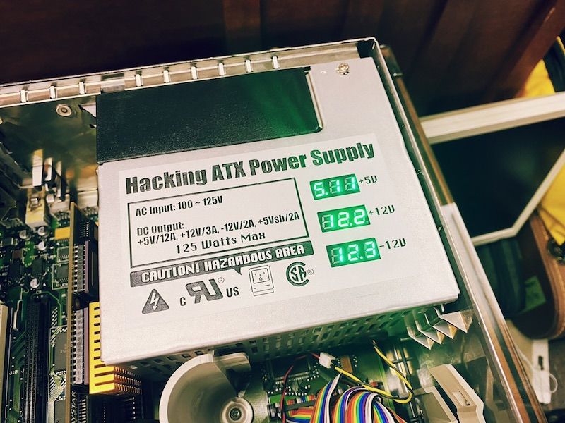

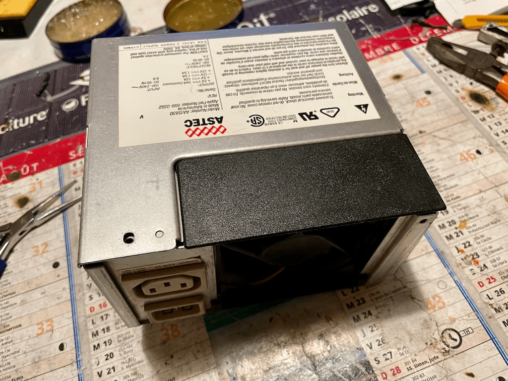

Here's my attempt at a 'stealth' IIci PSU, which uses a 250W Seasonic SFX unit inside the original housing. I even moved the Seasonic sticker across to replace the Astec one, so it looks like it's always been this way.
The Seasonic PSU has a built-in thermometer sensor so the fan speed is controlled from that.
Since replacing my PSU, I've had no issues with soft power - it acts really fast when the ADB keyboard power key is pressed, just as it should.

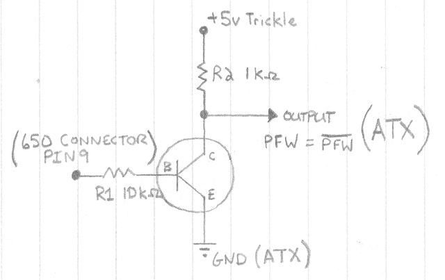

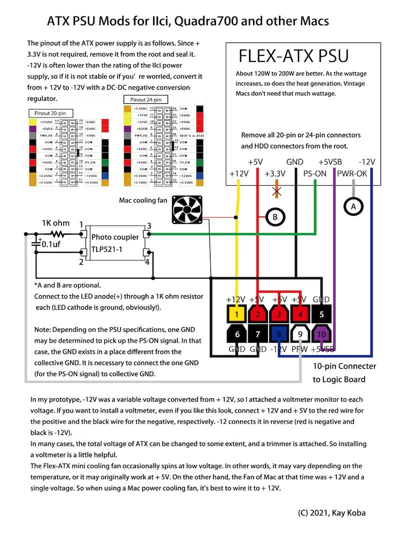

The soft power circuit I used:

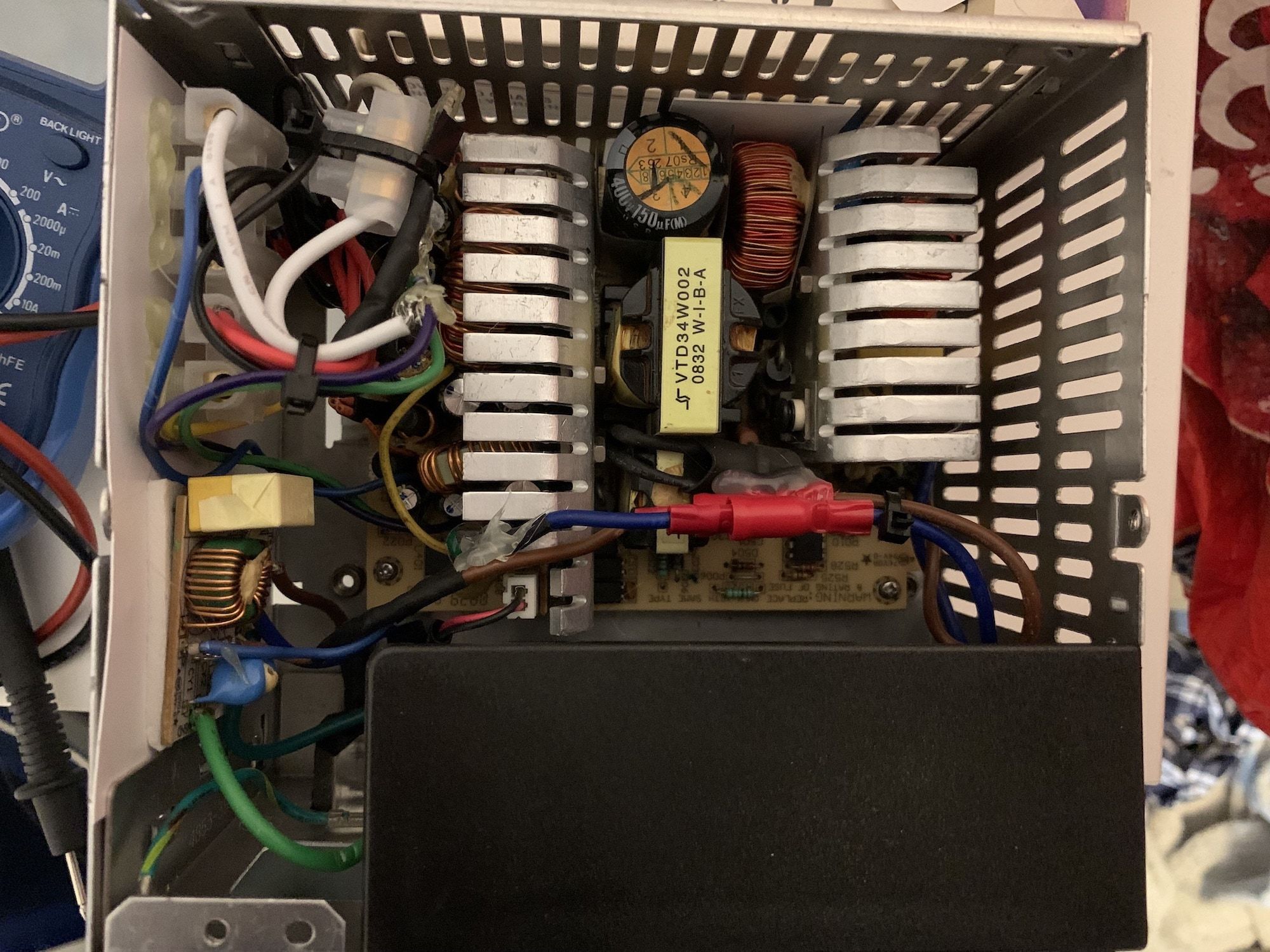

My original PSU:

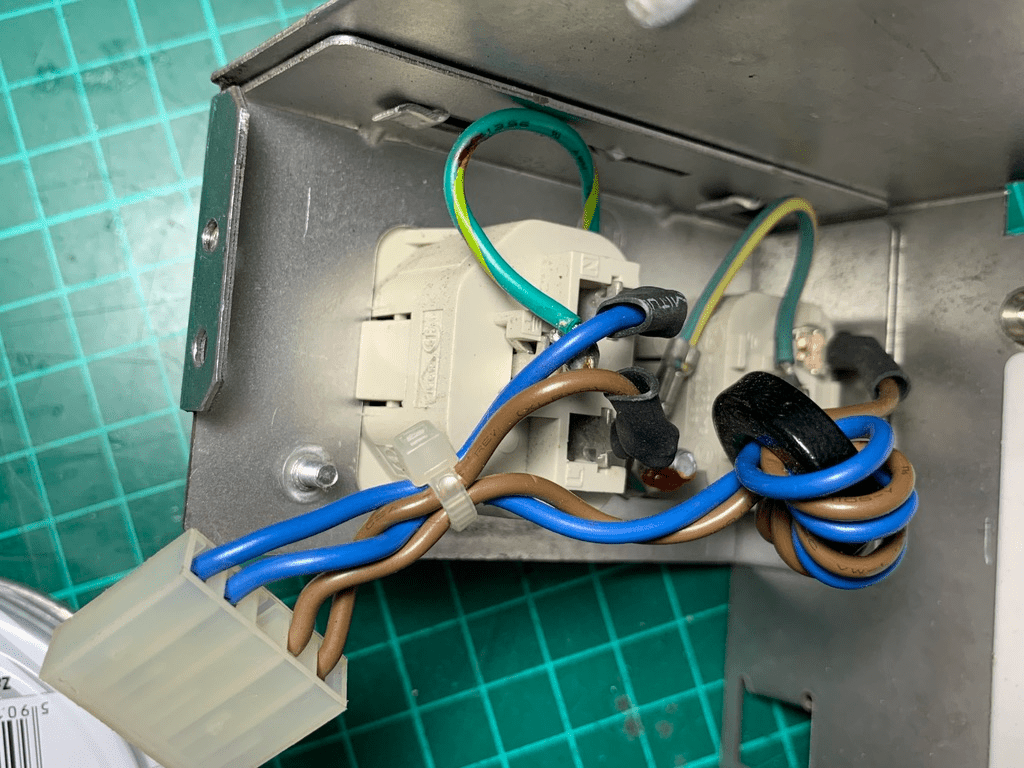

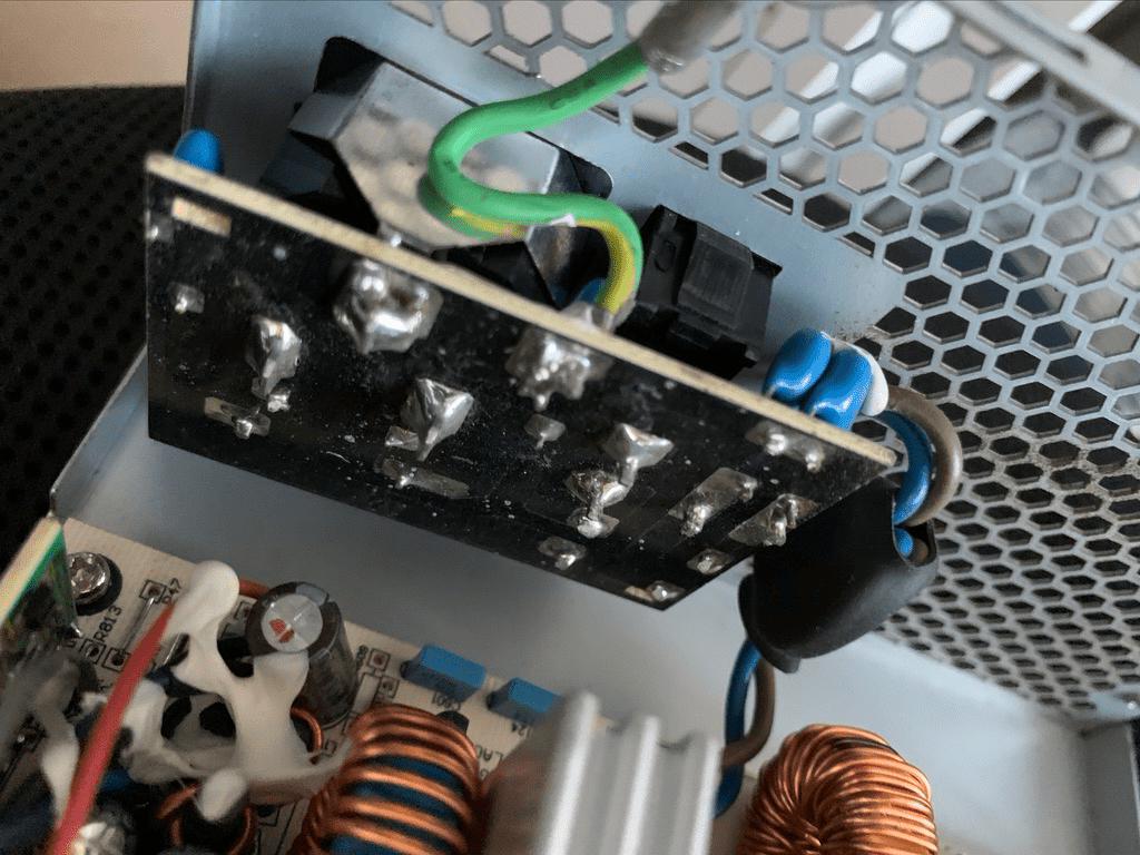

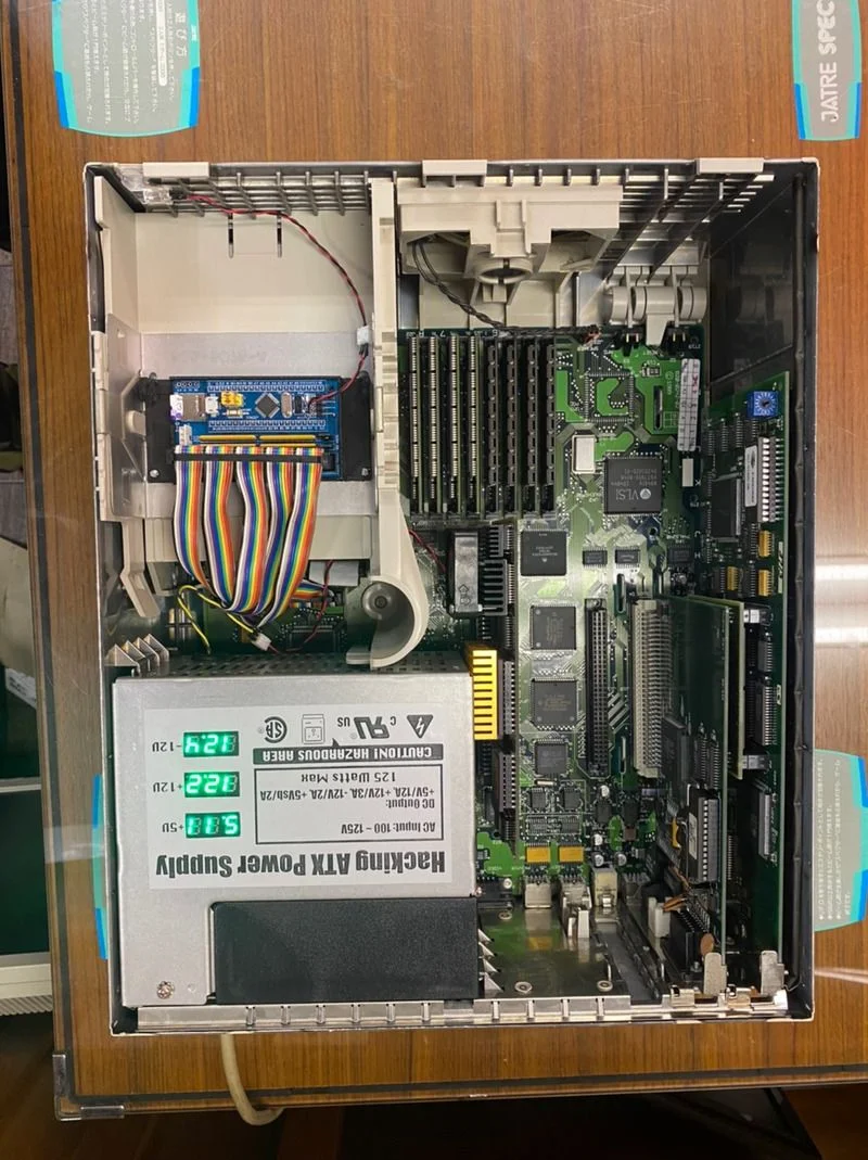

The Seasonic had its own filtering on the back of the AC socket, so I moved this across to the Astec housing.
The original Astec sockets were removed:
I installed new stand-offs into the bottom of the Astec housing. Went through two drill bits doing that, oops. But this meant I could dispose of the Seasonic PSU housing and just keep the Seasonic PCB and move that into the Astec housing.
Here it is all wired up to the original motherboard connector:
And all done, you can't tell anything was ever changed.
I saw your circuit. Our Beezul-Bulb LED switching board made for Blue SCSI was almost the same, so I tred your method.
I experimented with a cheap, unnamed switching power supply and it worked fine. I was delighted that Beezul-Bulb could be used for other purposes ...
Then I used the new AcBel 600W power supply. However, in the case of this PSU, the operating conditions of Power-ON are different, so in the case of an inverting circuit using transistors, the power cannot be turned off.
What this means is that even if the power is turned off, it will be turned off for a moment and then turned on again. It's just like Restart. In the case of a high-end power supply, this is probably because the power is turned on by the differential input of the operational amplifier.
I will try the circuit using the opt coupler tomorrow or the day after tomorrow under the same conditions.
After adding the diode, It was able to shut down stably!!! Beezul-Bulb wasn't wasted! Schematics very soon!
