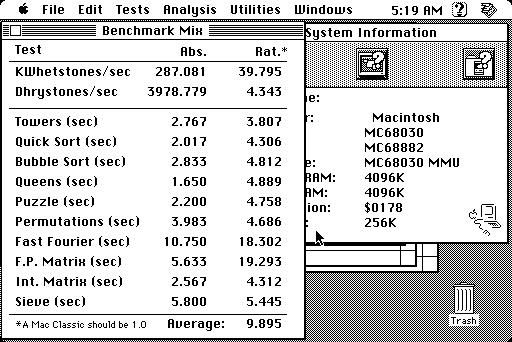

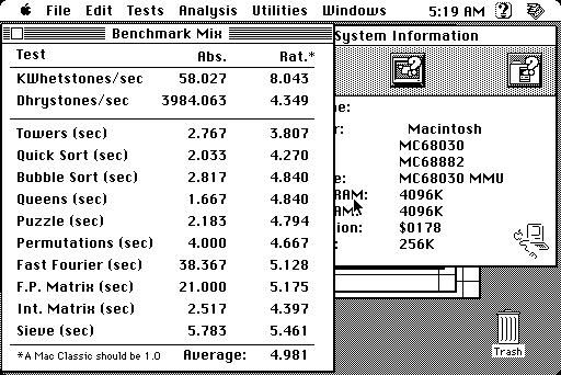

As to SANE and the SpeedCard control panel, we'll based on the article you posted, I guess Excel can use the 68881, and I guess the SANE setting does use the FPU in some operations, but it certainly doesn't use them in any of the benchmarks that I can see.
