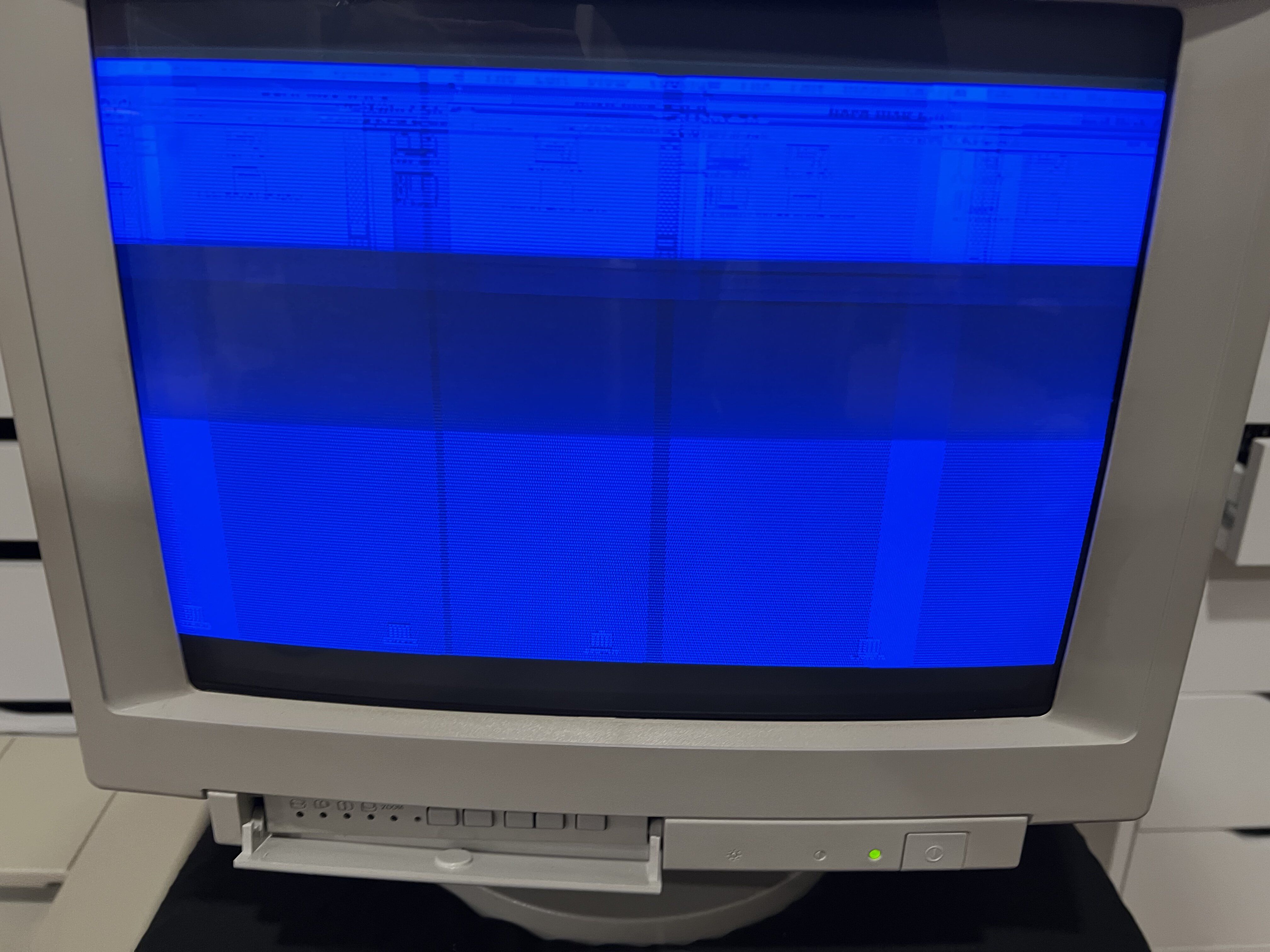

I actually had my Apple 15" multi-scan display with HD-15 cable around, so I hooked it up to see what it would do. I do get a picture, but it is blue and distorted (resolution / refresh rate difference?). I can see the image well enough to move windows around, and even move the windows between the external monitor and the built-in CRT. Is the radius card set to output a particular, portrait resolution that the CRT isn't set to handle? Are there any multi-sync LCDs that work well for this, as I would love to have a monitor I could use as the external monitor with this SE (something reasonable until I can get my hands on a compatible portrait display.

I don't have any portrait CRTs to try, but it seems like if Radius switched to Apple's preferred connector, it would make sense it was so you could use it with Apple's portrait display. See pictures for how the screen looks

Multi Scan is not MultiSync AFAIK. Sounds like it's doing its best, but not very close given available pre-sets on that list. Something like a Dell UltraSync(?) LCD should be part of every retro tool kit. They sync to just about anything thrown at them, but not quite just right on the Radius TPD/SE. I have three high end multisync CRTs, but only one did a bang up job, so . . .

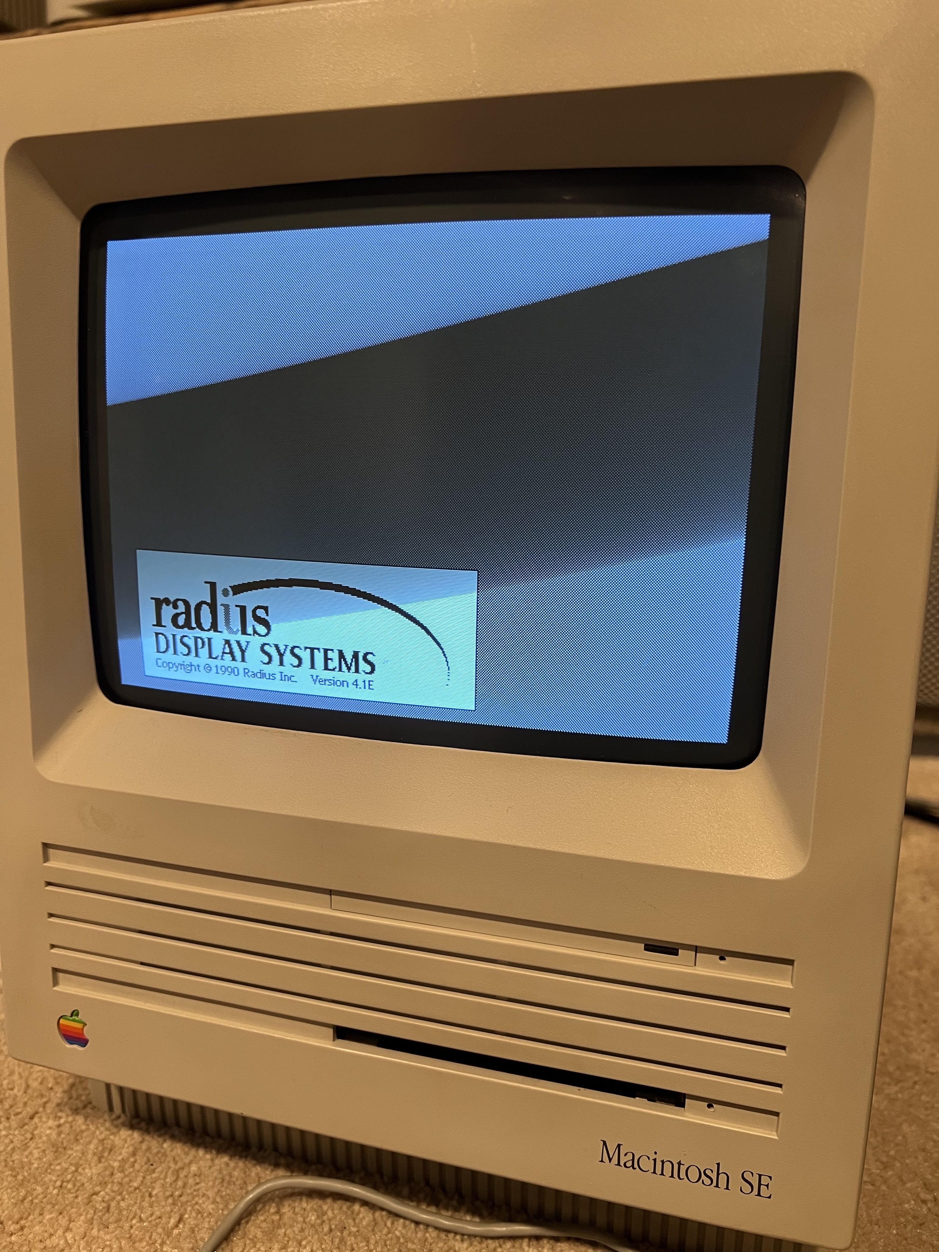

OK, finally got my HDMI scaler. Unfortunately, it appears my HD died in the meantime. So I threw a 6.0.8 image on a BlueSCSI. I still get the Radius image on boot, so the ROM appears to be loading (I assume that's what it means) version 4.1E.

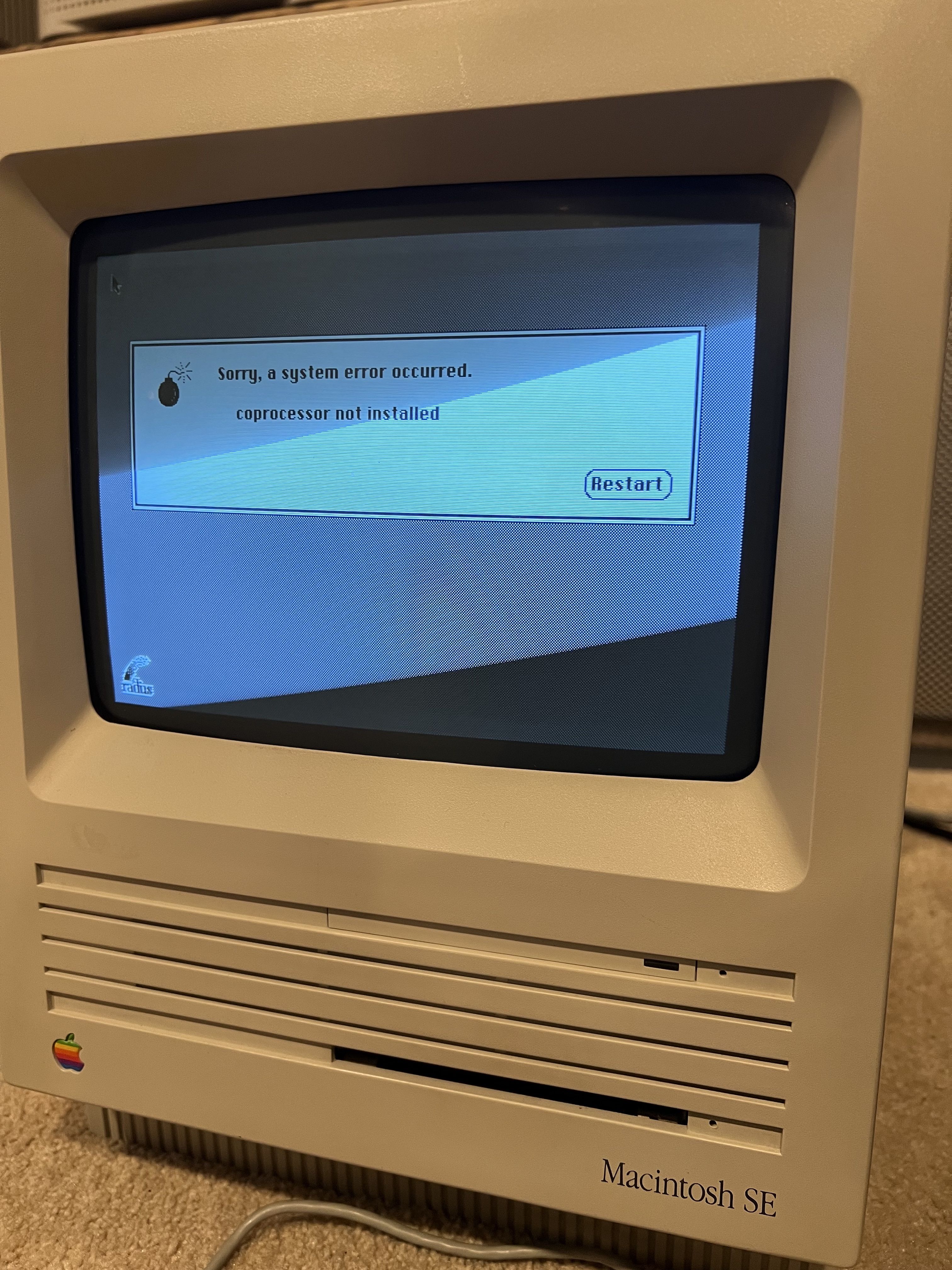

Unfortunately, I can't seem to get it to output video on the external connector. I found some radius system software (https://macintoshgarden.org/apps/radiusware-1990-displays-41-accelerator-29-radiusmath-15) and installed it, but when I boot with the "Classic/SE/+ Display" extension in the System folder, Upon boot up, when the extension loads, I get the "coprocessor not installed" error message:
I only have the display card, not the accelerator board that Radius also offered. Also, when installing, it seemed to know what to install because it only installed the "Classic/SE/+ Display" extension.
Any ideas on if I'm using the wrong software, or if there are other things to try? I did confirm the board was properly seated and the pins all looked good.
