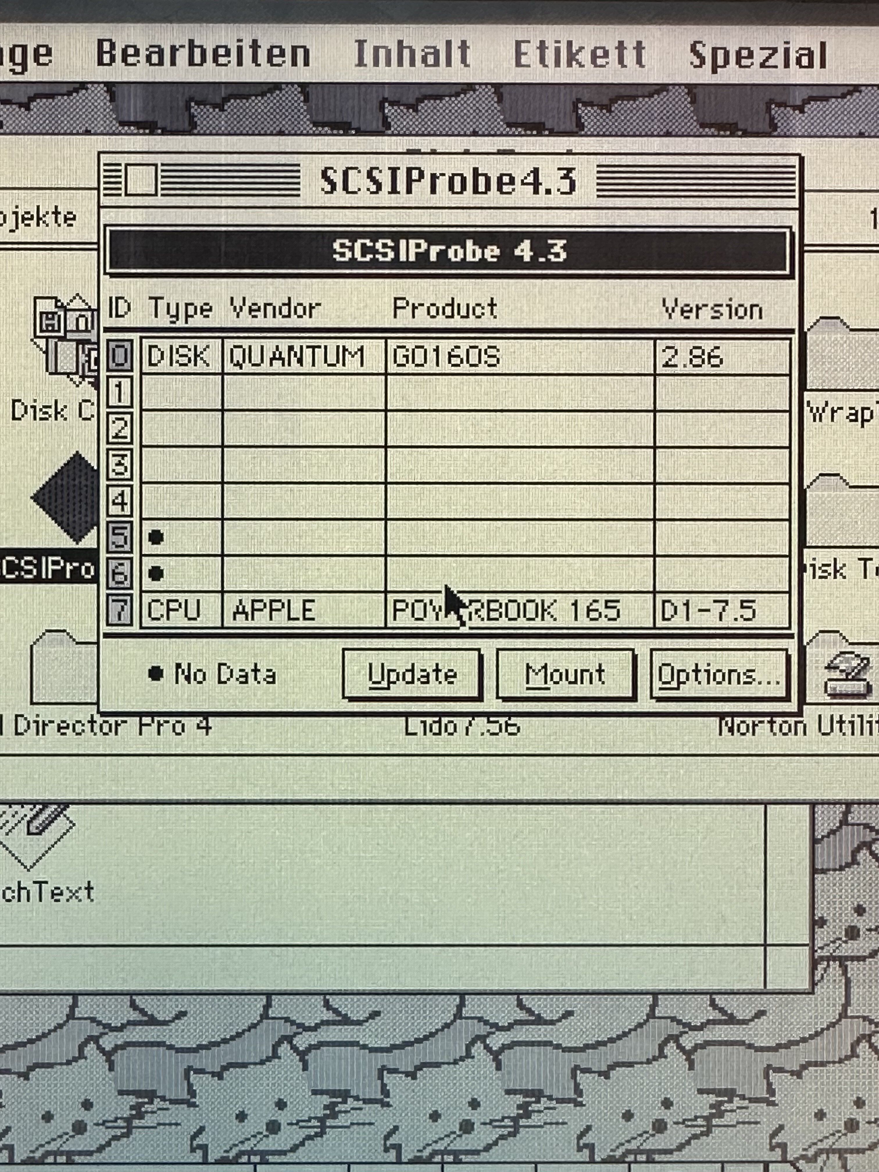

This is what I see in SCSIProbe:
ID 5 is a disk image
ID 6 is the DaynaPort adapter.

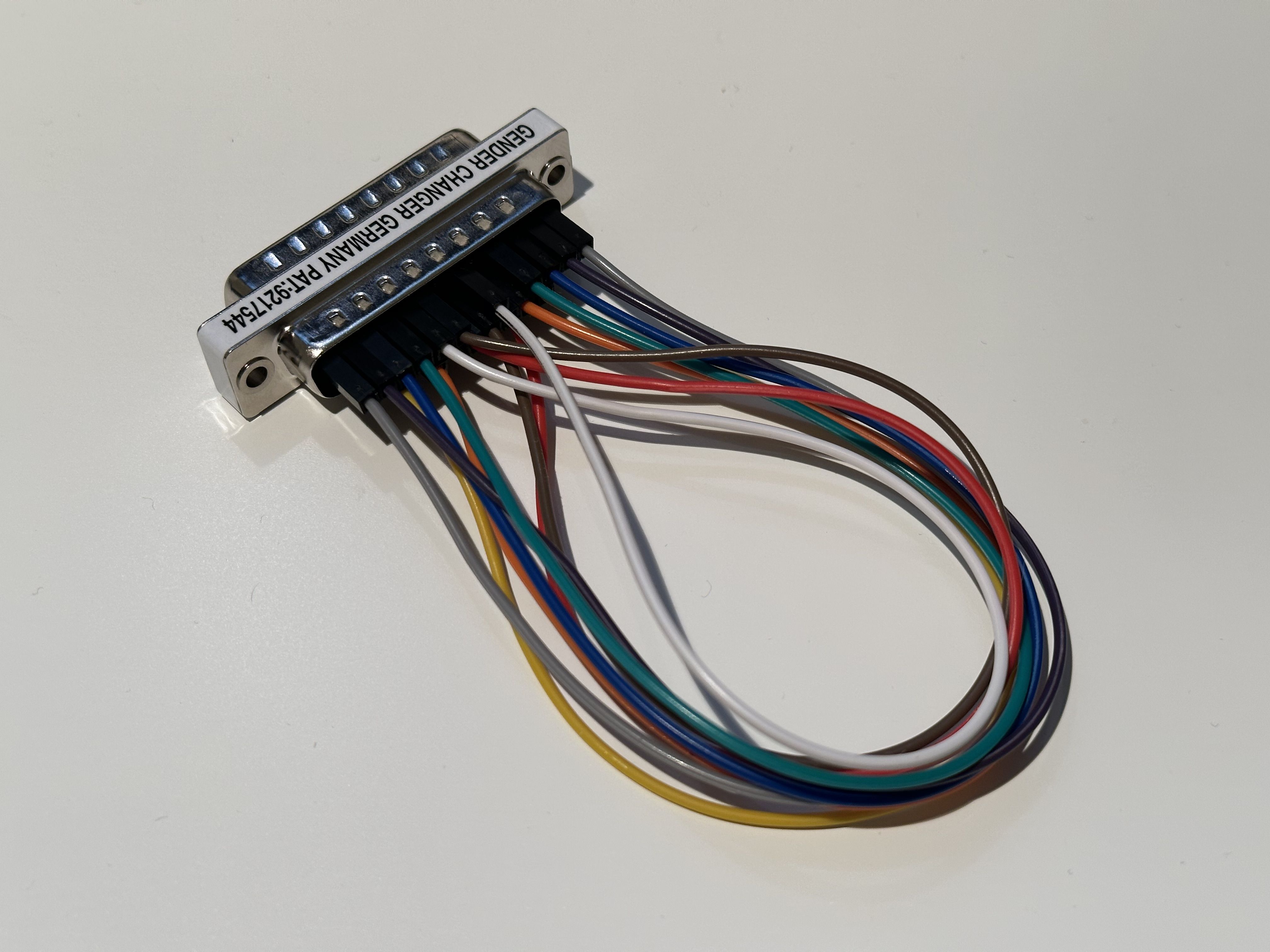

Next I got a set of jumper leads to create a loopback cable as described in the troubleshooting guide...
The result of the loopback test was:
Code:
pi@RaSCSI:~/RASCSI/python/loopback_test $ python3 test.py
Error: GPIO D0 should drive ACK low, but did not
Error: GPIO D1 should drive SEL low, but did not
Error: GPIO D2 should drive ATN low, but did not
Error: GPIO D3 should drive RST low, but did not
Error: GPIO D4 should drive CD low, but did not
Error: GPIO D5 should drive IO low, but did not
Error: GPIO D6 should drive MSG low, but did not
Error: GPIO D7 should drive REQ low, but did not
Error: GPIO DP should drive BSY low, but did not
!!!!!!!! Test FAILED !!!!!!!!
Total errors: 9

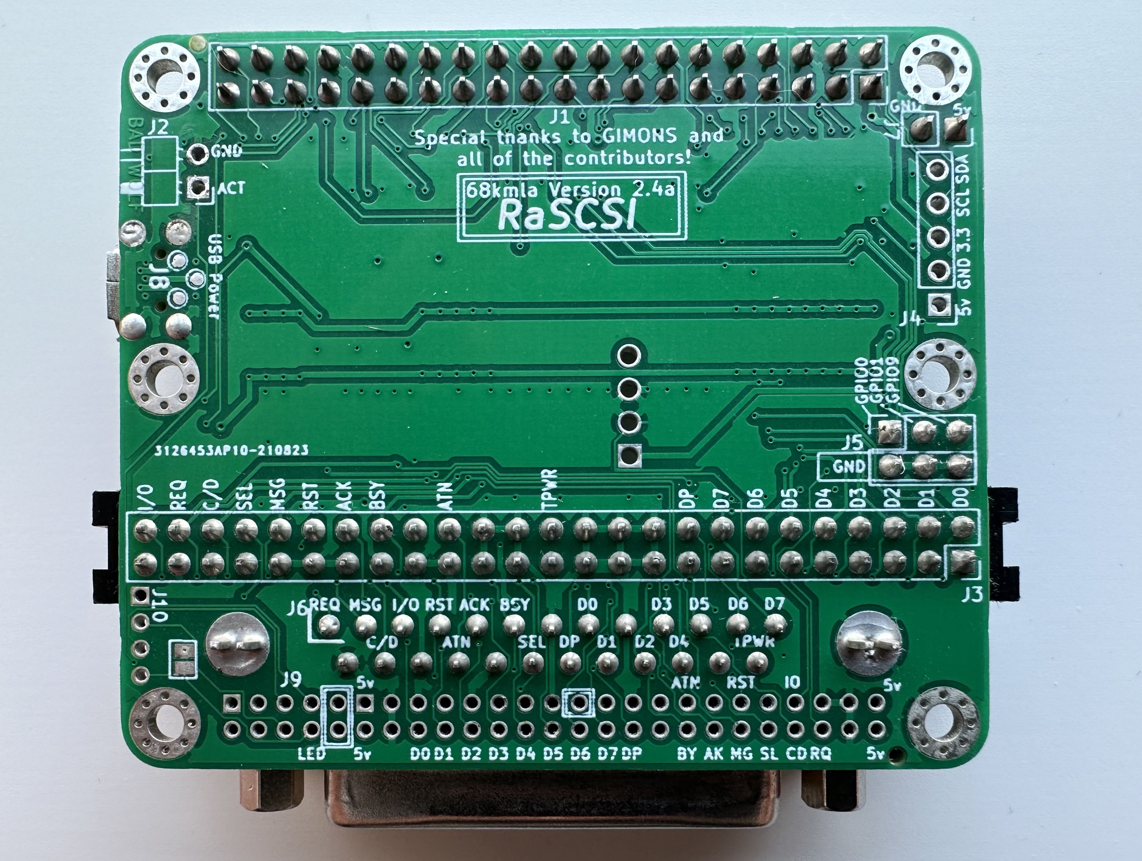

Apparently I lost the D signal/voltage. I just measured the voltages on the underside of the PCB. D0 to DP were all around 3.08V as stated in the troubleshooting guide, TPWR was 4.9V.

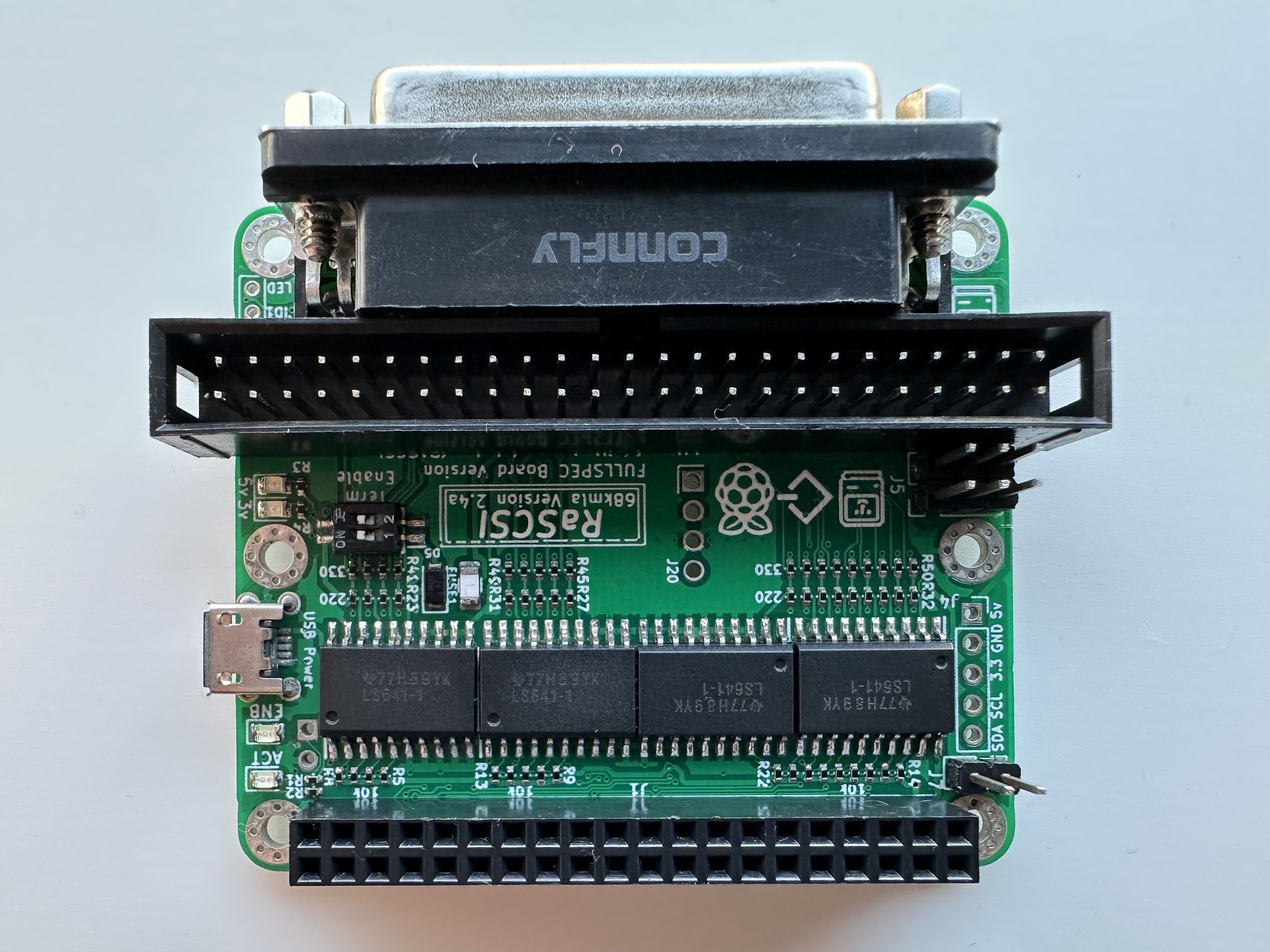

Do you have a multimeter that you could put on pin 24 (gpio8) to see if it is toggling high/low when you run the loopback test? Also, do a visual inspection of all of the pins (especially pin 24) to make sure that there aren't any cold solder joints. Feel free to post close-up pictures of your board too. Maybe there is something we can see?
Thanks for the help!
I just did resolder the transceivers before and now I also went over all of the GPIO pins on the pi and the RaSCSI.
The loopback test still fails with the same result as above. Pin 24 (GPIO 8) does fluctuate during the test between 1.6 and 2.9V.
The light sucks right now, but here are some pictures of the board I took a few hours ago before I went over the GPIO pins:

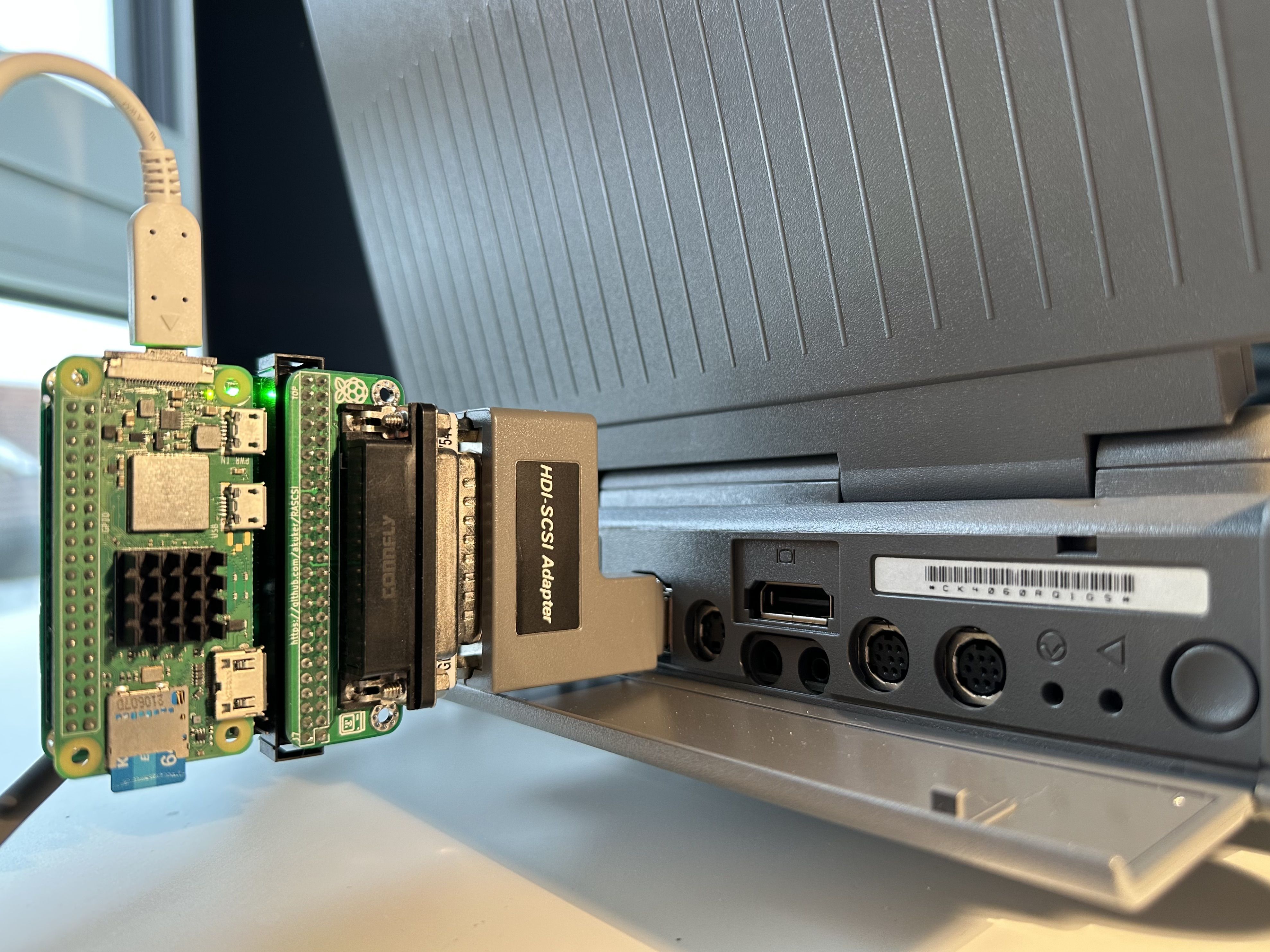

Also, for fun here's a picture of the RaSCSI when it was still working hooked up to my "new" PowerBook 165. Dongle mania isn't a new thing for Apple users.
