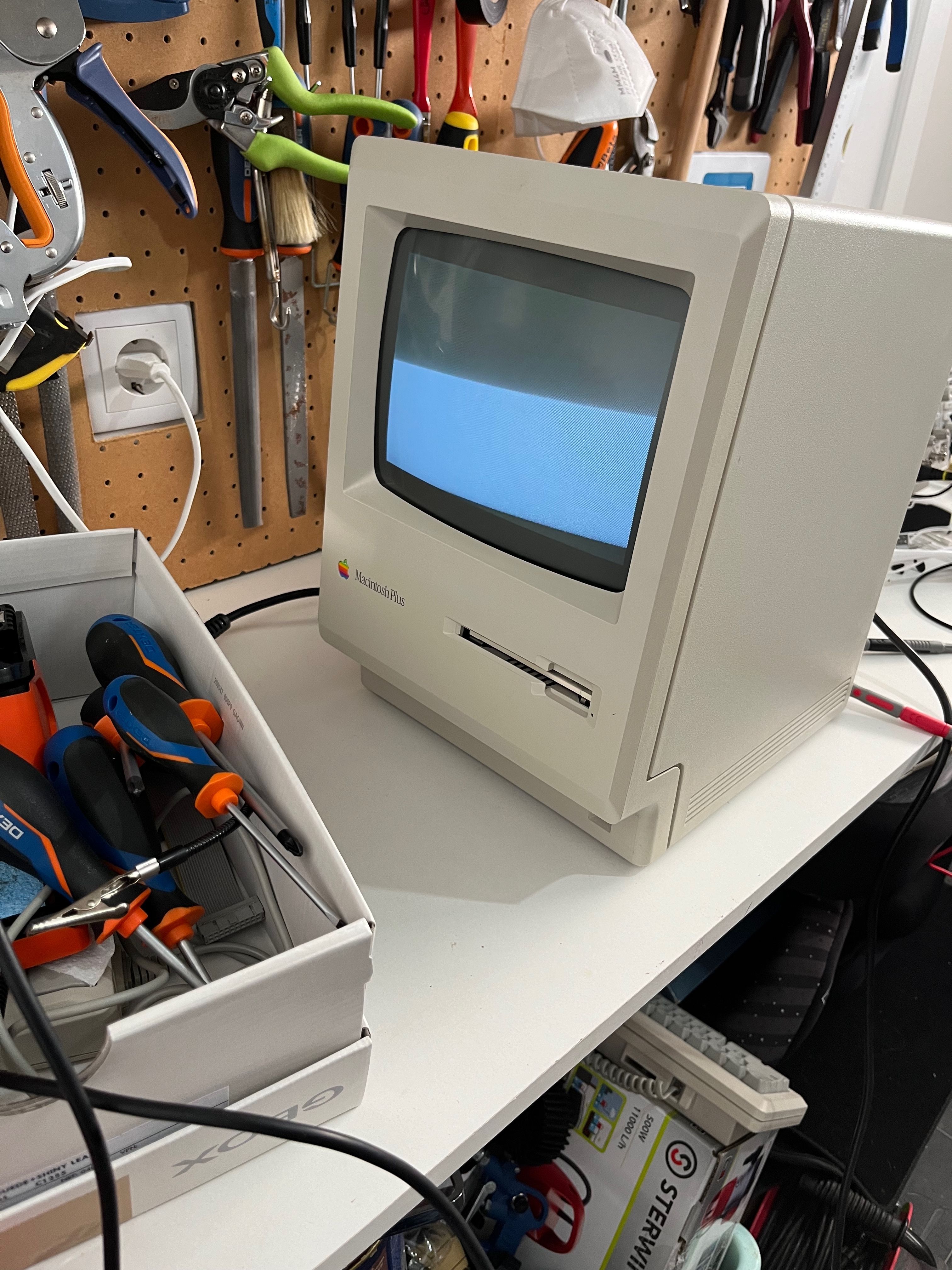

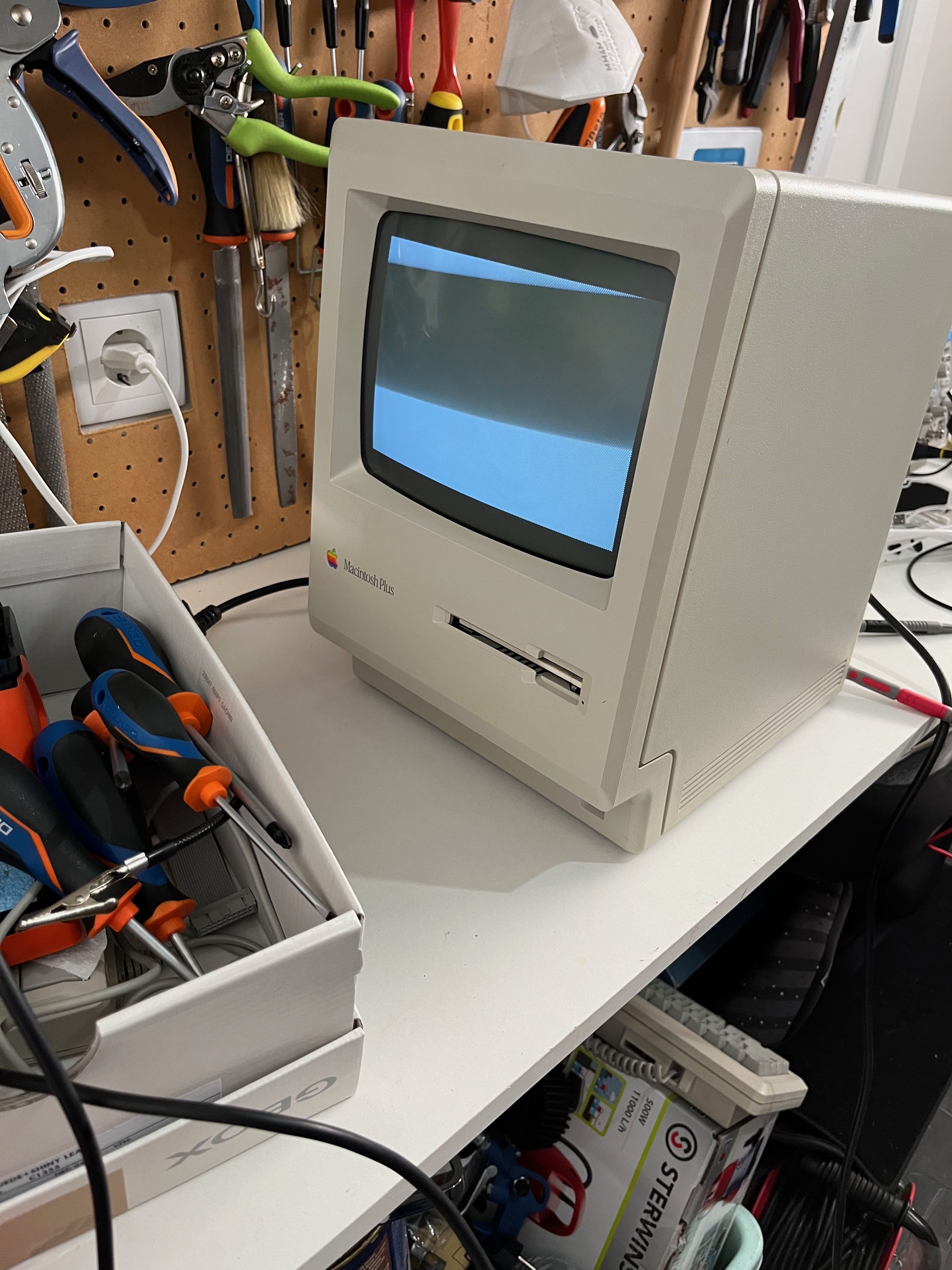

After all, I was getting video, but the brightness potentiometer was on the low setting... my bad... :-\
When it turns on, the voltages at the FDD port are -12,14V +12,10 V and 5,01 V.
There are no strange noises or hissing. It's completely silent.
I don't get the turn on chime, neither the FDD seeks or rotates, although it has a startup disk inside.
I get a stable and sharp video but only with the desktop pattern.
There's no happy or sad mac icon, neither mouse pointer, nothing....

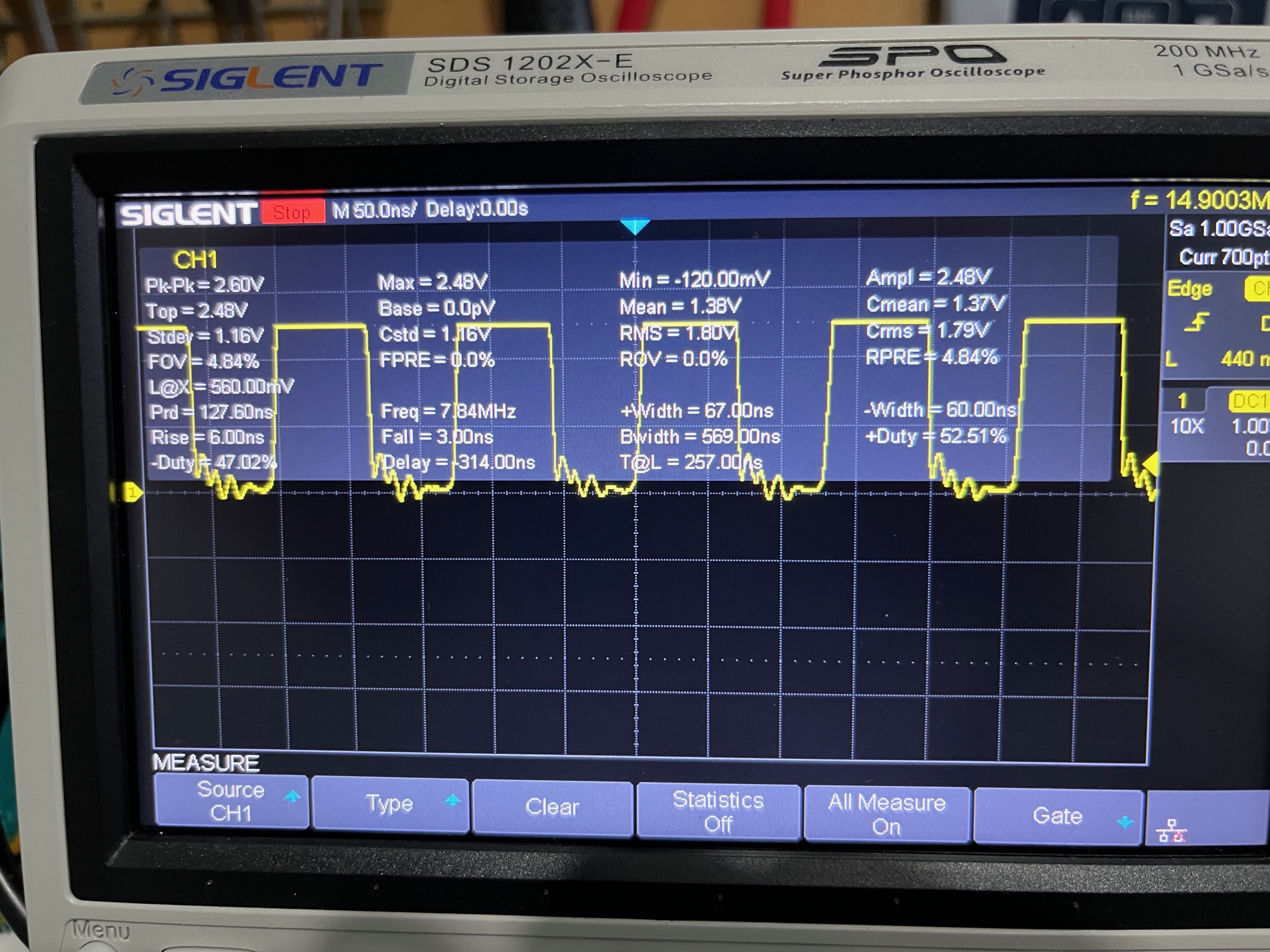

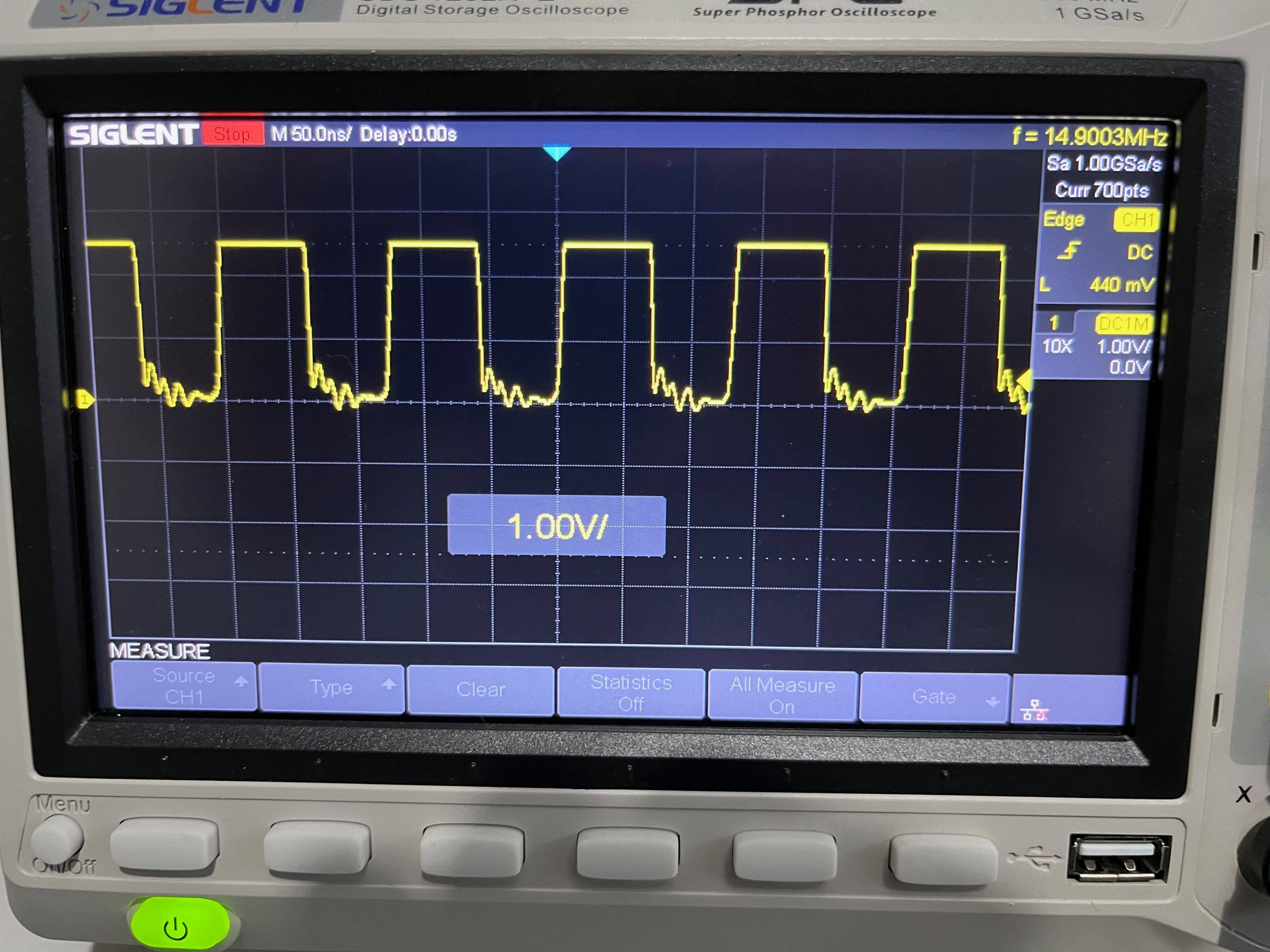

I've checked the clock signal at CPU pin 15 and got the results shown on the attached files.
I don't have a working machine to compare waveforms, does any one can confirm if the readings I got are normal?

Just did a quick search and this discussion while discussing a lot of what you have already covered mentions that the PRAM battery could be an issue. I quickly reviewed the schematics for the plus and I got no clarity on the CLK signal at pin 15. Perhaps someone else can answer that one?

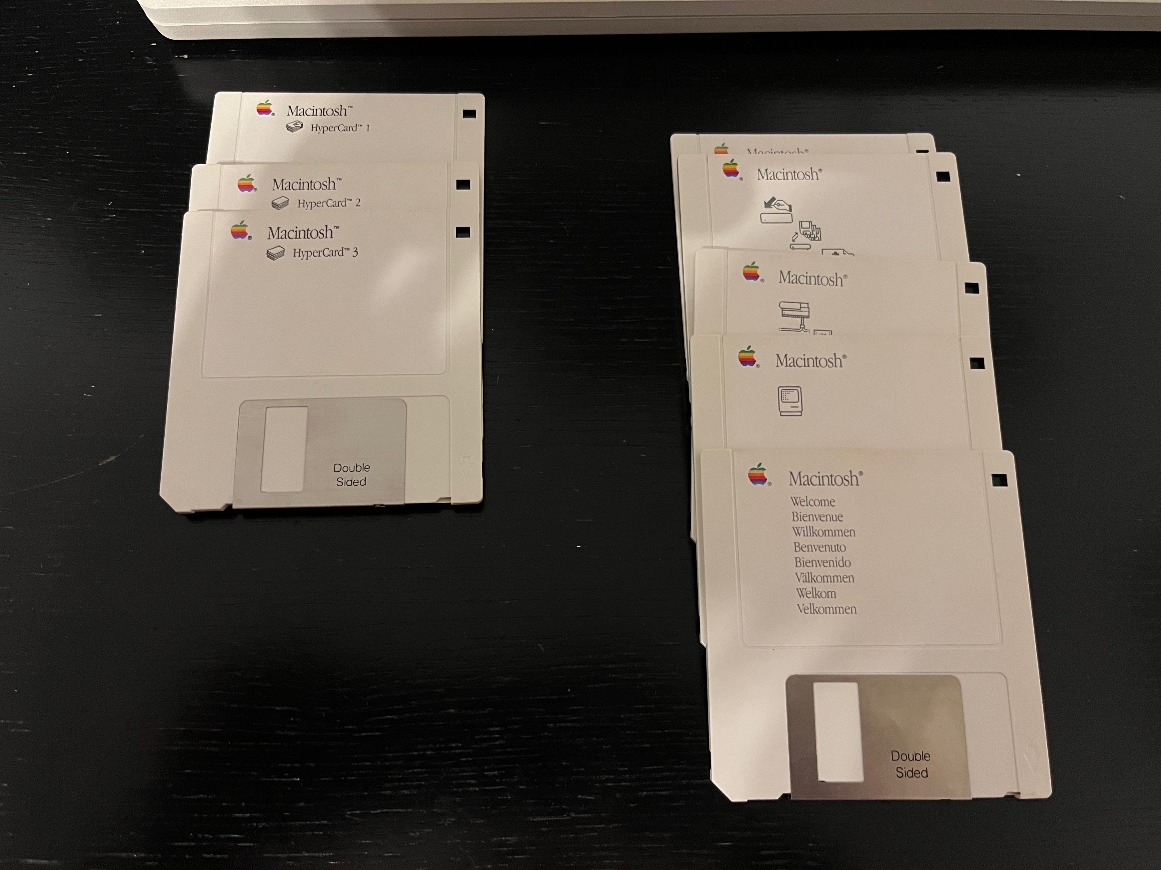

I even managed to restore to fully working order the original set of Apple System Disks.
Cleaned them up with Isopropyl alcohol and a cotton stick.
They're in perfect condition. (y)

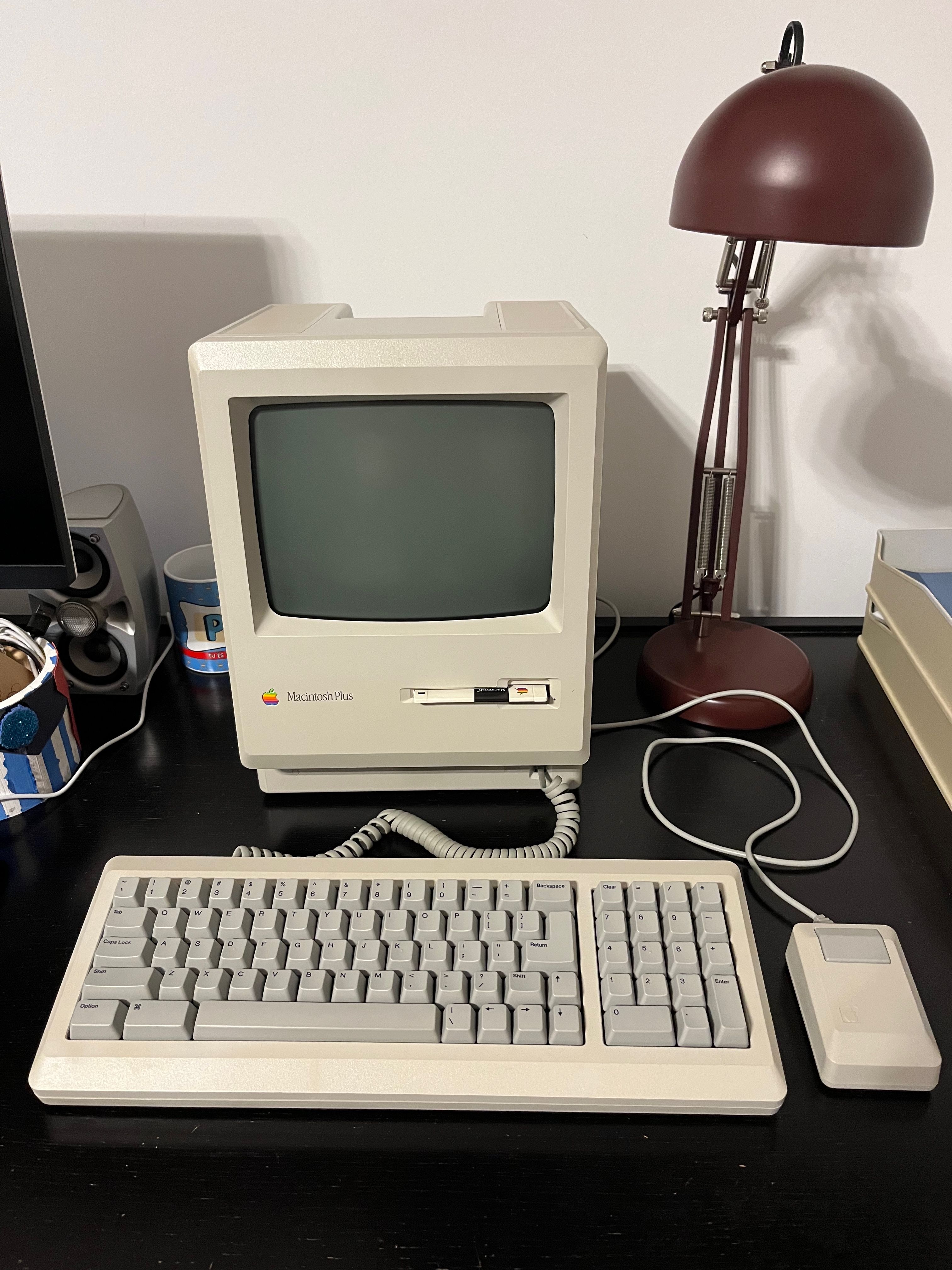

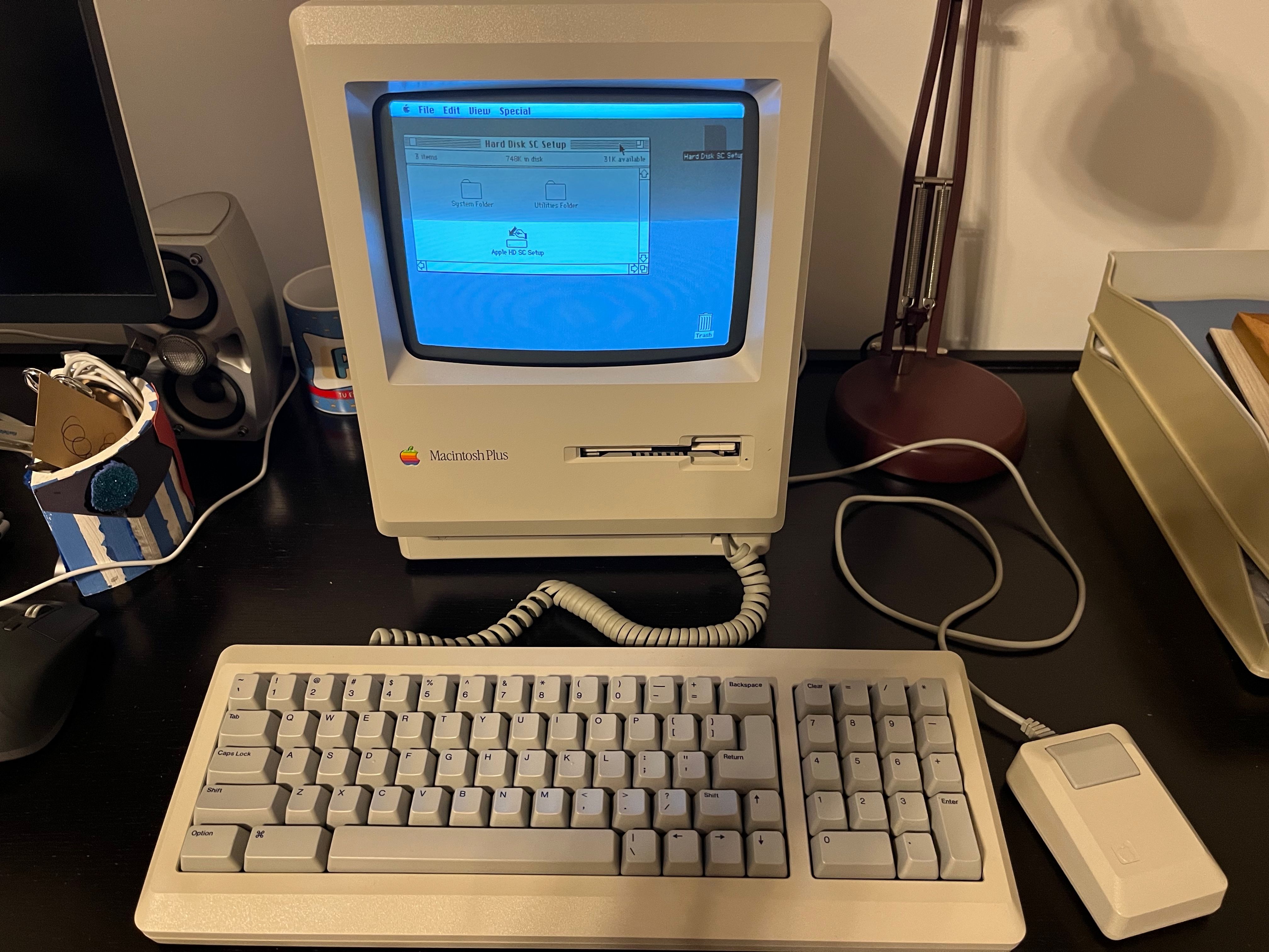

As you can see from the photos my machine looks and works like brand new! :cool:
