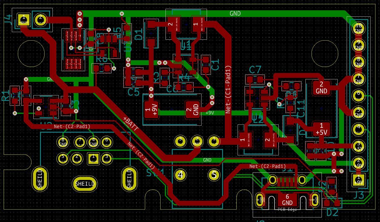

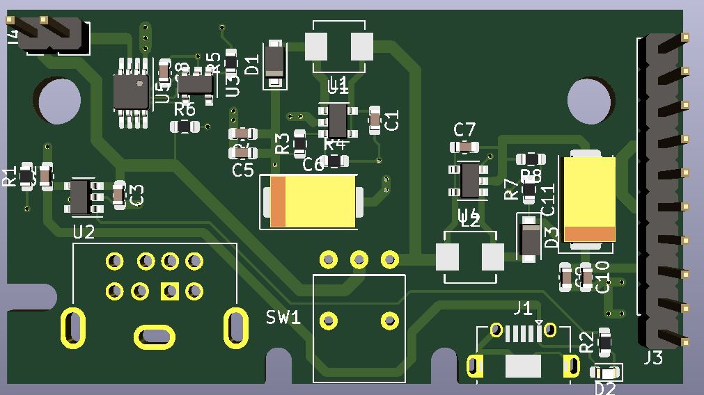

Noticing some unpopulated items: J2, J3, C2, C11? Were those unpopulated on the original?
The keypad PCB is pretty much entirely custom and apart from the keypad matrix which is a copy of the original, J2 should be populated I just forgot it :)
J3 is a optional battery connector for a flat lithium cell (rather than the 18650) which could go under the keypad PCB but as I wasn't sure exactly how much clearance there would be when I was designing it I added the option for the 18650 too
C2 and C11 are optional caps for the input / output of the boost regulator as I want to test it with some smaller tants rather than the big electrolytic's but for initial testing i'm sticking with the 'lytics as it's what the datasheet says should be there

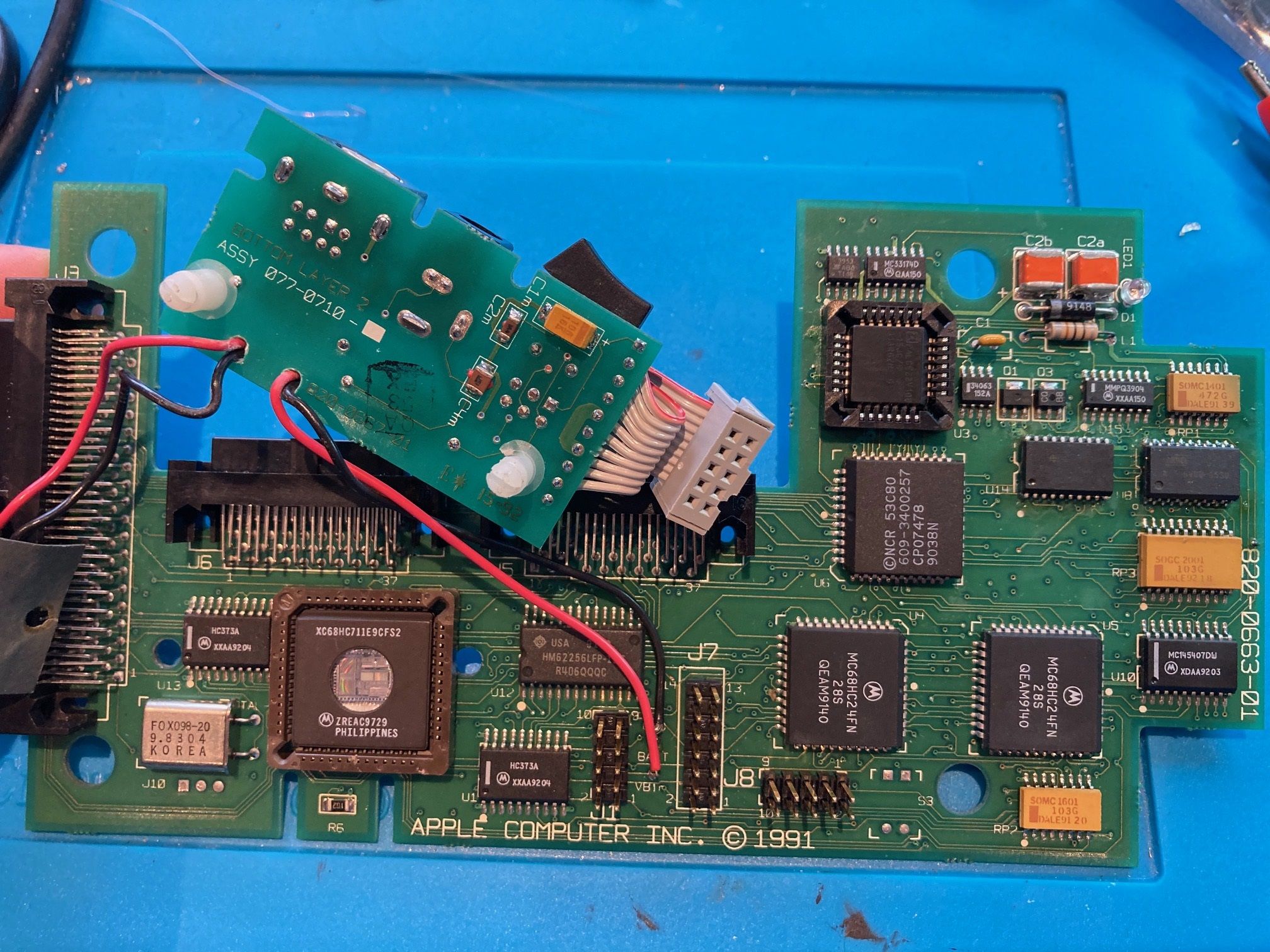

Update time!
First batch have all sold and a second batch of PCB's are in production
The design has been changed slightly to stiffen up the units when assembled, the port pack and keypad are now one PCB with the LCD screwed into the centre of it, this also has the added advantage of getting rid of the LCD cable which will simplify assembly a little
Additionally DIP footprints have been added for the EEPROM's for storing test results which give us more assembly options if we can find a EEPROM that works here. These will also have a backplate with them (essentially another blank PCB) to protect the bottom of the logicboard from shorting on the unit you are working on and also providing a space a lithium flat cell could be installed in if you don't want the 18650 on the keypad board
Also I have had some interest in kit versions of these, if anyone else is interested in this please let me know.
The kit version will be a little cheaper than the assembled units but please don't expect them to be half price or anything like that as a very large proportion of the cost of these is the parts and not assembly time (I expect kit for to be somewhere around £200 vs £250 for the assembled units however the exact price will depend on the exact BOM cost once I have everything ordered)

Time for a update (And not just because there is a TD Livestream tomorrow and I want to show the new version off....)
The most obvious difference is that the 18650 is gone from the keypad board which allows the keypad to be centred like the original unit, the 5v boost regulator has also been moved down the the logicboard and the external serial port been flipped to the other side of the board to get it out of the way
So what happened to that big 18650 that used to be there? It's been ditched in favour of a iPhone battery stuck to the back of the logicboard:
Either a iPhone 6 Plus, 6S or 6S plus battery is supported (I would recommend the 6 Plus one as it is the highest capacity of the bunch)
Why is the battery at that odd angle? Well someone was very careful to make sure there was enough clearance above the battery but totally forgot the check the clearance below it.... Installing it at that angle avoids the poky leads from the through hole caps
At this point the more observant of you may have noticed the DIP switches for selecting the ROM packs are missing, this is why :) :
Much slicker than the DIP switches :)
I have also changed the battery charge IC to allow a higher charge current as it was sloooow on the older versions but this has had the unintended consequence of making the overcurrent protection on the battery protection IC trip as the mosfet I am using has a slightly higher than ideal on state RDS so I need to find a replacement for that. Though this can just be disabled as the iPhone batteries have this protection built in
This revision needs some minor final testing done but is almost ready to go :)

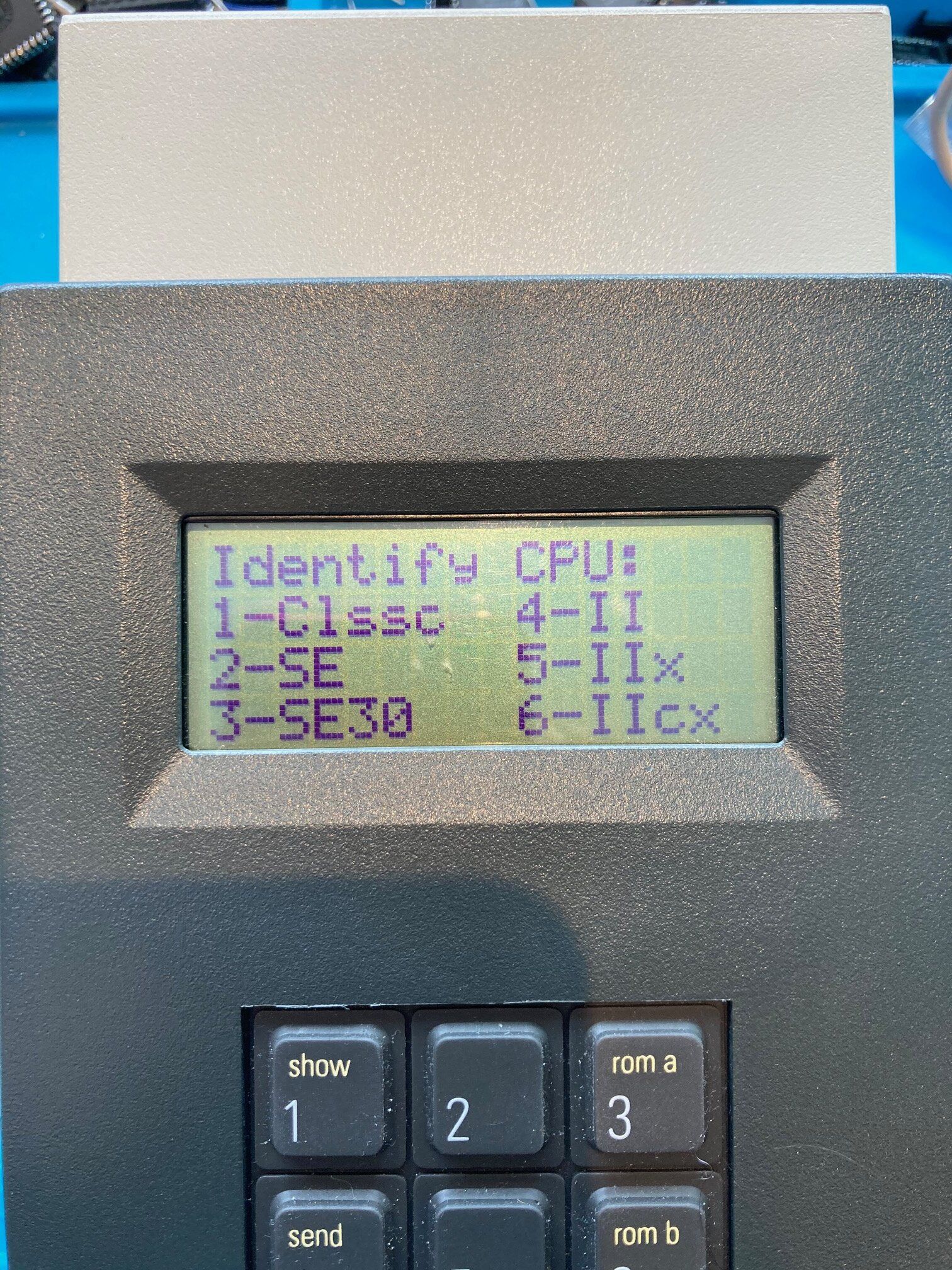

I know how to use the TechStep and was able to diagnose my SE/30 machines many times in the past, but I'm afraid I can't quite do it on the stock CC motherboard. I don't know if that's a bug in the cartridge recreation or if it is me doing something wrong. I can only use the TechStep to make two voltage measurements and that's it. The main tests don't work for some reason.
The specific segment where I talk about that problem is in my video below at the 38:44 timestamp.
Any thoughts?​
