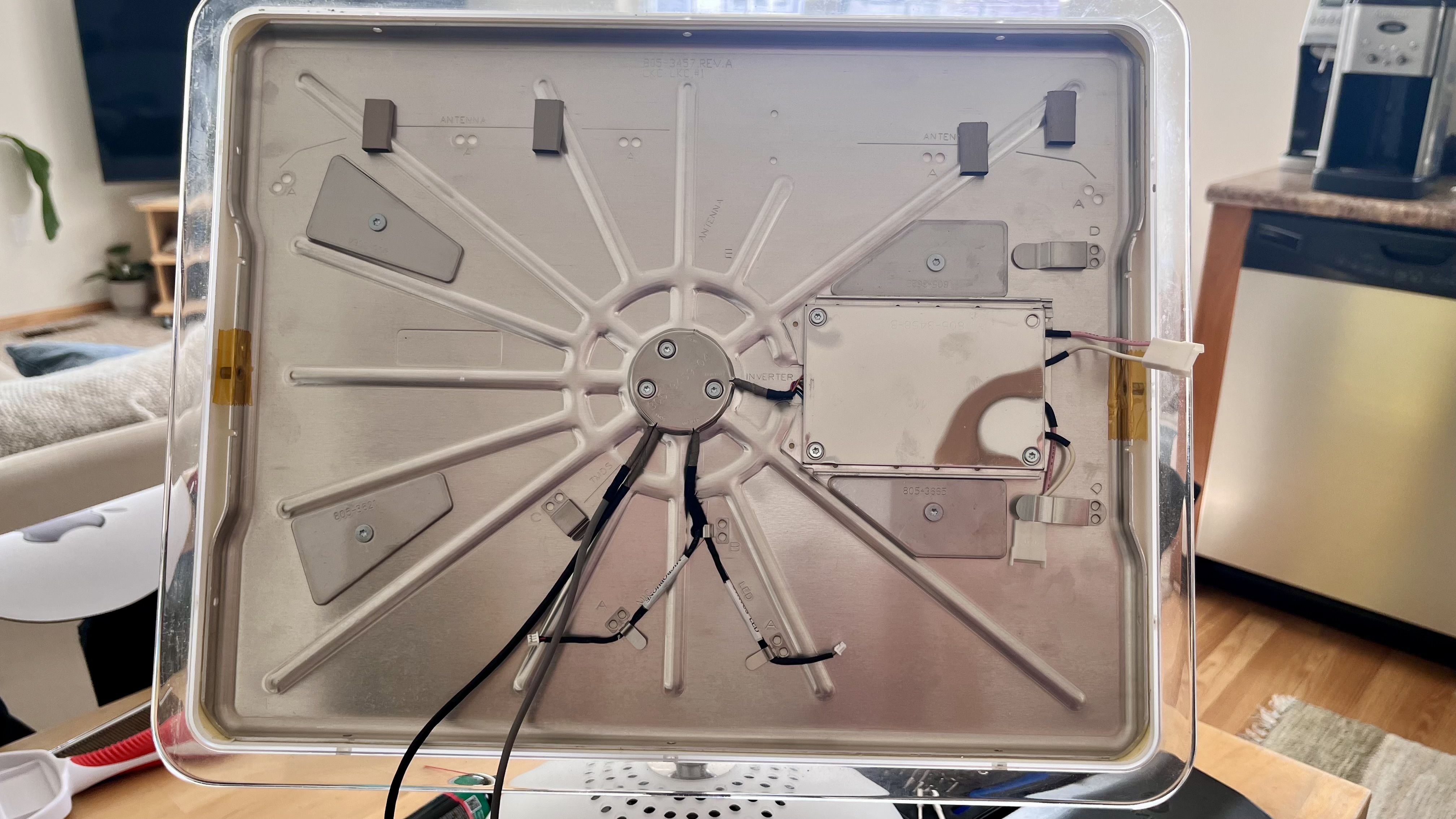

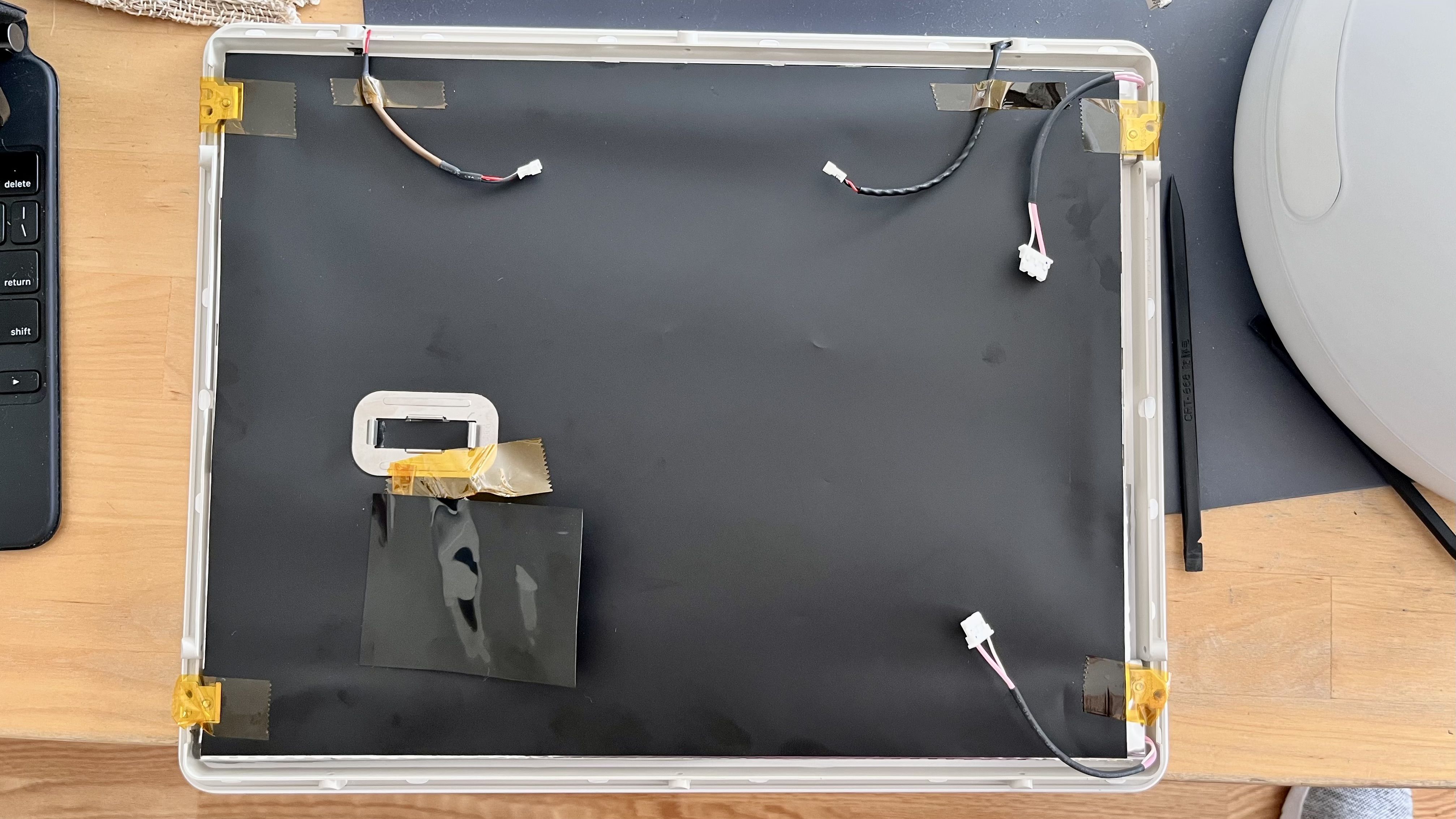

Removed. No make/model that I’m seeing here at all. Any additional pointers?
I am assuming there is one more layer of aluminum/black film that will come off the back of the screen (the black tape square typically holds the screen cable to the screen PCB). The back of the panel is typically white, and should have some barcode manufacturer labels on it.
Actually after looking at the iFixIt page, it shows a barcode on the edge. See step 9. That may be a serial number, but maybe there are other codes on the other edge.
