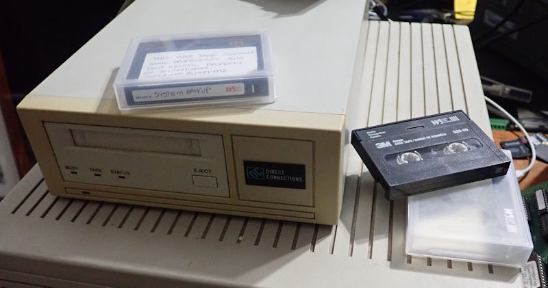

Back in 1992, I borrowed a DDS tape drive from my day job to back up all of my Macintosh hard drives at home. I stored the tape in a safe deposit box, until years later when it was relegated to the bottom of a storage box in the basement. Upon reviving my interest in Macs about five years ago, I encountered the tape. Given that I never owned a DDS drive and I hadn't documented which backup software I had used, I set the tape aside assuming I could never restore it. Every time I visited my basement boxes, the tape haunted me.
Recently, while looking for something else in my old utilities collection, I ran into a folder containing Retrospect 1.3B, circa 1991/1992. That was enough to warrant trying to restore the tape. I ordered a Sony SDT-7000 in an external SCSI case from eBay, along with some new-old-stock tapes for practice.

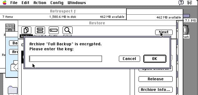

I first used the practice tapes to determine that the tape drive was functioning and was not going to eat my backup. Then, after inserting my real backup tape, I was greeted with the following dialog:
Oh no! What password did I use 33 years ago?
