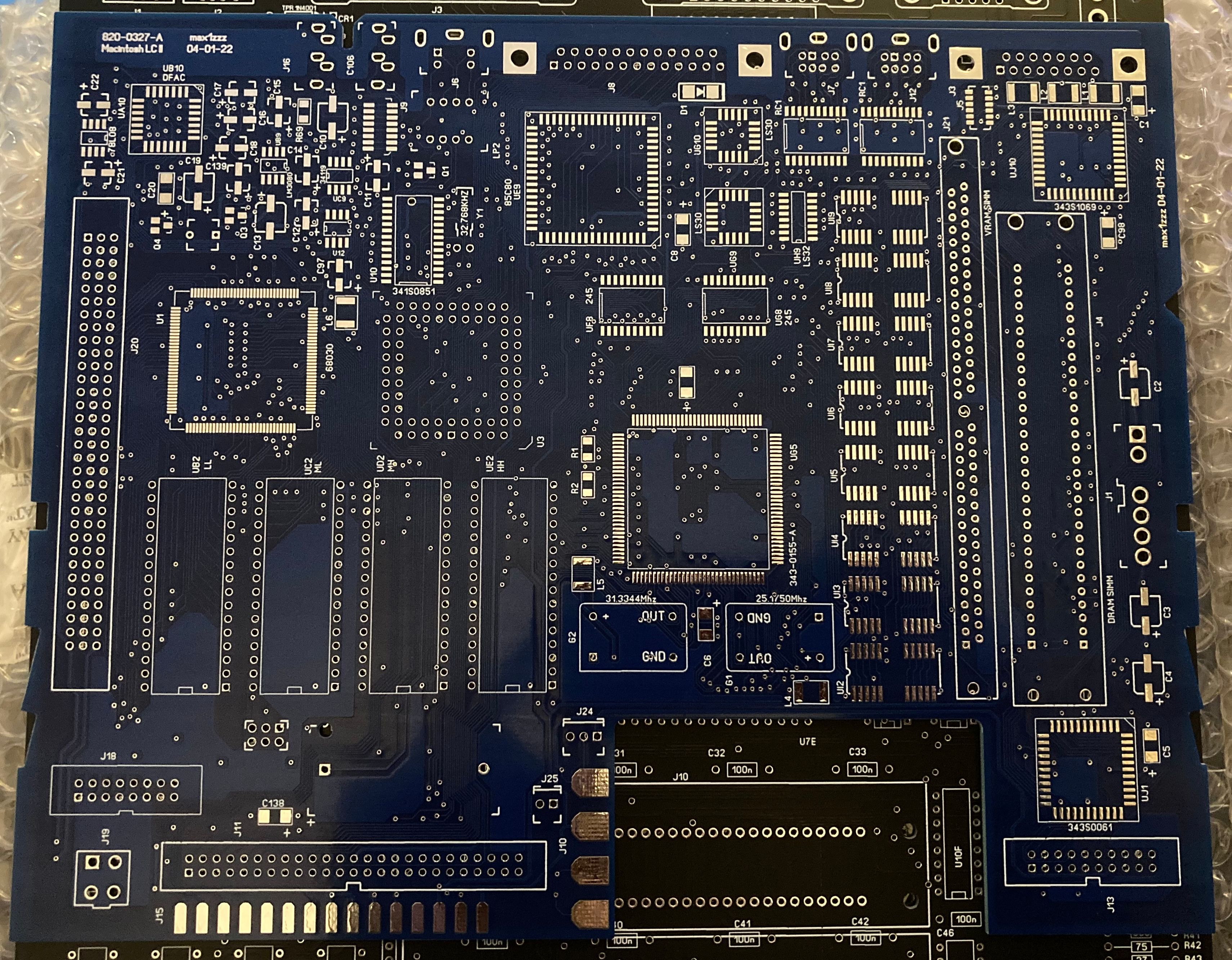

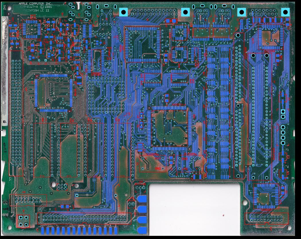

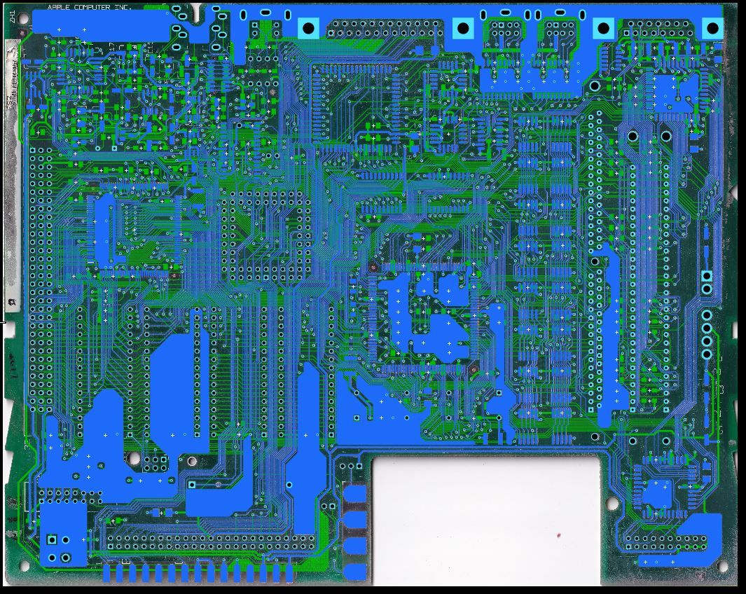

With the (hopefully) final revision of the LC 1 board and the second revision of the LC III both with JLCPCB for manufacture it;s time to turn my attention to the LCII. This was initially going to be the second board LC board I worked on before that pesky LCIII board distracted me...
The boards I am working form where kindly donated to me by cheesestraws from 68kmla for reverse engineering, Many thanks for that!
I haven't taken pictures of most of the process because it's more or less the same process as the previous two boards but here's when I'm at currently:
About 2/3 of the top copper is done, should only be a day or two more till this side is finished :) Then it's on to the bottom side which is always fun due to the huge amount of birdseed that's always on the bottom side.....
I'll post more updates as I work on the design :)
Wow, looks like you are making great progress! As an LC II owner, I am looking forward to seeing the final result. It's a shame that there is no good, non-destructive method to see the inner layers.

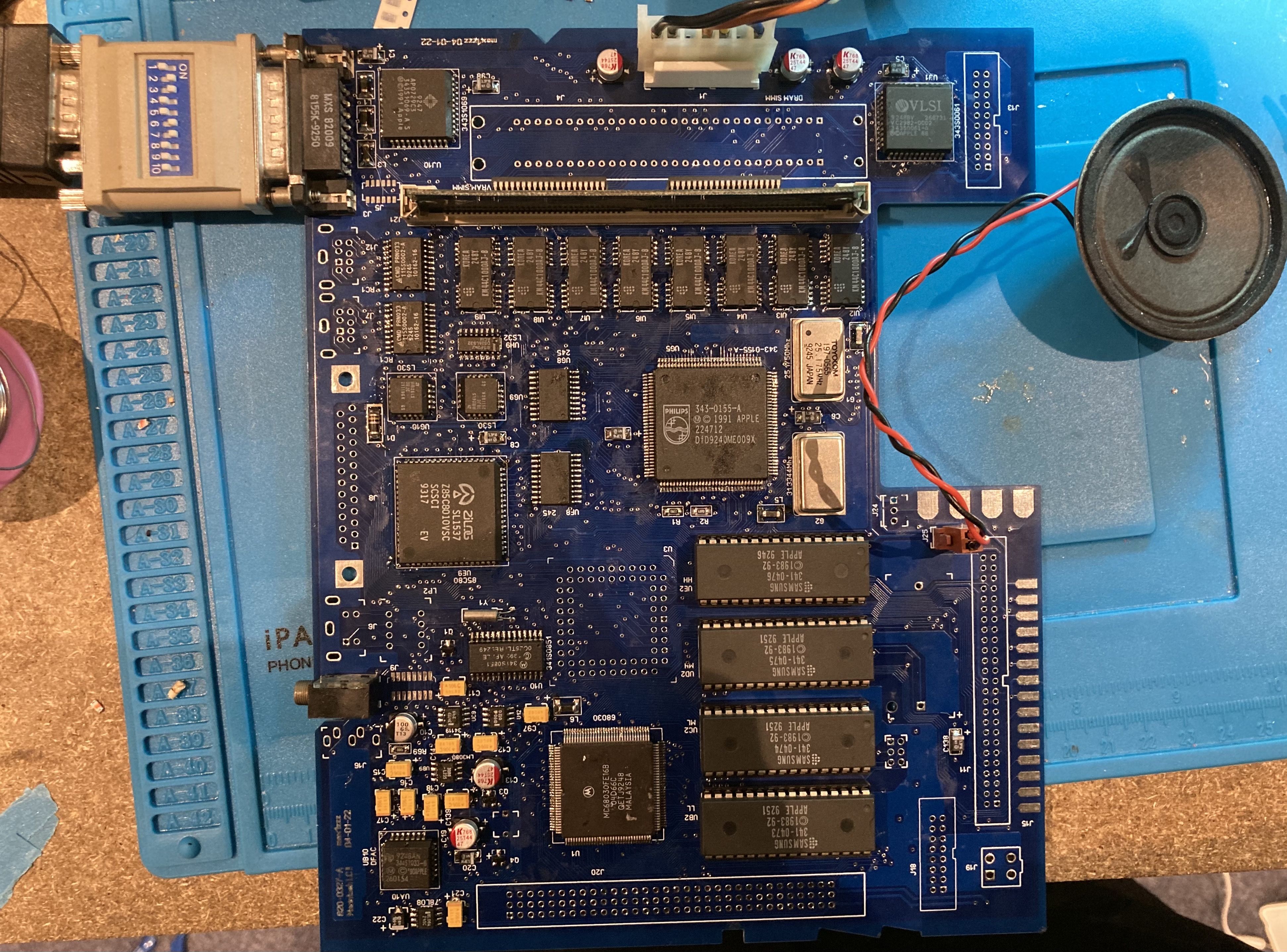

I finally managed to get a board assembled enough to test:
I didn't really expect it to work, after all V1.0 boards rarely work out of the box however I flicked the switch and was extremely surprised to hear a clear chime! But I was getting a solid white screen.... The I realised I hadn't installed a VRAM simm, quickly installing one presented me with this:
It works! :)
I can't quite believe it boots with no modifications! (well, at least it boots this far, I still need to solder the rest of the connectors and fully test it so there is plenty of room left for things to not work)
