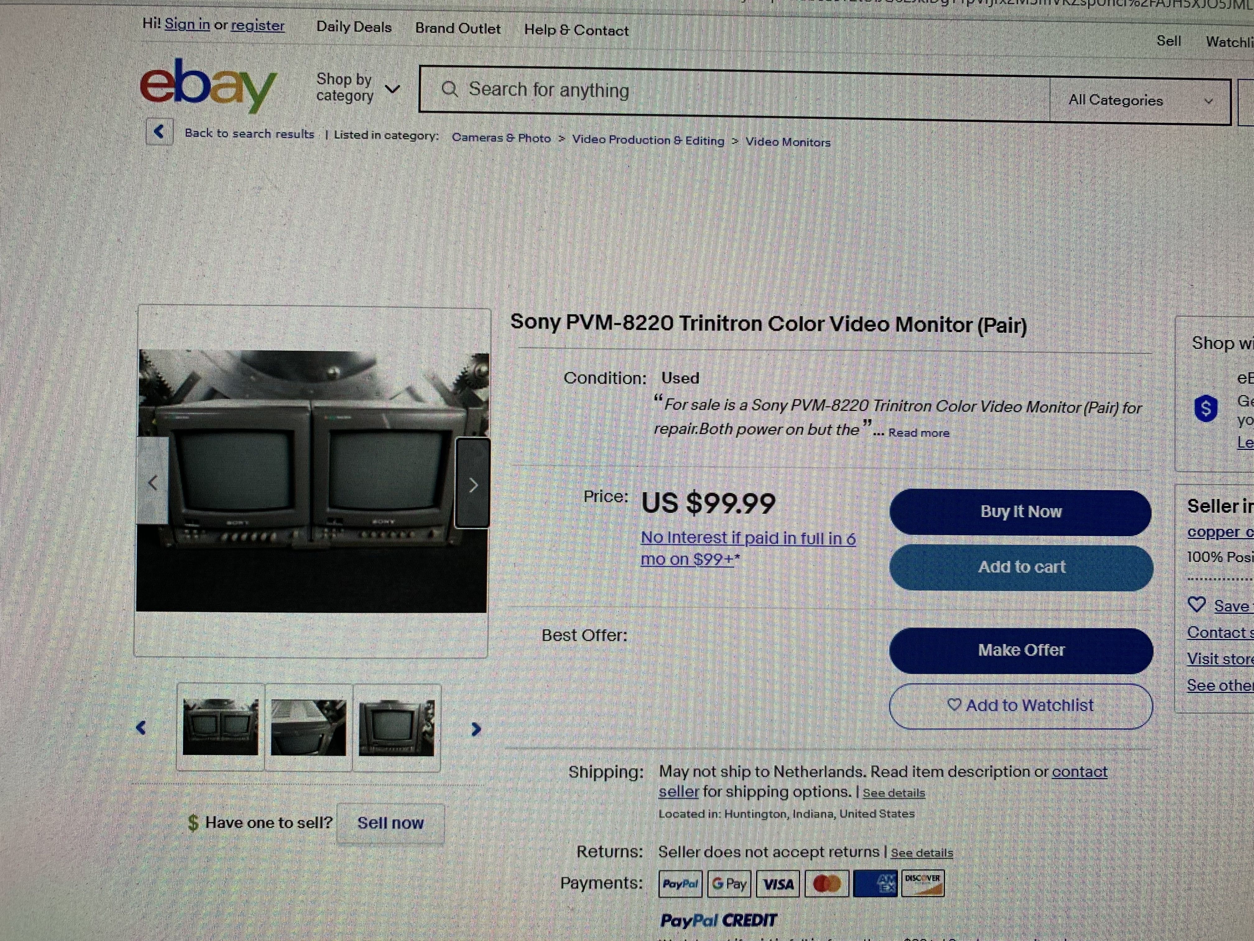

I may have a suggestion,….. to have a look/search for small trinitron monitors wich may fit your purpose.
Had a quick search on ebay and showed two 8 inches. (Could be 9” build format, like with the other compact Macs)
Based on squinting at their respective analogue boards, I suspect there's a lot of overlap between the Colour Classic AB and a 9" Sony PVM.

Bad suggestion on my part as its a 10“ CRT

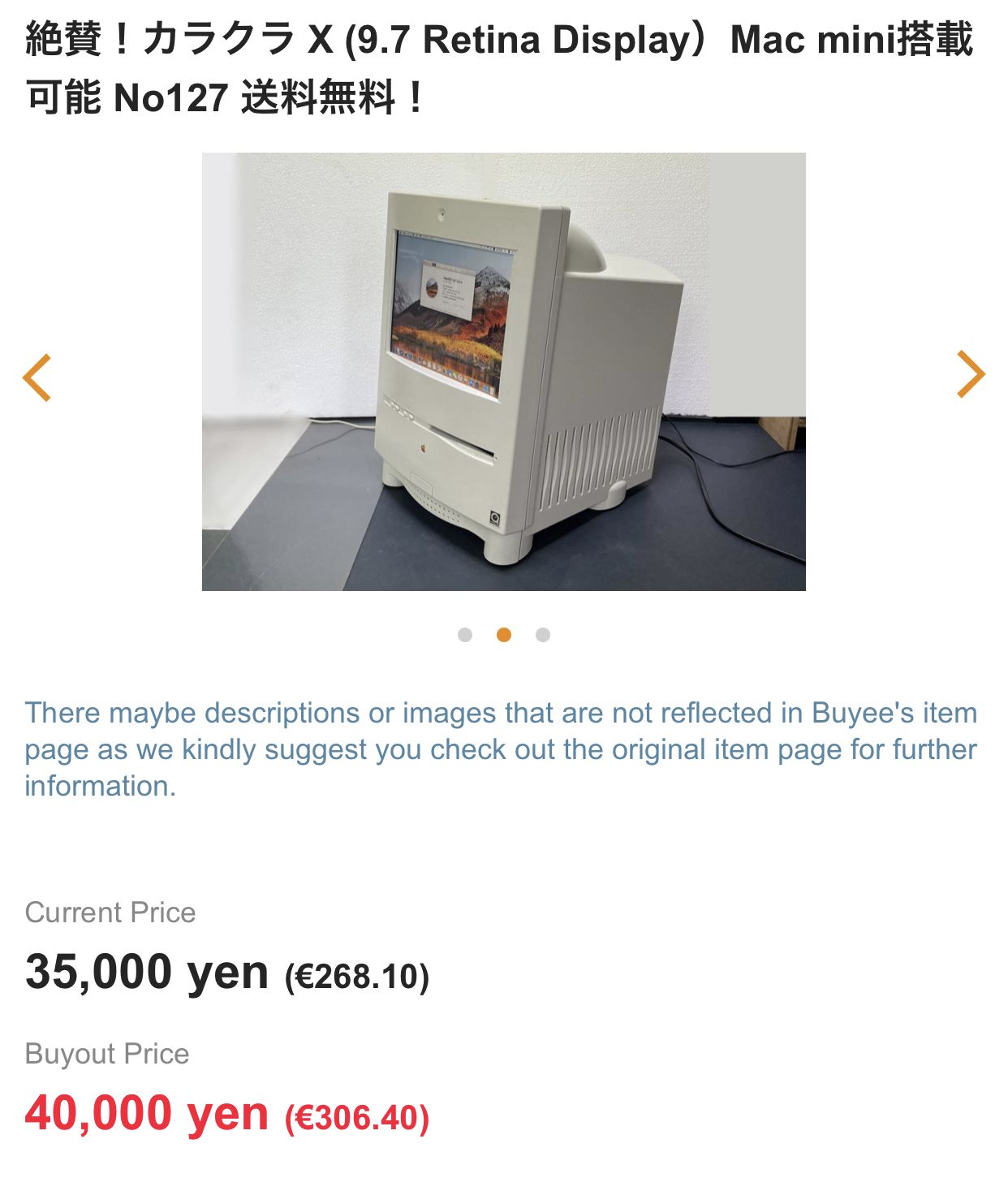

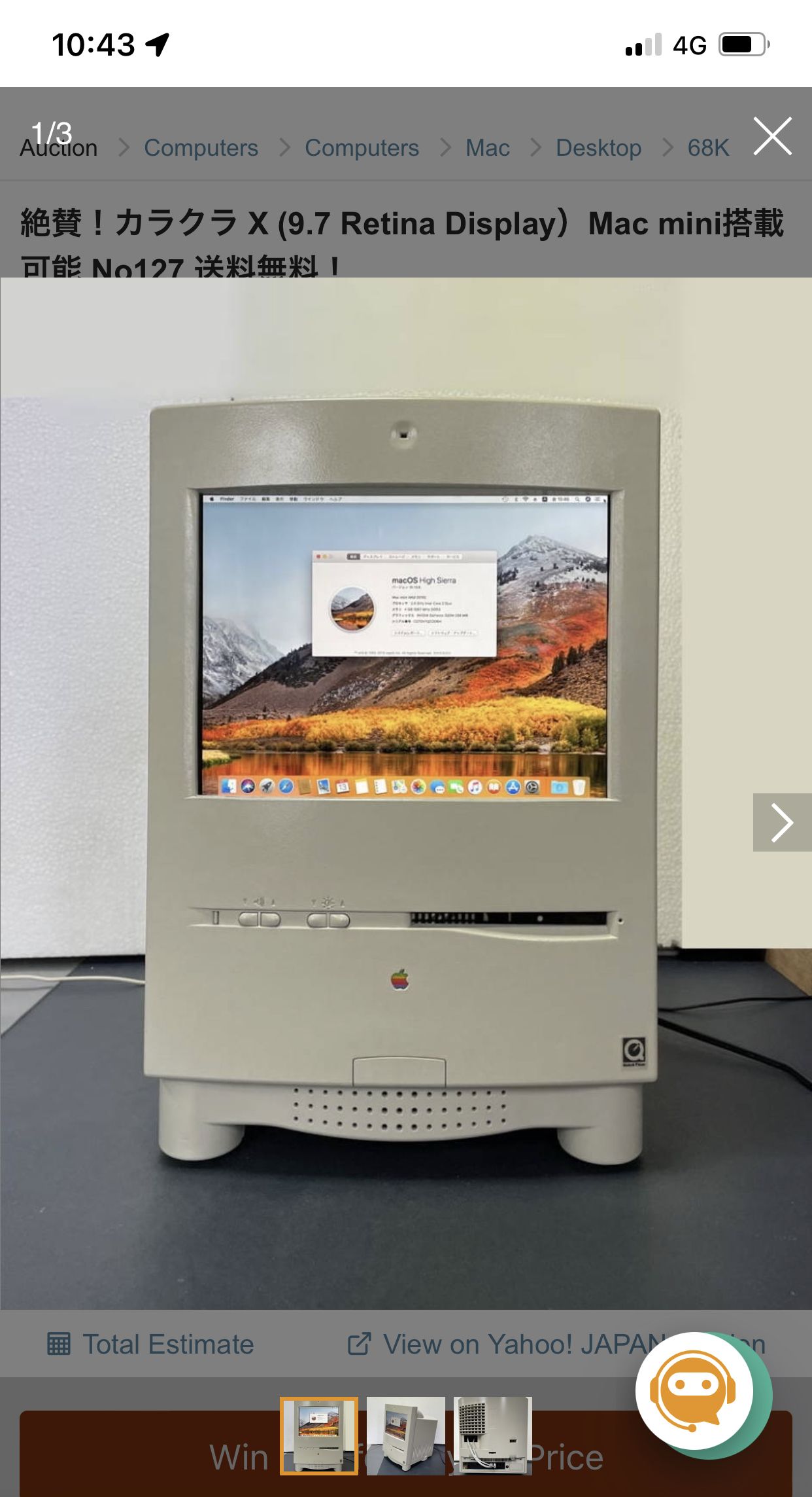

…We don't talk about iPad Macs, no no no 🎶…
Ok…..then better startup a CRT factory then.
How will this end in thirty or so +years, when most tubes have died 😢
Erics topic here is - without an analog board or tube-
Other solutions are not accepted?
