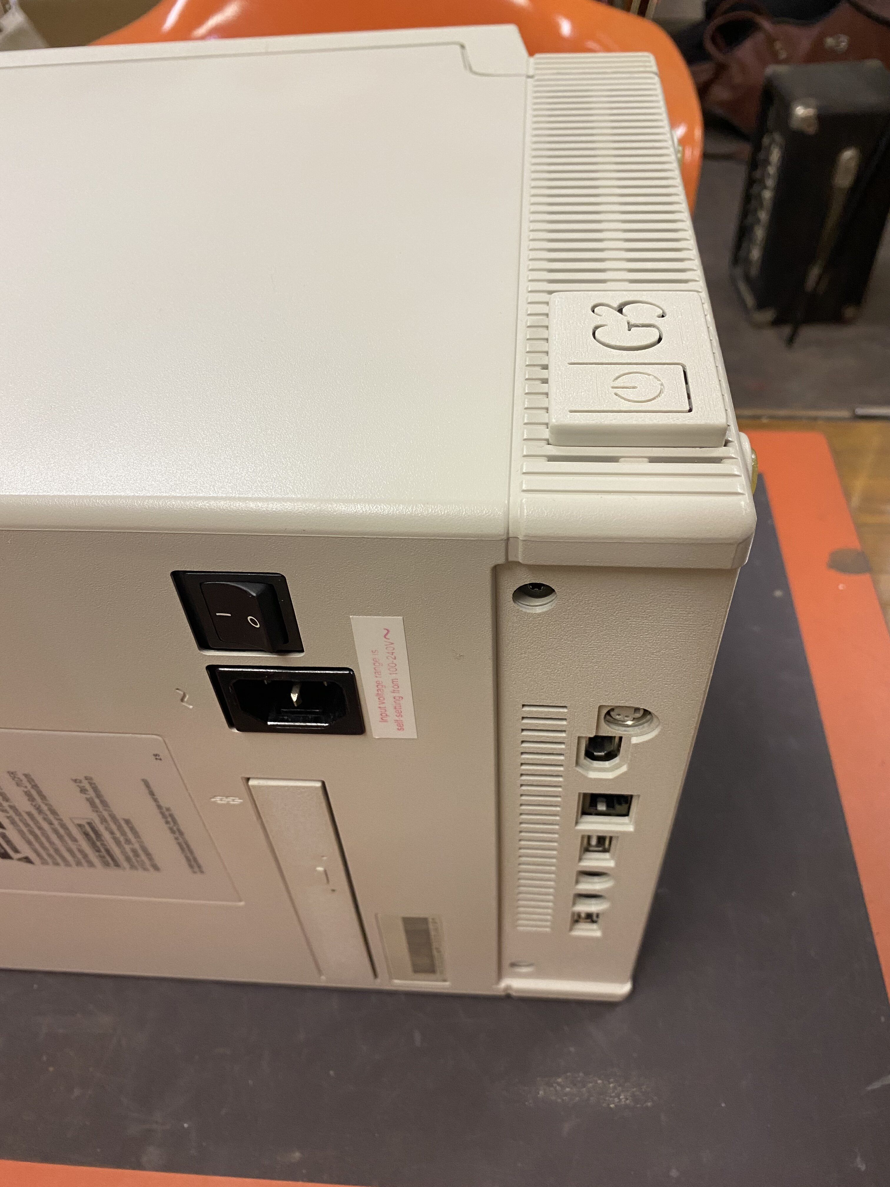

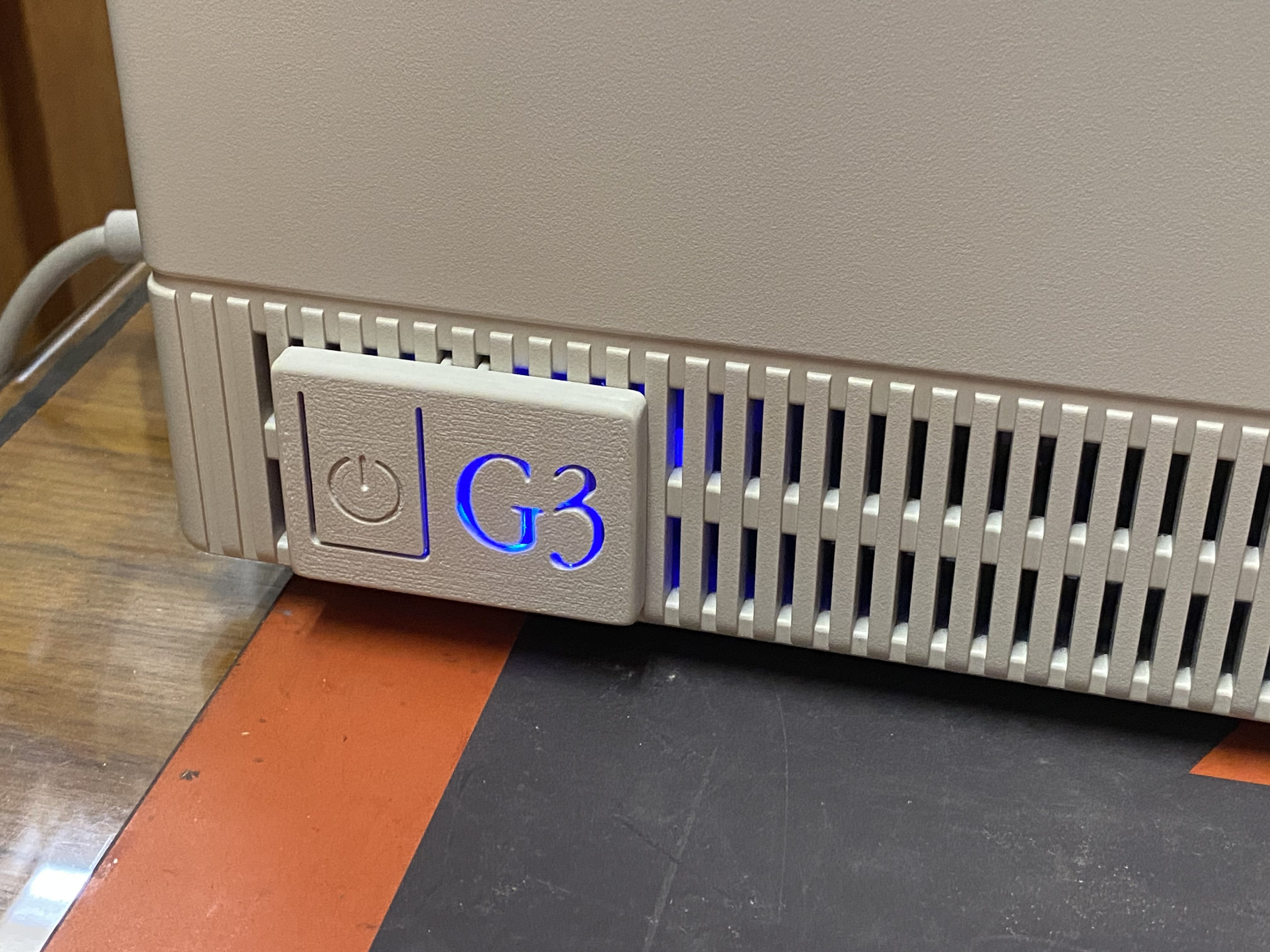

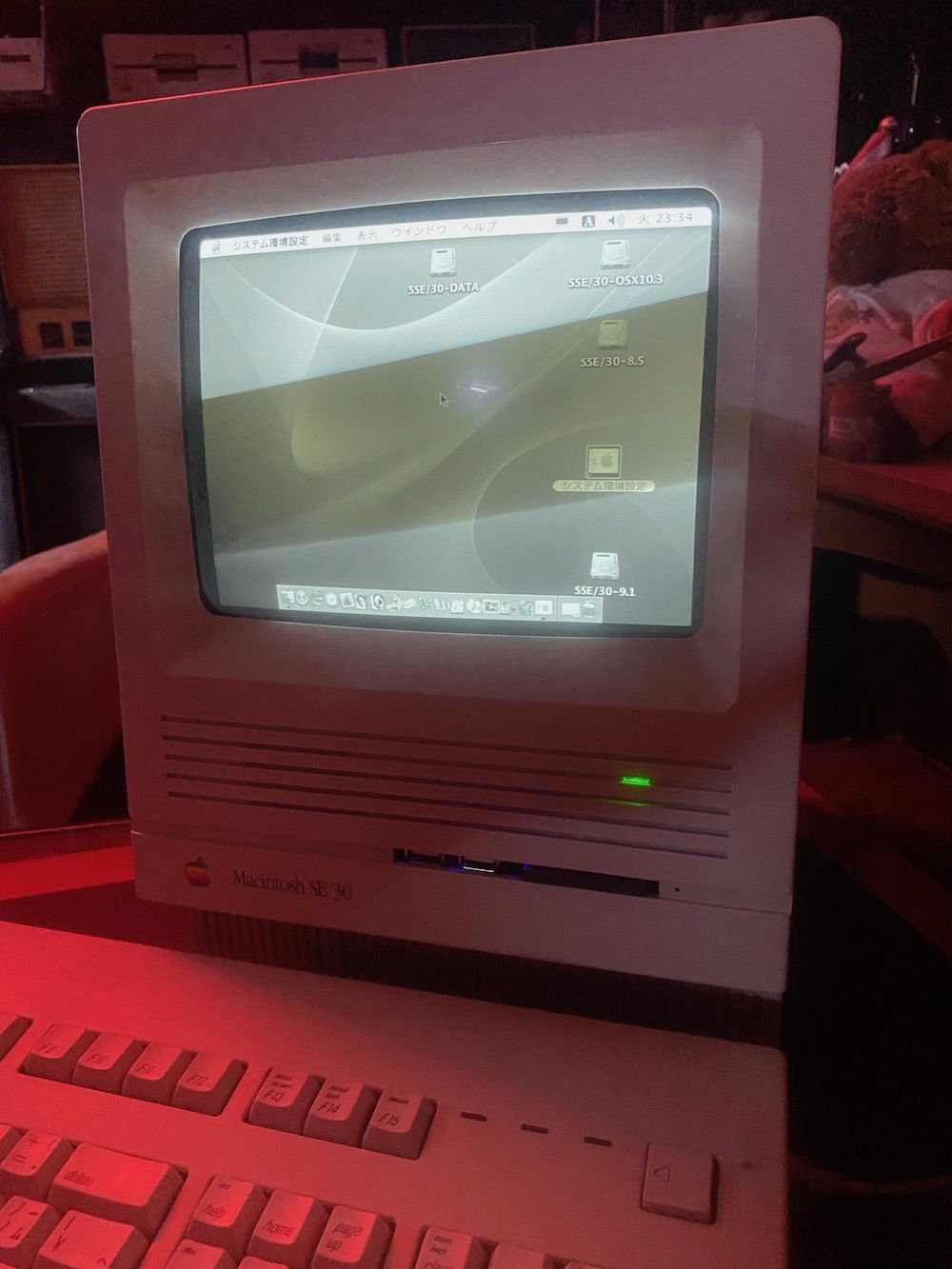

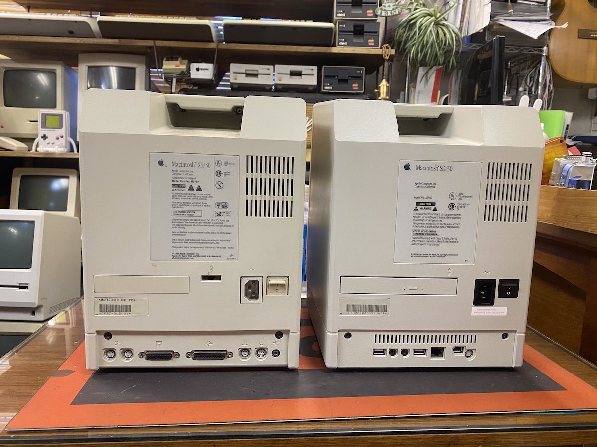

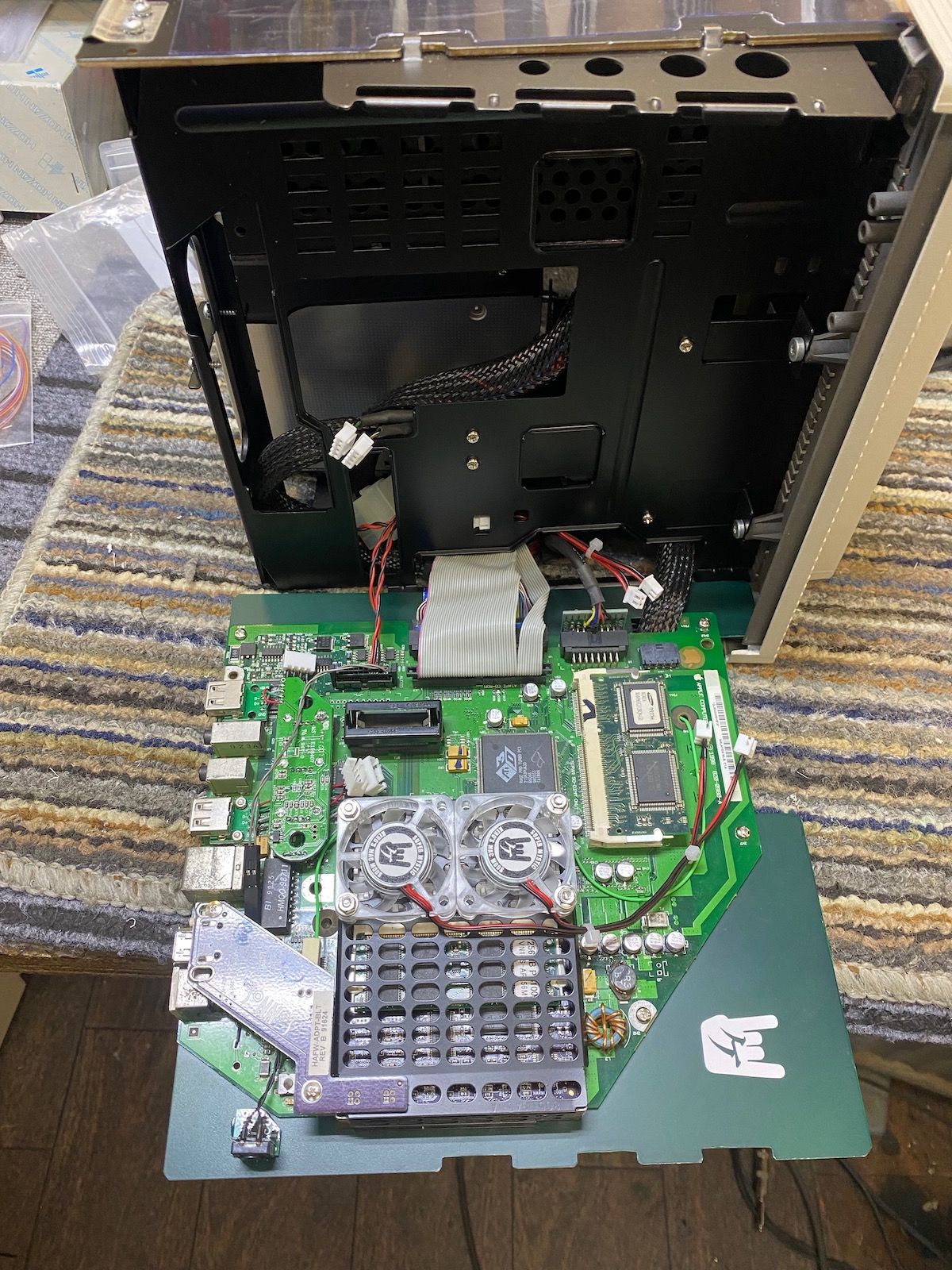

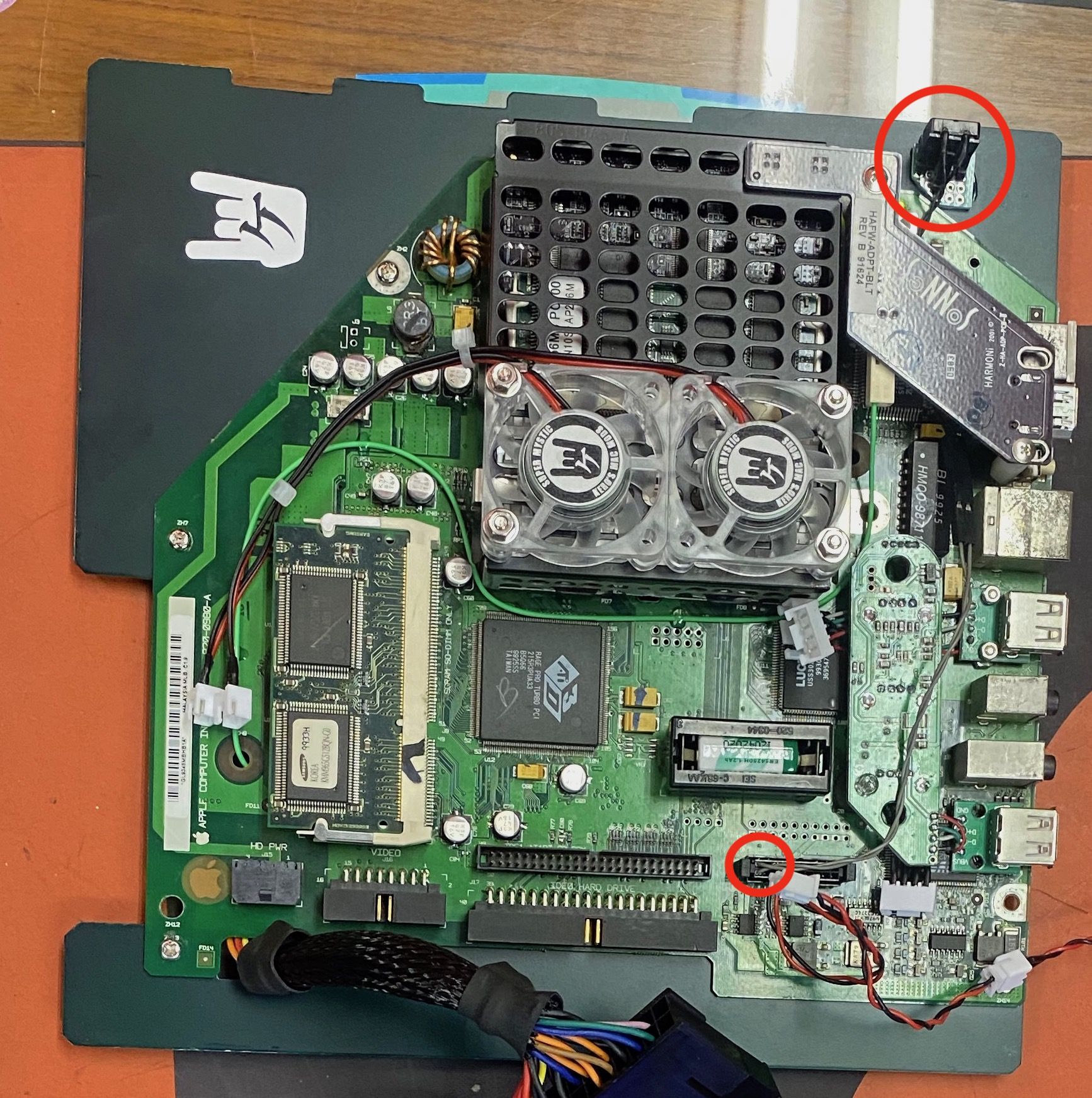

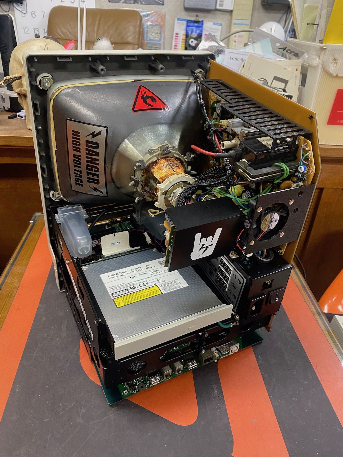

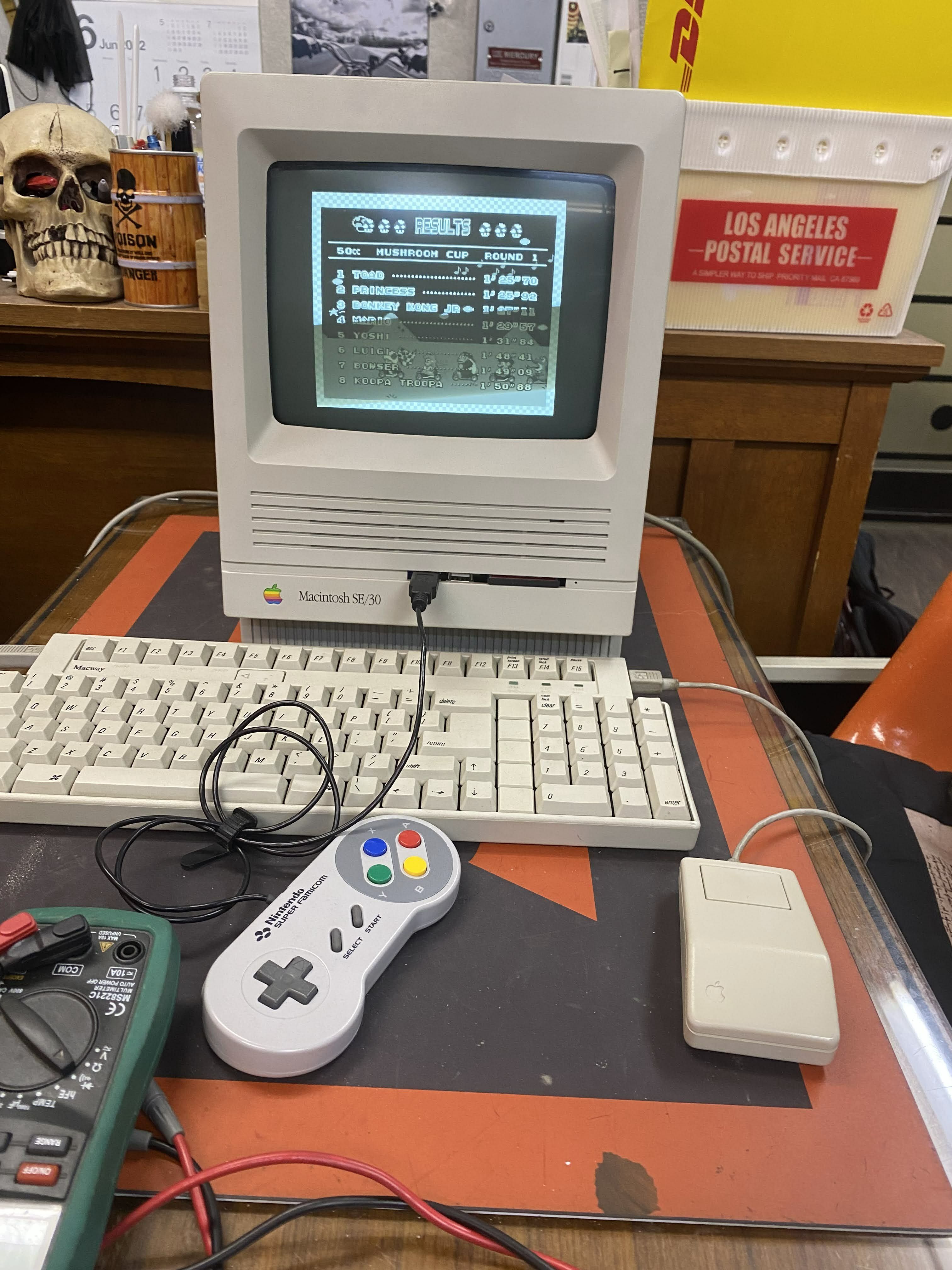

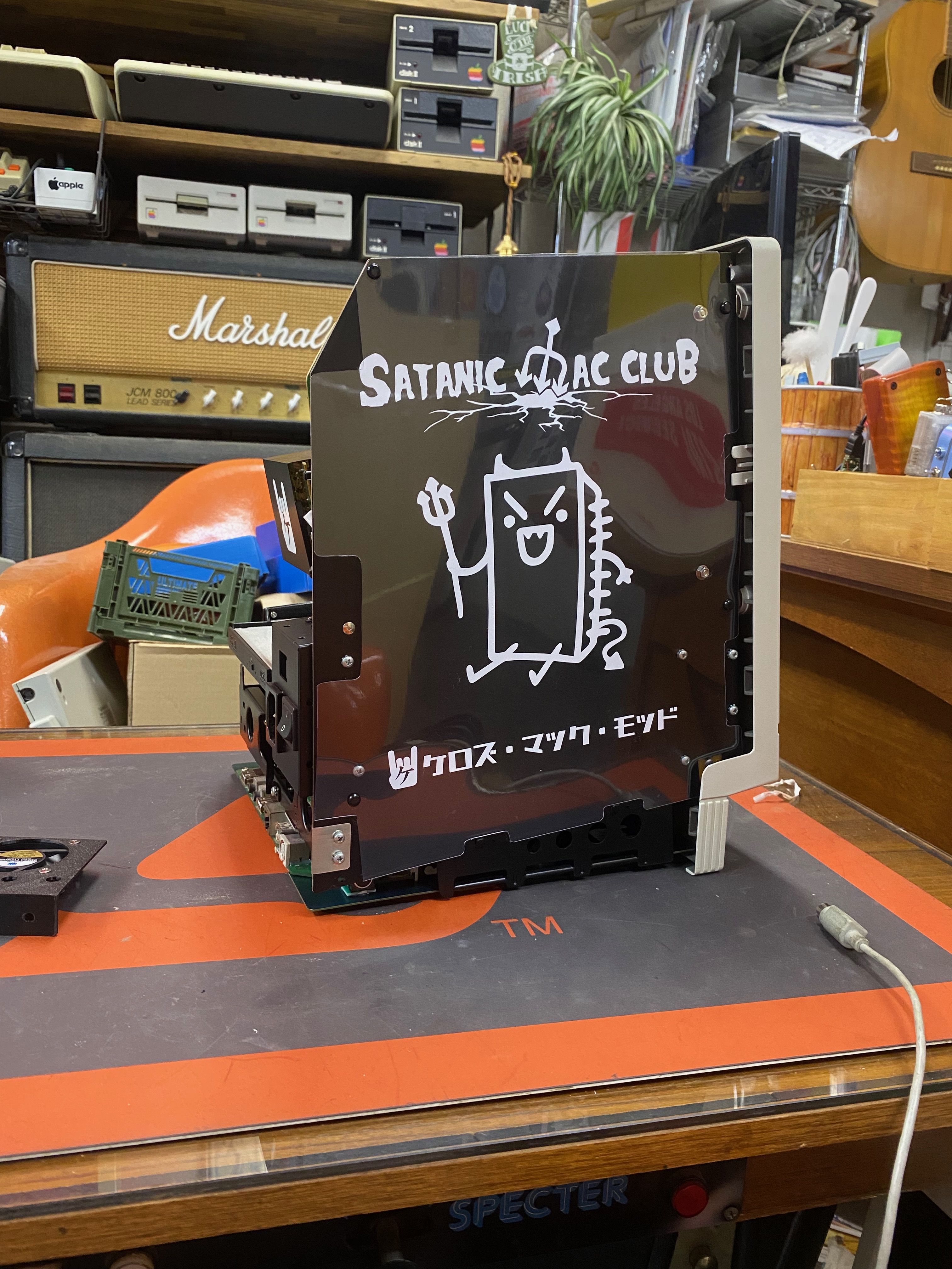

Satanic SE/30 Project
This is so inspiring. I do NOT have half the know how to do anything like this, but just knowing its possible is awesome. Great work!!
The attention to detail and dedication in your Satanic SE/30 is impressive. I don't usually like compact Mac hacks/mods because they're usually very poorly done, but this is excellent!
Thank you guys. @winters It's enough if you understand about half! Seventeen years ago, people around me used this SE/30 as a normal Mac, but no one cares about the contents because it works properly but it is old.
@joshc that's right. My focus was on the craftsmanship of manufacturing. What I always care about is the surprised face of the person who tried to disassemble this after I died. And if that person misunderstands that some high-brand maker has reworked, I win! But 17 years ago I wasn't aware of it. I made it by reflecting on it.

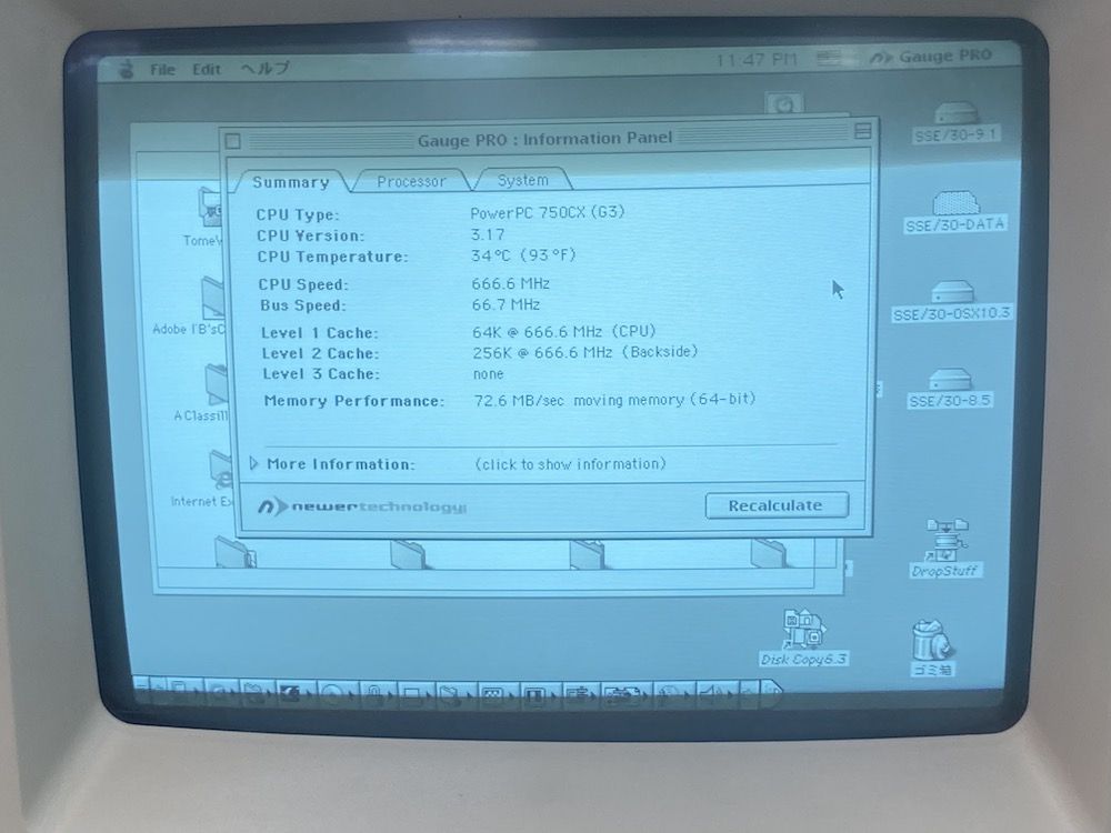

As I mentioned on the previous page, I don't have a 500MHz card anymore, but when I received the 600MHz card back from support, the first thing I checked was this PLL setting.
As mentioned above, the resistance was set at FSB x 10 times! In other words, it seems that the FSB is lowered to 60MHz as I guessed at the beginning, and it seems to be compatible with the system by enabling something. I don't know at this point whether it is compatible with hardware or software, but each system info tells it. In the system profile for both OSX/9
As shown in the picture, FSB: 67MHz is shown (there is some error), but CPU: 600MHz. It is a numerical value that cannot be achieved by magnification. But Metronome on OS9, GaugePro, and CPU Director on OSX...
It is displayed like this. (The image is GaugePro) So what is actually going on? It is common knowledge that when a third-party card is installed, it will be seen as an unknown CPU in the system profile, so there will be bugs in the CPU clock, but what about this case?

After entering , press the start button. After rebooting, OS9 started up as if nothing had happened, and I decided to take a look at the system profile.
I noticed after this that when I run it on OSX, it goes back to 600Mhz.
