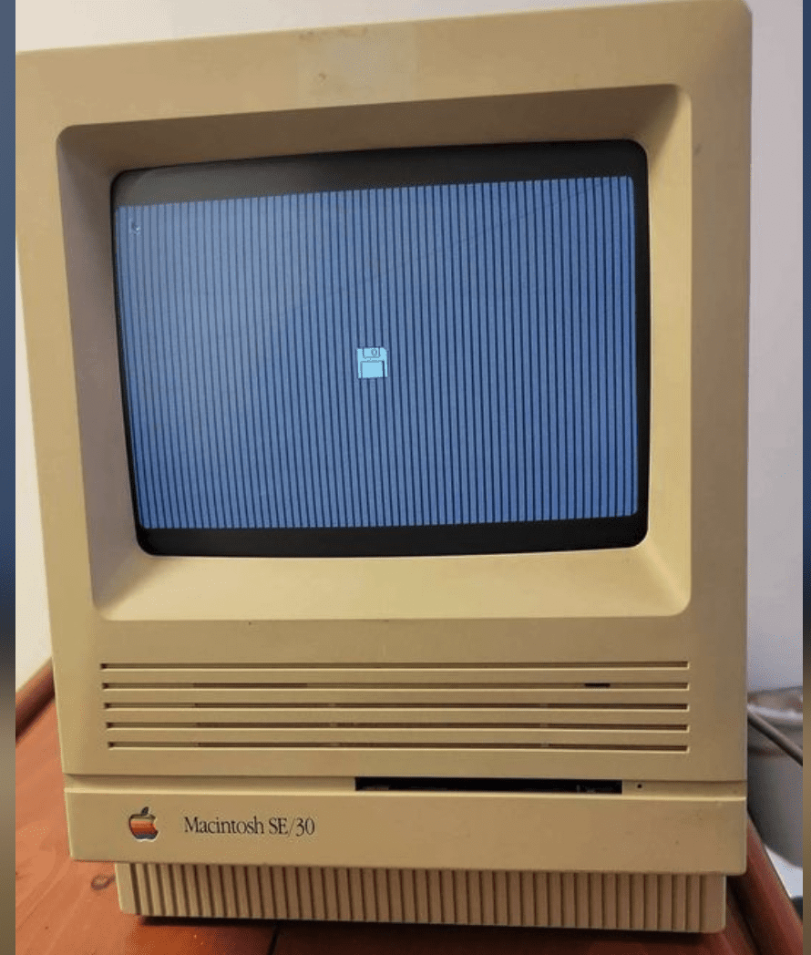

I picked up a SE/30 off FB MArketplace and in the picture it had the vertical lines and a floppy (interestingly the bars were only on the background - the floppy icon was in tact:

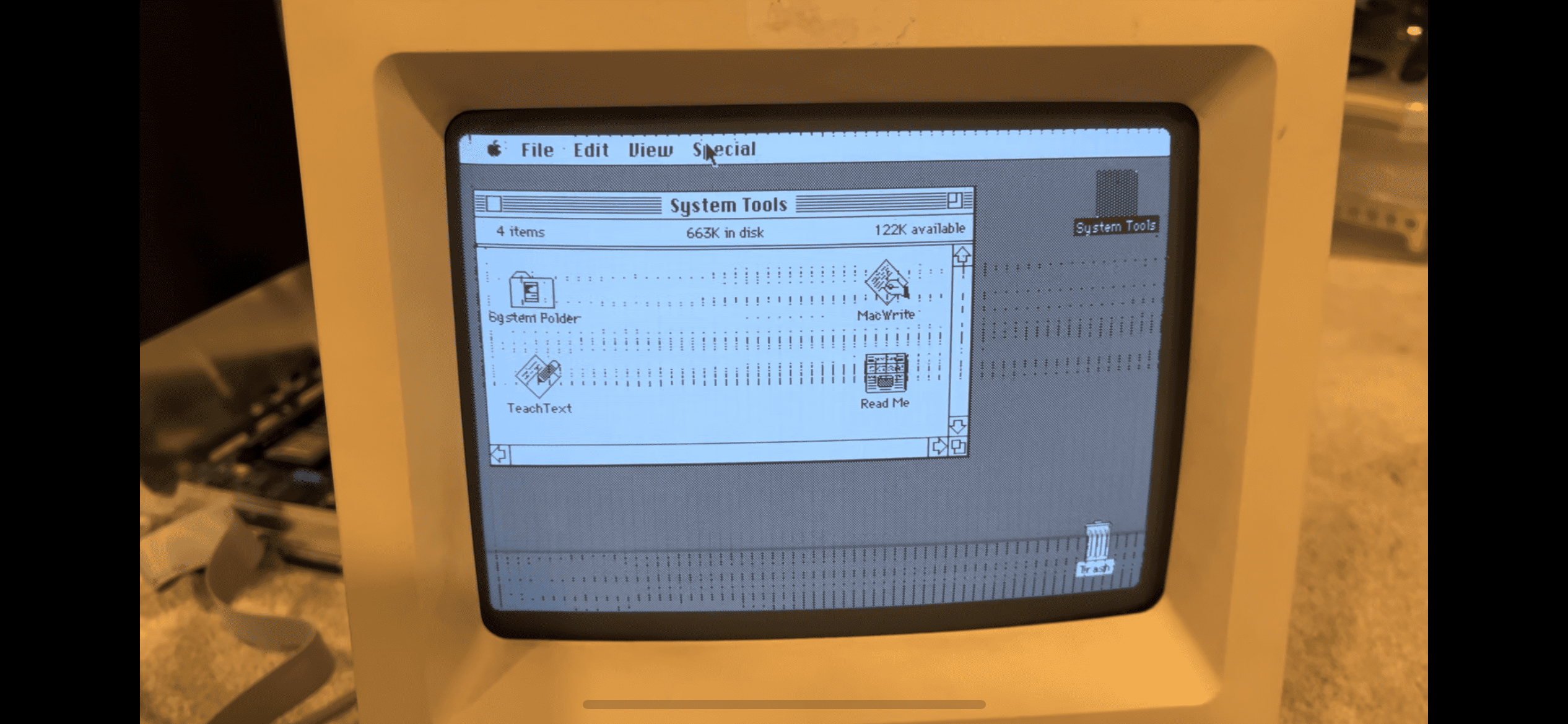

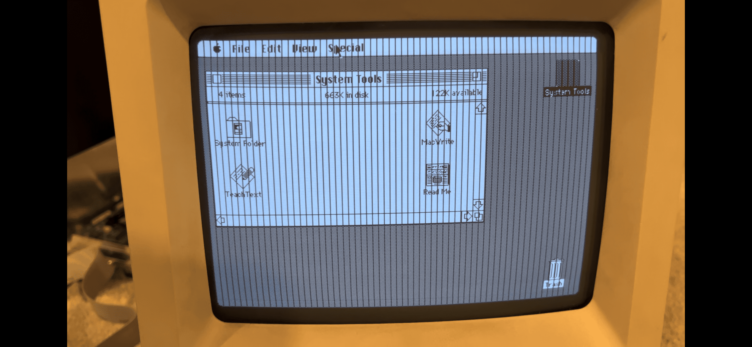

My Q3 replacement came in, so I got it soldered on and tried to fire it up. Unfortunately, the symptoms are now a bit different. Basically, sometimes the picture looks good, but it flickers with artifacts of the vertical lines, sometimes having the full vertical lines.

Also, here's a video so you can see the effect of the bars coming and going:
