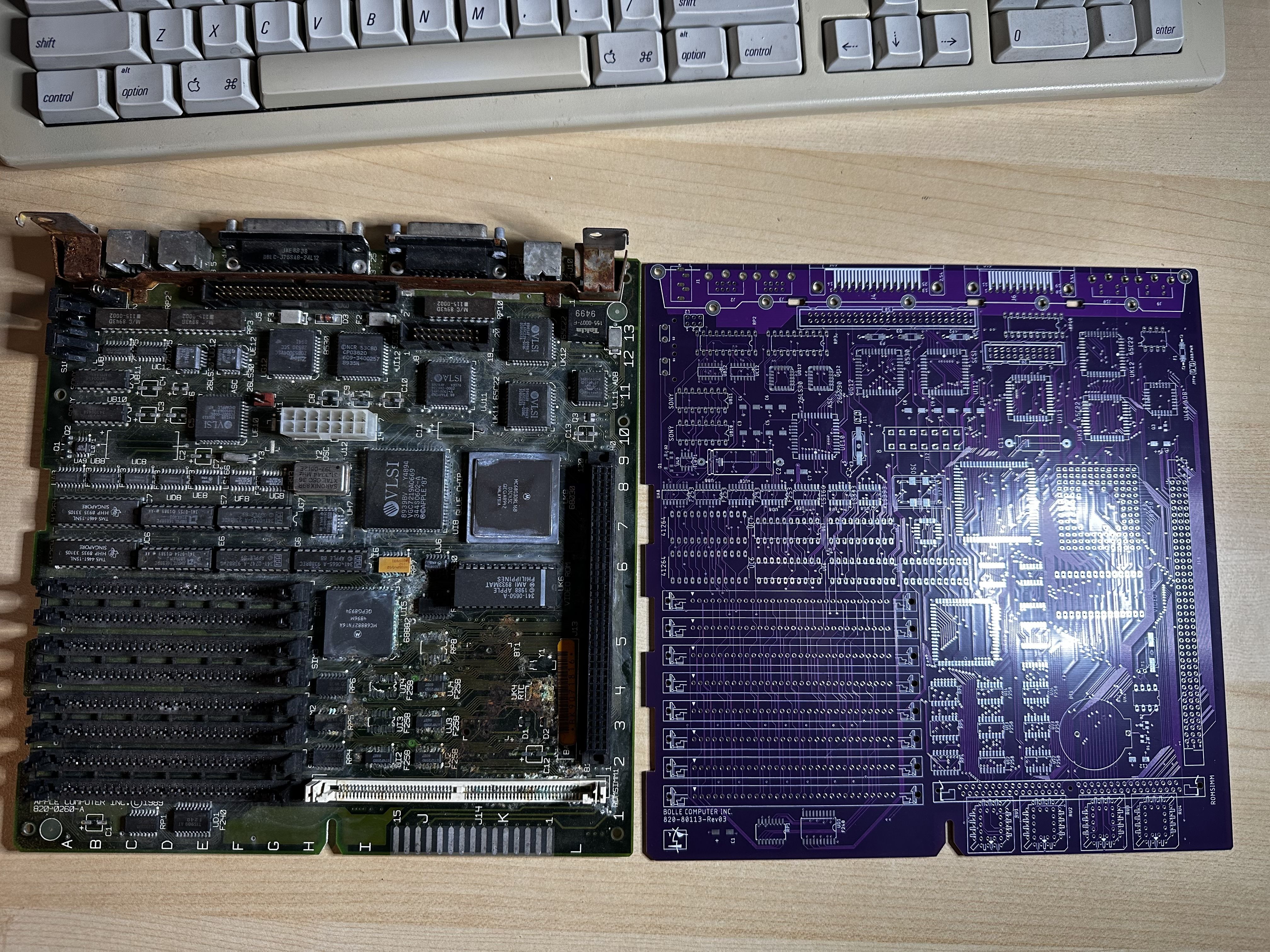

I recently went in on a group order with @rdmark of @Bolle's SE/30 Reloaded board, in purple. Here's the donor board along with the new.
As you can see the bombed area is pretty bombed... but it seems like the important chips survived. Here's my first look over for replacements I need and a ROM socket.

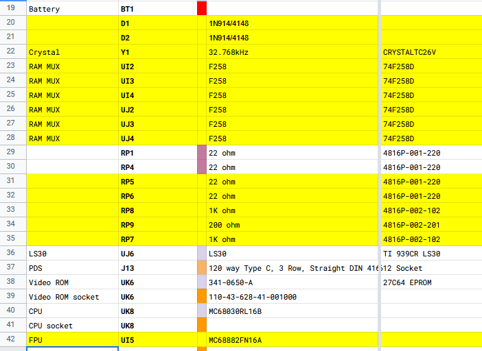

Between Mouser and DigiKey in the US I found most of the parts I need, but not all:
ROM SIMM holder - I can try to recondition this one, or take the ROM's off the old one (has some corrosion, may be fixable) or take the ROMs off the new GGLabs one I have.
Resistor packs (22/1k/200ohms) - I cant seem to find these anywhere, but the data sheet these look very trivial, might whip something up quick in kicad.
FPU
