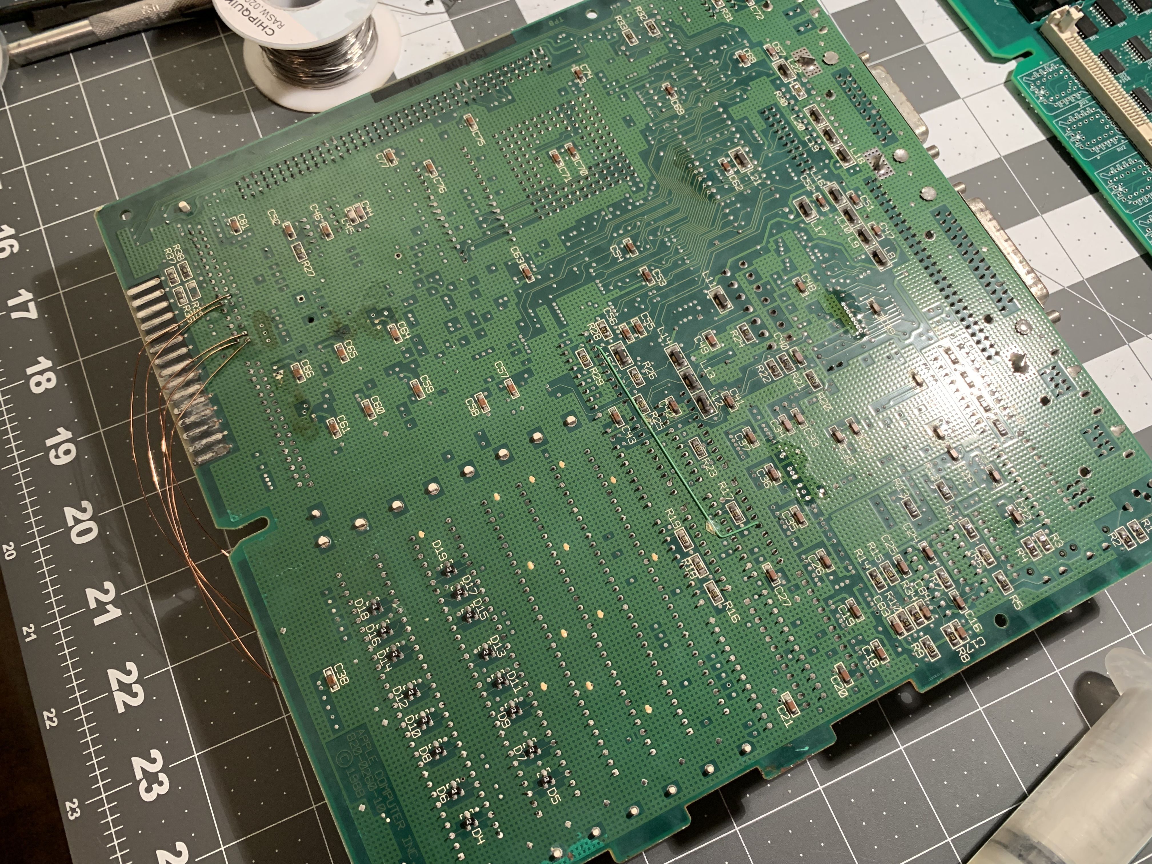

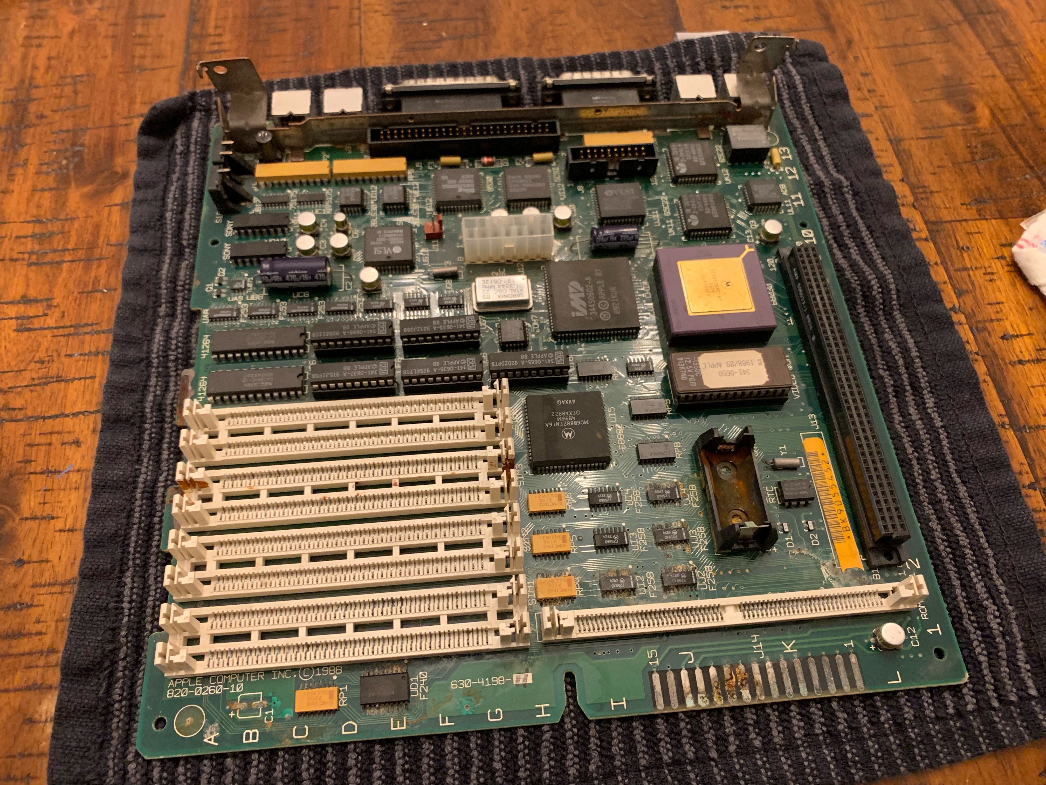

Hi all, I decided to document my latest project board - yup, another battery bombed SE/30. Now, some photos!

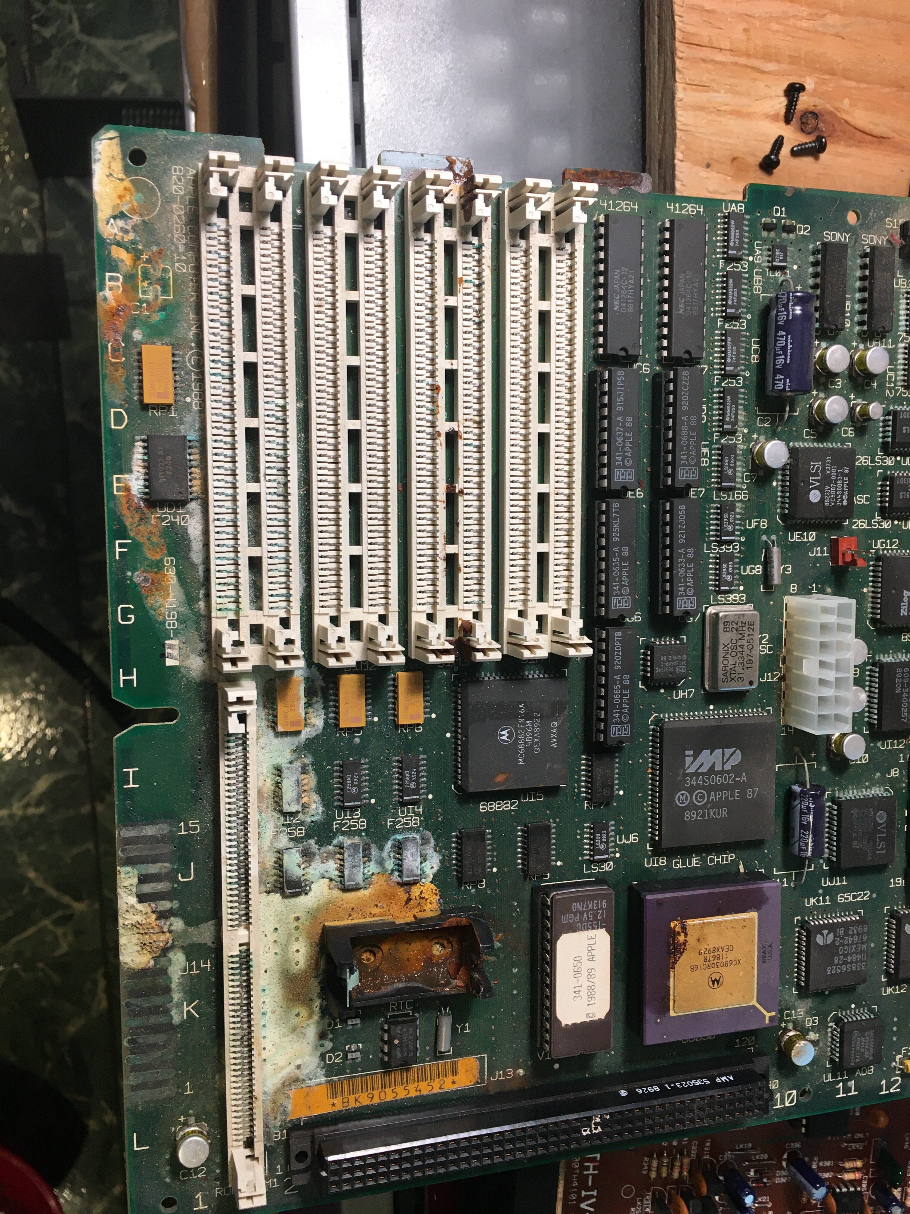

This is how I received it (yikes).
Here's what it looked like after a very thorough cleaning.

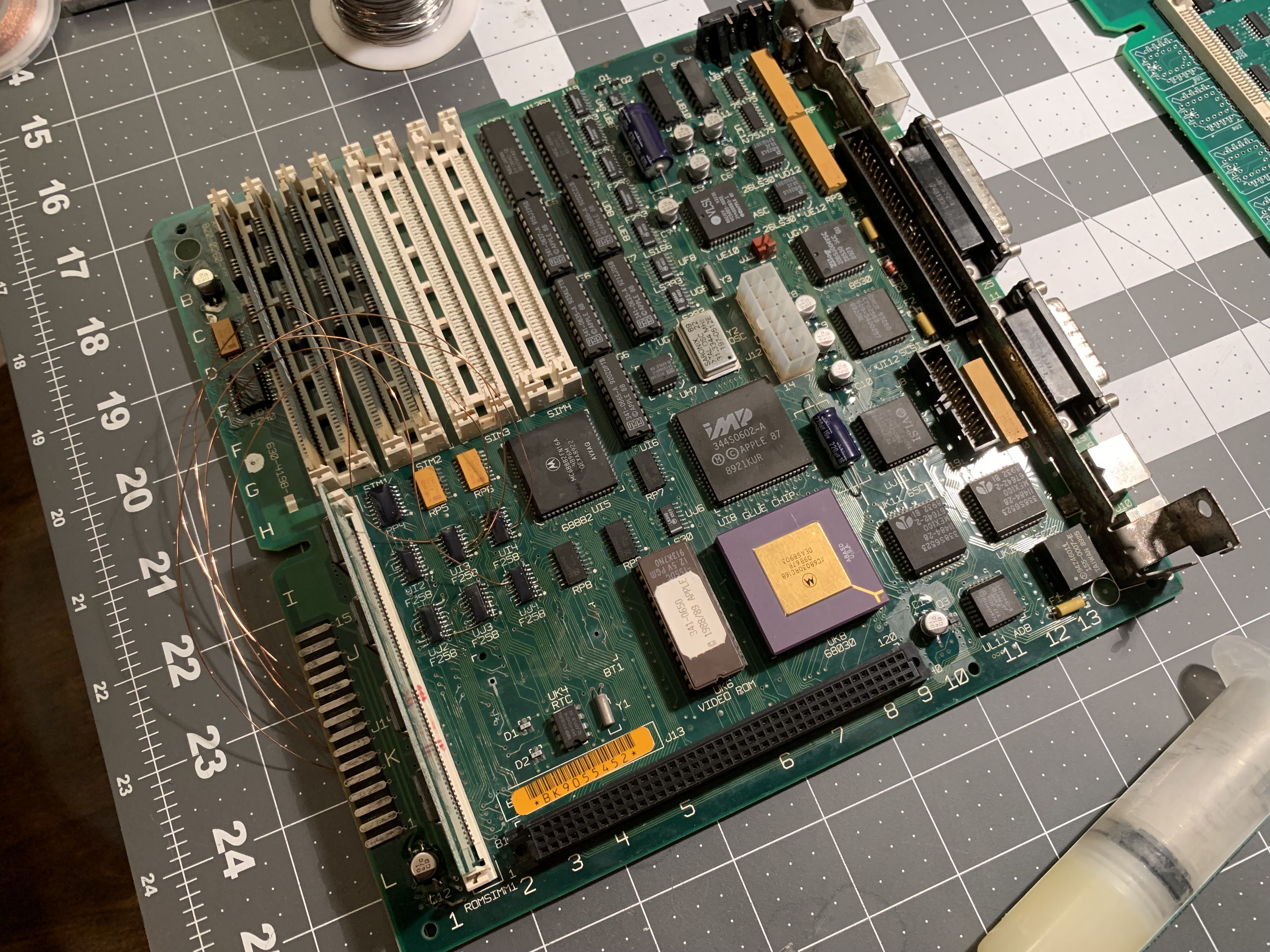

This is where I'm at now:

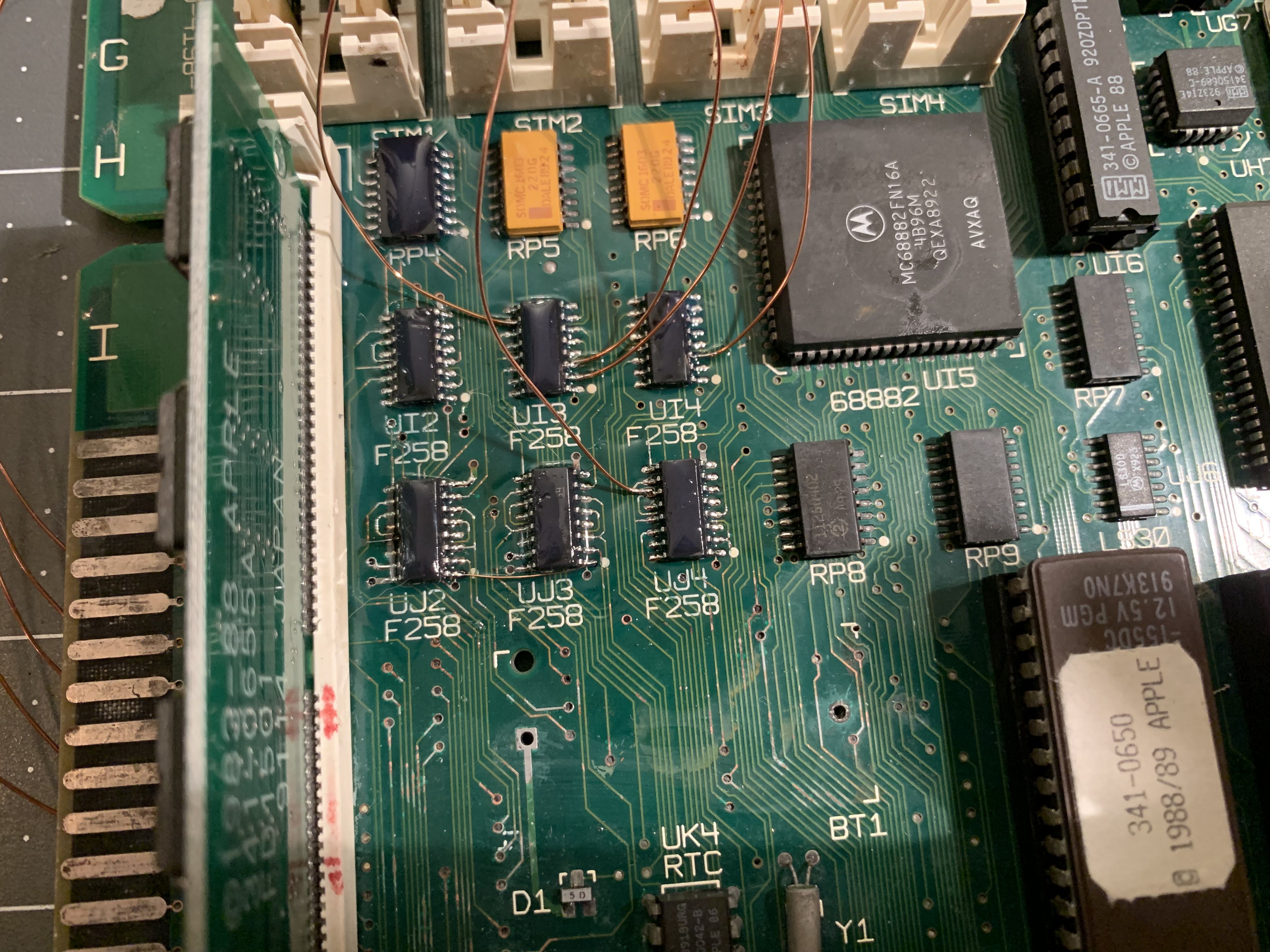

  • Battery holder removed

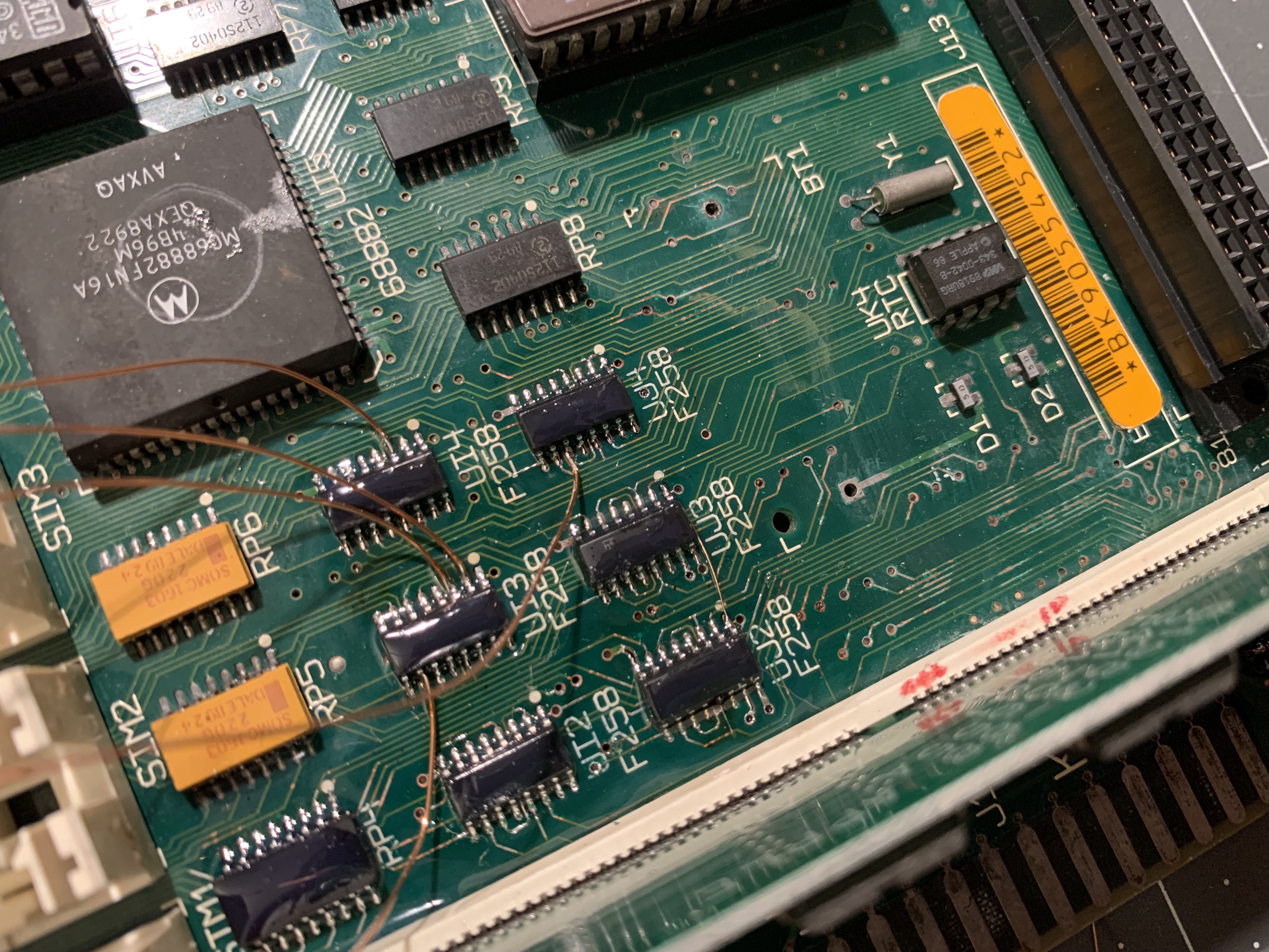

  • UD1 removed, cleaned, replaced
  • RP4 removed, cleaned, replaced
  • F258's removed, cleaned, and replaced
    • Had to run one bodge wire here to compensate for a missing pad
  • Entire board recapped
  • Five address lines restored with some ugly bodging (it's only temporary while I troubleshoot)
Unfortunately, none of what I have done so far has amounted in any sort of video output. I flip the power and hear the typical quite pop from the speaker, but no chime and no video. Voltages are all within spec, and I have toned out every connection to the infamous UE8 chip. I also made sure Hsync, Vsync, and Vidout from the Molex connector were making their way back to the ICs.
I'm stumped here! To add insult to injury, my SE/30 reloaded board has almost the exact same symptoms. No video, no chime. It's like there's a component required for boot that gets destroyed by the battery acid. Regardless, I'd appreciate any insight on where to look next! I should also mention that the behavior is the same with and without ROM or RAM installed. On my good board, no ROM and RAM will give me a simasimac pattern.

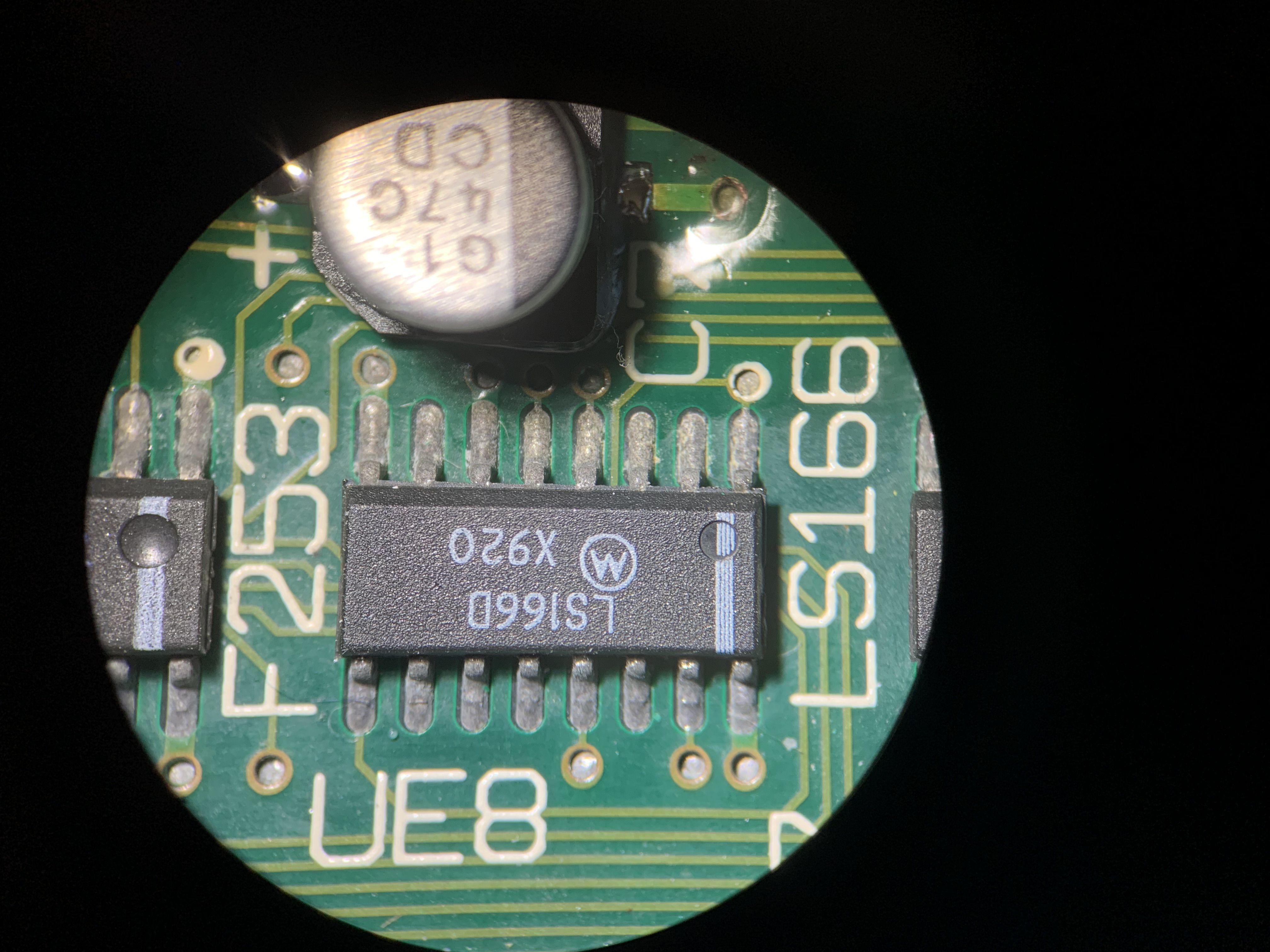

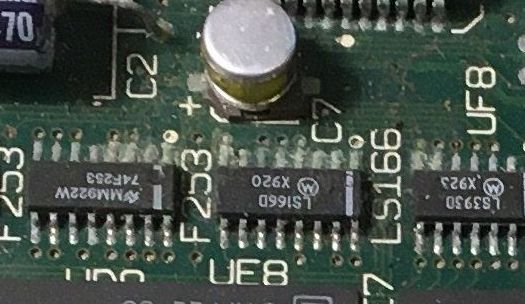

Have you double checked the UE8 connections? This area just looks really bad.
I had an SE/30 that looked similar in this spot and gave me lots of trouble. Reflowing the UE8 was a real pain, I noticed if I ever slightly warped the board video would still disappear even after pulling the chip and cleaning under. I had to use a microscope to verify every single pin was making a really solid connection.
With this much damage, it may be a good candidate for a donor board and transfer components to a recreated PCB as additional issues may appear on this board within a couple years.
UE8 is making good contact at all of its legs. I did measure continuity at the top of the leg nearest the chip in order to make sure the leg/pad contact was good as well. Here is what it looked like after the cleaning. There's still some flux on the board from the recap, but I don't think that's my issue.
Do these LS166 chips fail often? I think I have one or two new ones I could pop in, but I don't want to go through the hassle if they're generally reliable.

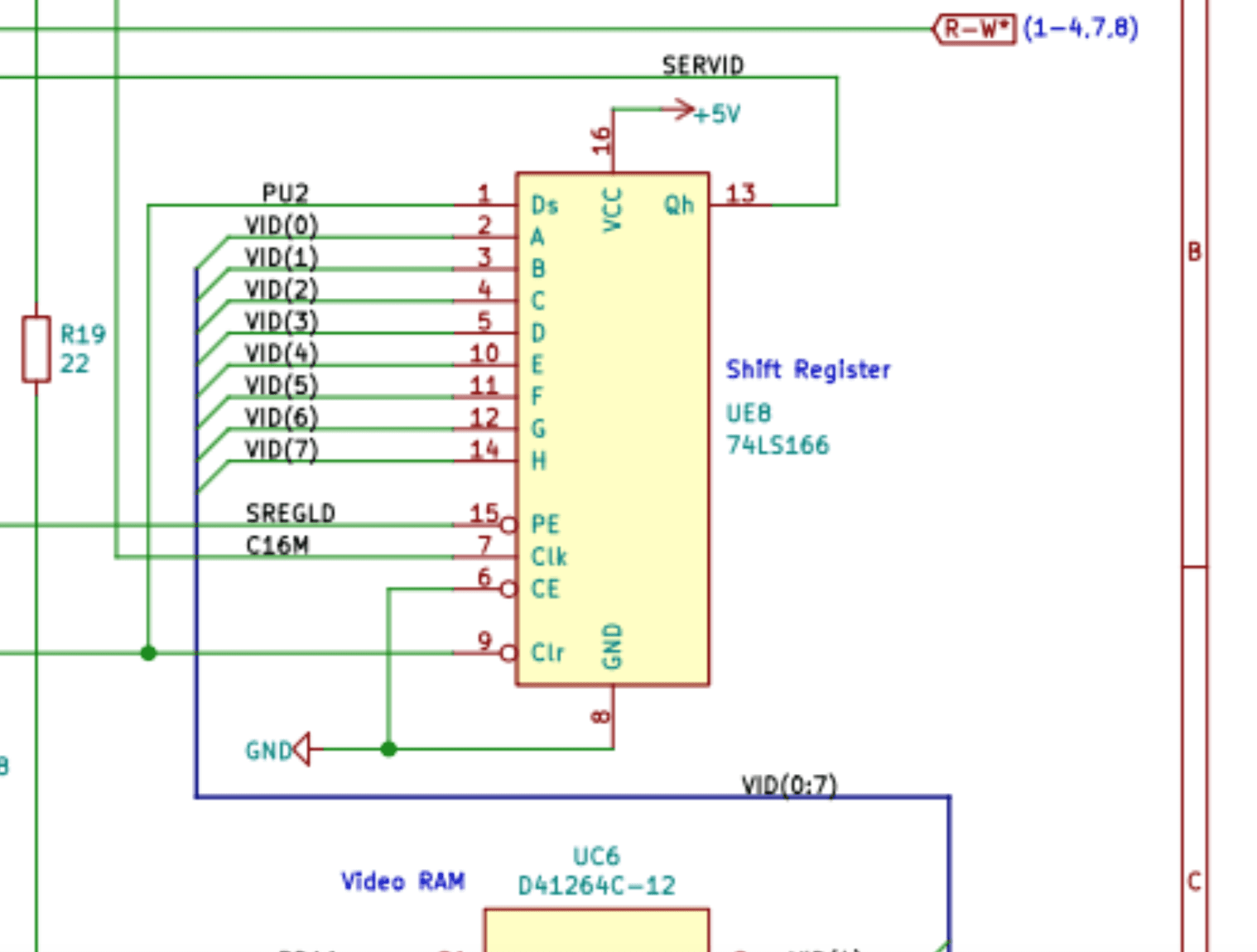

One thing I did notice, is that there's no activity on any of the VID 0:7 lines which I believe originate at the VRAM chips or MUX chips? On a working board, I read about 12kHz on each line at UE8. Can anyone confirm where these signals originate?
The only other thing I haven't done is swapping the video PALs. Maybe I'll try that later. I am not so worried about the ROM address lines at the moment, because I should have some activity on the screen even without ROM or RAM installed.
