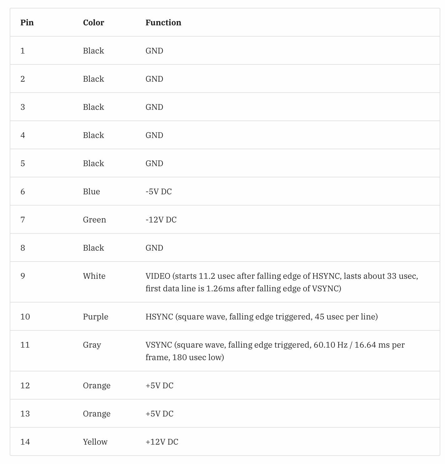

I got an SE/30 motherboard. I already had an SE case.
I'm planning on putting it together with a Pico-PSU (+ -5V adapter board), blue-SCSI and an LCD display.
I know the J12 connector on the motherboard receives power and outputs video signals.
Questions:
  1. Do anyone know of a simple diagram for the J12 stating where I should connect ground, +12, -12, +5 and -5?
  2. Which pins on the J12 output video signals?
  3. I heard it's possible to get color video signal out of the PDS slot. Does anyone have that information in more detail?
As always, thank you for any information!
edit.
I found it.

It is indeed doable. A lot of ppl have used RGBtoHDMI to hook LCDs to compact macs.
I already saw ppl feeding power directly to the motherboard.
The color signals from the PDS slot I just heard of, never saw.
What I don’t have is an accurate pin out schematic.
