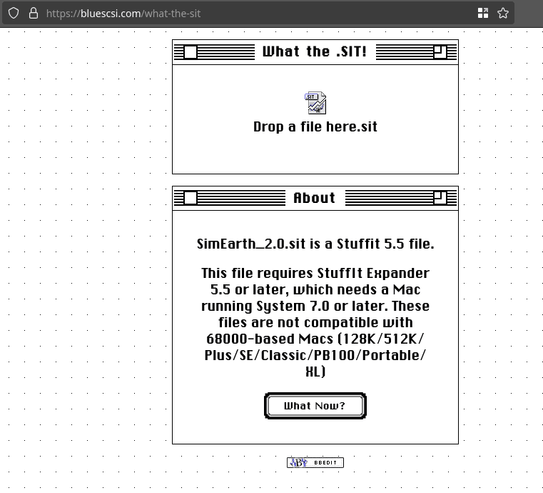

It's a Stuffit 5.5 archive, unstuffs fine with 5.5 - will not work with older Stuffit versions. One could reasonably argue a 1990 game should not be stuffed with 5.5. You can use https://restuff.jcs.org/ to re-stuff it :)
That's odd. I'm using an SE/30 running 7.0.1 and I have Stuffit Expander 5.5. It seems to corrupt every time. I'll try that Restuff tool - very useful thanks.
Got it - Stuffit 5.5 Engine can't run on 7.0.1 so even when using Stuffit Expander 5.5 it can't unstuff v5.5 files. Worked fine on System 7.5.5. Probably should be repackaged given that it's a game that runs on old B&W Macs.
