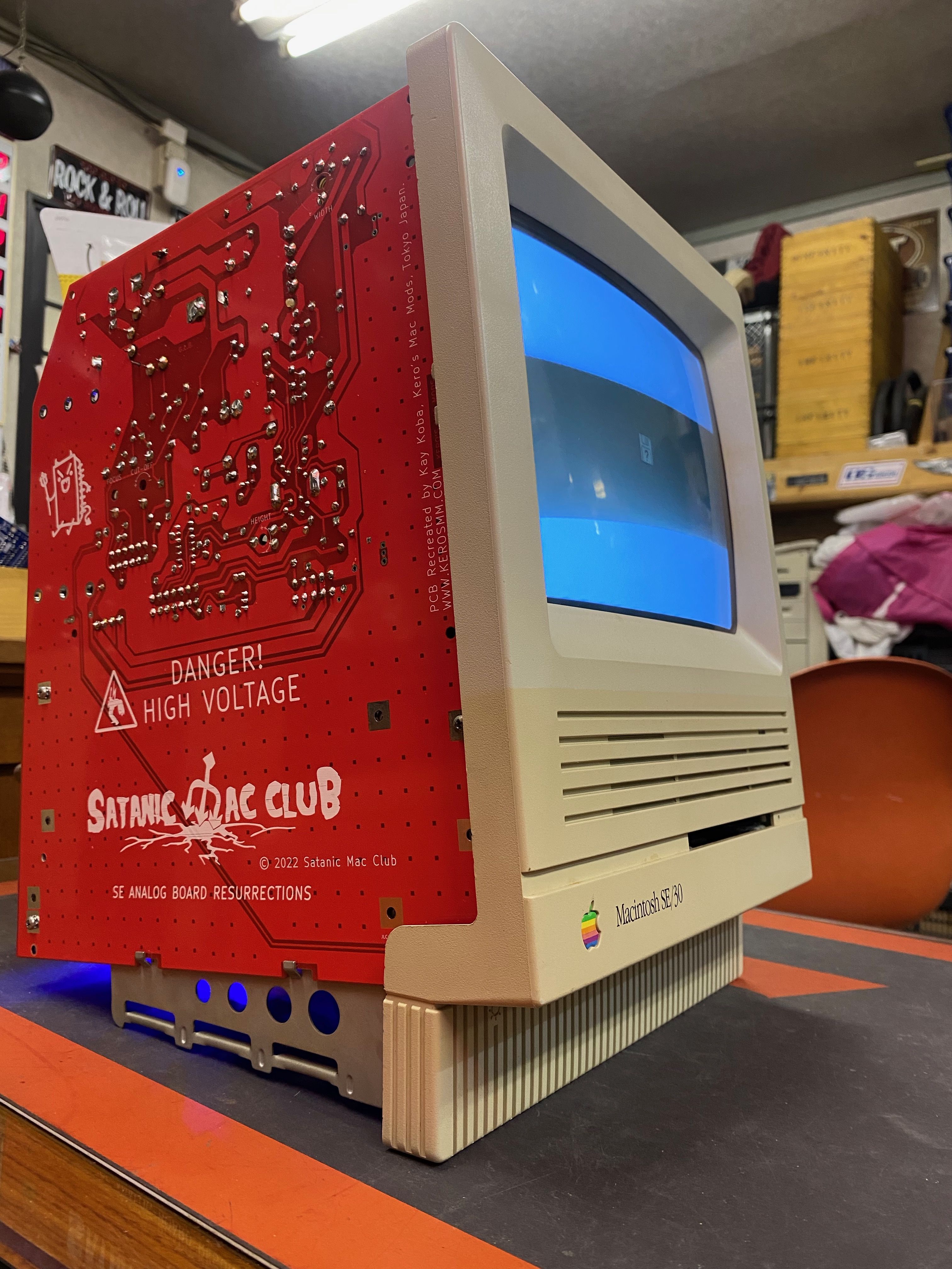

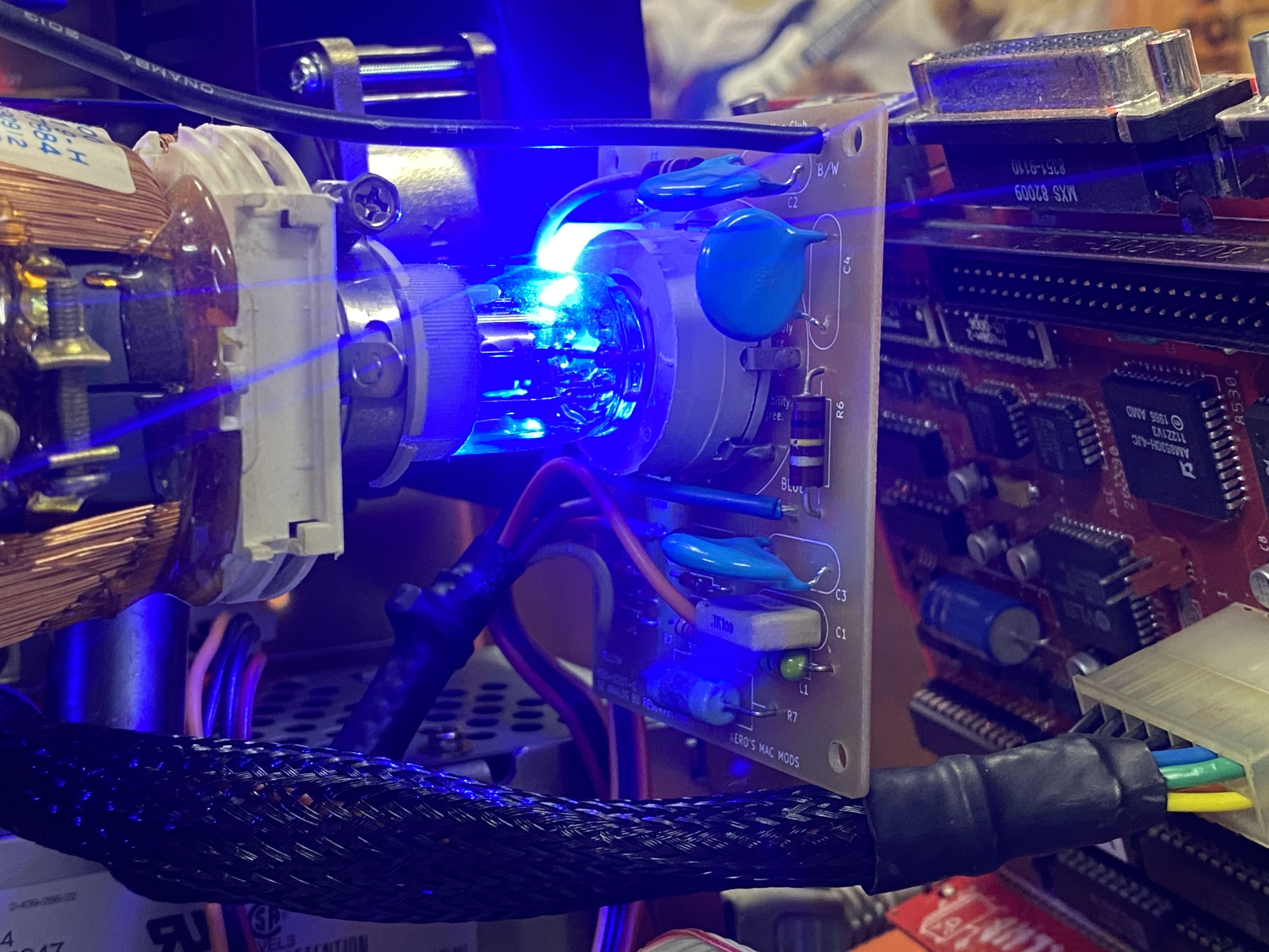

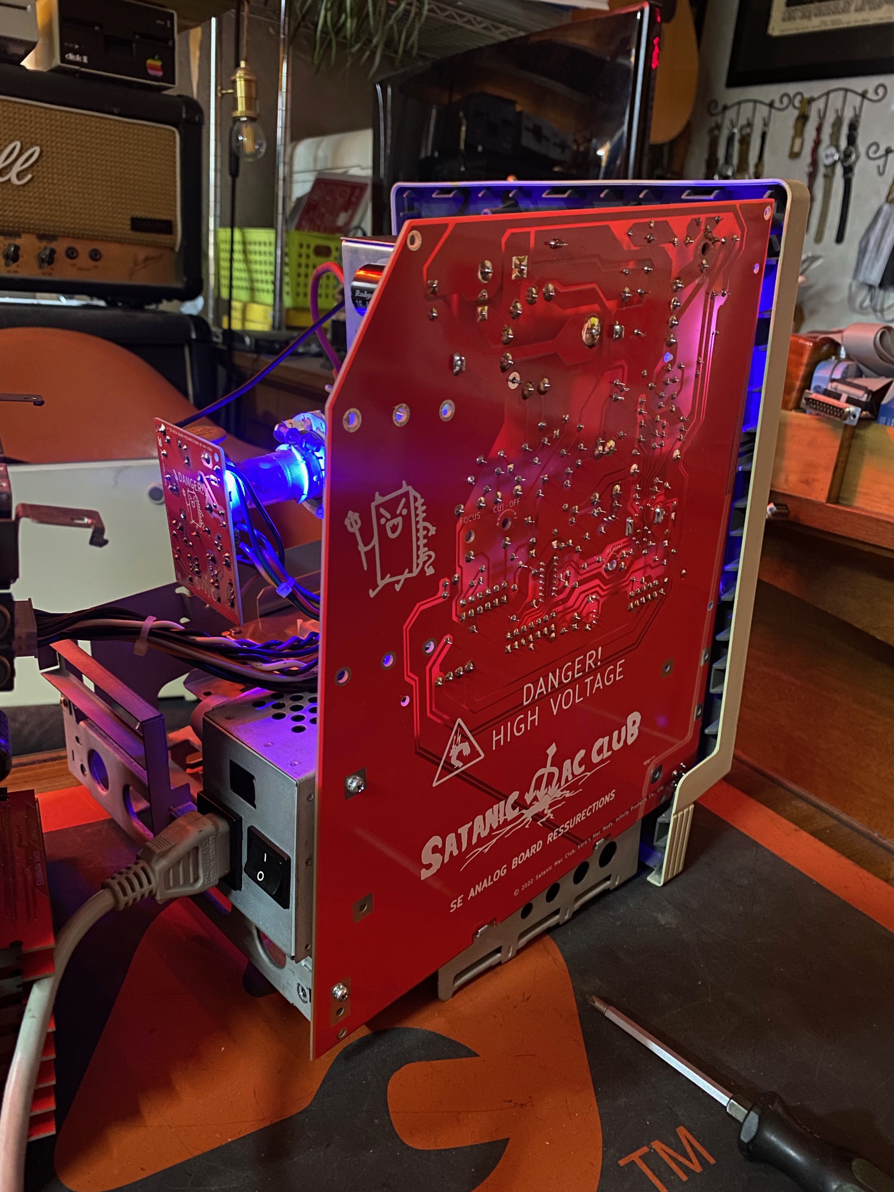

I recently built Kai Robinson's Classic Reloaded and Bolle's SE/30 Recreation. Classic Reloaded was assembled cool and completed. However, the SE/30 is not cool with the genuine analog board, which is essential. So I decided to make an analog board.
Before anyone points it out, this product is not suitable for those who only want functionality. I want to seek beauty, so I just create.
Since it's a single layer board, I didn't use the advanced techniques like Kai's and Bolle's logic boards, but I placed the ground Cu fill like the original.
While making it, I thought about how faithfully it should be made and whether I should add my own arrangement.
Differences from genuine board:

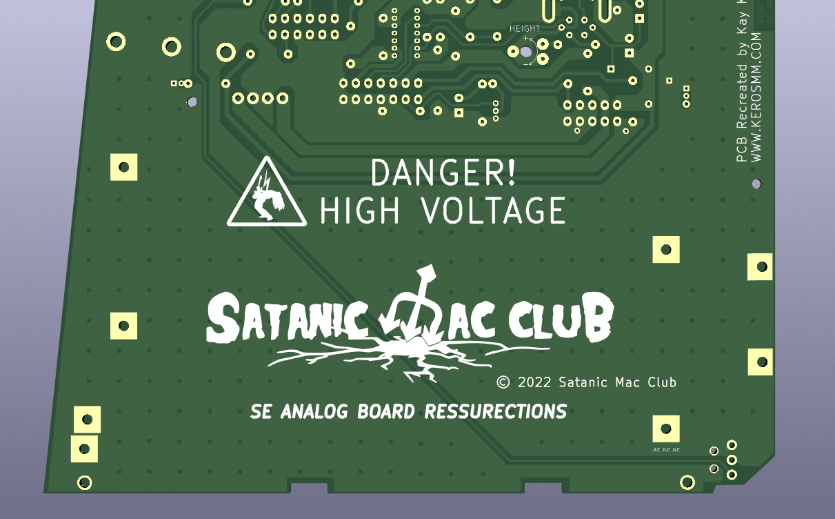

- Coating is also applied to the top layer. The aim is to make the impression tight with red and black.
- LEDs are arranged one by one. I think you can use a blinking LED if it doesn't affect the noise.
- Great Drake's "IC Devil" character. And SMC and my logos.
If there are no major problems, I hope to report the completion next month...

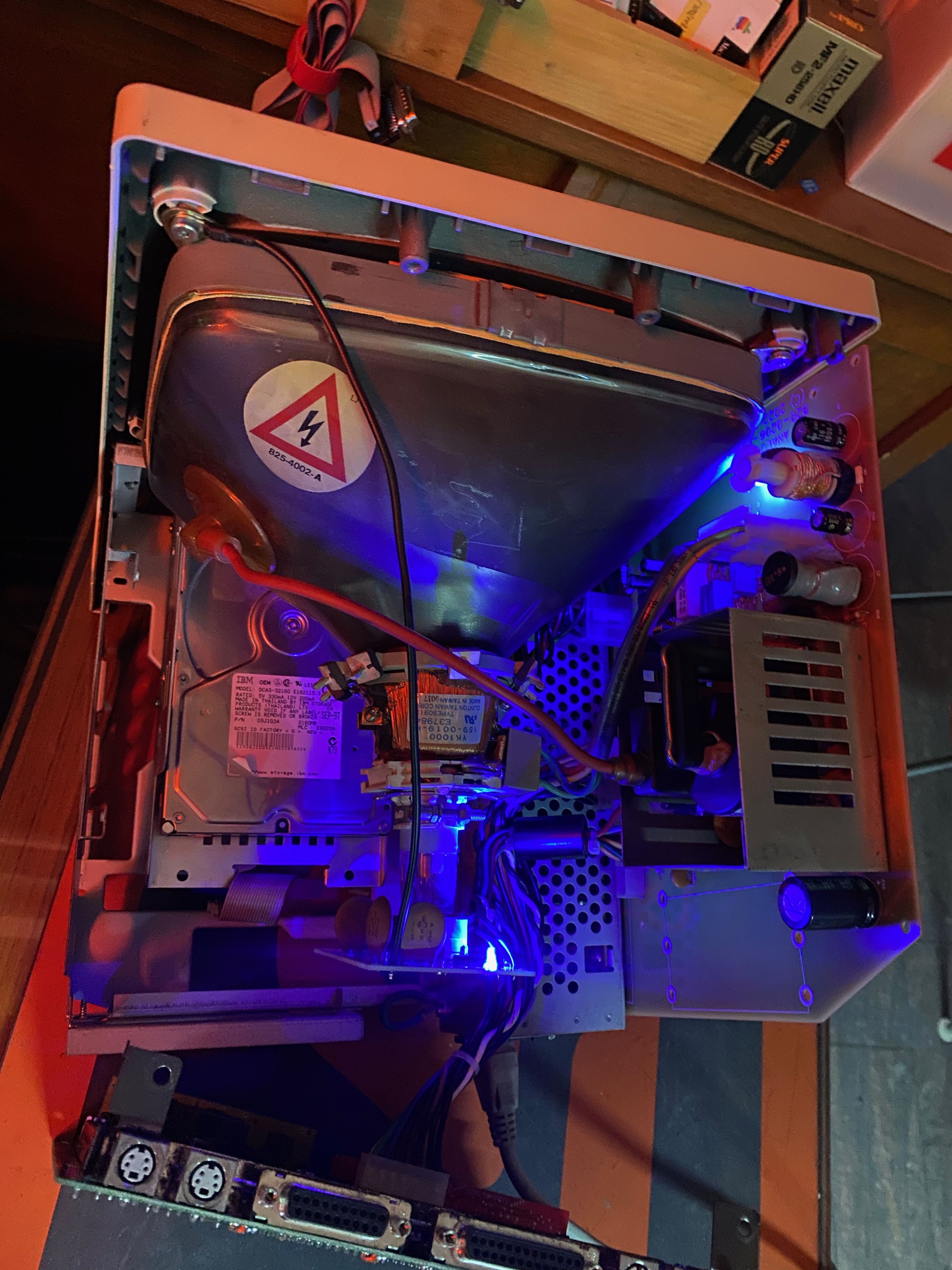

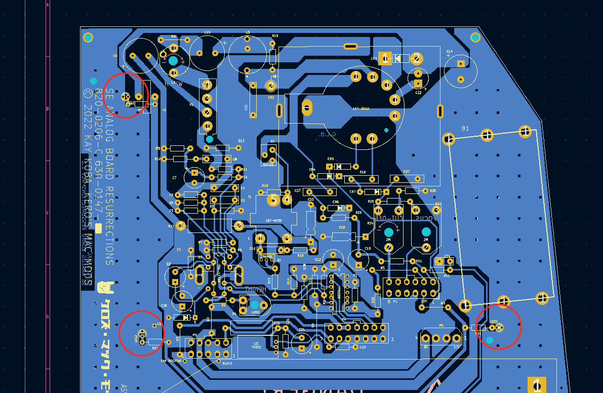

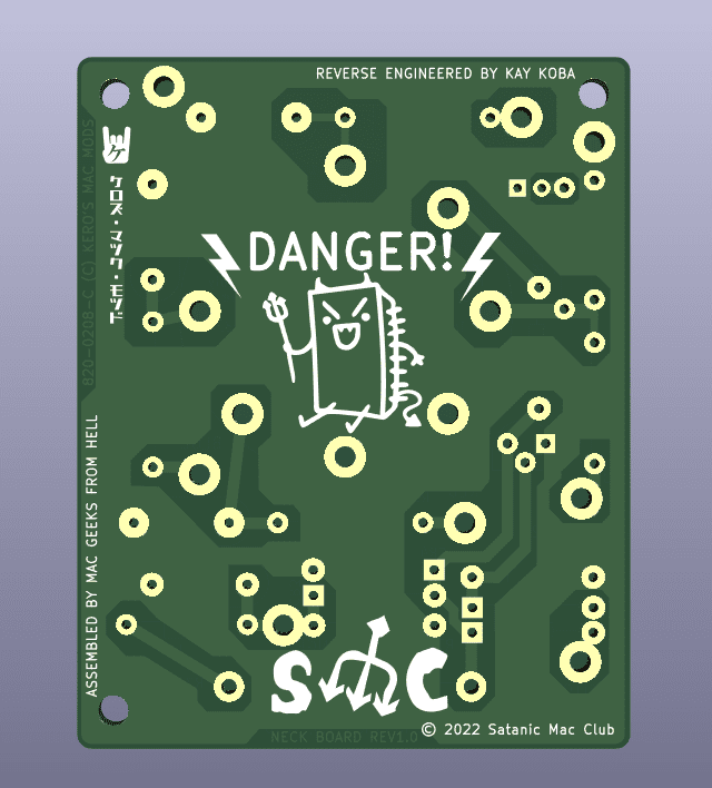

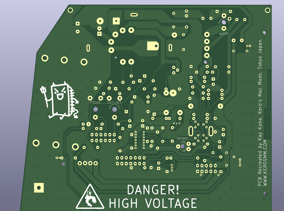

I'm slowly updating the board while waiting for the PCB to arrive. I used 5V to power the LED, but changed it to 12V. The original has dots scattered around the ground fill, but I did it the same way.
I created the BOM first, so please use them.
*Dec 22, Analog BOM Updated.
*Dec 5, Neck board BOM Uploaded.

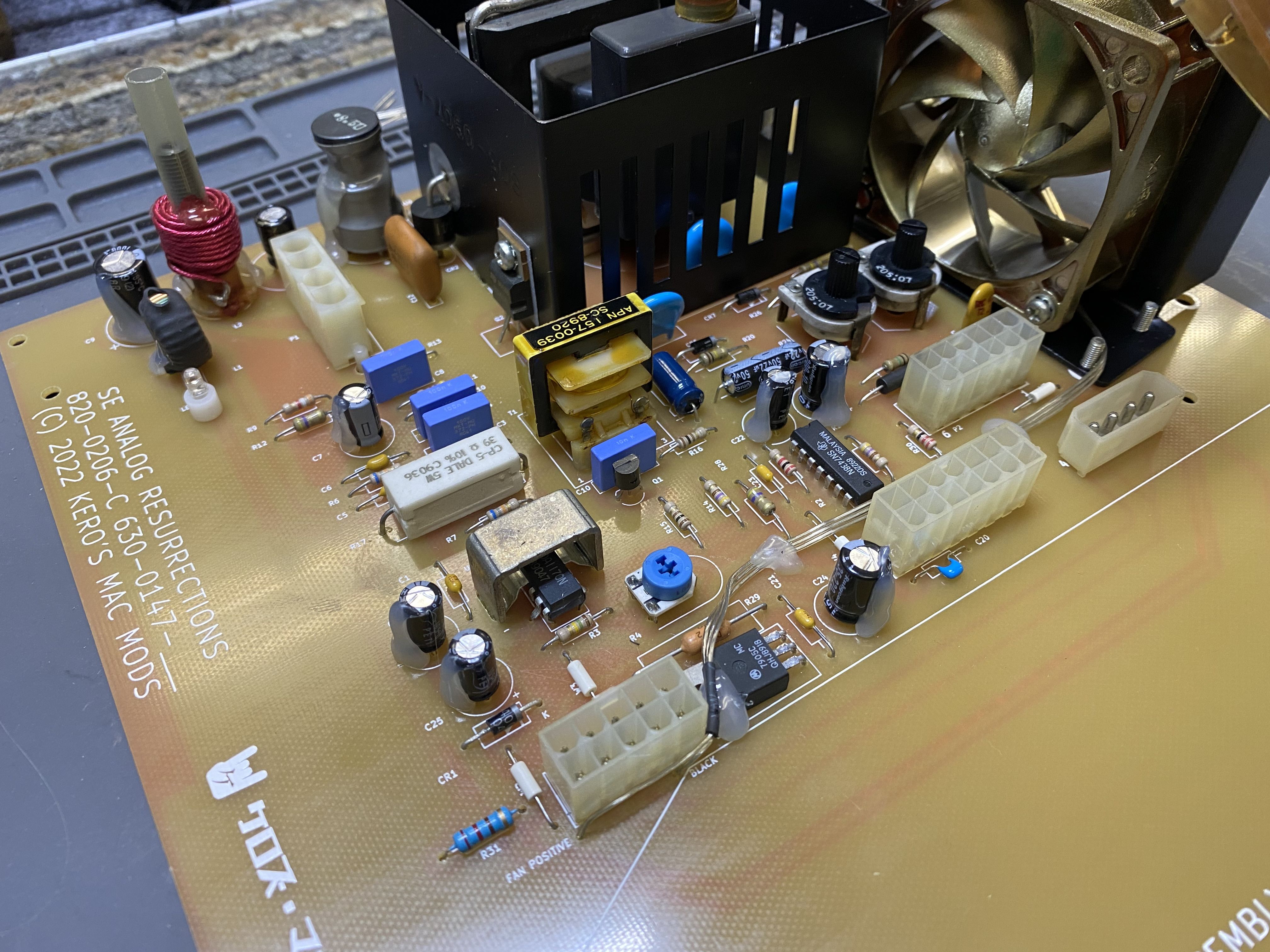

Rev1.0 worked fine with no footprint mistakes.
For the next step, minor change in Rev1.2 (1.1 is a plan failure):
- The LEDs are powered from +12V (similar to my Neck Board) instead of from +5V. There are 3 positions for LED placement because there is a preference. You can install it as you like.
- The pads on the U3 were small, so I made them bigger. U2 is also slightly bigger.
- A small square dot is provided on the ground fill. Also fixed the shape of the ground fill.
- Moved the R4 trimmer hole slightly to the center. Apple's genuine hole is also misaligned.
- Fixed the ground of the front brightness adjustment pot.
- I made the hole for the wiring on the neck board smaller. I'm trying to match AWG#20 exactly.
- fixed misspelling silkscreen 😅
In fact, many current electrolytic capacitors have a narrow pitch, so I thought about correcting this as well, but I gave up because it would be impossible and half-finished depending on the position.
Special thanks for @Drake and @Stephen , they support me spiritually...lol

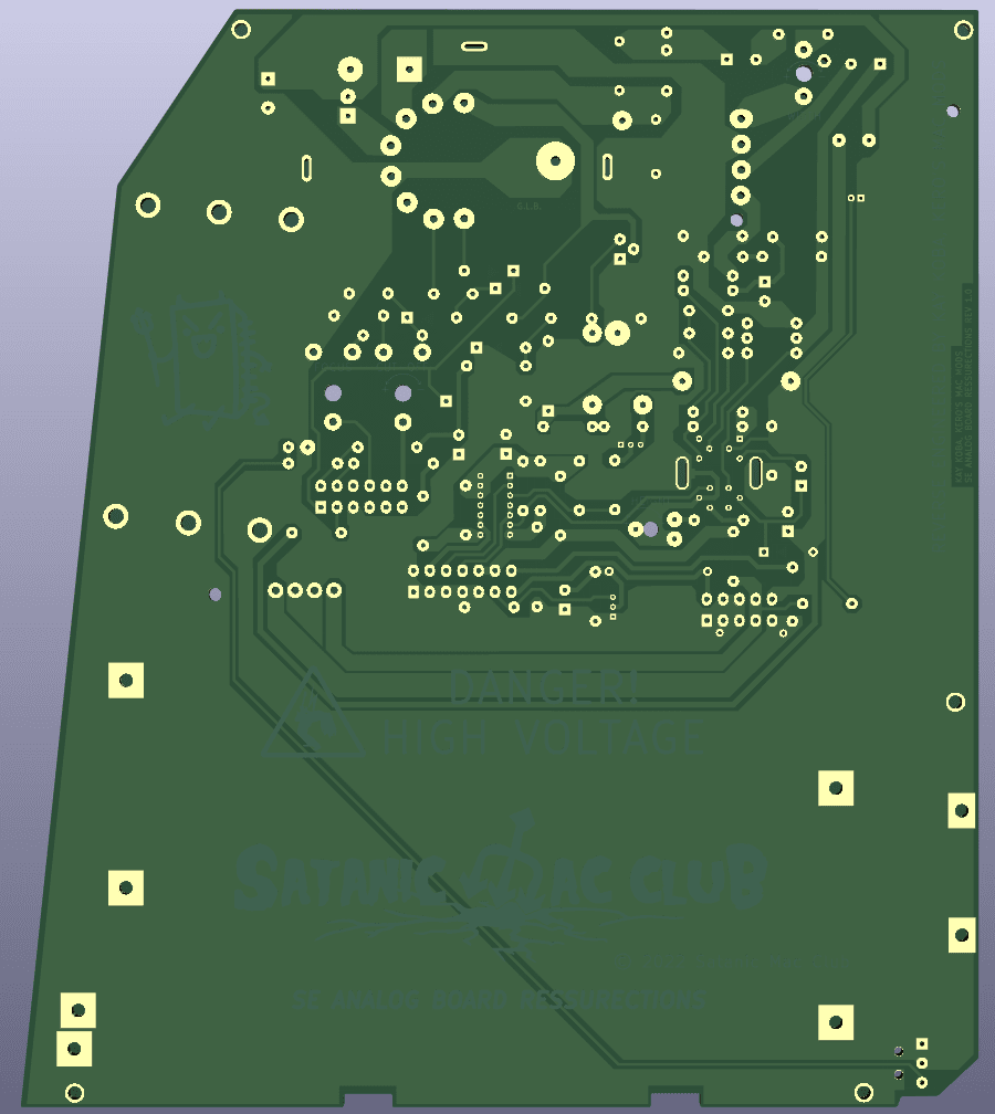

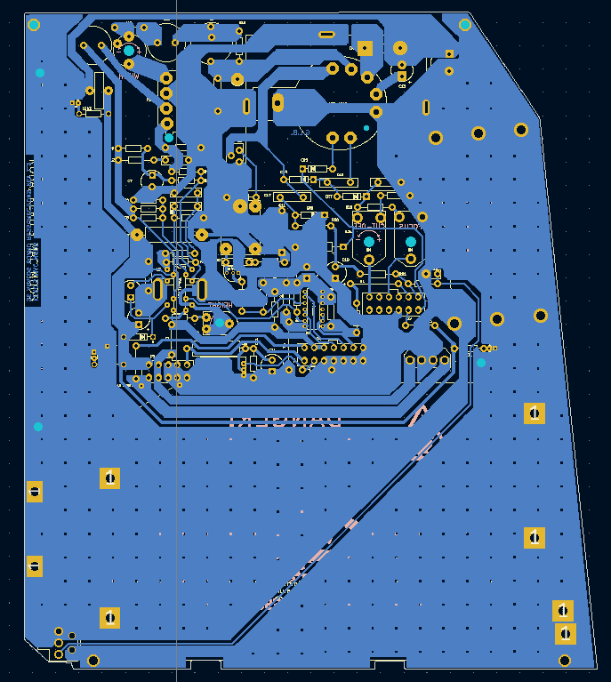

スクリーンショット 2022-12-06 0.02.09.pngスクリーンショット 2022-12-07 0.01.06.pngスクリーンショット 2022-12-07 0.00.55.png

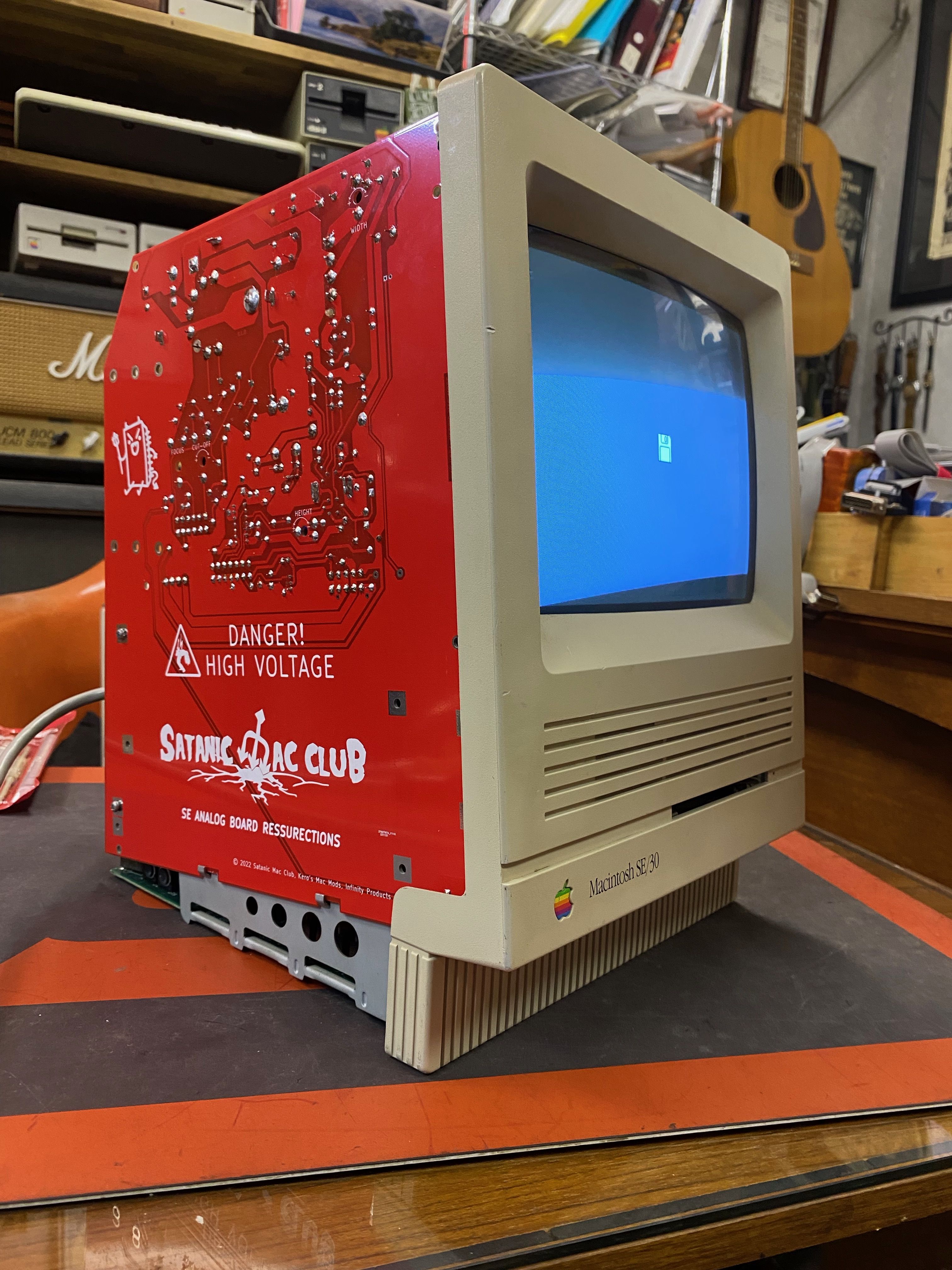

The Rev.1.2 board has been completed. It looks like all the prototype work is done with this, so we are thinking of selling this. I have my own store so I don't open source it, I sell it reasonably in my store.
Rev.1.2 improves:
- Improvement of the GND part where the brightness pot is attached
- Replaces entire GND fill design
- Improved the size of each part hole
- Added 2 more LEDs
- Fixed "Resurrections" silkscreen spelling mistakes
- Both layers have solder mask *We are considering Red and Purple

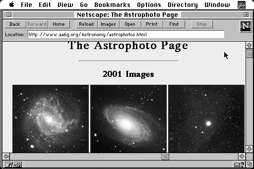

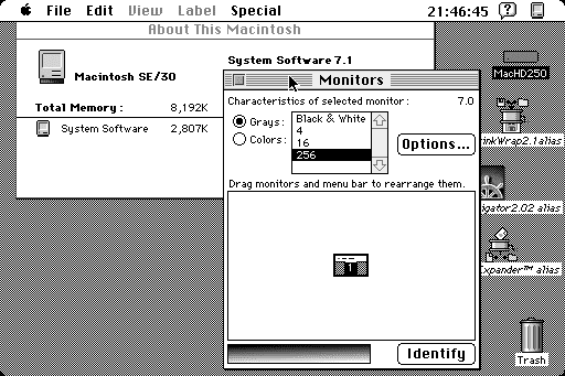

However, I thought that 640x480 display was not possible.
In that case, the usage is quite limited. I made a SATANIC SE/30 before, which can display XVGA rather than VGA.
This method also works for SE/30 logic boards.
*video card required
On a side note, Bolle's neckboard and graphics card look great in purple.
