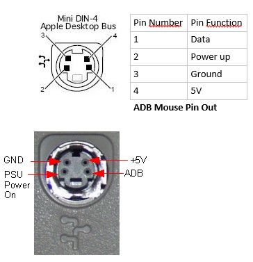

This has me thinking as to why hot swapping is D A N G E R. Looking at the pinout of ADB I am wondering that maybe there is a solution simply with the 5v line in. what is the behavior of the keyboards controller during powerup and how can we make a circuit to safely simulate that when hot swapping, flip a switch, wake up the controller and feed the appropriate data+/- and 5v.
Does the Apple only look for a keyboard during power up?
the software supports hot swapping but hardware does not. People have and i'm sure still do hotswap their ADB devices. there is just a chance. you could cause a short and fry something.
But yeah. you can plug in keyboards / mouse / joysticks. and they work. as long as you were lucky enough to not cause a short during the process.

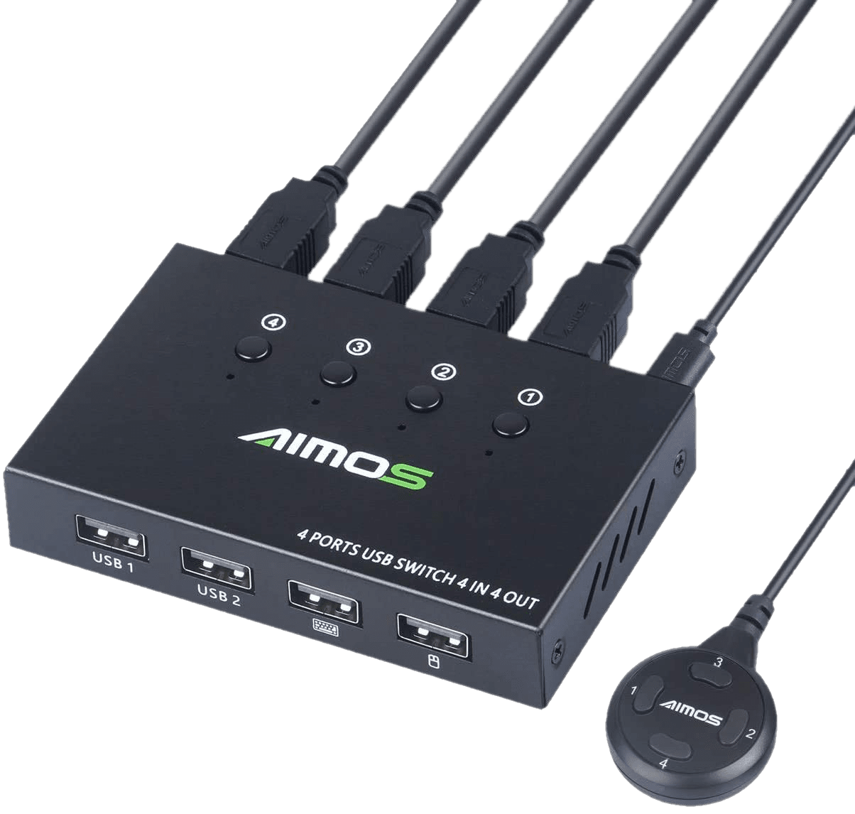

Any recommendations on a USB KVM that is KB/Mouse only?
Got the wombat and I am able to manually move the Drakeware USB from it to the modern PC and back. I did have to add a second ADB port (scavenged from a Classic bombed board) to the wombat for the mouse - the speed of the mouse via the drakeware was slow and I couldn't adjust it. Havent picked up a USB switcher yet, so many bad reviews on them I'll wait a bit.
