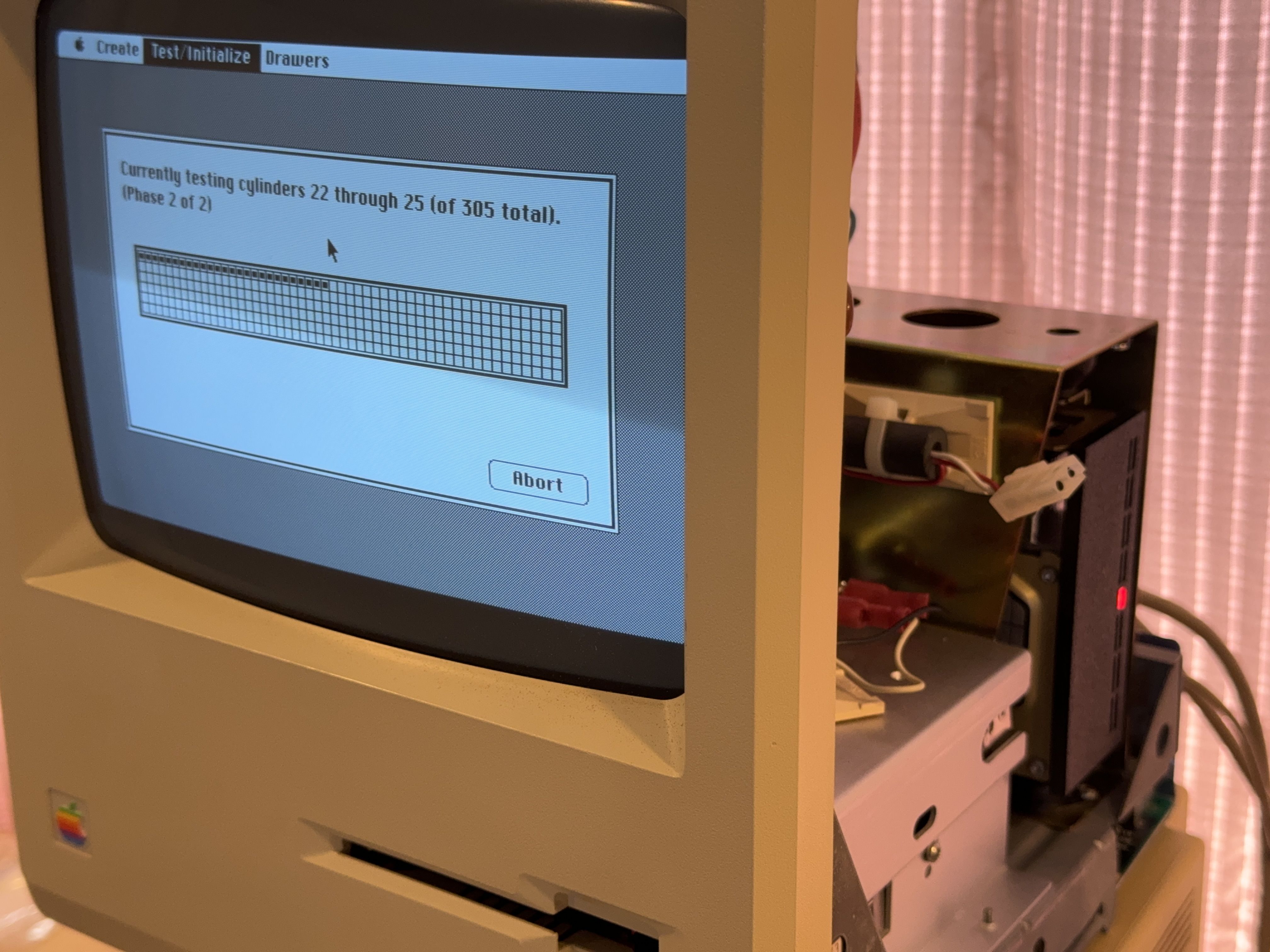

I can boot off a 400K floppy disk and use the HyperDrive software (I've always used V2R1) to access the drive just fine. After that, I can copy files to the HyperDrive, from the drive, and I can also use the HyperDrive software to mount "Drawers" and close them. I can delete drawers and create new ones. If I launch the "Manager" app and run the disk tests (from the Test / Initialize menu), all tests pass. The "cylinders" test is very intensive and takes a long time to complete. If the drive mechanism was bad, it wouldn't pass those tests.

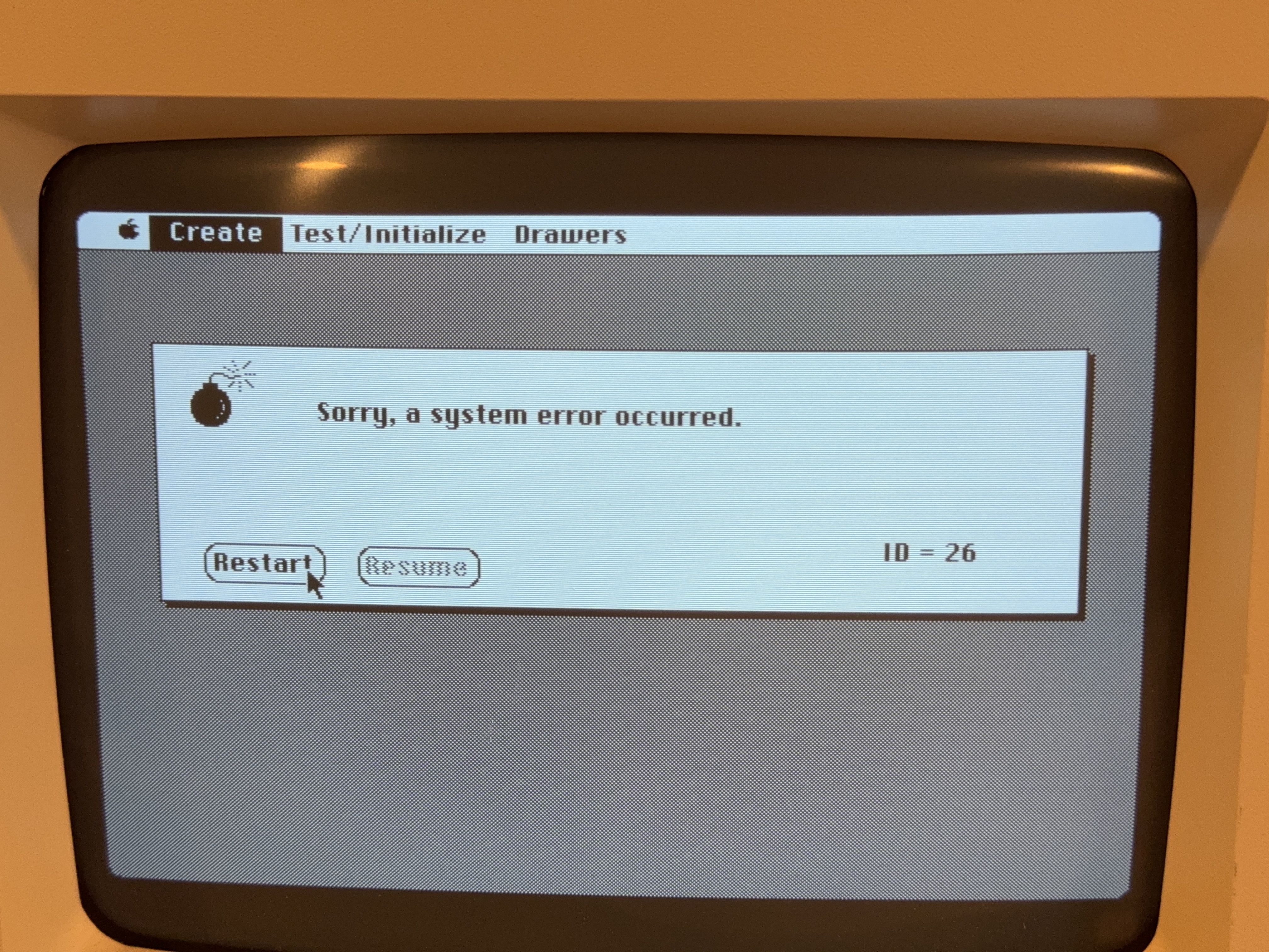

Everything seems normal when I do that, but then when I try to quit the software (even other apps too), I get a System Error.
And then when I restart, I get that 2-4 minute wait and a Sad Mac most of the time!

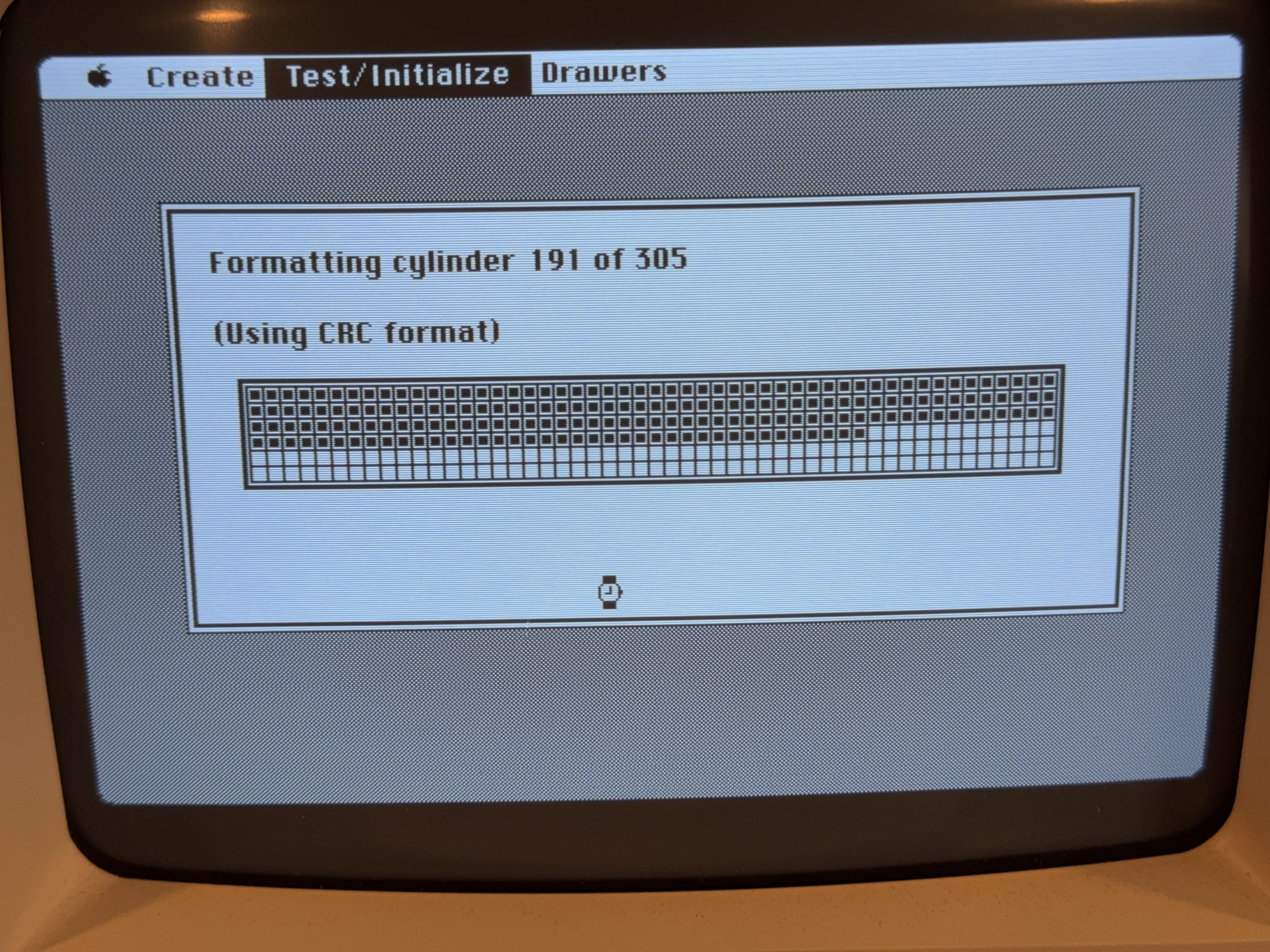

I finally found a FloppyEMU I use with my Apple IIc, flashed Mac firmware to it, then added many blank MFS 400K disk images for the purpose of making a backup. Using the HyperDrive Backup app, everything went smoothly. That enabled me to try the one thing I hadn't been able to try before, which ultimately was the solution: LOW LEVEL FORMAT.
Specifically, there is an INITIALIZE button and a FORMAT button. The key is to click FORMAT. It then asks you for the system password, so I typed "System Password" and it worked.
After the format was complete, I created a new Drawer, named it Startup, then copied the System files from V2R1 boot floppy to the Startup drawer, since I know that system software works fine on my 64K ROM Mac512. I then copied the HyperDrive installer app over to the drawer and ran that to ensure all required files are added to the System file in the Startup drawer. I then copied over the Manager app and restarted. To my delight, I got the normal black spashscreen with HYPERDRIVE logo text and it booted right away. No delays! Crashing and other problems reported in my opening post are now gone.
So it would seem that whatever caused those artifacts to appear when I first powered the machine on after having been in storage for 1 year corrupted the drive content so badly that a low level format was required to fix the problems. I had tried defragmenting prior to using FORMAT, but that didn't work. So FORMAT is the key to fixing problems.
Of course, if you don't already have a backup, getting your files off the Hyperdrive and onto other media could be the sticking point, and that was the reason why I tried everything EXCEPT a low level format first. But after finding my FloppyEMU, that problem was solved, and FORMAT saved the day.

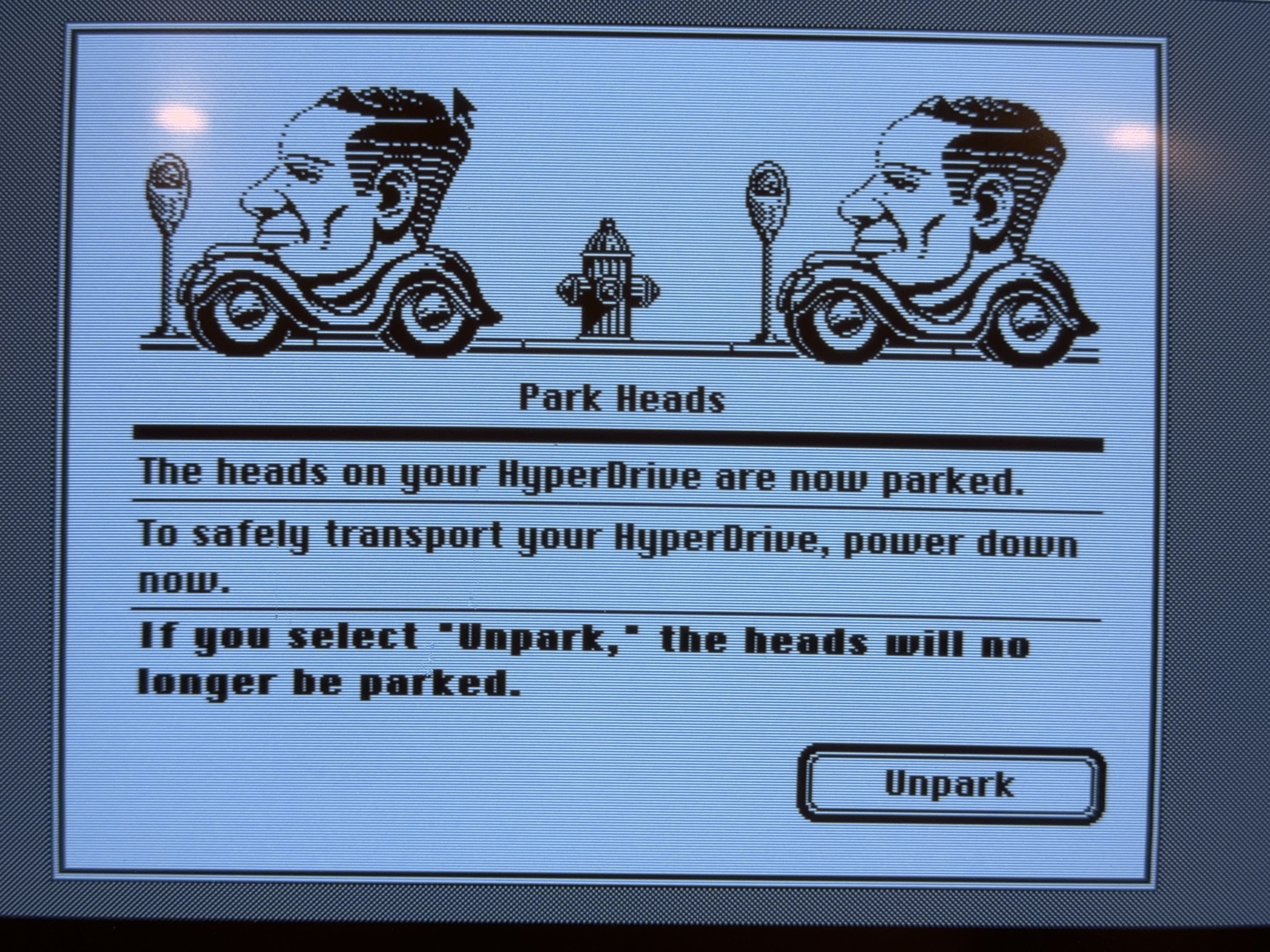

When you are finished using your HyperDrive Mac, it's highly likely you will move the machine. Before moving it, PARK THE HEADS.
Sounds odd in 2024, but remember this hard drive is from the mid-1980's when heads were left having precariously over the disk platters UNLESS you manually parked them. If the heads are left hovering over the disk when you move the drive, any bump could send one of the heads crashing against a disk platter, possibly damaging the drive.

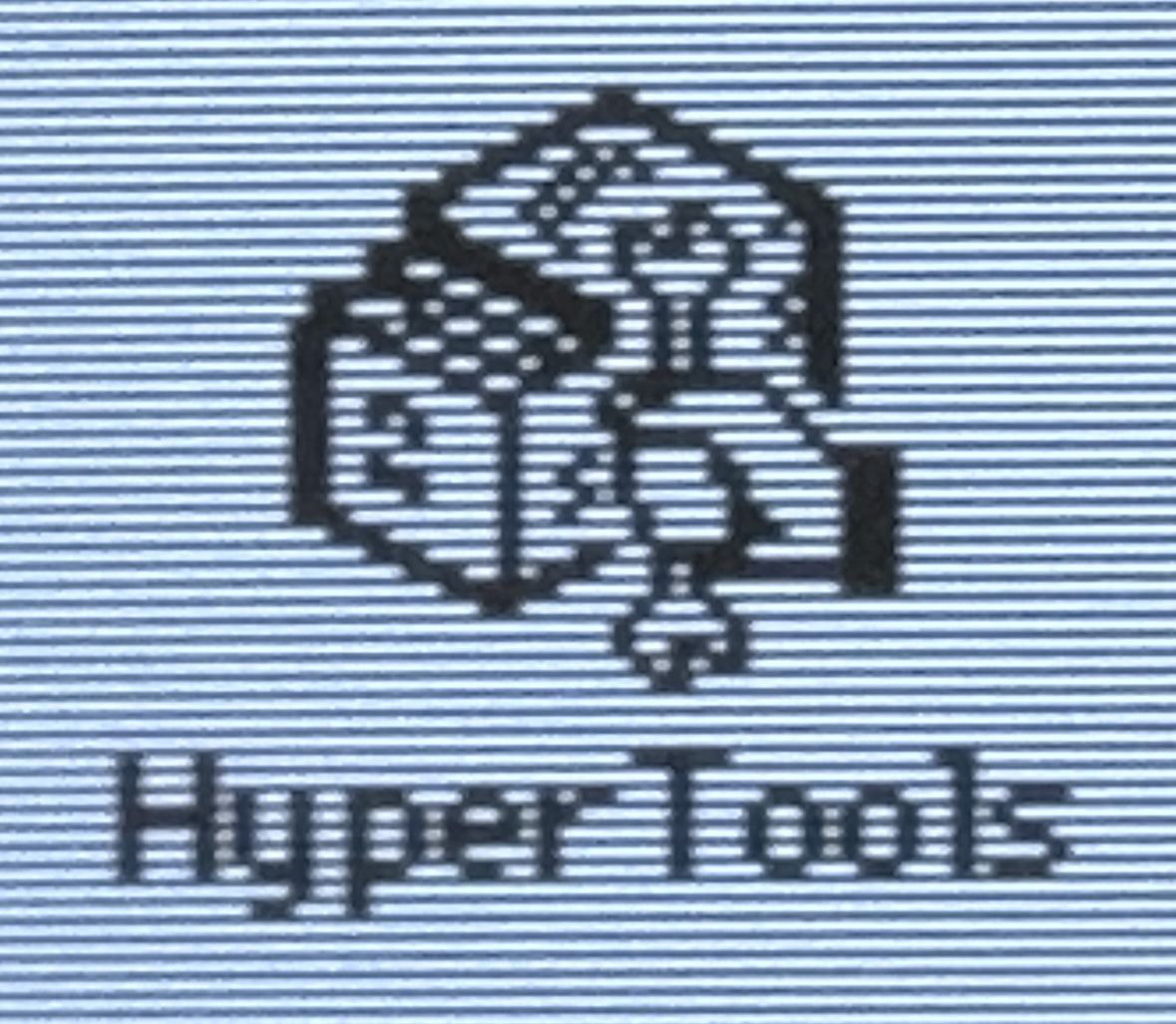

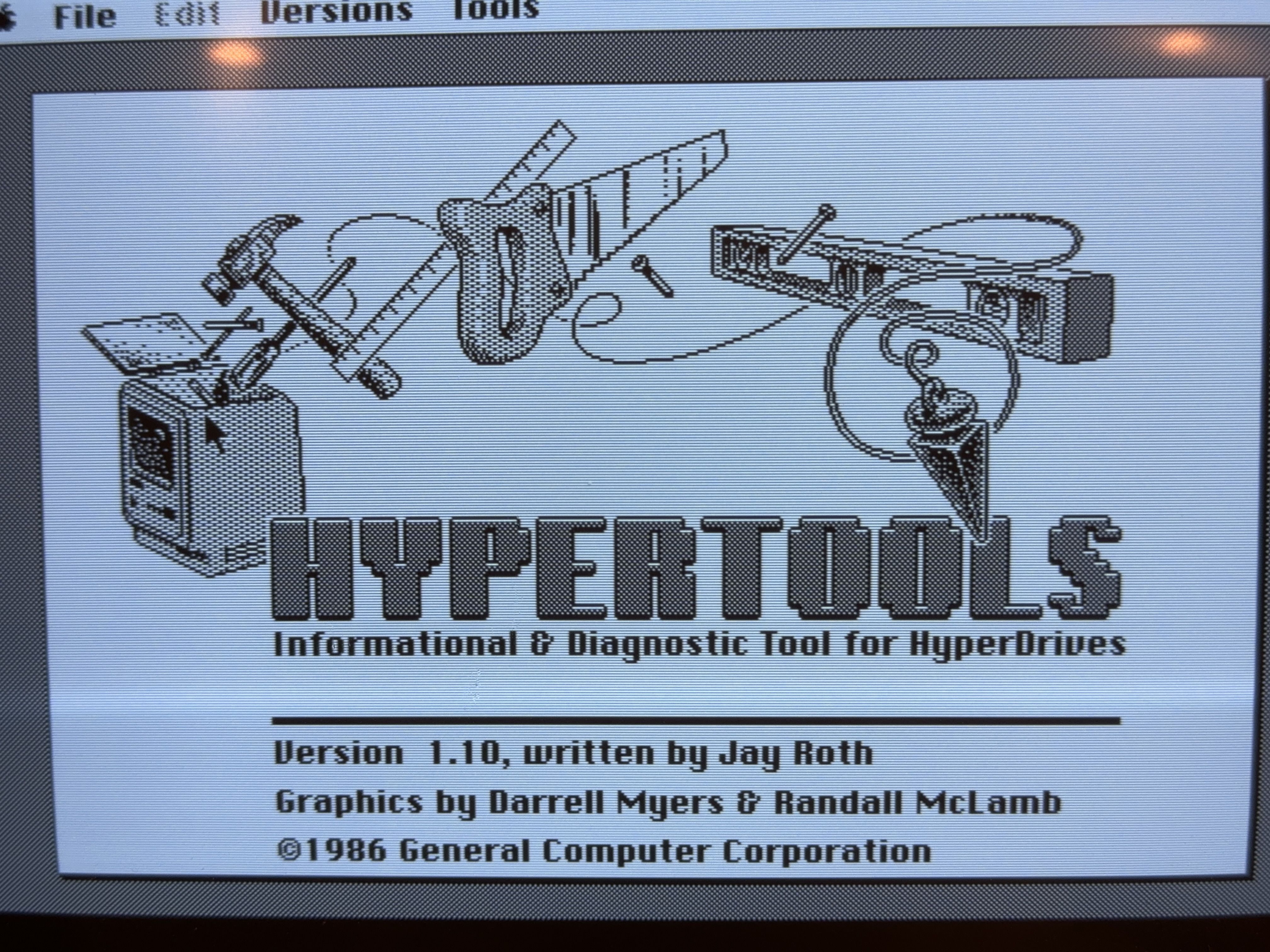

Thankfully, GCC added a head parking feature to their HyperTools app to let you manually park the heads. I added this extra info to Macintosh Garden just now.
