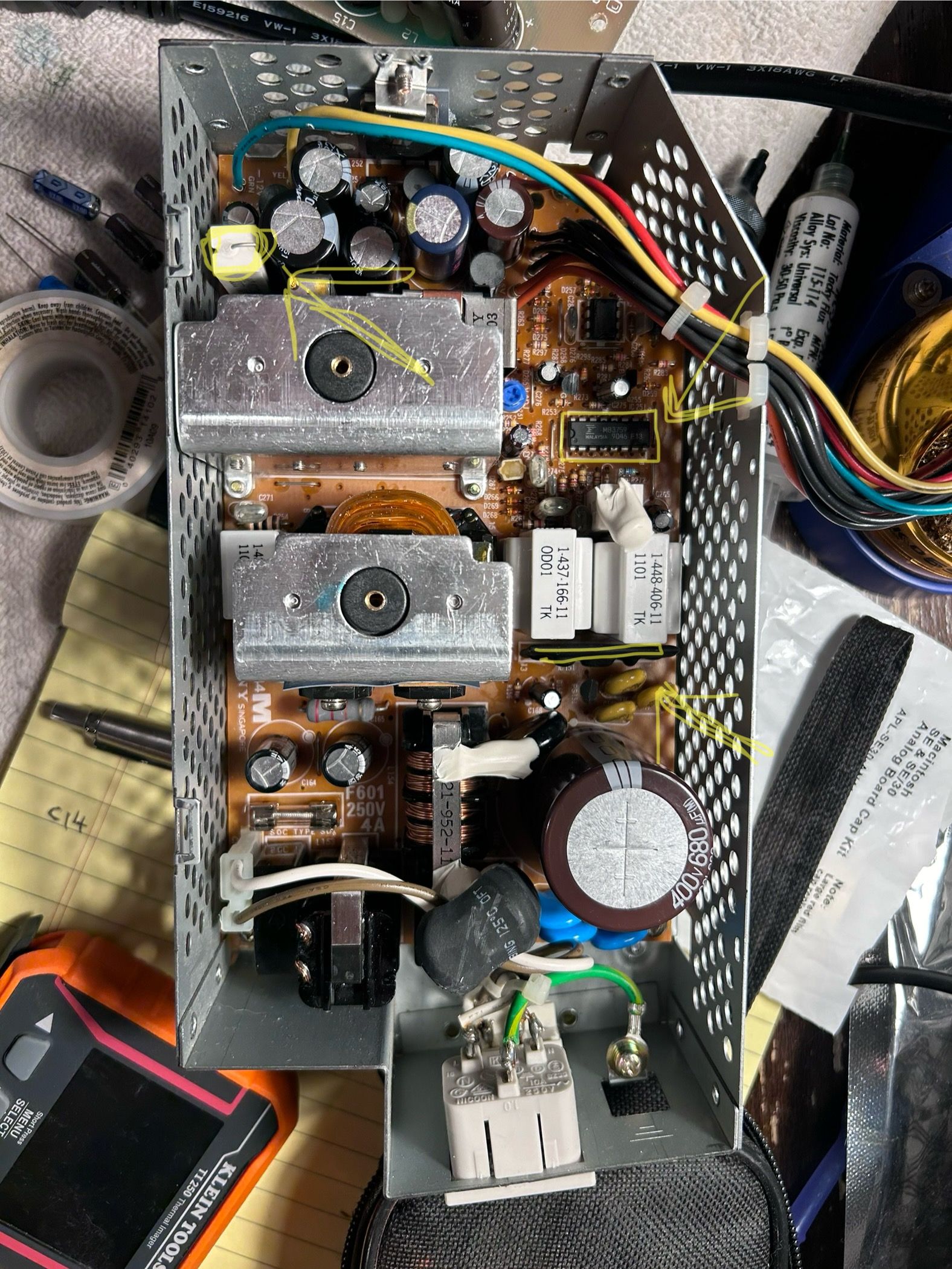

Thermal camera! Good call! I forget that I have one. I looked carefully and saw three points that were heating up. I circled them in the attached picture.

The resistors won't matter unless they are visually browned or blackened with heat.

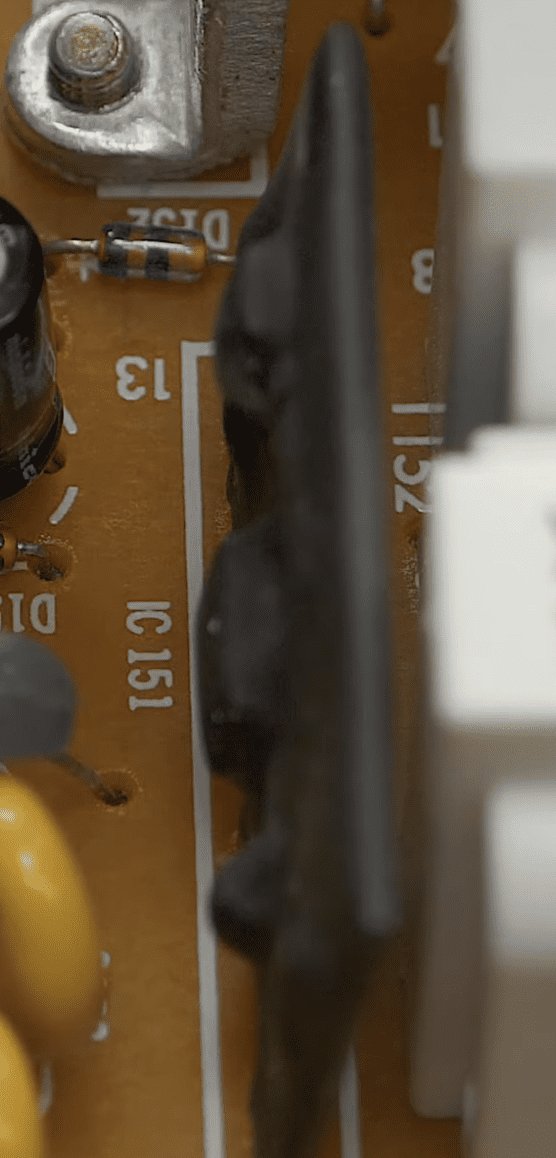

The the black IC151 board shown was said to be hot, at 112°C, but I think that is normal...
IC251 probably shouldn't be hitting 100°C (unless all your measurements were °F, and in that case, it would be 37°C, which is nothing of concern at all).
You didn't mention IC253, but it shouldn't be getting anywhere close to 100°C either...
Examine for burn marks on any component, and on ICs you would look for discoloration or shiny parts versus matte parts of the chip.
Lastly, check all solder joints on the bottom of the board because that very well could be the culprit.
View attachment 24089 View attachment 24093

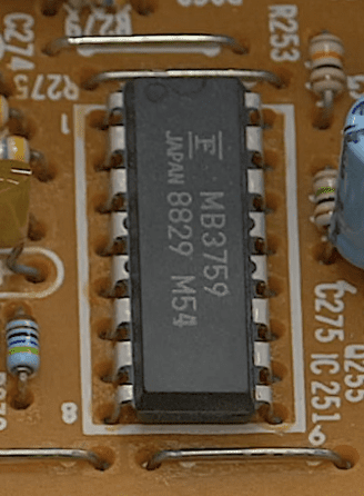

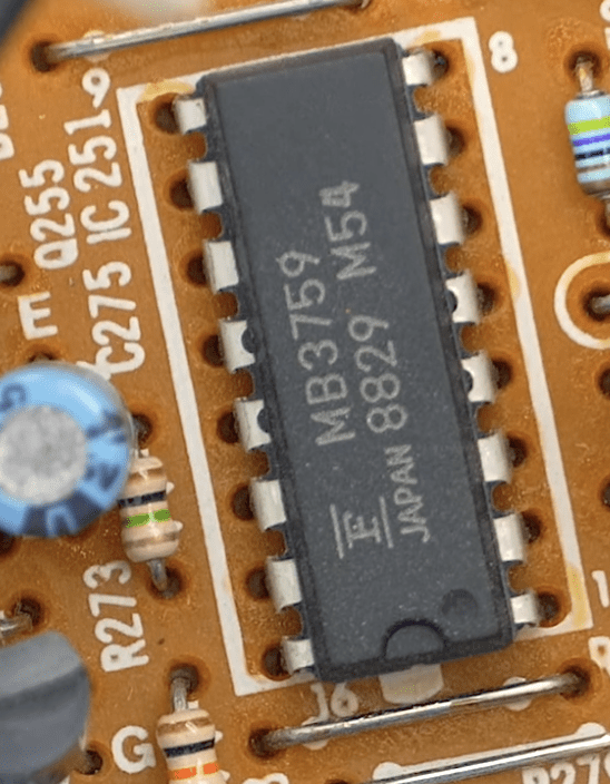

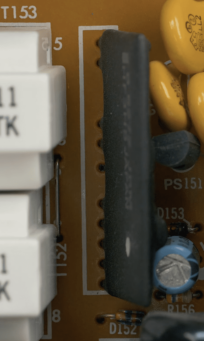

View attachment 24090 View attachment 24092
