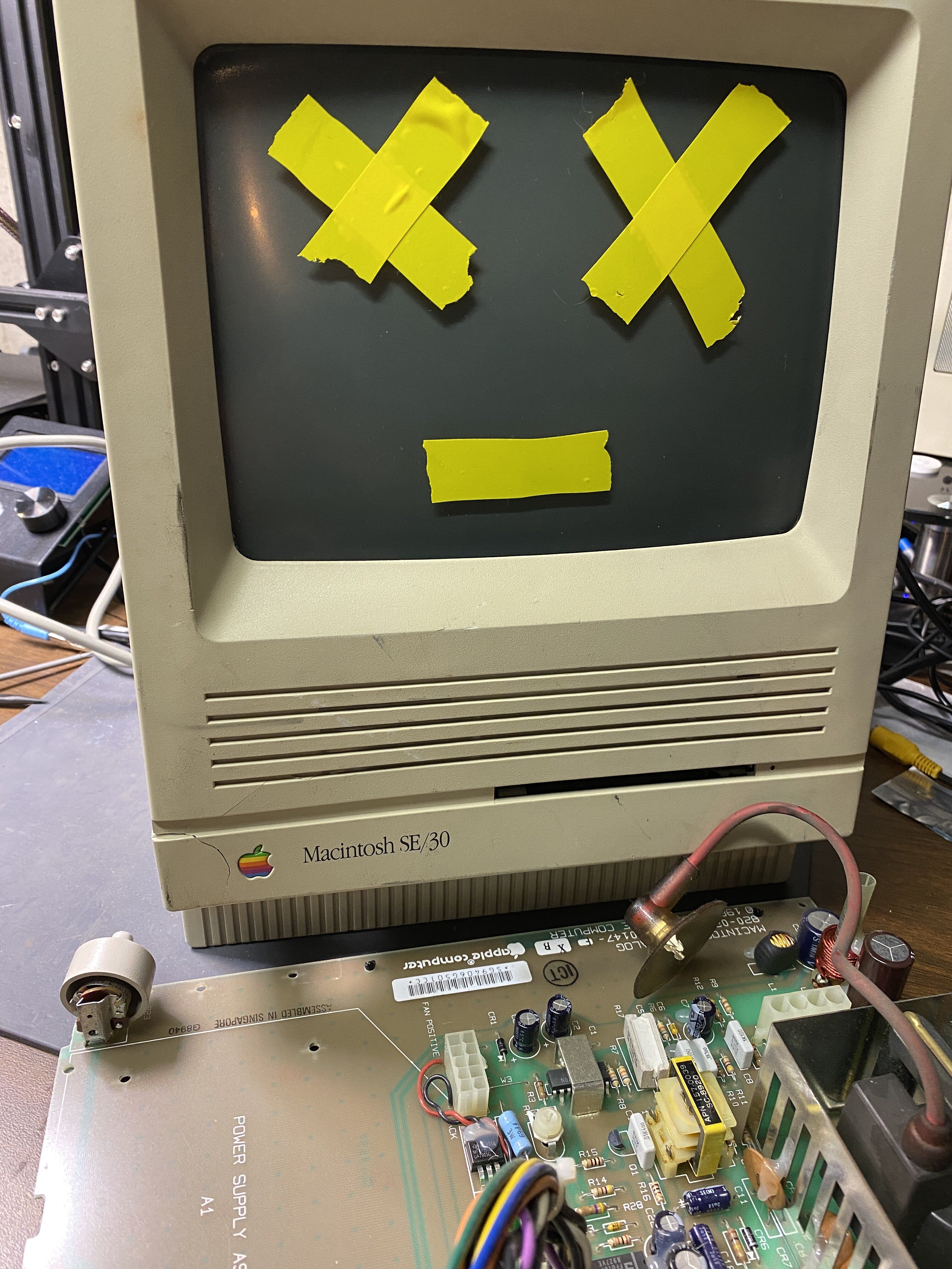

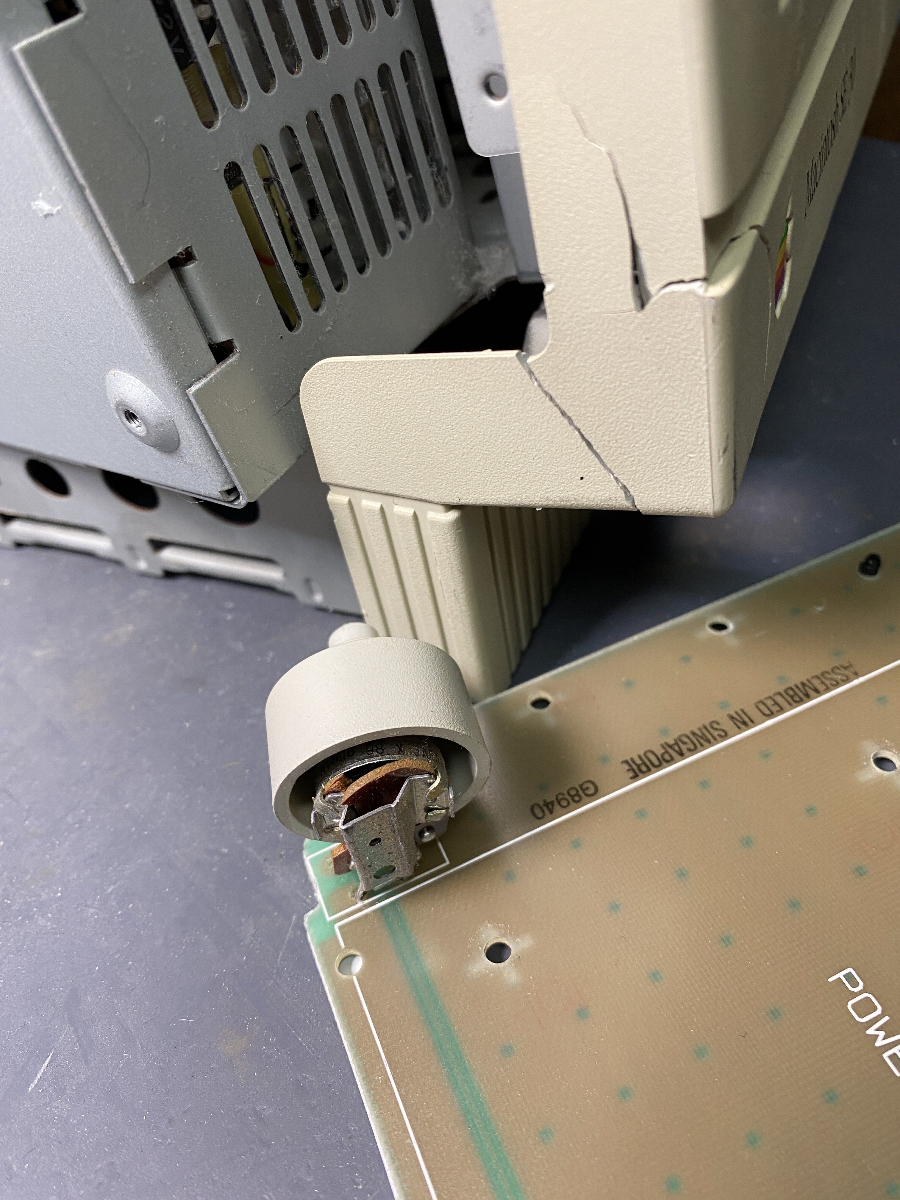

I’m trying to fix no video on this Macintosh SE/30 that looks like got dropped on its front left corner. The brightness pot is pretty smashed up and reads as an open circuit on my multimeter. Does anyone know if this is a common part that’s still available today, or if there are any substitutes?
Oh, and bonus pic of the screen describing its current state!

To kinda answer my own question, after measuring an un-smashed pot on another analog board, this Alpha potentiometer, part number 3RP/1612N-AA2-B1M seems to be the closest match. Of course, I can't find any place that actually stocks it.
I'm assuming I want linear taper, not audio taper for the brightness control. If audio taper, the suffix is -A1M.
I may try to find one with the same 18MM height from board to center of shaft, but without the extra support legs on the back. Since the front of the knob is supported by the Mac's case, it may not need such a beefy connection to the analog board.

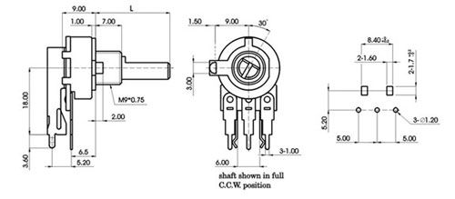

I've been unable to find an exact replacement so far. I've tried using this other Alpha pot: https://www.taydaelectronics.com/b-1m-ohm-linear-taper-potentiometer-spline-shaft-pc-mount.html
It has the right lead spacing and body size, but has a few downsides: the leads have to be bent straight and trimmed to match the original pot's height, and it has a spline shaft instead of a D shaft. I've filed the shaft down with a dremel and wrapped it with tape to get the right thickness, but it's not exactly centered so the knob wobbles when turning. The knob also doesn't push onto it all of the way without trimming some plastic from its interior, which I'm reluctant to do on increasingly rare parts.
