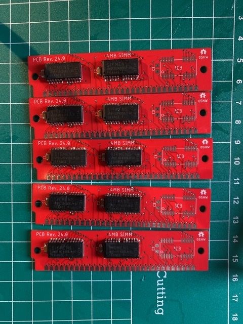

I made myself these 4MB SIMMs last weekend, pretty happy with the result, but now I have to redo it because I didn’t pay attention to the PCB thickness and the default 1.6 mm of JLCPCB is too much… so if anyone gets into this project better you don’t repeat my silly mistake and ensure you select 1.2 mm.
