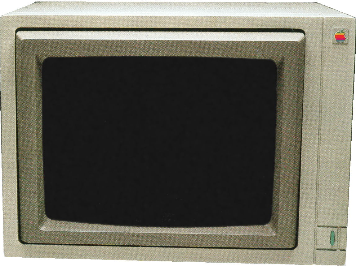

And can the AppleColor 100 monitor handle the output from the IIgs's RGB port?
It can with modification. :) Here is what I found at this link about the AppleColor Monitor 100 with the IIgs:
According to the Apple II Compatibility Guide (P/N A2F2204),​
the AppleColor Monitor 100 is not compatible with the Apple IIGS.​
For the many owners of the AppleColor Monitor 100 who are​
upgrading their IIe's to the Apple IIGS, but who wants to​
avoid having to purchase a new monitor, and there is a workaround.​
Inside the AppleColor Monitor 100 on the main PC board, almost​
directly under the neck of the CRT, there is a slide switch​
labeled "16 color/8 color".​
To make the AppleColor Monitor 100 work with the Apple IIGS,​
set the switch to the 8-color position, and use the cable​
provided with the Color Monitor 100 (svc part # 590-0194-A)​
to connect it to the Apple IIGS. This configuration makes​
all colors available.​
Apple Computer, Inc. takes no responsibility for any damages​
incurred, real or implied, that may result from this change.​
CAUTION! HIGH VOLTAGE! Be sure you know and follow safety procedures when working inside any CRT monitors or TVs!
