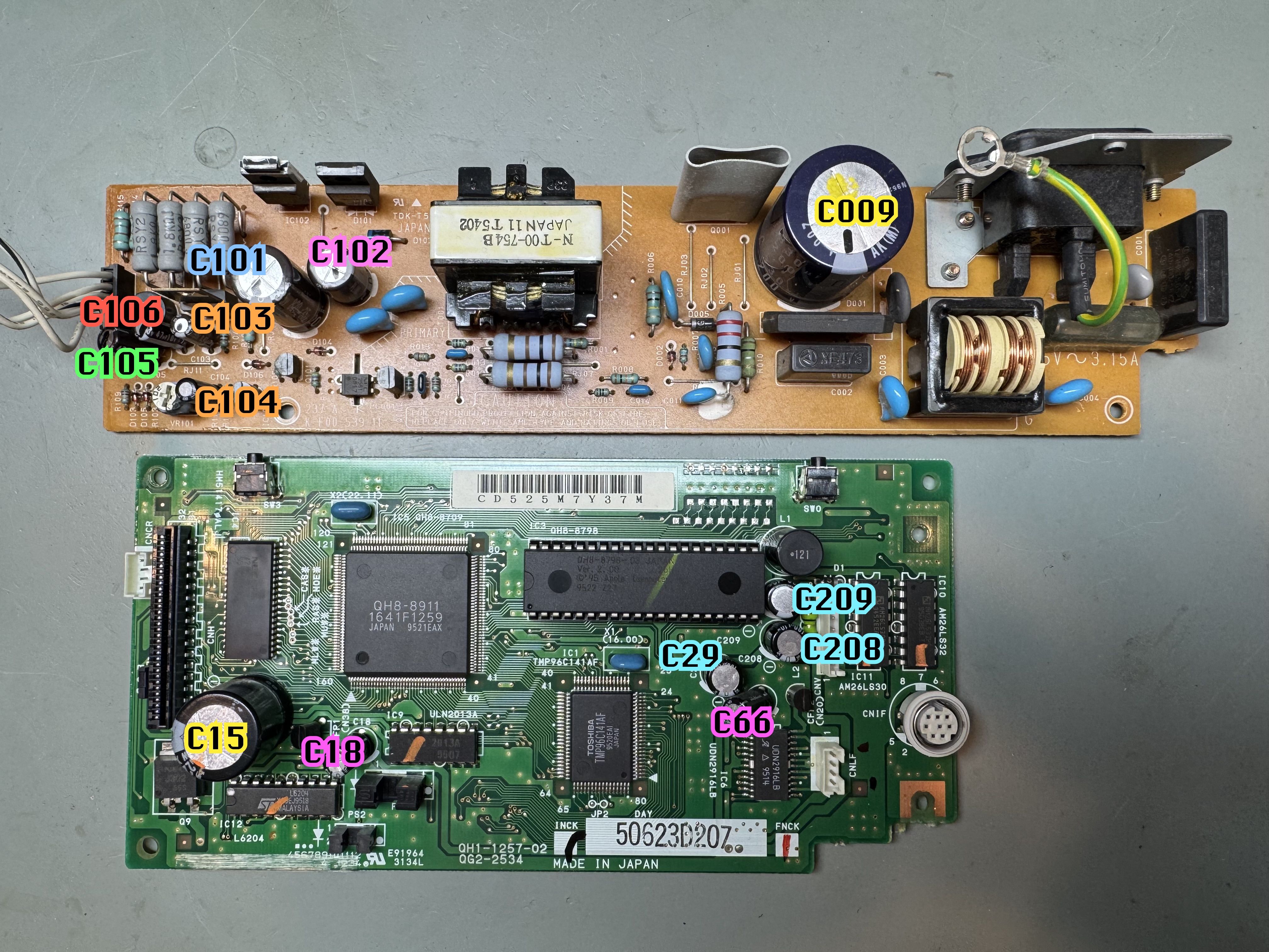

Since I don't think this is documented on the site yet, here's the list of caps for both the logic and power supply boards on the StyleWriter 2400 printer. In my case they were all fine, so I ended up not replacing anything, but good to have the reference if something fails in the future. All caps are radial through-hole aluminum electrolytic.
Logic Board​
LocationCapacitanceVoltageDiameter (approx.)Height (approx)
C152,200uF35V18.5mm21mm
C18, C66100uF35V6.5mm12mm
C29, C208, C209100uF10V8mm9mm
Power Supply Board​
C009330uF200V25mm30mm
C101820uF35V13mm25mm
C102470uF16V10mm16.5mm
C103, C1040.47uF50V5mm12mm
C10547uF35V6.5mm12mm
C1064.7uF10V5mm12mm
