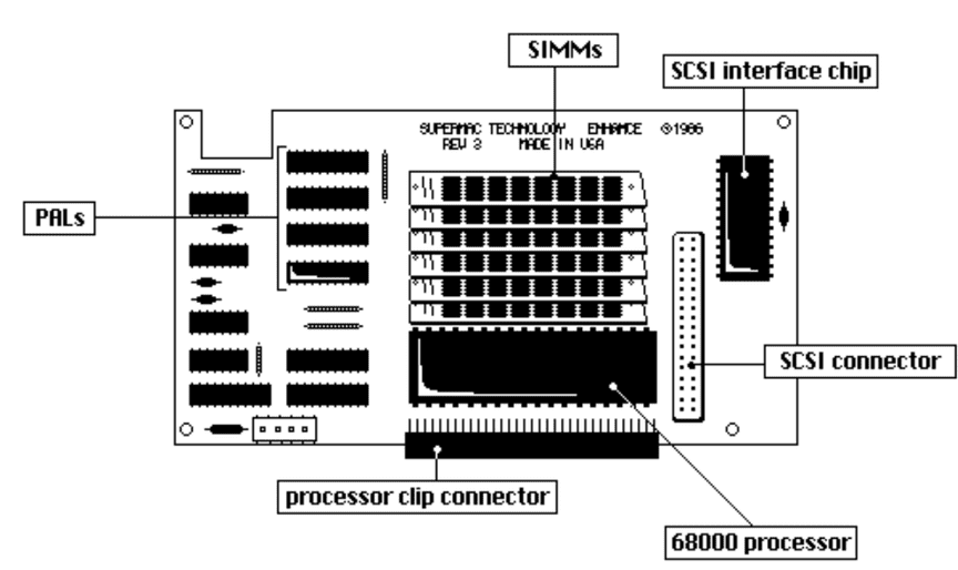

The Enhance board was a great upgrade product for the Macintosh 512Ke computer with the exception that the Killy/Chabin Clip that hooked to the Mac's 68000 had frequent failures. The later Chabin clip was a little better, but still had issues. The Enhance shipped with a special plastic tool for installing the clip. It was a plastic frame that folded over and hooked on to both long edges of the clip so that it could be evenly flexed into place. But, in practical terms, the clip had a very low insertion count and tended to fail when it was over-flexed at installation (or maybe when someone sneezed), resulting in poor spring force contact with the processor pins.
(The clips might still be findable on AliExpress - I would have to check the part number.)
With Enhance, if you happened to get a working clip and did a proper install (minimal flexing and install attempts) great! You might never have a problem. However, the only reliable way to connect the clip to the 68K was to solder it to the pins (and that solution remains true today in a retro context). In the '80s and '90s, some people needed multiple replacement clips (which may have been because of over-flexing the clip on initial install -- hard to say). After SuperMac was acquired by Radius, if you called in with an Enhance clip problem, you just returned your old Machine/Enhance and they sent you a MacPlus for free! The users loved that solution (even though it was technically slower than an 512Ke wiith an Enhance board).
Anyway, as above, by default, Enhance adds 1.5Mb of RAM (6 x 256K SIMMs -- for a total of 2Mb) and a SCSI port to the Mac 512. It also has an on-board 68000 that let it run about 30% faster than a MacPlus. The reason for the speed-up was that the main motherboard 68000 CPU could manage the screen buffer while the Enhance 68000 managed application accesses to its expansion RAM. So, a Mac512+Enhance had an advantage over a single processor MacPlus that had to alternately manage screen updates and other RAM accesses. Also, I will have to check, but I think the Enhance 68000 runs at 12Mhz vs. 8Mhz on the Mac 512Ke.

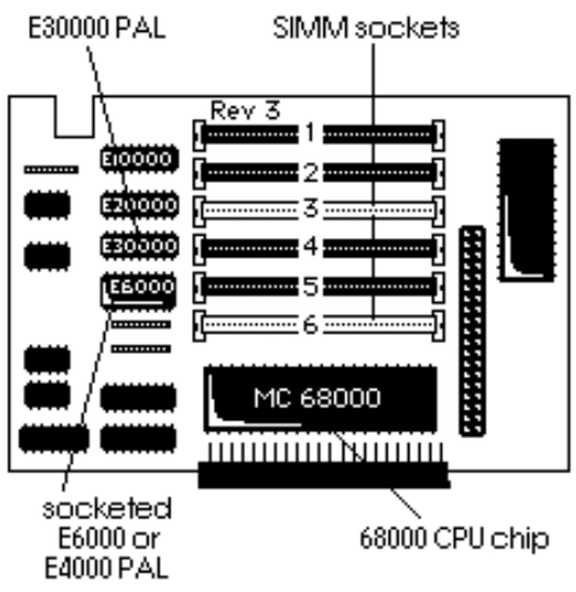

Enhance could also use 1MB SIMMs for a total of 4Mb on board (plus the 512K on the Mac). However, in order for this expanded config to work, the board had to be a Rev 3 board and needed a PAL upgrade. The PAL upgrade part number was E6000 (E4000 was installed with 1.5Mb on board). So, if you find a Rev 3 Enhance board that has an E6000 PAL installed, that is a great find! It means that it can be upgraded to the max config. If it has an E4000 PAL, then it is stuck at the lower 1.5Mb RAM config. See the picture below.
Also, with a Rev 3, E6000 board, the 4 1Mb SIMMs had to be installed in sockets 1, 2, 4 and 5 (dark sockets indicated below), skipping sockets 3 and 6.
When users wanted to upgrade beyond 1.5Mb and had an old rev board, SuperMac would exchange the board for Rev 3 with an E6000 PAL installed. Otherwise, if they had a Rev 3 board with an E4000 PAL, SuperMac would simply send out a replacement E6000 PAL.

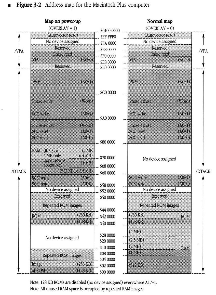

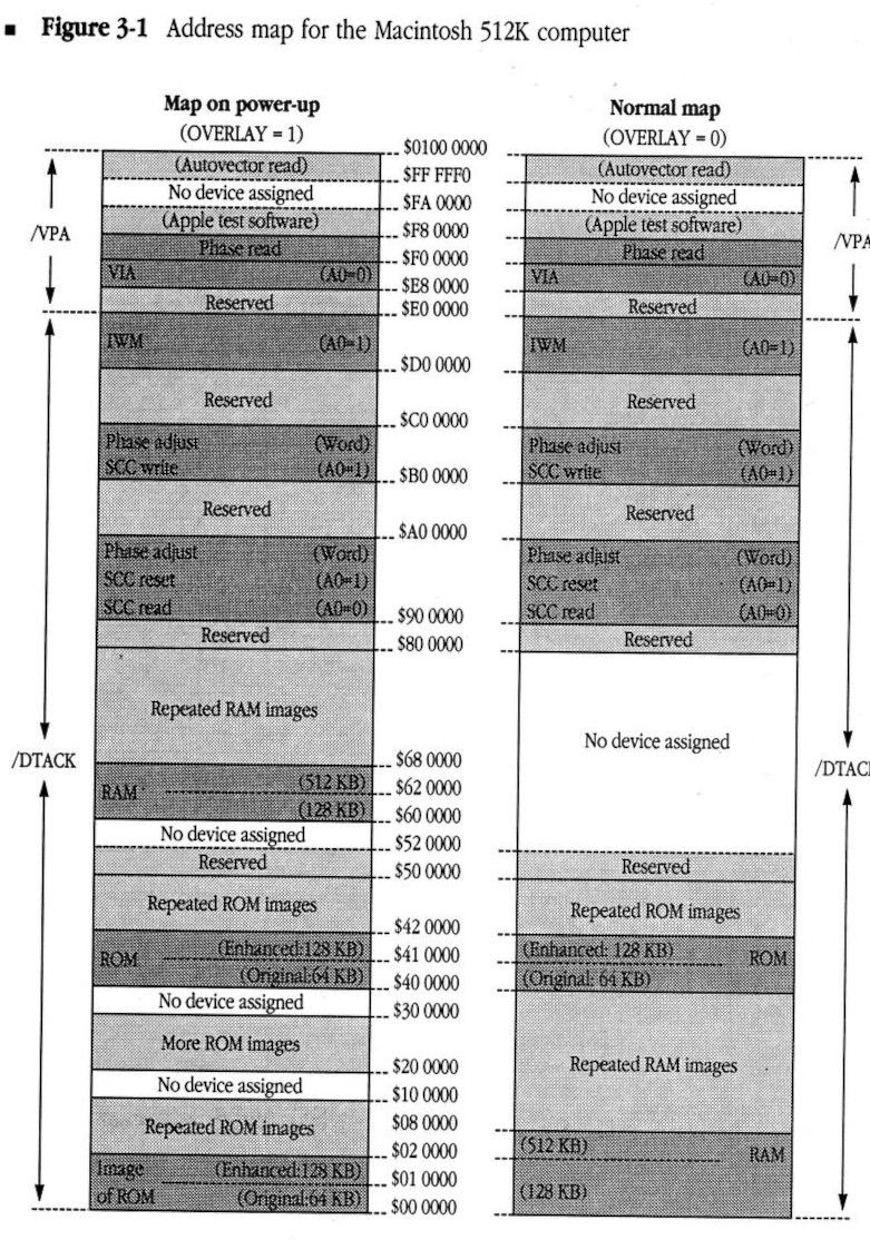

It's been so long since I looked at this I completely forgot how it was set up. I just remembered that there was only a 4MB block set aside for RAM. I wonder how they're using that extra 512K? Here's the address map of the 512K and Plus from Guide to the Macintosh Family Hardware:
Reactions: BFEXTU
I generally agree. The original Enhance specs may have been in place before anyone realized that the address space was capped at 4Mb (or maybe there some other software trick in mind to do some extended mapping - that rings a bell, now that I think of it). I have to find my boards and fix up my 512K machine. I have dual 400K MFS drives and it is vintage 1984-85, so it must have 64K ROMs. The 512Ke was not until 1986.
I will have to recap it and burn some MacPlus ROMs to install as an upgrade. If I can find my E6000 Rev 3 Enhance, I can test it at 6Mb, but I really don't think it will work, but maybe I can create a map hack - I don't know if it's physically possible. The more I think about it, the more I am remembering a discussion about a software hack, but the Mac market was changing quickly and SuperMac killed all the memory expansion products in 1988-89 when it was clear that Graphics and Storage were king. SuperMac rebranded itself as a "High-End Graphics Subsystem Company." So, memory products like Enhance for the discontinued 512Ke platform didn't warrant any further resources, except in terms of the promised "Lifetime Warranty" support issue (which is why they gave away free MacPlus computers as replacements for failed 68000 Killy/Chabin clips).
