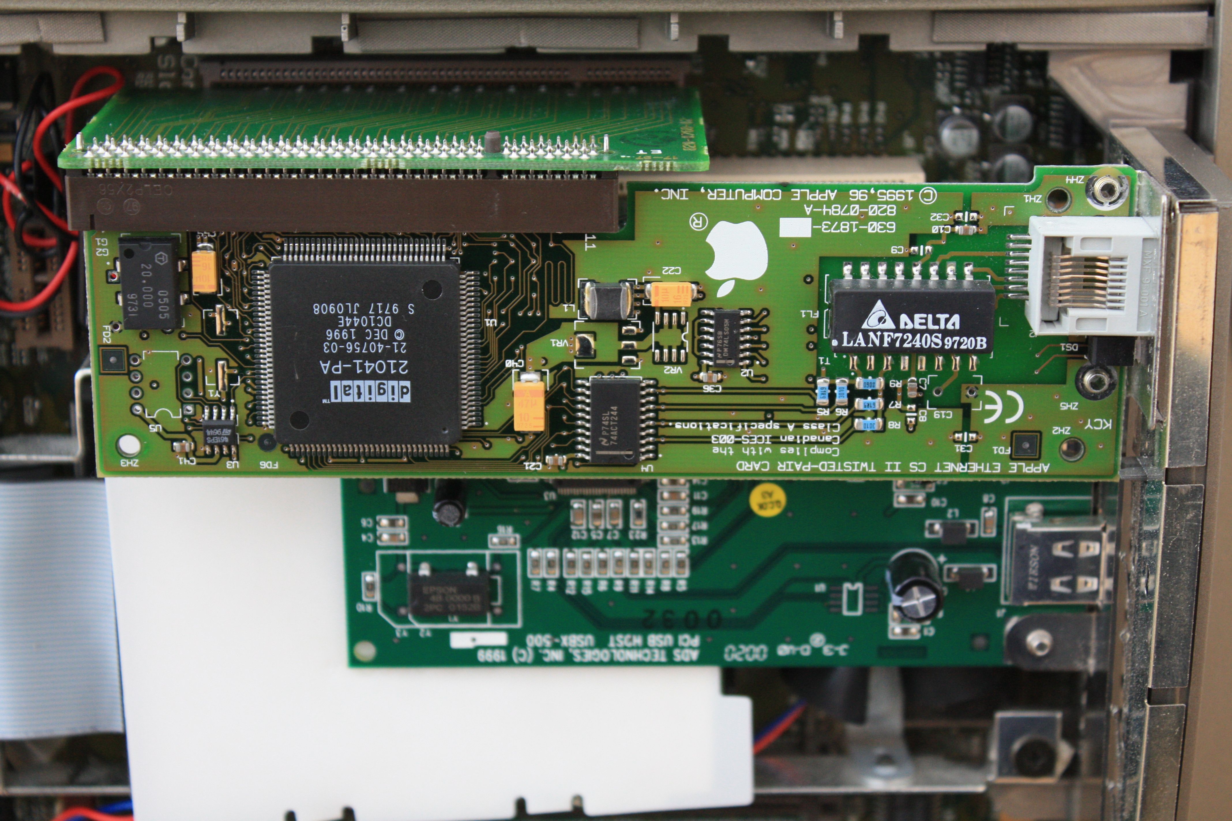

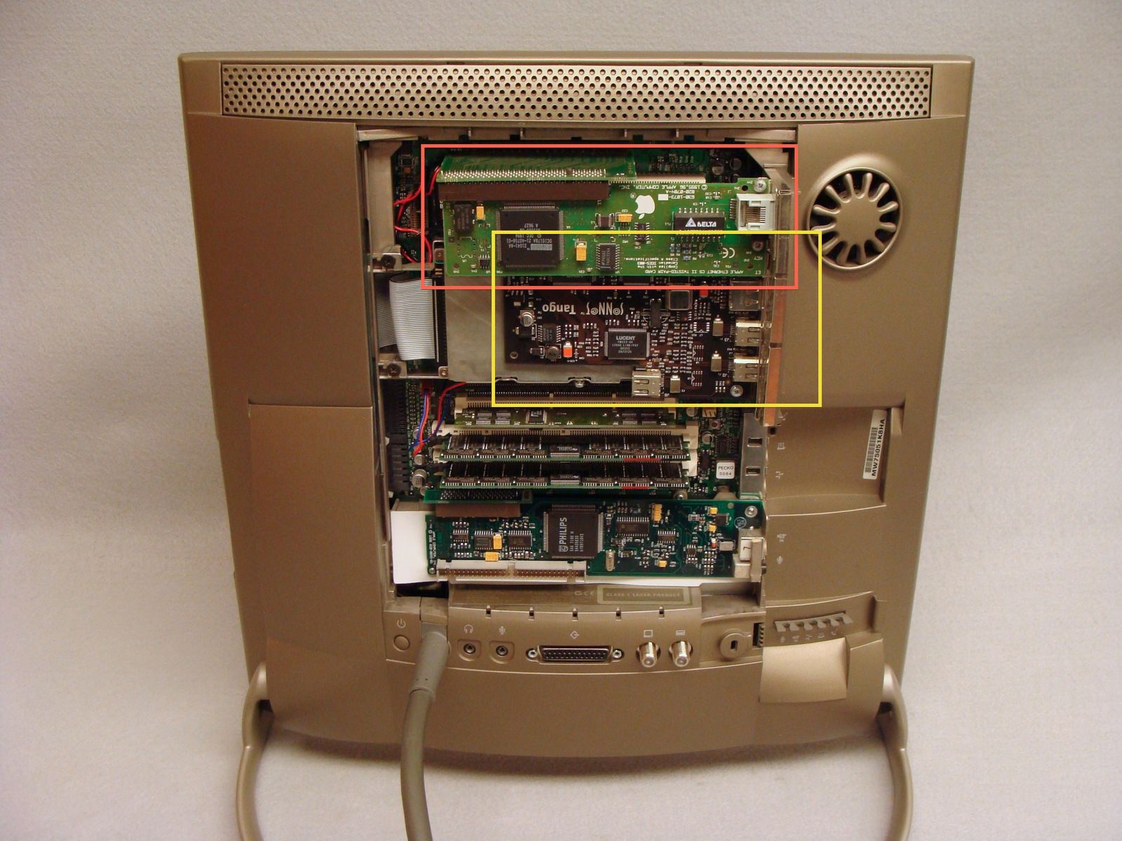

I've identified available cubic in the TAM for boosting its anemic power budget in the upper right hand corner of the red box:
edit: found a far better pic of available cubic:

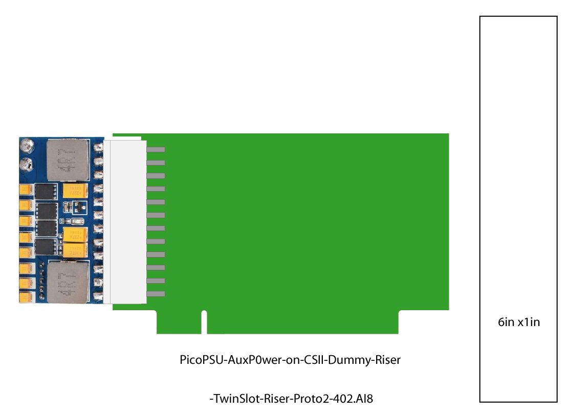

A PicoPSU will fit nicely mounted vertically to edge of the ComSlot2 standard riser with hot glue or socketed on a custom repro riser.

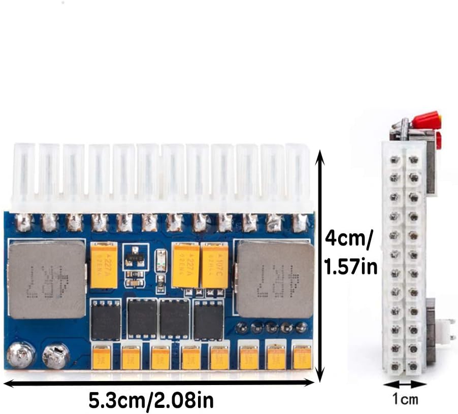

PicoPSU in 90W range seem expensive ($100+-) while 150W units seem to be very inexpensive in comparison.
Cooling in a TAM will be the sticky point, don't have one, but tinkering with a FauxProtoMac counterpart.

Some 14 years ago I was looking into 6500 and Beige G3 ATX conversions. Going for an ersatz TAM/FatBack form factor build now that will be powered entirely by the 250w PicoPSU pictured above.

For nearer term project I only need to power the TwinSlot adapter to allow use of a power hungry pair of PCI cards in the TAM. That'll be done on the Dummy CSII riser pictured above. That project will eventually include connections to implement the (ofttimes missing?) standard TAM riser as a bonus feature.
