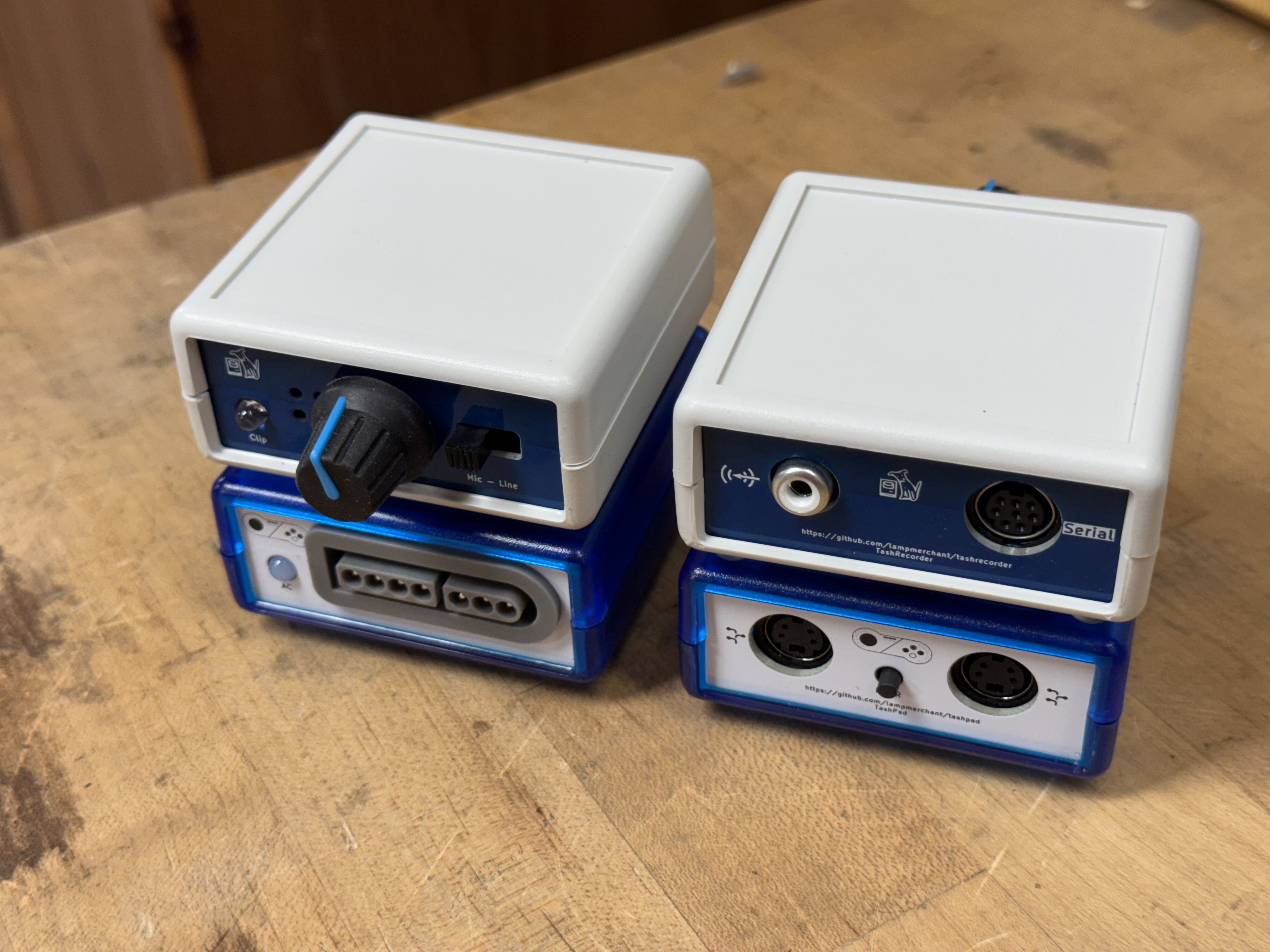

During the group buy, a lot of people were interested for a color closer to our old gear (white/beige/light gray), here is what it looks like
Activity LED is orange-ish like the Mac II era HDD ones, whereas on the blue one LED collar is sea-ish blue
