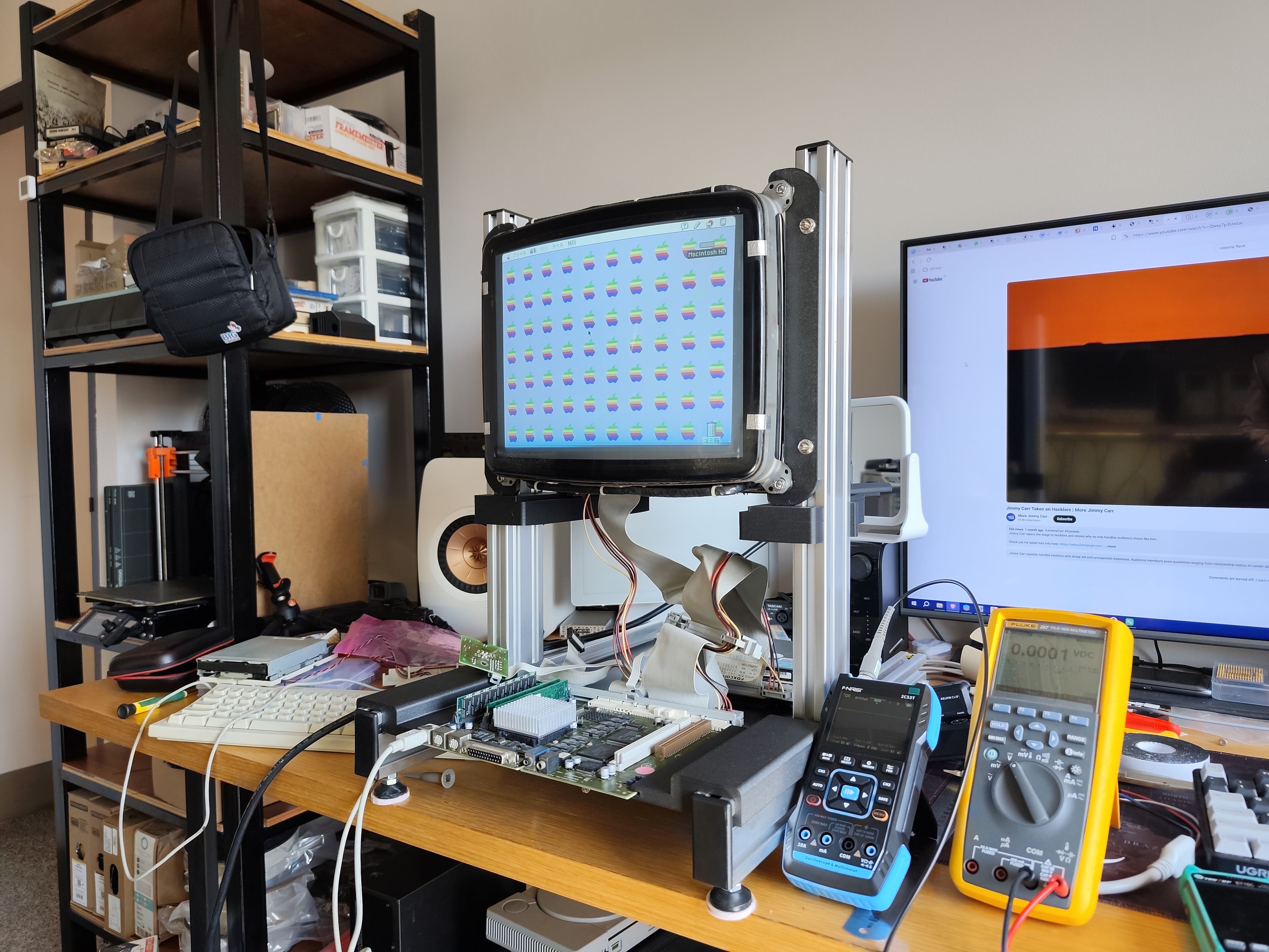

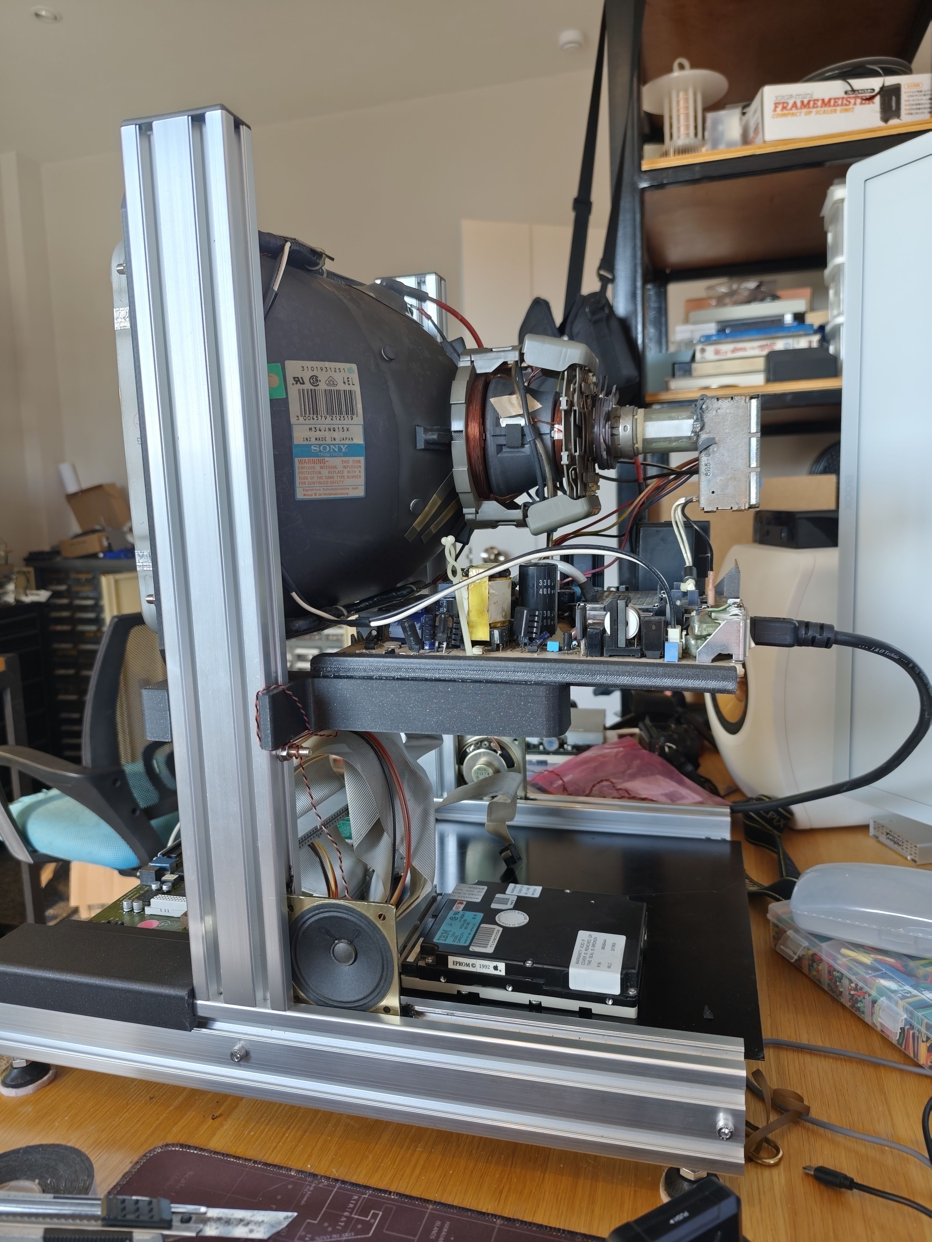

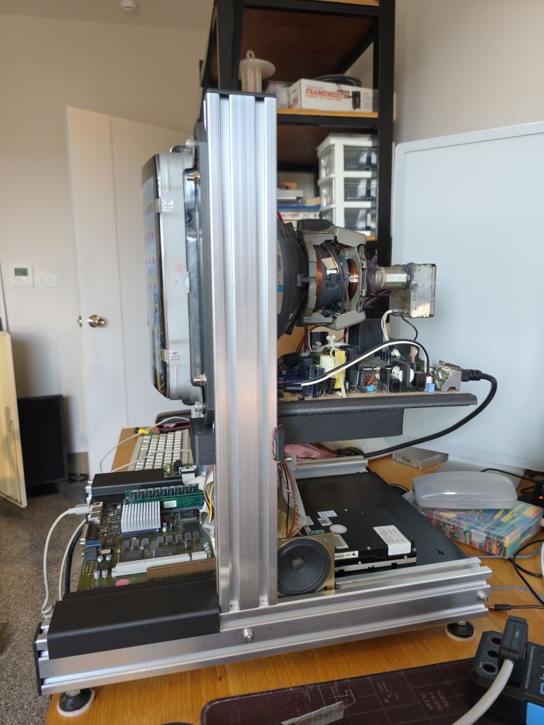

Hi there Tinkerers, thought i'd share something i worked on for a while.
Since i started servicing classic mac's, and especially colour classic machines, I've always been annoyed that it is so hard to measure anything in-situ, while powered on.
So when i got a LC575 in with plastics that had the integrity of biscuits, snapping when you think of touching it, and a motherboard nuked with battery acid I thought, this could well become a test stand.
I still had 2 aluminium extrusion "legs" and i decided to design and 3D print all the needed pieces to mount the CRT, analog board and motherboard.
The result is a test rack allowing me to measure while running the computer both the analog and motherboard are accessible for measurements, saving me time in repairs.
if anyone wants the 3D files, just say the word and ill upload them

Hi! Very cool, please share the details and models.
That will save so much time and annoyance for a problematic compact Mac. Thank you for sharing.
Haha, well honestly i am looking for a power meter that i can add, to keep an eye on power consumption. I suggest that to anyone fixing these things, its really handy to know what's going on, power consumption tells you if its in STBY, running well, or over-consuming due to a fault, a few watts difference and you know something is up. at power up it will take about 250-300W to degauss, don't let that scare you. Idle is about 12W (!!) a running CC will take around 55W if you have a Bluescsi, more if you have a HDD, should not exceed 65W.
Hi!
Can you share some details about the project?
I sure can, so i had a LC575 computer, damaged in shipment due to very brittle plastics. I could not repair it, so i decided to make a test stand with standard aluminium extrusion profiles, and 3D printed plastic parts to fit everything together. i can share those parts with you of course!
Extrusions used: 60X30mm profile, 4 pieces all 480mm long, 4 90 degree brackets, 6 end plates (plastic parts to close the extrusion off) and 4 feet. the printed parts are same for left and right side. if you need more photo's just let me know
