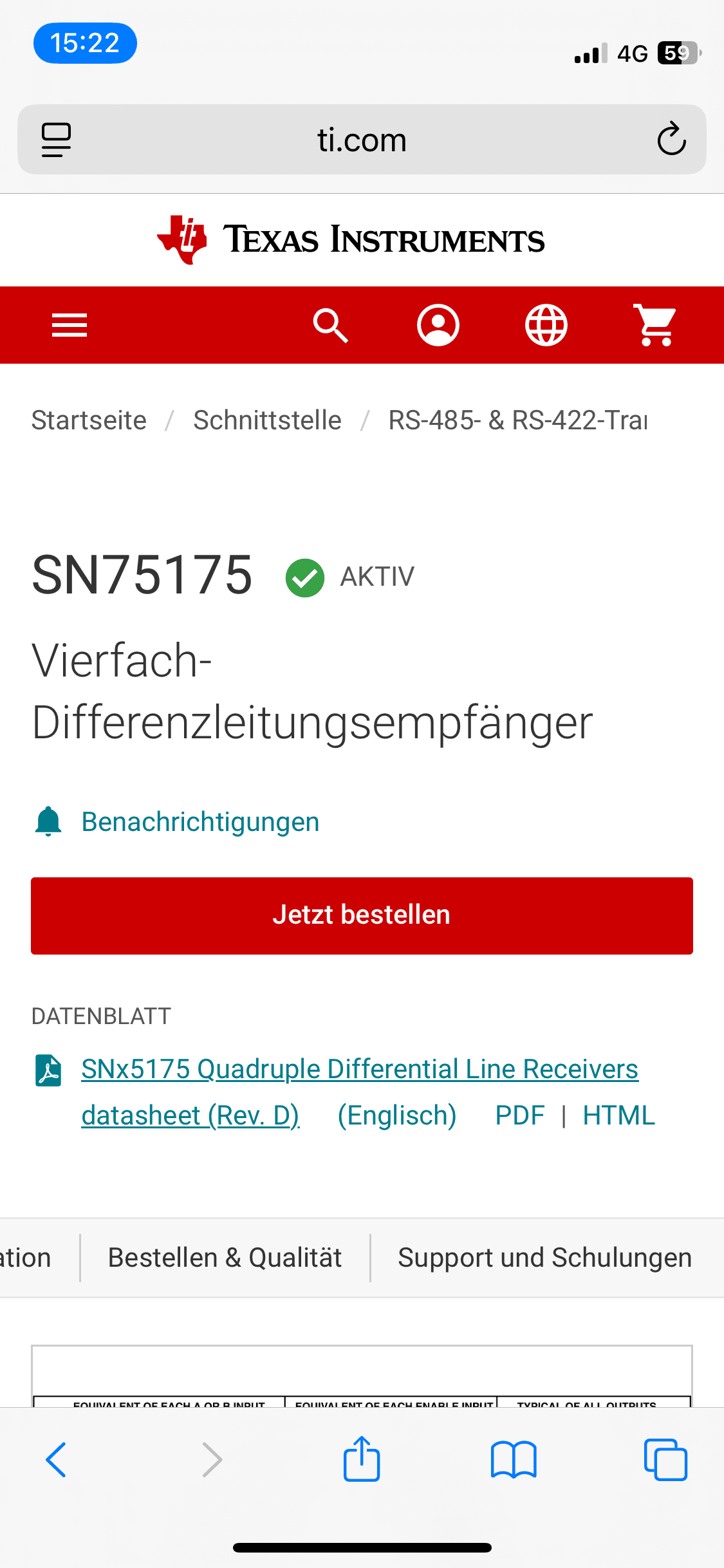

Can you quote any source? TI still lists the 75175 as active…
