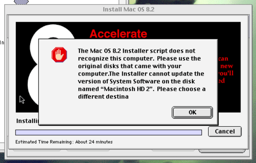

Mounting the image in BasiliskII and attempting the install resulted in a failure as it doesn't recognise which model machine I'm running. FYI - I'm emulating a Quadra 900 with a 60040 CPU. As 8.5 was PPC only, this would make sense.

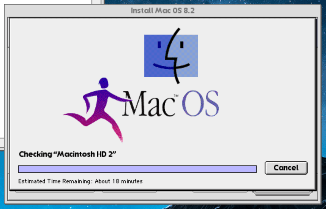

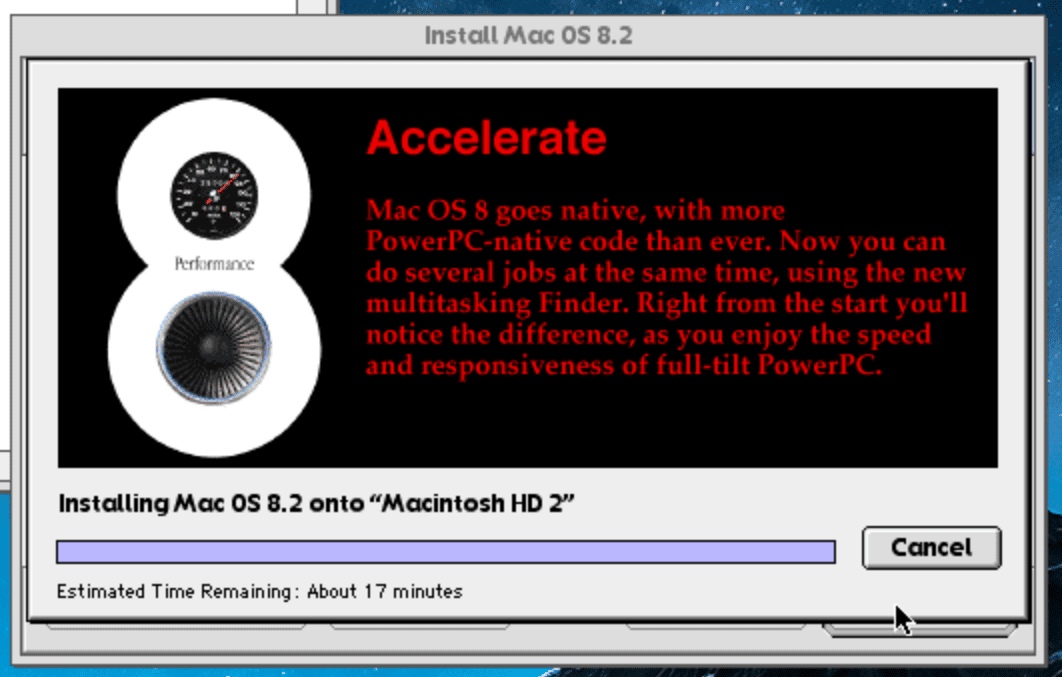

This time I was a little more successful in actually installing the OS onto a spare hard disk image. The first attempt failed as under the installer options, there's a tick box to update the Apple hard disk driver but it couldn't find disk copy. No worries, untick this option to start the installer going.

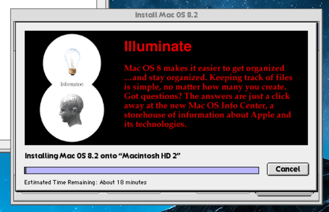

I've never seen this install before, so figured I'd share the screenshots of what's shown during install. First is the installer starting.

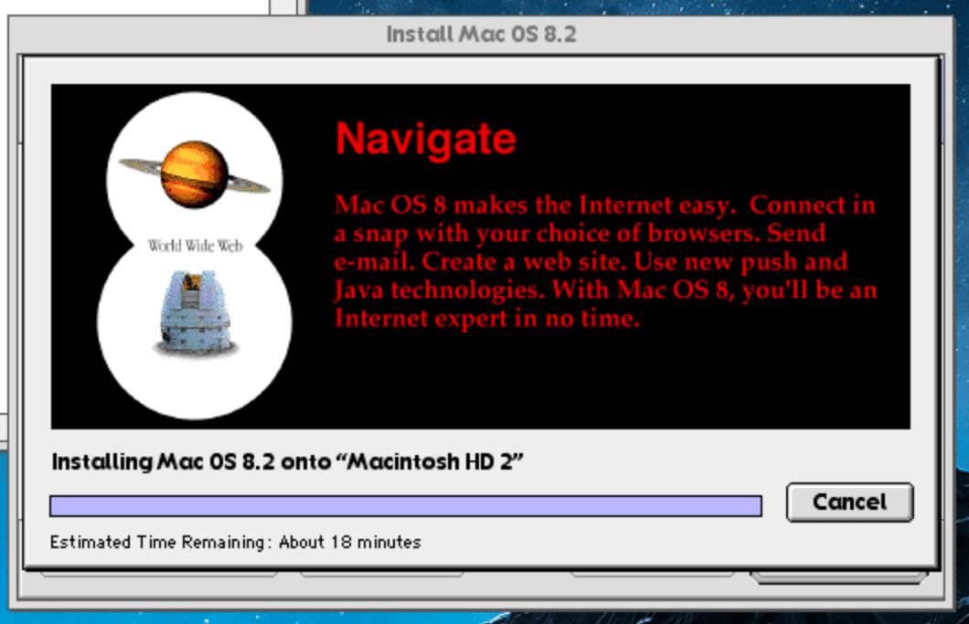

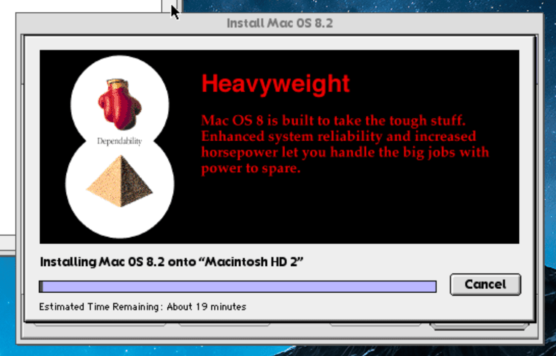

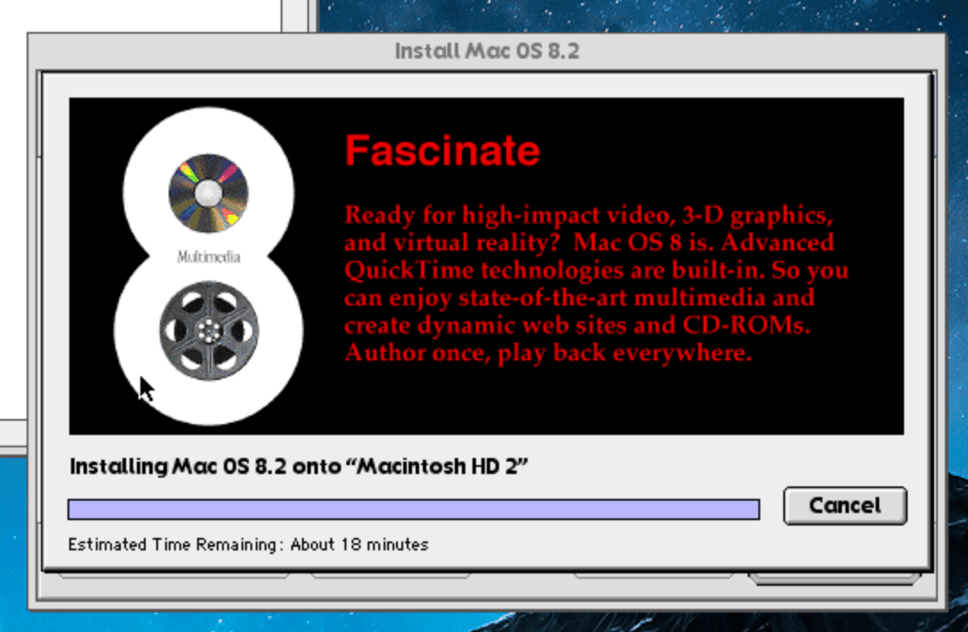

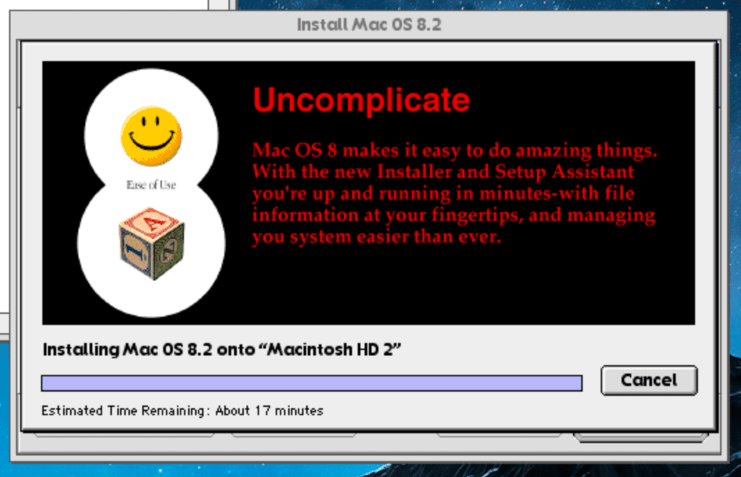

Here are the other images - notably they all seem to rhyme with Mac OS 8....

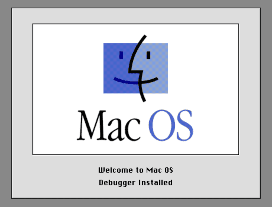

I customised my SheepShaver VM and changed the boot order. Unfortunately SheepShaver crashes immediately. I fiddled with the options for ignoring illegal memory accesses and enabled the JIT compiler, which have helped before in the past, and the next time I launched SheepShaver I at least got the Mac OS boot splash screen. However SheepShaver promptly quit. Reopening just goes into a loop. You get the splash screen, it crashes, reopen it, splash screen, crash etc.

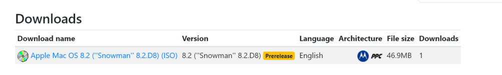

I had seen some indication from WinWorld PC (where I got the ISO), that it was indeed 68k compatible. I was excited at this, as rare/leaked betas of old OSs are intriguing
WinWorld indicated that this was 68k compatible, via my screenshot..... However as we know, it is most definitely not. When you mouse over the Motorola logo, it says 68k
Liars!

So, to test this once and for all, I just created a blank disk image, did the same things, and tried to install into that... Sadly this did not work, even with the above tricks, it kept telling me that this system was not recognised or something to that effect
So really, I am now unsure if this error is actually because this is only PPC as we previously thought, or this particular copy is 68k but this system is not on the list of machines that are allowed. Probably the first one
