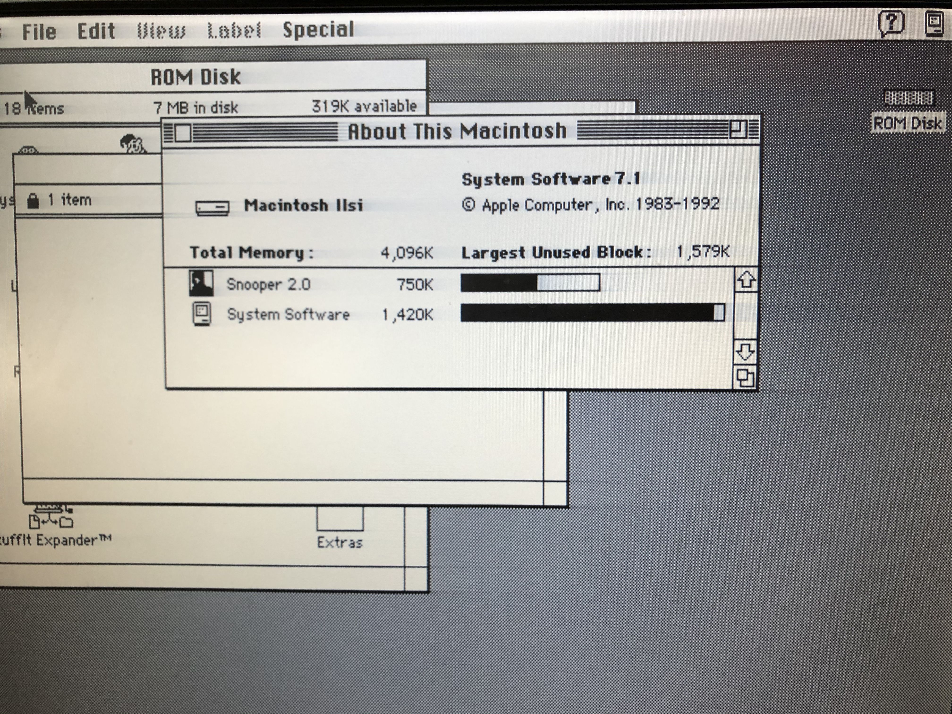

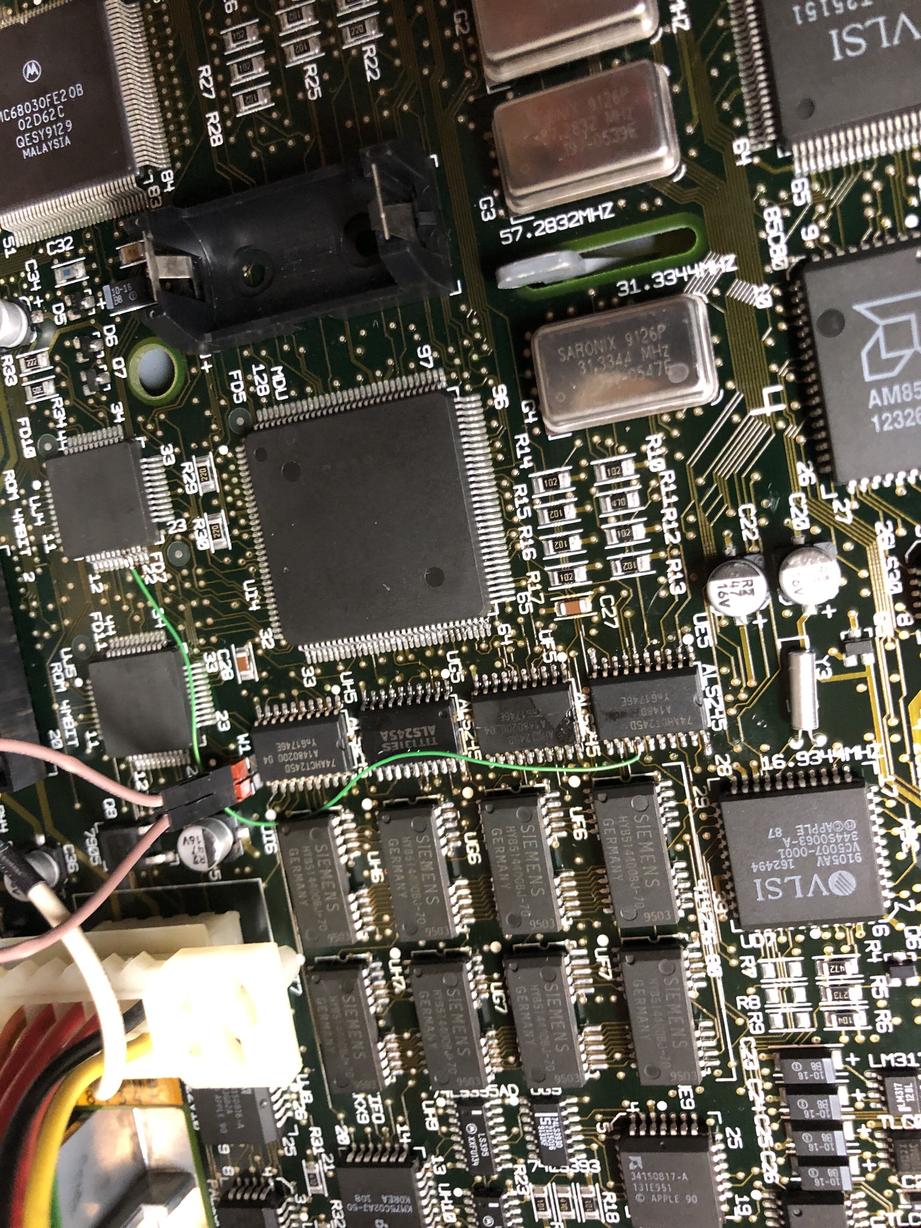

The Mac IIsi motherboard is wired for a 1 MB onboard RAM array using eight 256kx4 DRAM chips or a 4 MB RAM array using eight 1Mx4 chips. After discovering this on my broken IIsi, I was able to simply replace the eight RAM chips with larger 1Mx4 RAMs (e.g. KM44C1000, M5M44400, MT4C4001) and get 4 MB of onboard RAM. No bodge wires required--the extra address pin used on the larger RAM chips was wired in the motherboard, evidently in anticipation of a possible 4 MB model.

There are four things that come to mind when shopping for that kind of part:
1) Is the shop reputable. IOW, will you get the part that is listed.
2) Is it the correct part number. In this case, yes, it is.
3)* Is the part in the correct package. The part is actually the tiny silicon wafer die at the center of the big component with legs, but that die can be put in several different shapes and sizes of package with different arrangements of electrical leads (legs). In this case, the part is in the wrong package. The IIsi needs an SOJ package (leads curled underneath, a bit like a bug) and the listed part is for a TSOP II package (leads stick out from the side of the package.
4) Other specification. In this case the speed rating of the part. The speed is listed as 60 ns ( -6 in the part number) and so is plenty fast for the IIsi.
* Sometimes two different packages will fit in the same place. For example, if the spacing of the leads/legs is the same, and they stick out the same distance and land (reach down to the circuit board) in the same locations, then even though the packages are different, they could be interchangeable. It is possible, depending on geometry, that those TSOP II packages might fit into the SOJ space, but I do not know. The link to the part leads to a datasheet for the part. Check to see if there are mechanical drawings (drawings with dimensions) for the respective chip packages in the datasheet.
