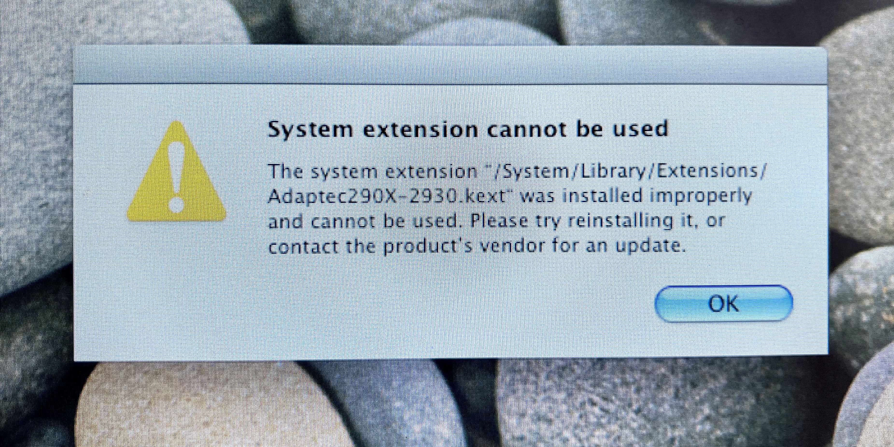

I knew Leopard may be pushing things, but I figured I'd try. Without drivers the "PCI Cards" section of the Apple System Profiler showed that no driver was installed for the SCSI Card. So I downloaded the v1.1 (Feb 2002) driver and attempted to install it, but the installation failed. I tried to be smart and install the driver manually, but that resulted in a lovely error upon startup.

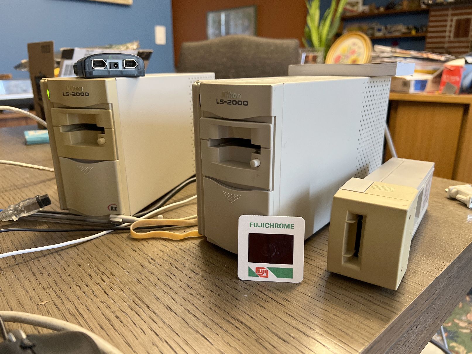

The Nikon LS-2000 isn't the fastest scanner, but the quality is well worth any time spent scanning in film at 2700 dpi. One of the scanners I bought online came with a "bonus" SCSI to FireWire adapter... and what a bonus that was! :love: So I'm able to use the scanner (with VueScan) on my MacBook Pro while using another on my G4 to tackle on larger scan jobs. Sadly the SF-200 batch slide loader attachment goes for $500+ on eBay, so this will have to do for now.

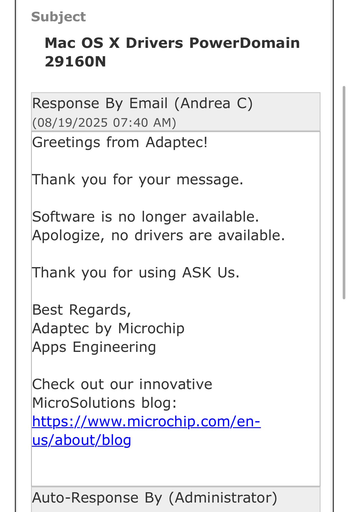

Does anyone have a copy of the Mac OS X drivers for the 299160N SCSI to share?
The file is: apd29160x_X_v12a.hqx.
The downloads for it on Adaptec's site are all dead :( and support would not provide it.
I also tried the Wayback Machine, but I couldn't get a download either.

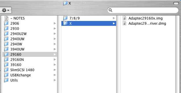

This may help, @Ron's Computer Videos did a great video and journey of archiving a lot of Adaptec drivers, including the 29160, you can check it out here: https://macintoshgarden.org/apps/adaptec-powerdomain-scsi-card-firmware
It looks like it may have something similar to what you need.
Note: TheUnarchiver didn't like to unpack the .sit file on my particular system, but it unpacked fine on my G4 Mac with StuffIt Expander 8.x.
Thank you so much for responding!! This looks promising. I'll try it now.
