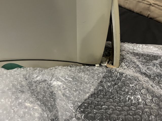

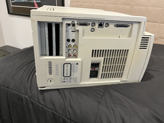

tl;dr USPS did their best to destroy the excellent condition G3 Minitower I bought on eBay, including, I think, actually dropping it at least once (the box clearly exploded open, and the power cord it was shipped with did not arrive. I've already gotten a refund via the shipper's insurance (they were just as upset as I was). I was crushed to see this. Aside from yellowing plastic, it was in amazing condition; it even has the Whisper A/V card.
I don't have a wait to prove it, but I'm 90 percent certain based on the tracking/package movement that it was maimed once it got to my local distribution center.

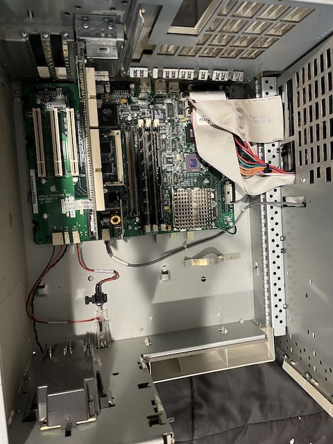

Almost all the damage appears external, except that the little metal retaining band that goes over the CPU heatsink popped off and somehow got bent at an almost 45 degree angle. I'm concerned that it rattled around and may have damaged the board somehow.

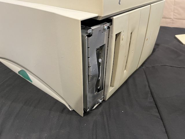

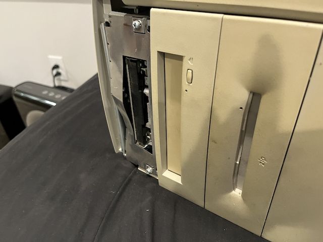

  4. The metal plate thing on the front of the floppy drive is trashed. Are there replacements for these?

Might be best to keep your eyes peeled for another case. With respect to the retaining clip, you might be able to rebend it and get it attached to the ZIF socket again. If not, leave the computer on its side, so the board is at the bottom, then try to boot it that way. Use the correct version of MacTest Pro to test the computer out. The RFI shield for the floppy should be pretty easy to find, since it's also used on the 8600 and 9600 machines.

The metal on the floppy drive looks like it could be bent back easily enough - and I think it's just shielding - could be left off if you cant get it bent back. Unfortunately no replacements unless you find NOS covers for it, which is unlikely.
Unfortunately the only way to really know is to visually inspect as much as you can, and then, power it up (IMO).
Yes a standard IEC power should be fine.
Also remember there are OTHER things that can be bad - eg bad ram/etc - so if it doesnt boot the first time, don't fret and try all the normal debugging stuff as well.

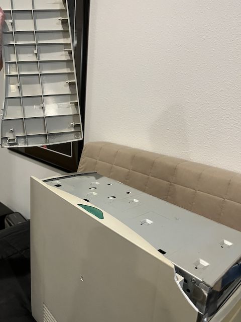

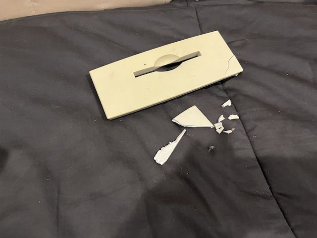

If you can glue the floppy drive plastics back together and the back case plastics and display it in a way that minimizes seeing those - I still think it can be quite a good looking machine!
Good luck, many times these machines are more resilient than you think! (unless you get a color classic, then if you look at it funny it'll break!)
I don't think that this computer is beyond repair yet. I would take a really good look at the logic board and inspect it for gouges and cracks, but it looks fine in the pictures. The shattered plastic pieces of the computer case can probably be glued back together with some effort. I also think that if you are careful, it should be possible to bend the metal heatsink clip and CD shield back into their original forms (maybe using some pliers wrapped in a towel?)
For just testing the computer to see if it still boots, as long as the heatsink is touching the CPU and held down by gravity somehow, I wouldn't worry. You might also be able to secure the heatsink using zip ties if the bracket cannot be recovered.

Unfortunately, I think the broken plastic got thrown away. That's okay. The only thing I'd really want to get replaced--assuming everything else works--is the floppy cover.
What's the purpose of the RFI shielding on the floppy drive? Or, put another way, what's the risk of leaving it off?
So far, all I've found is someone selling a replacement for the 9500, which looks considerably different.
I agree this looks repairable to me. In addition to supergluing the bits together, a couple layers of epoxy on the interior seam of the glued crack will help to keep them secure. This has always worked well for me on repairs where the plastic will not see any flexing ie: side panels, face plates etc. Best of luck on your repair.
