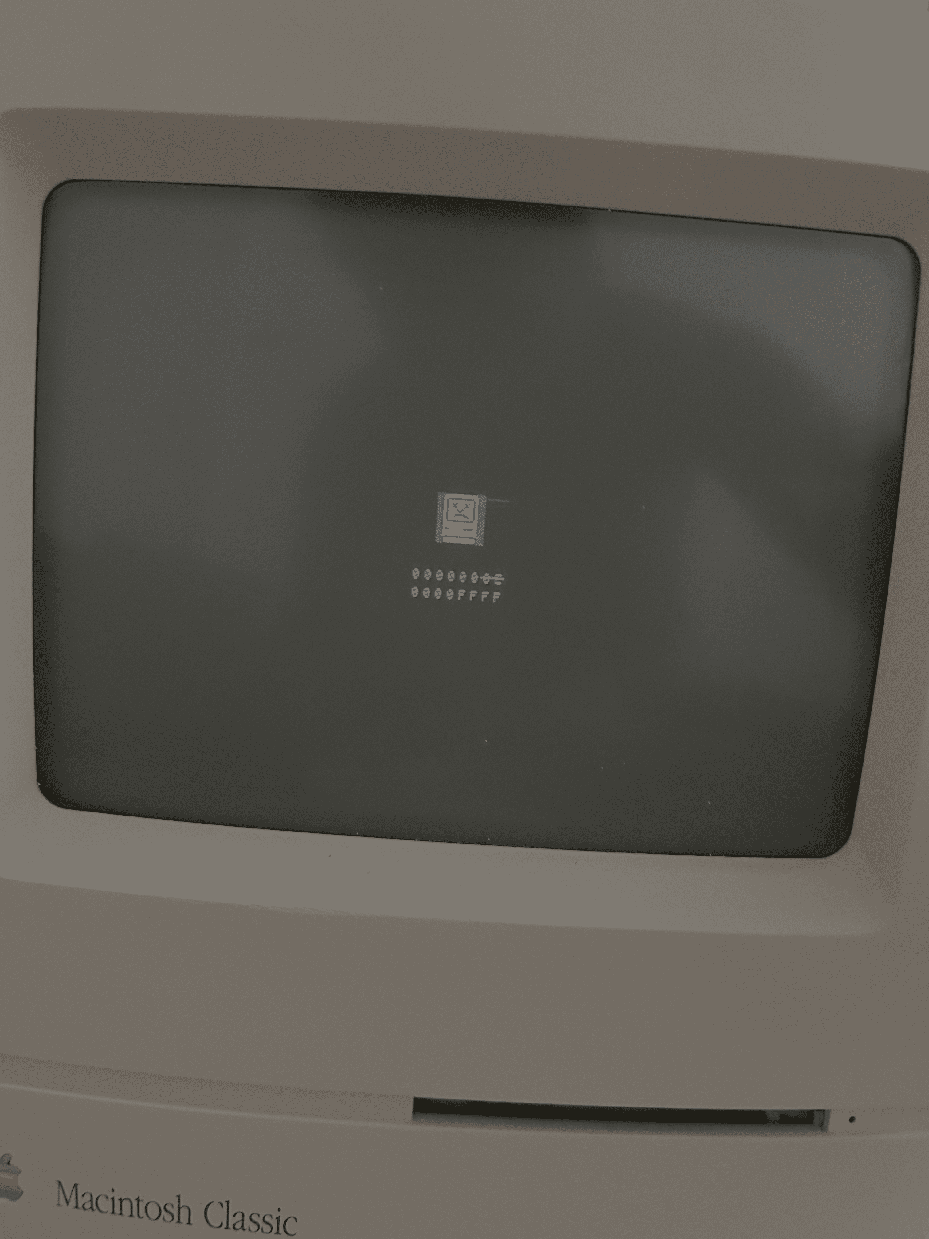

I am trying to revive a Macintosh Classic (my first time doing this!). When I got the system, the screen didn't turn on when powered on. I took the system apart, gave the analog and logic boards a good cleaning, purchased and installed the capacitors on both boards. After that, the screen turned on and I got to the sad mac icon.
Research on this error code seemed to point to capacitor electrolyte residue still possibly on the logic board, specially under chips. So I took it apart once more to give it another round of cleaning. I was a bit more aggressive this time. In the process, two chips came off: UA5 and UH6 . Both chips were in bad shape. Their pins were rusted and some of the pins on UH6 simply broke off when i tried to gently scrape off the rust that was shorting the pins. Furthermore, the some of the pads on the UH6 and UA5 chip regions had also lifted, so I couldn't just solder them back on.

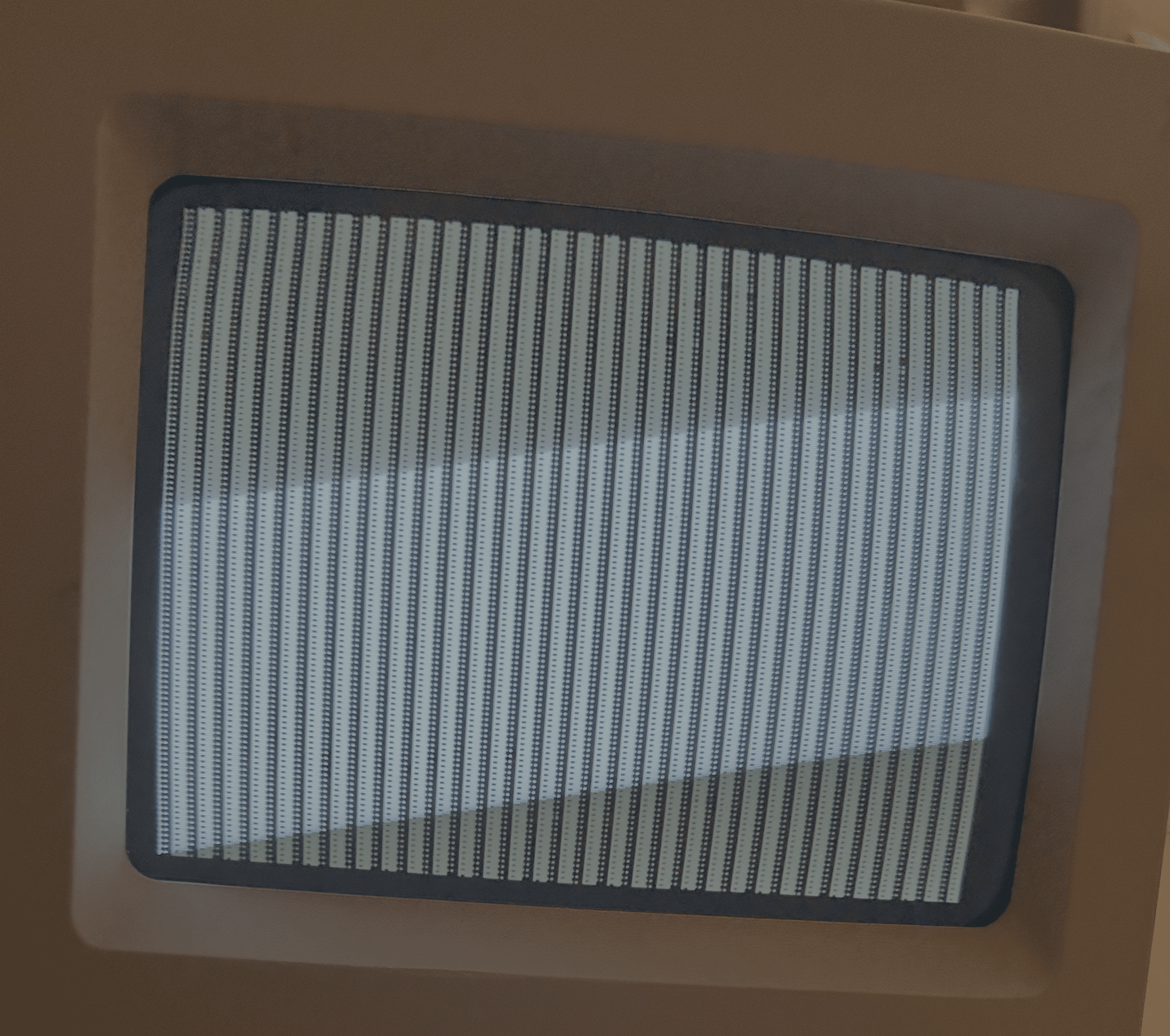

I booted the system with both chips off, and got this vertical stripes screen:

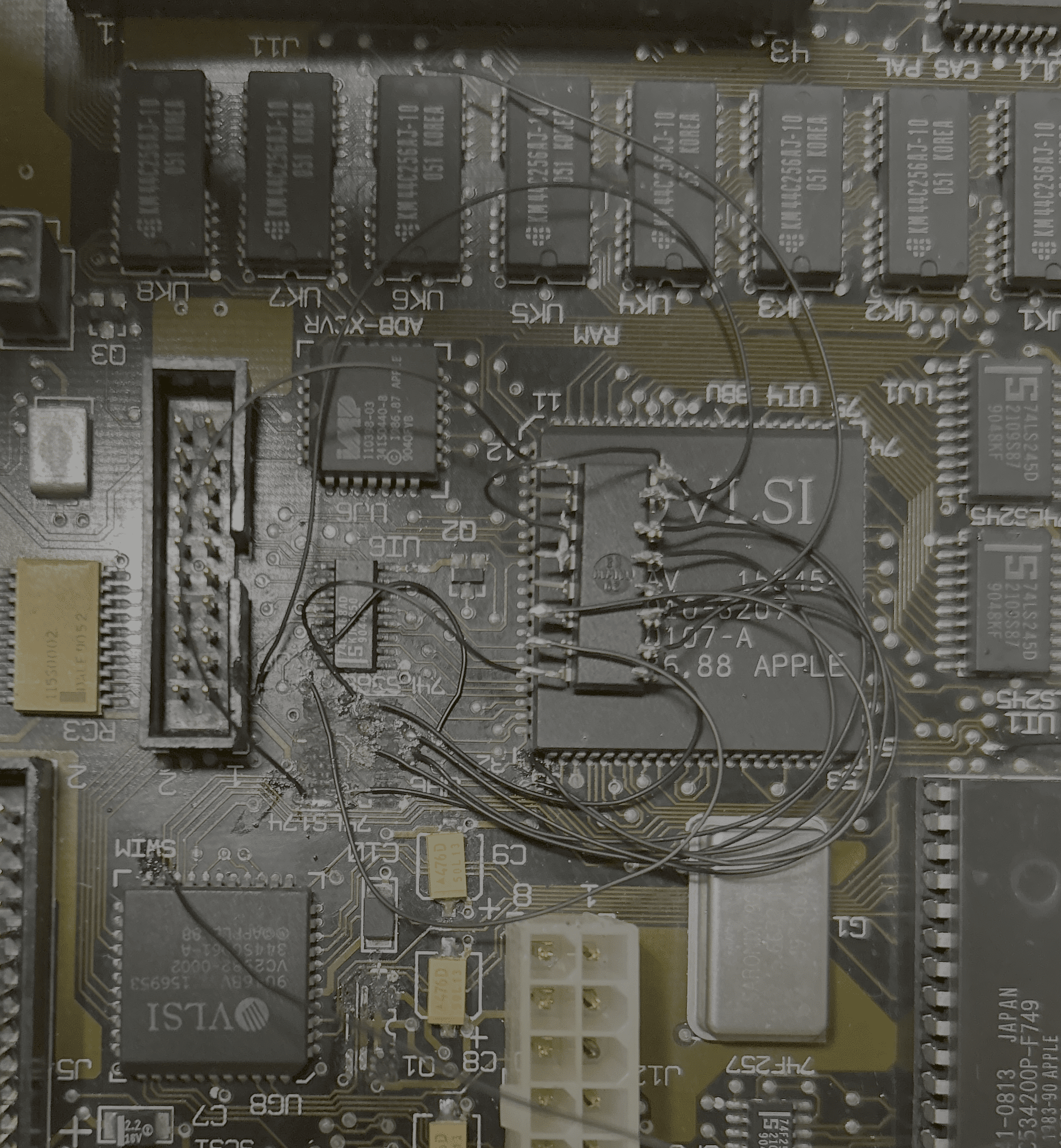

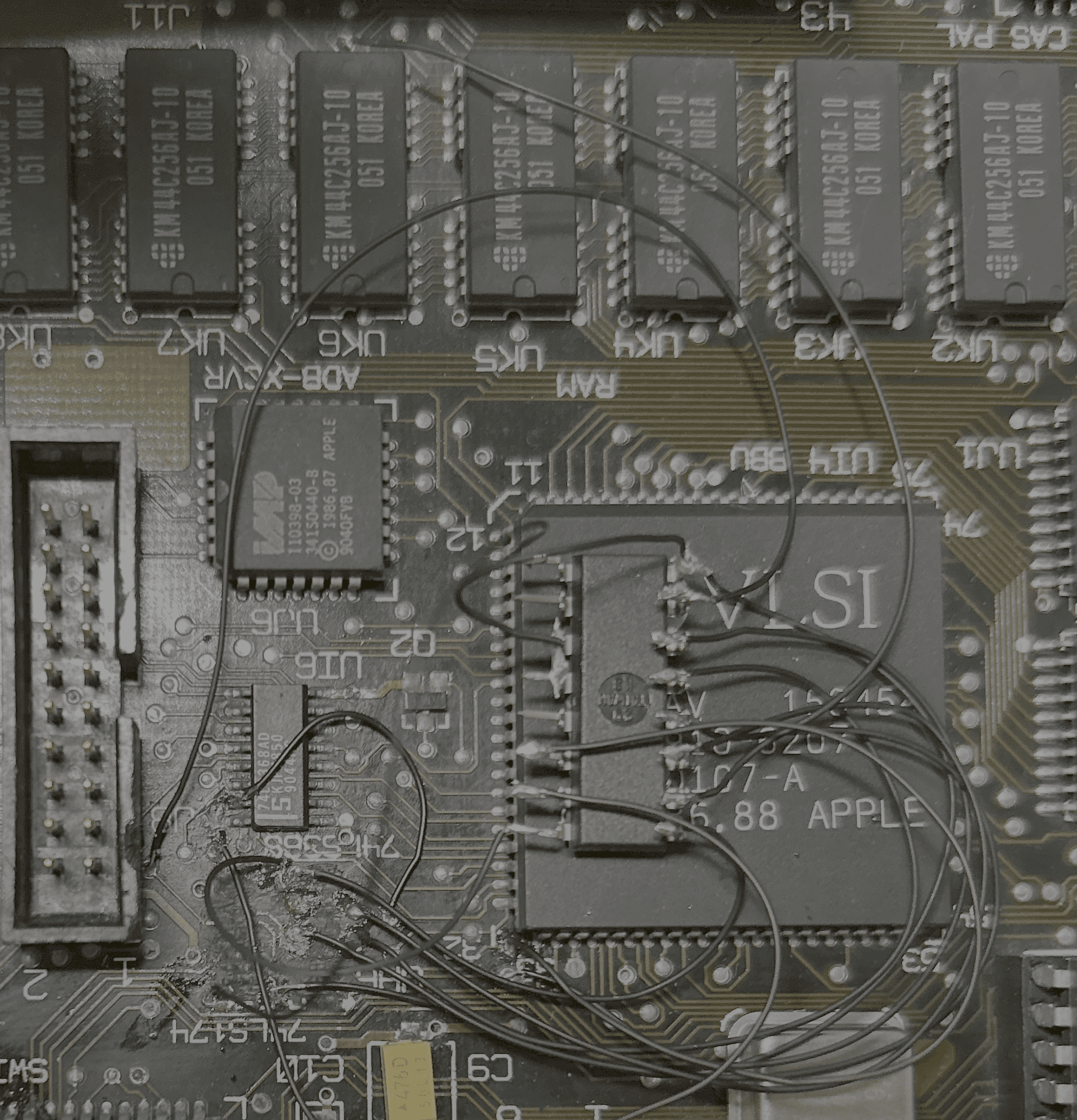

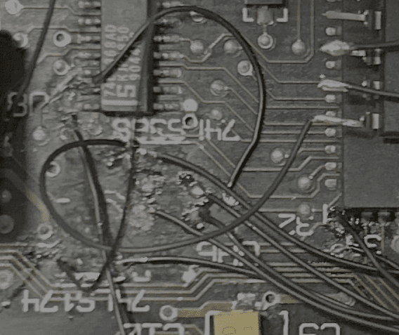

UH6 however seems to be an important memory control chip. So I ordered a replacement 74LS174 and tried to deadbug it onto the board (pictures attached).
I double checked the routing, did continuity tests, etc and everything APPEARS to be in the right place. I also fixed a couple of traces that got cut in the process. Booting after this work didn't change the picture much. Still the same vertical stripes.
After that I did a bunch of probing. Log of some checks and probes below, but working theory at this point is that the CPU is executing and doing bus cycles. The failure seems to be some write cycle not making it through, where /AS stays low and /DTACK is not asserted. Any hints would be appreciated!
