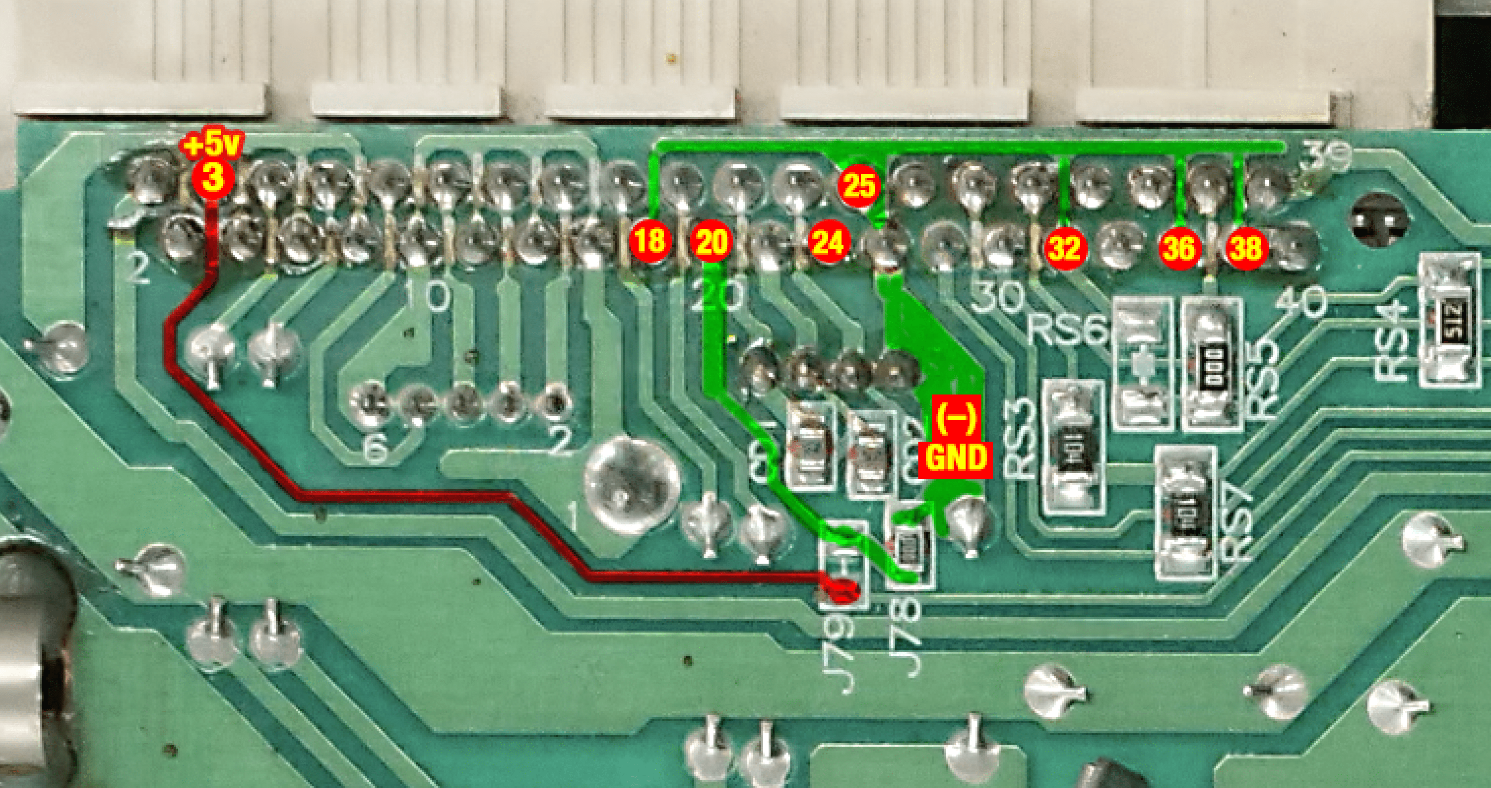

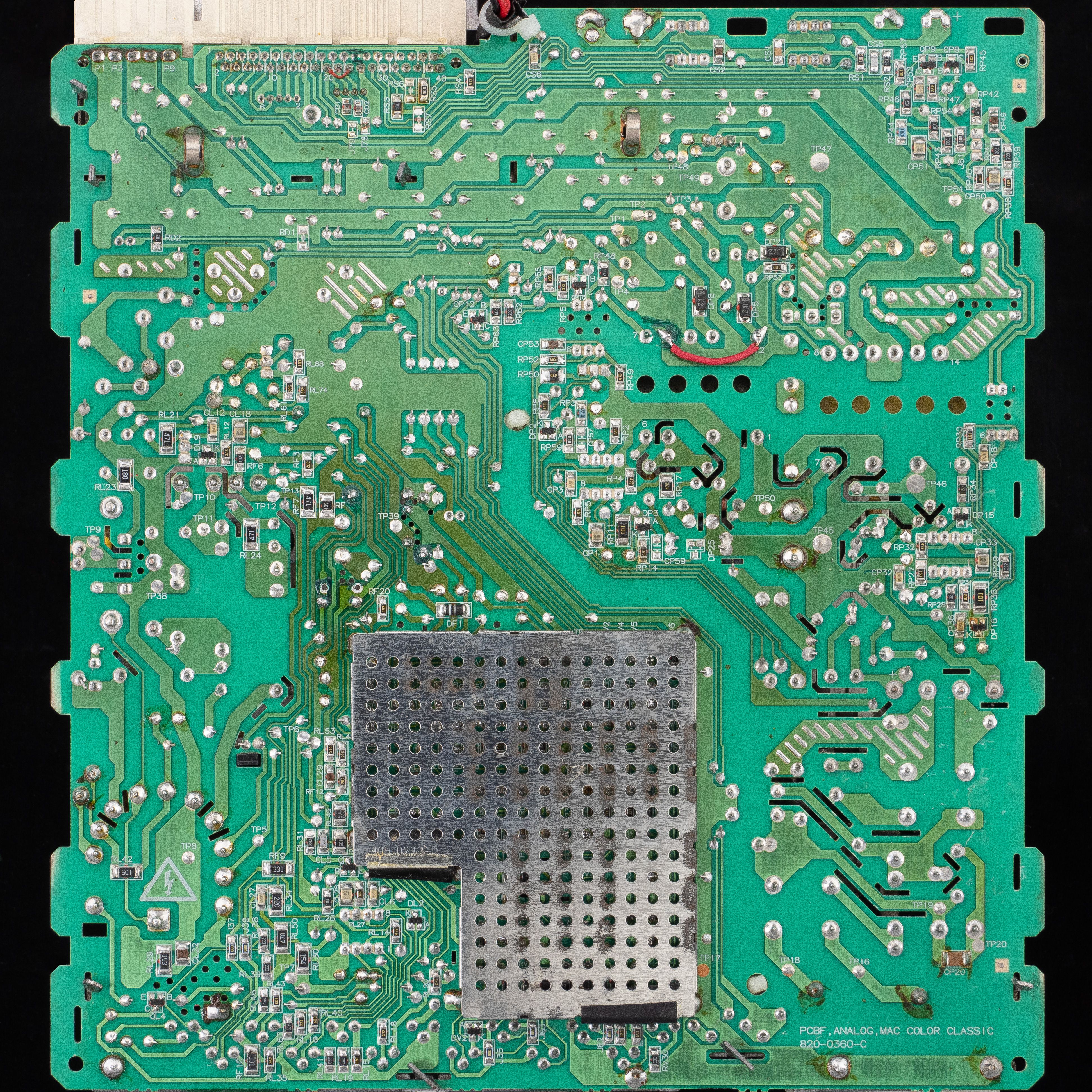

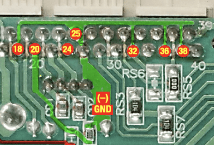

All of us who have done the 68.4V "VGA Mod" on our Mac Color Classic ANALOG BOARDS know that you must change the SENSE LINES, and that involves ISOLATING pin-25. I did that, along with @Branchus and @Kay K.M.Mods and countless other people through the years, and none of us have any problems doing it the same way. But while preparing for my forthcoming video on the 84v 13" Hi-rez mod conversion, I discovered something I hadn't thought about before. And honestly, I don't think anyone has!

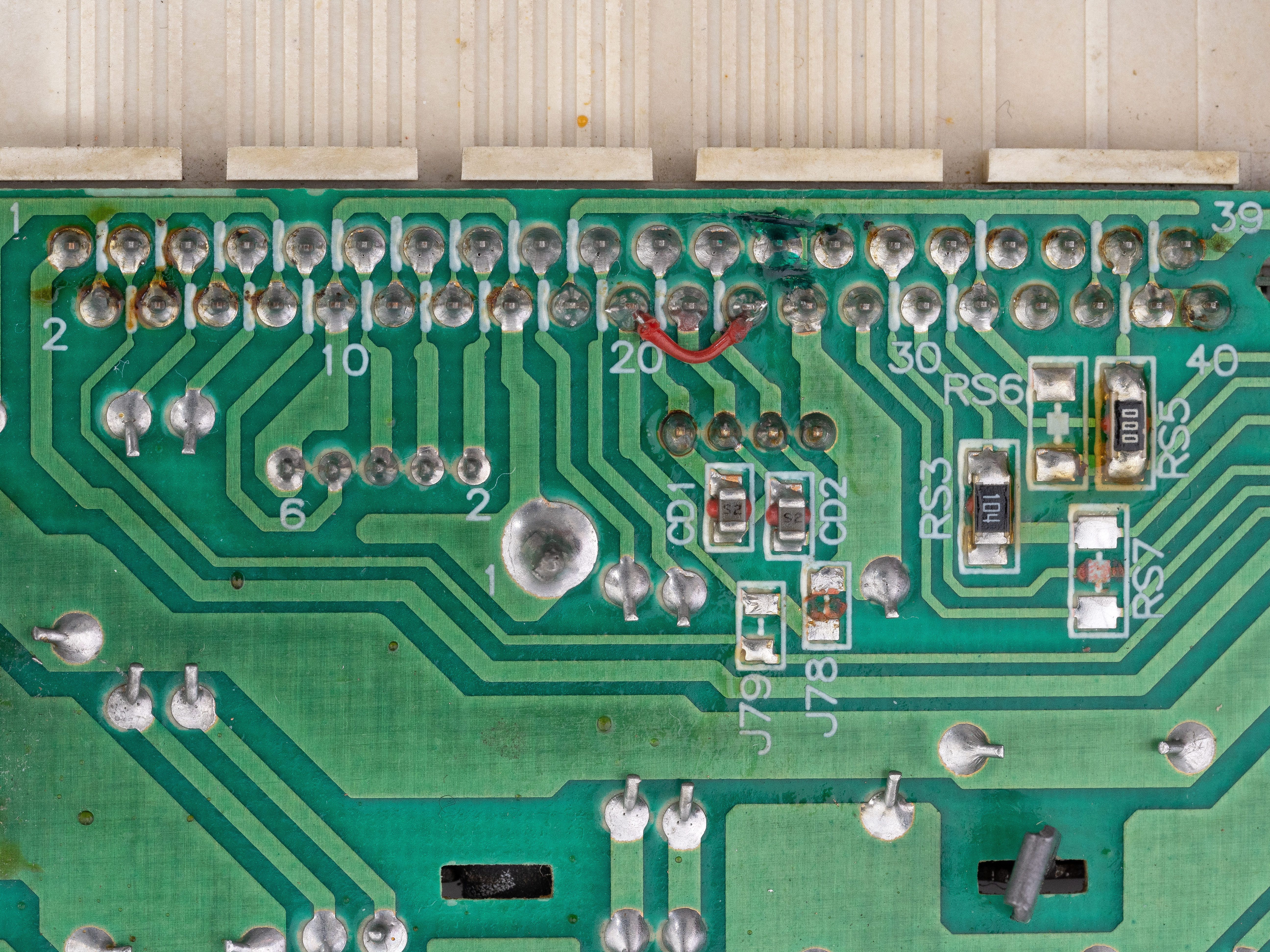

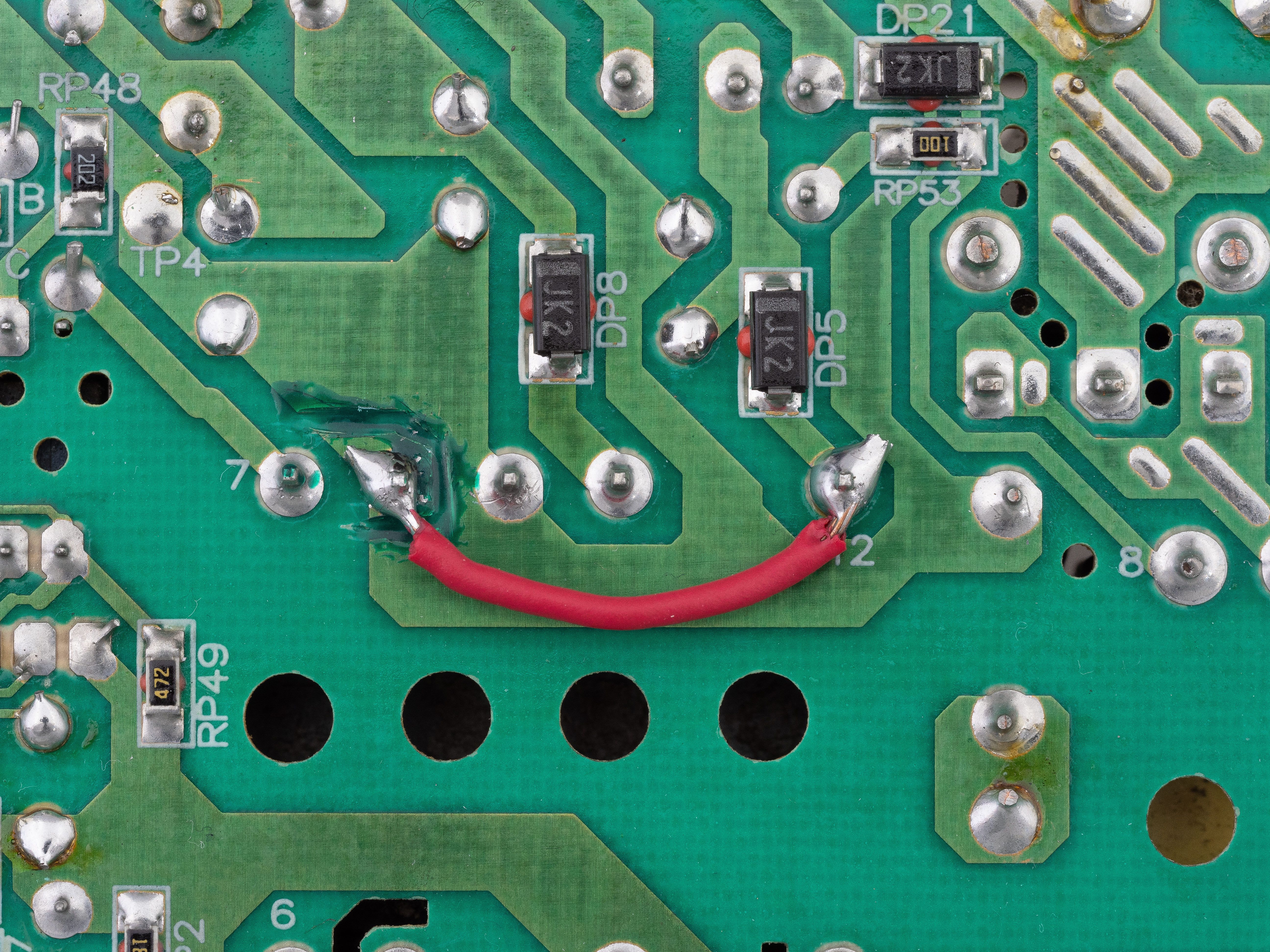

Have a look at the sense line mod area on the bottom of the ANALOG BOARD in my marked-up photo below...
(The board above is Rev. C.)
When doing the VGA Mod, we remove the 0Ω resistor at J78 (on boards that have it) in order to isolate pin-20 from Ground. (For the 84V 13" High Resolution mod, we move that 0Ω resistor (jumper) from J78 to J79, which effectively ties pin-20 to +5v.) The VGA Mod also requires isolating pin-25, but closely examine the width of the trace leading to pin-25. Ponder that trace-width deeply.
Specifically, note how incredibly thick that GND trace is leading to pin-25. Sure, it narrows going up to pin 25, but it then widens at the GND rail. That GND rail branches off along the edge of the PCB to feed GND to 4 other pins.
When doing the 68.4V VGA Mod, we are told that pin-25 must be isolated, and indeed it must be, but there are implications to that. In order to isolate it, we are all told to cut above and below pin-25. And truly, there is no other way to isolate pin 25. But consider this. When you cut out pin 25, that thick GND trace no longer feeds GND to the 4 pins!
Pin-32 is probably not affected because it leads to RS6, and those pads are empty. But what of pins 18, 36 and 38?

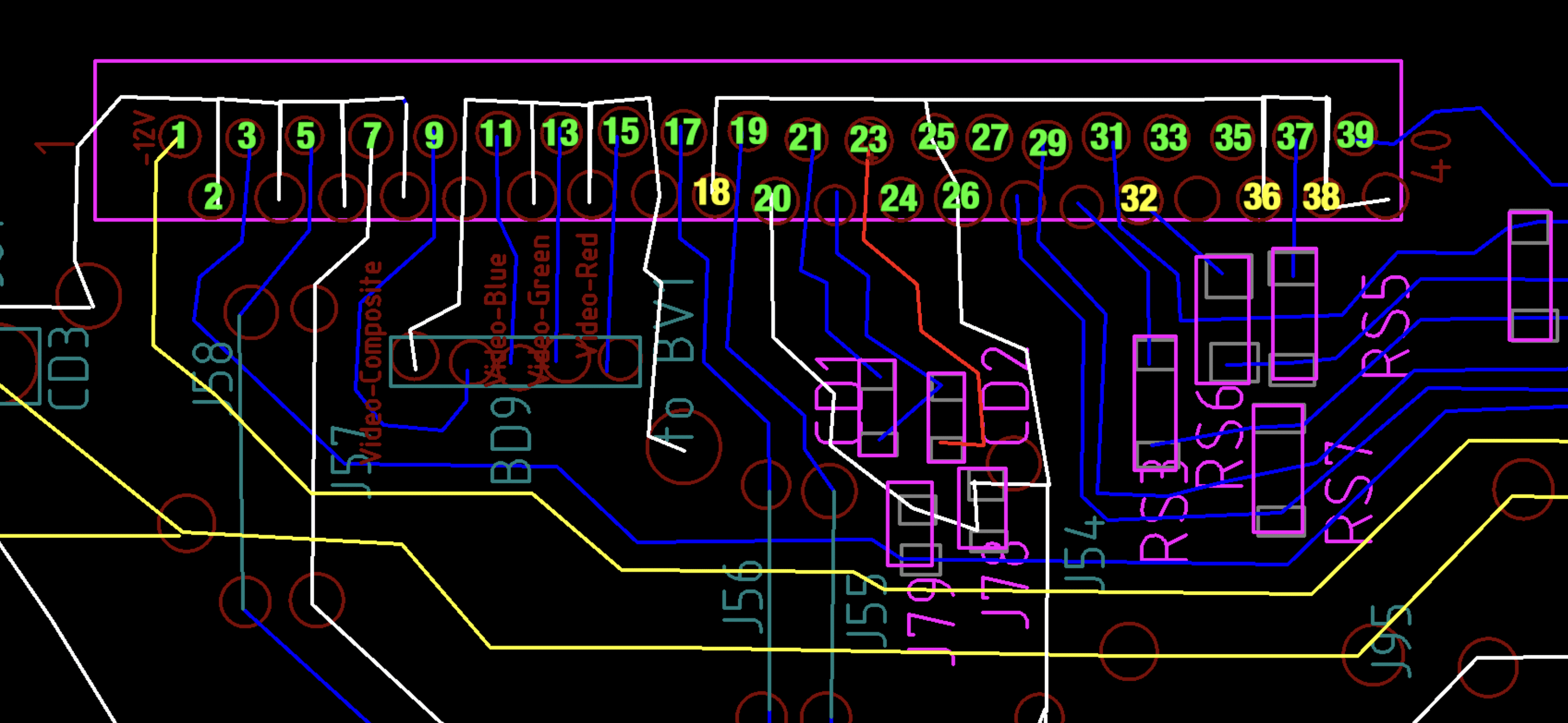

And if you're wondering if I have consulted the partial (and very INCOMPLETE) Analog Board PCB layout found here, the answer is yes, and I even put pin numbers on it for clarity. But "incomplete" is the key word here. Note the mistake it makes below by not drawing a white line from the GND rail to pin 32. So in light of that oversight, I cannot really trust that PCB layout, and it doesn't show me anything helpful anyway.

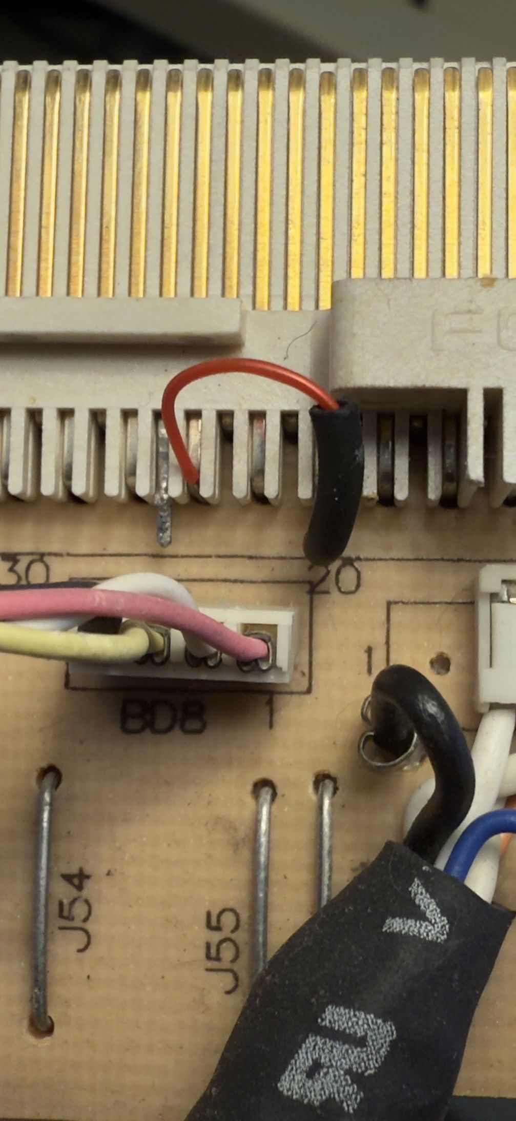

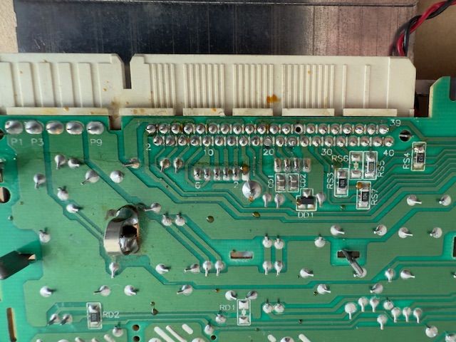

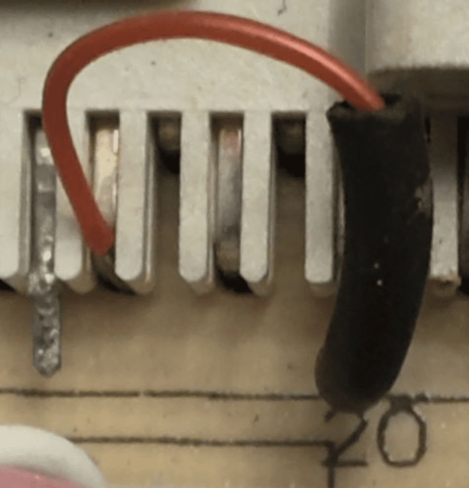

Below my take: I just desoldered and removed pins 20 and 25.
It did work. Until today, when after many months and a intercontinental relocation in between, I restarted my Mystic for the first time.

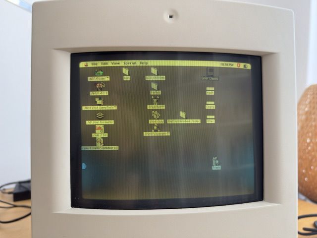

This time at 220V. A suspicious “pop” at the start up as the machine got energized and the display now looks messed up.
Don’t know if this has anything to do with the modification in combination with 220 V, though.

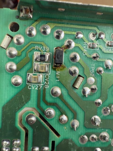

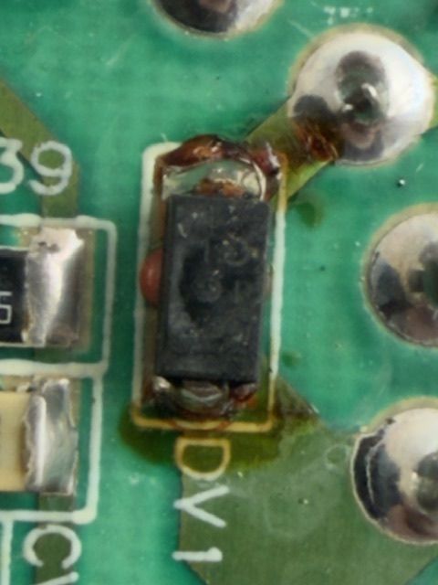

At a first glance, the neck board has what seems to me as a blown capacitor, any advice is more than appreciated.
  • Wow

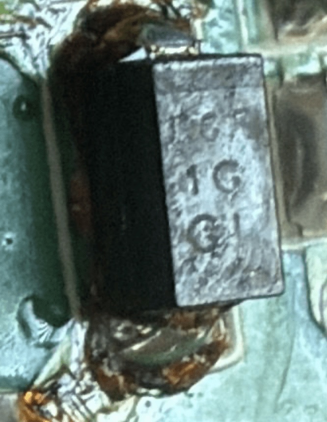

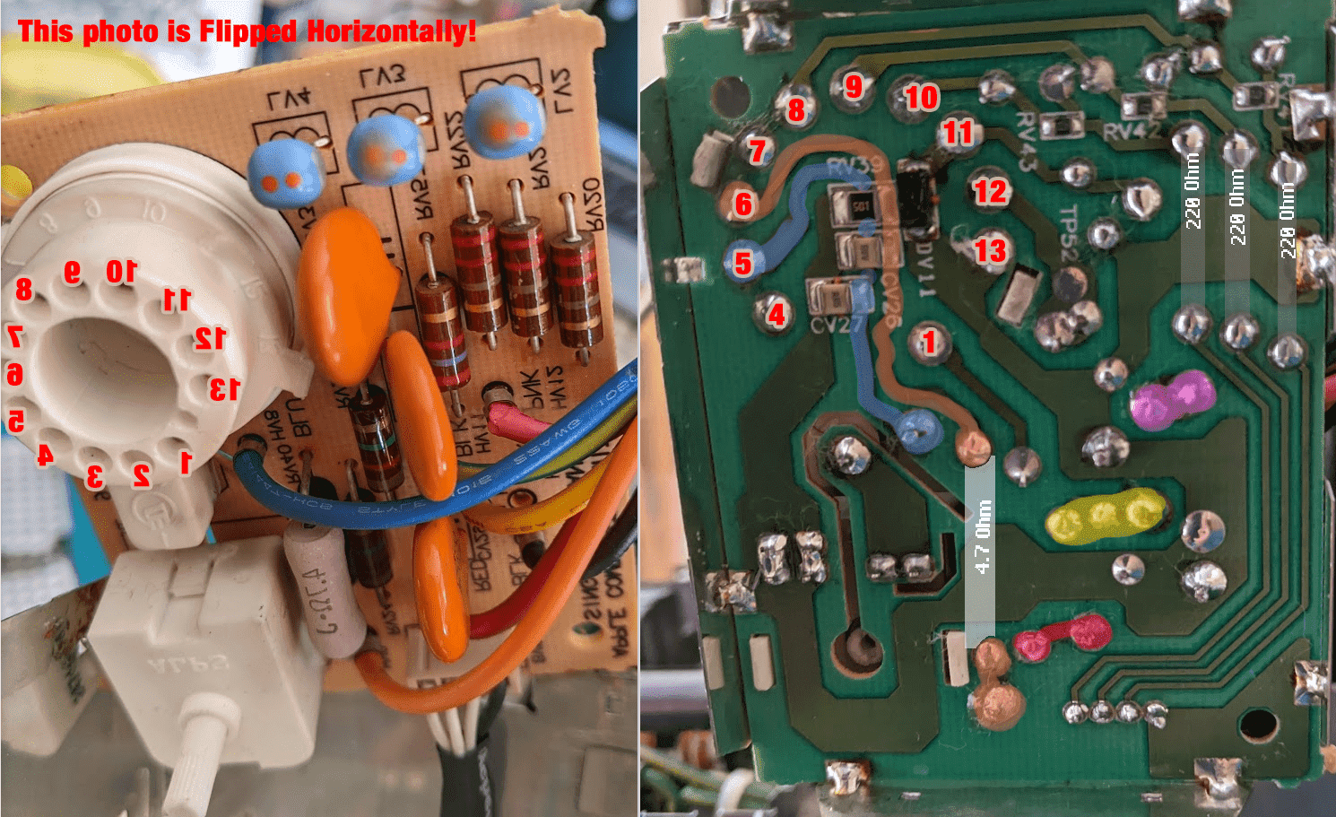

DV means diode, and I think I see the Cathode line marking on the side closest to that DV11 silkscreen.
Determining the type of diode and its part number is crucial for replacement.
I see that @Mu0n has a nice photo here:
@MuOn, would you know the value of that DV11 diode?
I see a partial description in the CC Analog Board Parts List here (keyword search for DV11 to jump to it):

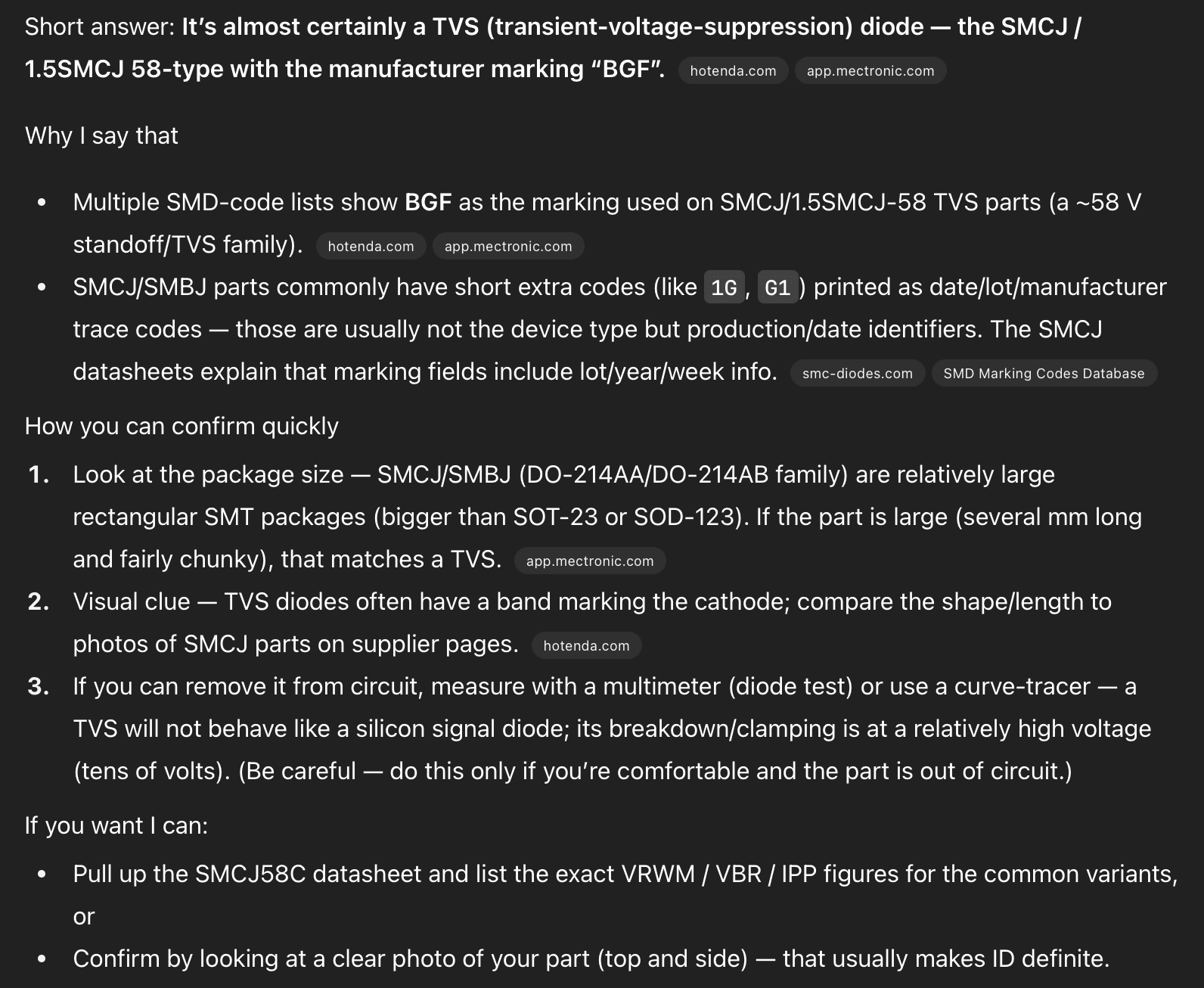

I told ChatGPT it's an SMD diode with "BGF (possibly E, not F?) 1G G1" and asked it to research what it might be. It came back saying this:
@Paolo B , could you explain how you removed pins 20 & 25 entirely? If you have the metal shield removed on the component side of the board, I love to see a photo of that area.
I also see that you have an analog board which is missing J78 & J79, so how you must treat the Sense Lines depends on which VGA mod you have. Do you have the 68.4 V version or the 84V 13” Hi-Rez version?
Thanks for the feedback and the support.
DV11 is a diode, sure. At a closer inspection it seems to be labelled "BGF 1G G1".
As for the pins 20 and 25, stupidly I did not document the process. However, please see in the picture how it looks from the back, underneath the metal cage. Both pins desoldered and lifted (yes, I had to desolder the entire connector, this much I do remember), plus a bridge.
Concerning the modification, I went for the basic 68.4 V one. Everything worked fine for quite some time, until today.
Wow! The fact you desoldered that entire connector is incredible!

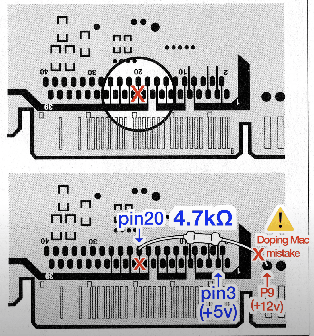

The book Doping Mac, which @Kay K.M.Mods sells and recommended to me, shows that when doing the 84V 13" Hi-Rez Mod on boards like yours WITHOUT the J78/J79 jumper pair, a pull-up resistor must be used as follows:
But you are NOT using the 84V mod but instead using the 68.4V VGA mod, which means you DO NOT use that 4.7kΩ resistor at all and instead isolate pin-20 (which it seems you have done), and then connect Pin-20 to Pin-24 with a jumper wire, which seems like you have done based on your photo here...

I took the photo posted on the MLA by @Mu0n and flipped the left side photo horizontally in order to identify pin numbers on that yoke connector, which you can see as follows:
So the Anode of that DV11 diode connects to pin-11 and the Cathode connects to a thick trace that leads to pin-13 and many other places.

It did work. Until today... I restarted my Mystic for the first time. This time at 220V. A suspicious “pop” at the start up as the machine got energized and the display now looks messed up.

What lead you to remove and open the Yoke Board and then spot Diode DV11? Did you inspect the Analog Board fully, find nothing, then open the Yoke Board as a last resort?
Your diode looks like it might be bad in your first photo, but then in your zoomed-in photo showing the markings, it looks fine. I’m afraid the only way to know if that diode is bad would be to desolder and check it with a meter set to diode check. But you would then need to take great care to solder it back with the Cathode line going in the same direction as before.

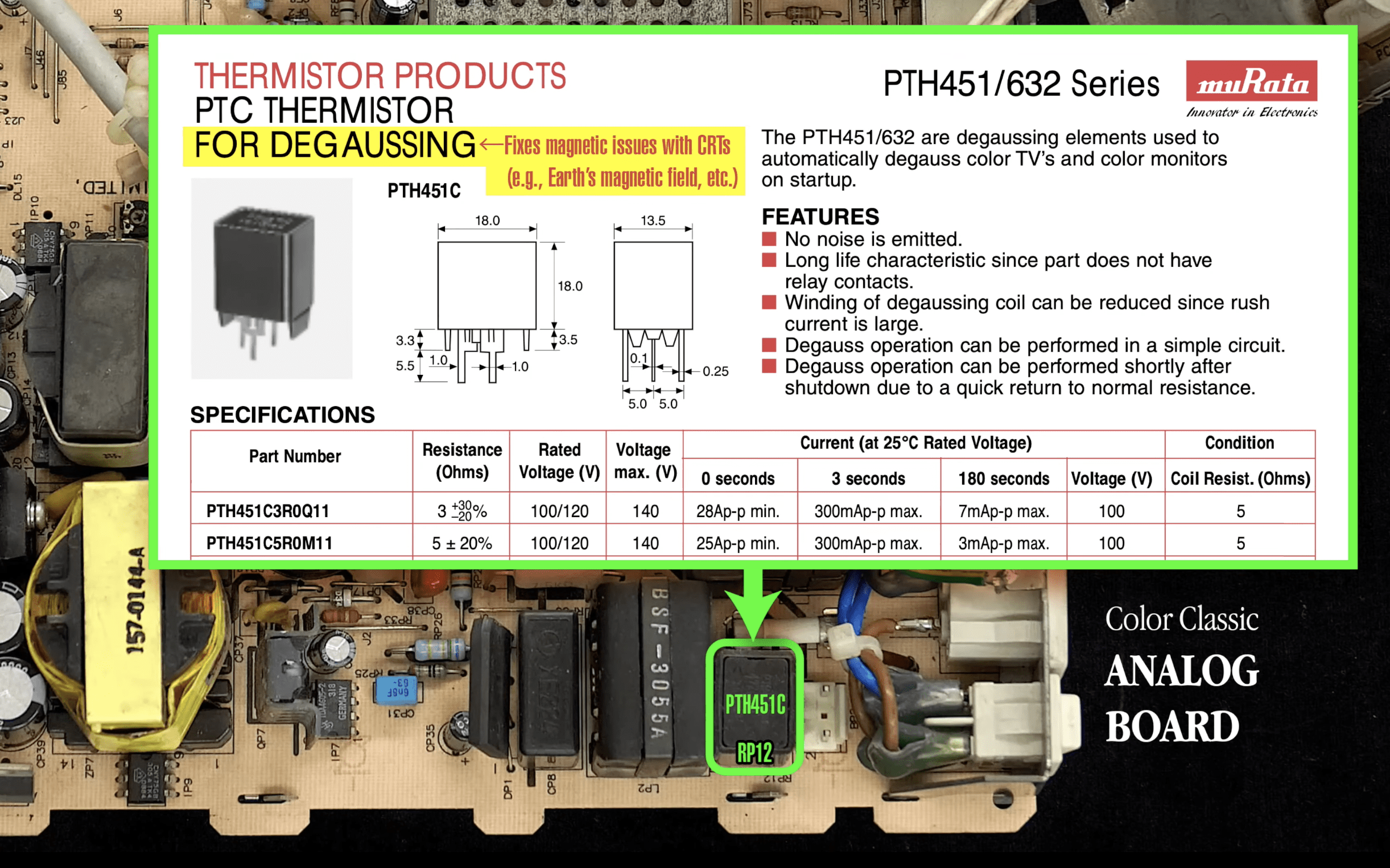

If you did not check your Analog Board fully, note the degauss component is there to remove discolorations, and you have discolorations. There’s a screen capture from my last video…
Thanks for you support, I really appreciate it!
Desoldering the whole connector has not been particularly difficult, even with a basic desoldering station like the one I have.
I just wanted to avoid altering the board, so I figured out the least invasive solution possible.
As for the current issue, I immediately noticed that even before the start up chime, almost instantly as I pressed the power button on the keyboard, a suspicious "pop" came out loud. To the point I was expecting nothing to appear on the screen. Luckily - so to speak - this has not been the case, but still some damage occurred.
As I couldn't see any visibly damaged component on the analog board (beyond the almost charred board behind the overheating resistors and diodes), I checked the CRT neck board noticing this overheated (damaged?) diode.
I now checked the degaussing item you highlight, seems to be OK, at least I could not spot any visible damage.

Yesterday, I fully removed my Analog Board and measured between GROUND and Pins 18, 32, 36 and 38.
I found Pins 18, 32, 36 and 38 were not Grounded by the Analog Board. No surprise there because of what I said in my opening post — we CUT THEM OFF when doing the VGA Mod, when isolating Pin 25..
My Analog Board has the standard 68.4V VGA mod installed. My board also has J78 & J79 jumpers. I did the VGA mod in strict accordance with the book Doping Mac, which is how everyone does that mod. (Well, everyone except @Paolo B , who removed the entire connector in order to lift pins instead of isolating them by cutting. Also note that his board lacks J78 and J79.)
As mentioned in my opening post, the VGA mod says to isolate pin-25 by cutting the copper trace between 25 & 26, and also cut the thick trace on the opposite side of Pin-25 that attaches to the Ground Rail that feeds Pins 18, 32, 36 and 38.
So, as mentioned in my opening post, when you make those two cuts at Pin-25, two things happen:
  1. Your effectively isolate Pin 25. That is a requirement for the standard VGA mod. (In contrast, Paolo isolated his Pin 25 by LIFTING the Pin and NOT cutting, thereby maintaining Ground to Pins 18, 32, 36 and 38.)
  2. Cutting means the Analog Board no longer feeds Ground to Pins 18, 32, 36 and 38, and I confirmed that last night by testing with my meter.
Of course, I tested with the machine torn apart and the motherboard no longer connected. So I don’t know if the motherboard is supplying ground to those Pins. That's why I created this thread — to find out.
When everyone does the VGA mod, it usually just works. So no one thinks beyond what they’re told to do. But is the motherboard Grounding those pins without help from the Analog Board?
If it can be shown that the motherboard DOES ground those Pins, then my question would then be answered, and it won't matter that you’ve isolated Pin 25 by CUTTING in those two places.
But if the motherboard is NOT grounding the aforementioned Pins (and I have no idea if that’s true), it means they’re not being Grounded at all when you CUT in two places to isolate Pin-25 for the VGA Mod. And because we don’t really know what those Pins do (18, 32, 36 and 38), we don’t know the implications of cutting-off ground to them.
But let’s hypothetically say the motherboard is grounding them. Why then does the Analog board also ground them? It doesn't make a lot of sense, and that leads me to doubt if the motherboard is actually grounding them. Because if the motherboard is grounding them, the analog board wouldn’t need to, especially because I don’t believe its passing high current to those pins.
So again, I look forward to hearing from you Color Classic experts regarding this.

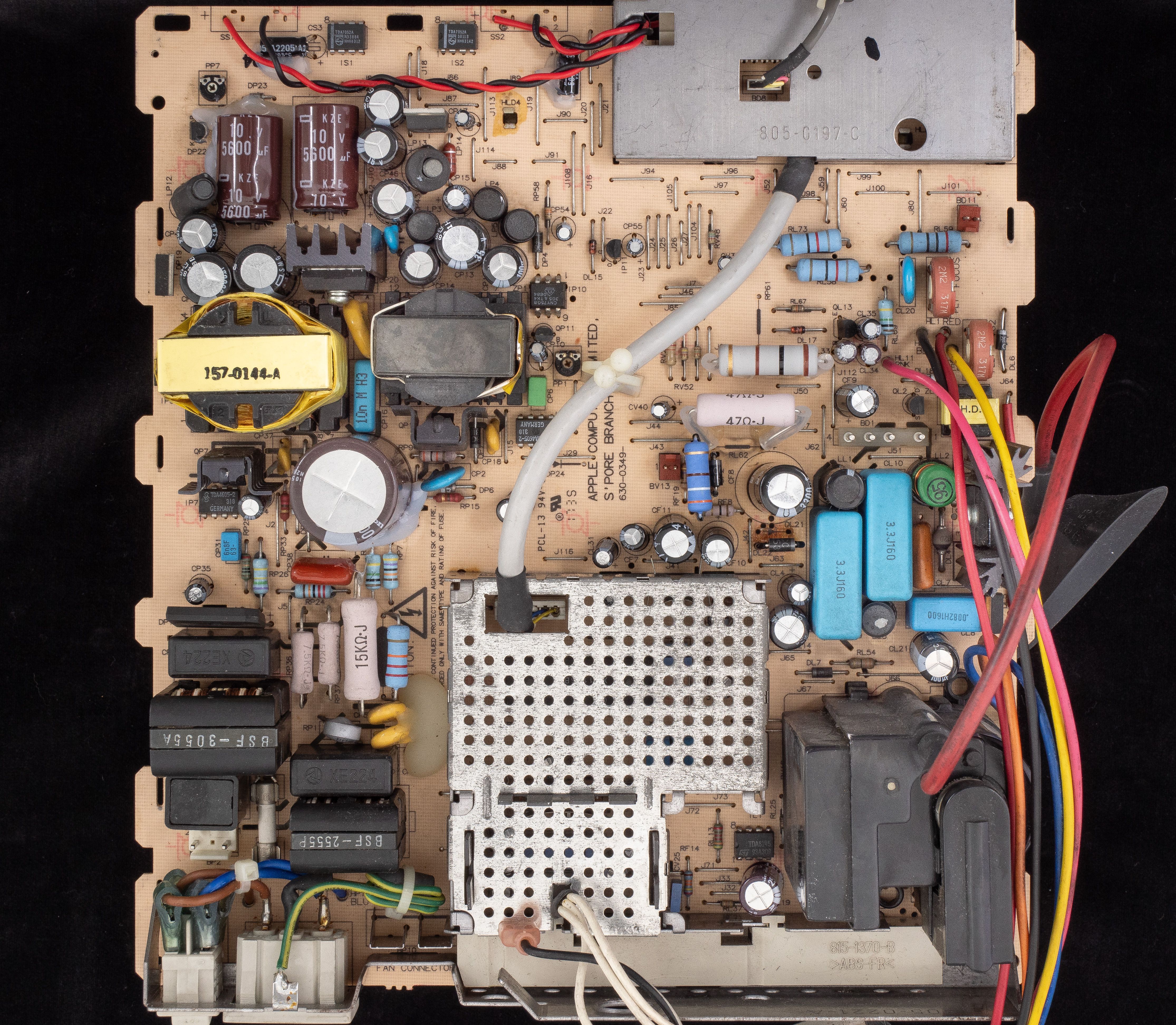

Sometimes posting photos helps to attract much needed attention to a thread, so here are some very high resolution photos of the top and bottom of my Analog Board, as well as zoom shots of the 68.4V VGA Mod (Sense Lines & Horizontal Deflection Voltage areas). You'll also see I have the stereo mod installed too. :)
If you look closely at the PCB bottom photo and look at the middle-left area, you'll see the solder mask over those traces has become darker than the other traces due to heat. That's the area where I swapped out resistors and diodes for higher wattage versions.
So, eventually, as I just didn't want to have another gut open Mac around, I reassembled it and... surprise, the issue is now gone.
I have not modified anything, but could be that some cracked solder joints got somehow re-seated in the process.
So, yeah, most likely it was the degauss thermistor.

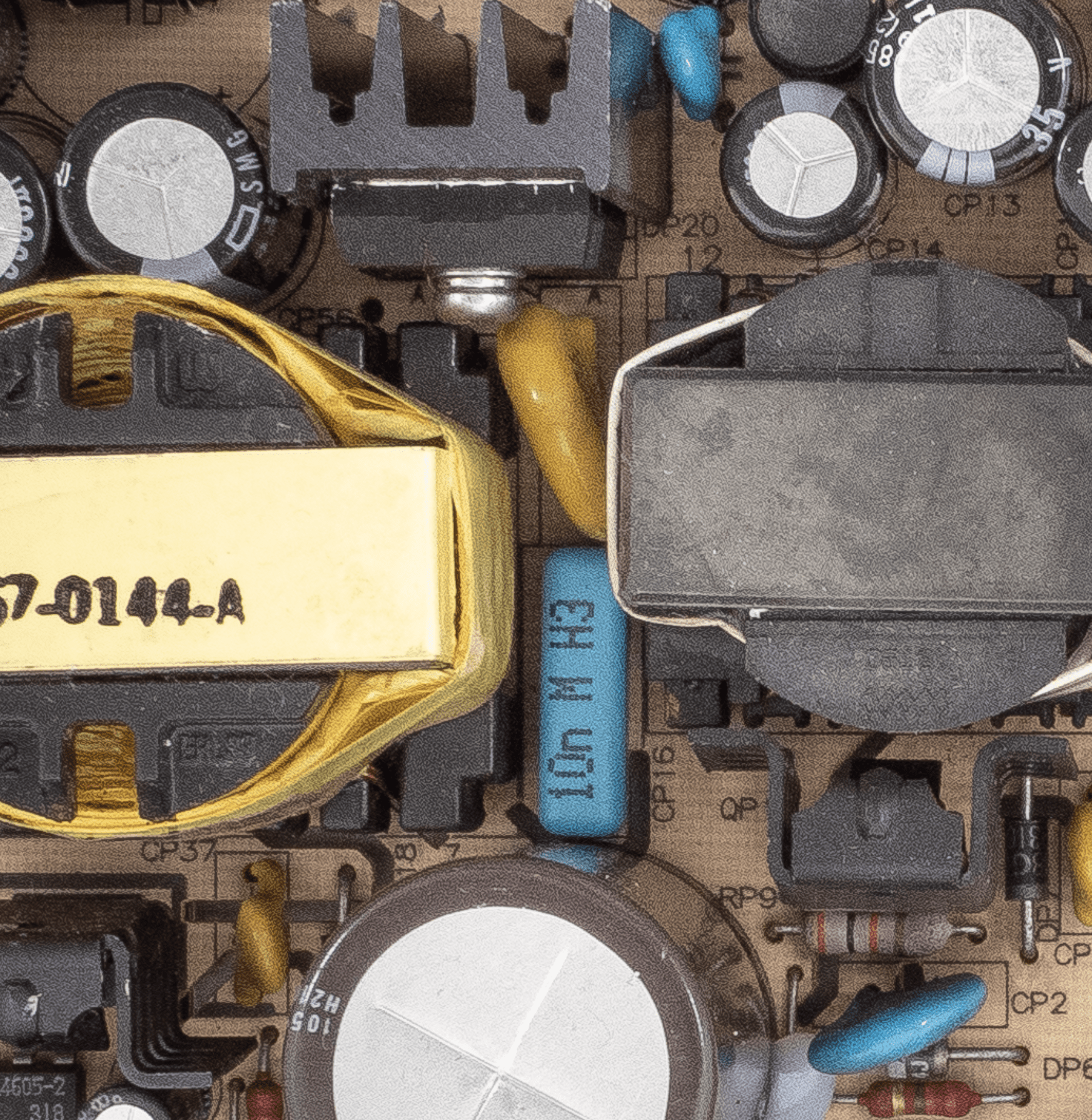

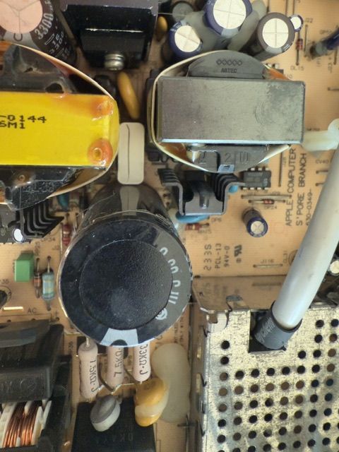

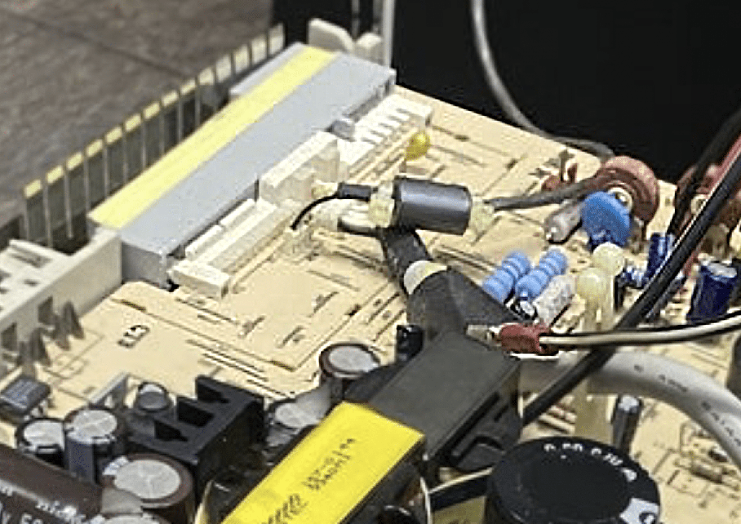

That still leaves the question of what that pop sound really was though.
There’s a crack in the case of one capacitor (?) tucked between two transformers (?) and a big capacitor. Could be it was that, I need to desolder it.
Hmmm... You have a different capacitor part number than I do. Mine is blue and shaped slightly differently (with no crack, of course)...
Because you confirmed your machine working, that indicates the plastic housing of your capacitor cracked, but nothing inside was affected. Even so, if that truly is a crack, it's worth replacing that capacitor, especially before you embark on the Stereo mod.
